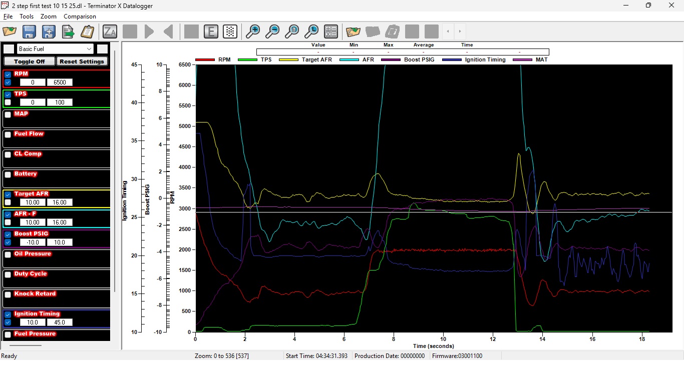

    I'll play with the 2 step some more today, I'll drop the timing down to zero in the area of -1 to +10 psi boost, 2000-2200 rpm and see what it does.

    Jim, the chart looks okay except the AFR during the stall portion.
    I'm guessing it was on the 2 step and the ignition was holding RPM, which is why the AFR went way high? No ignition means oxygen is not ignited, which means more oxygen in the exhaust.

    That's what it looks like to me.

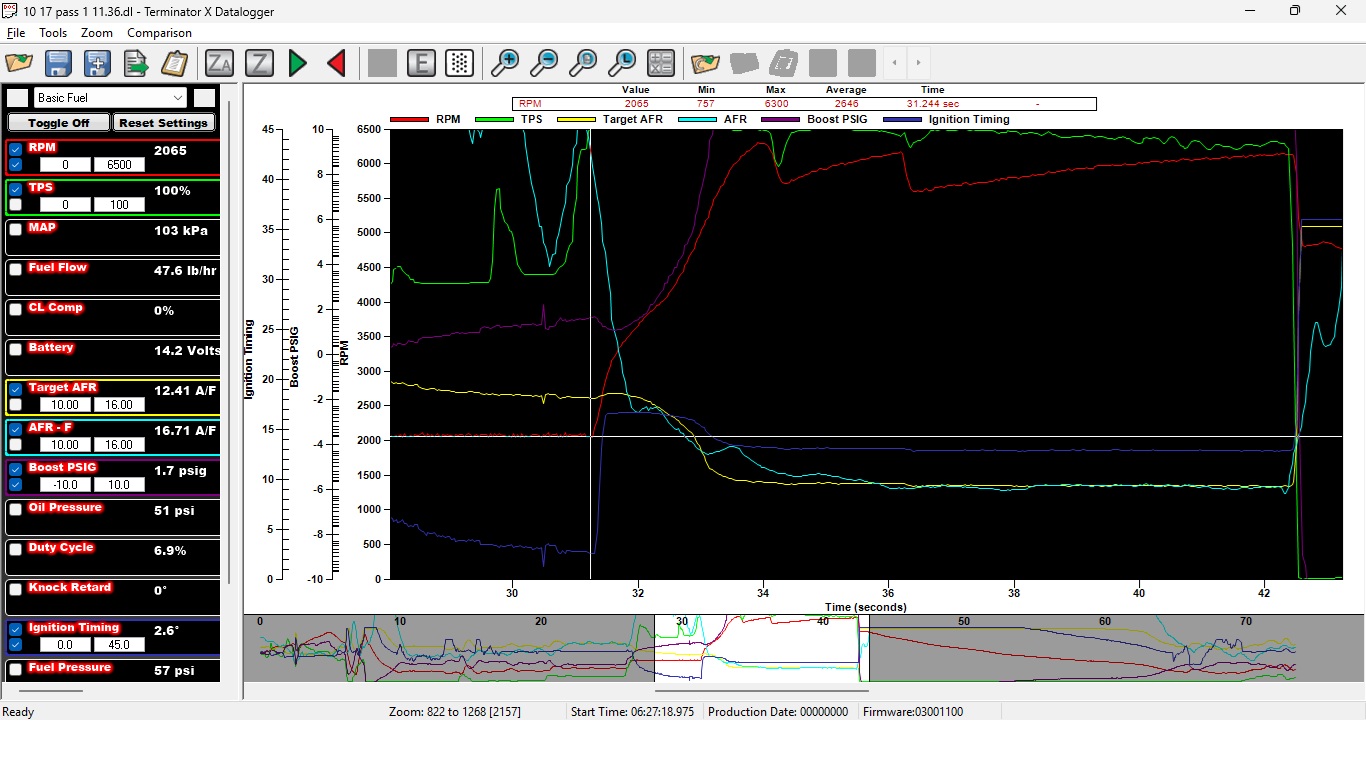

    still not launching worth a darn...but it is fun to drive!

    If you could get your 60’ down in the 1.40 range and take the difference off your ET that would be worth a smile…

    It's certainly making power. 129 mph is typically in the 10.30 ET range in a naturally aspirated car with good 60'.

    Search internet easy to find formulas use weight, et, or mph to calculate horsepower.; come up with 2 numbers. Mismatch usually means tire spin. With a turbo, mismatch means top end horsepower not there at the start

    not a stock converter. Notice in the datalog I didn't have the throttle open all the way when I was trying to build boost, that doesn't work.
    I'll play with it some more.

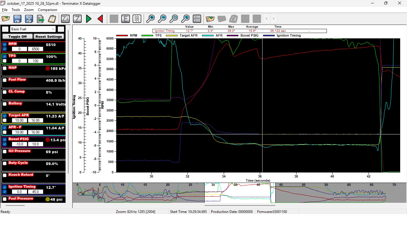

    Went back to the tune I had on drag week. Just foot braked without the two step. Quickest p*** yet. Still has a dismal 60 ft, but mph is good.
    I probably won't run again until the beater race tonight.
