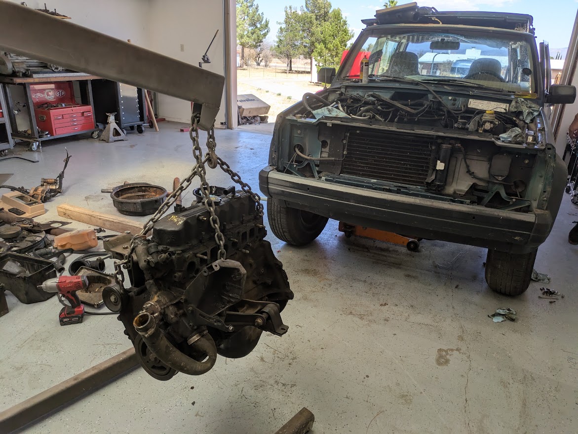

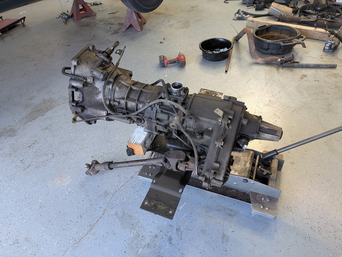

  18. squirrel
    Joined: Sep 23, 2004
    Posts: 60,996
    squirrel
    Yeah...ratio....I'm guessing low-mid 3s is where I'll be.
    Thanks for all the info, it helps!
