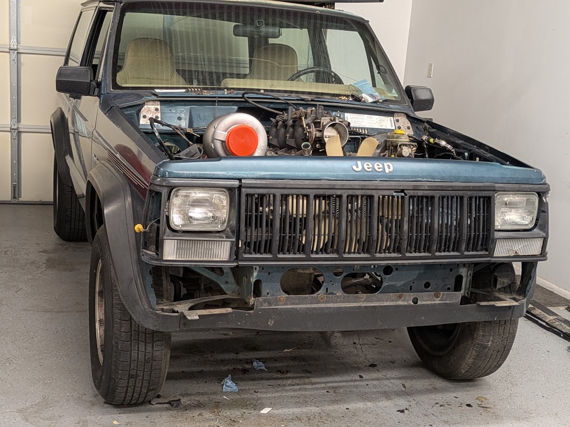

    It makes sense to have the crossover at the front if the turbo is going RF of engine bay. Shorter run (heat = energy) and leaves room for the downpipe to go down and back.
    Jim, have you plugged in numbers (weight+ET = hp needed) yet? You mentioned 3000 lbs and 9s.
    this says 600 HP will net a 9.96

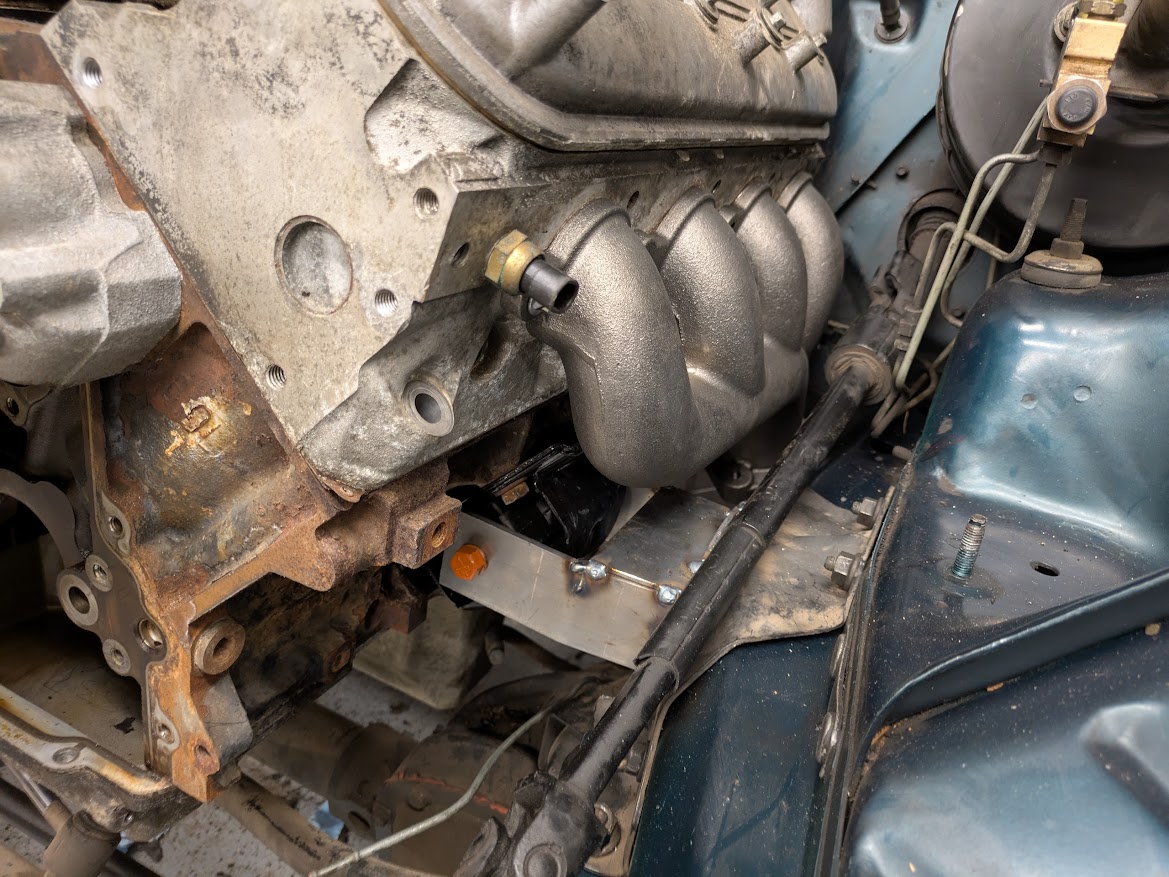

    Playing with mounts again. Trying to find where the engine wants to be, and how to support it there. I think it's pretty close, within 1/4" at least.

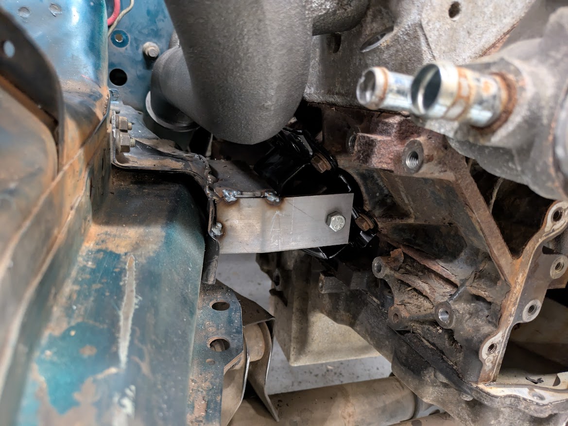

    working on mounts. This is one of the frame brackets that held the original motor mount. I cut off the horizontal part of it that went to the mount for the inline engine, at about a 45 degree angle, and welded on a plate to build the new mount off of. It'll all make sense when it's in the car...but at least a little progress is happening.

  9. squirrel
    Joined: Sep 23, 2004
    Posts: 60,992
    squirrel
    no engine plate, I'm going to try stock Camaro mounts and see how it works. Might not work, but I'll only be out $25.

  11. squirrel
    Posts: 60,992
    squirrel
    This is the progress so far...will get a flat plate across the top connecting the two "arms".

  12. gene-koning

  13. squirrel
    Posts: 60,992
    squirrel
    Me neither, but if they don't, we'll find out, eh?
    The front/rear plates are 3/16 thick, the rest is 1/8.
    tacked in....
    and the finished product. Well, almost.

    I haven't seen any falcons around here lately...except a few that have been fixed up. But you might be surprised how light the brick is. Shipping weight was 2954 lbs, Falcons were only a couple hundred pounds lighter. I'm taking weight out of it, too.
