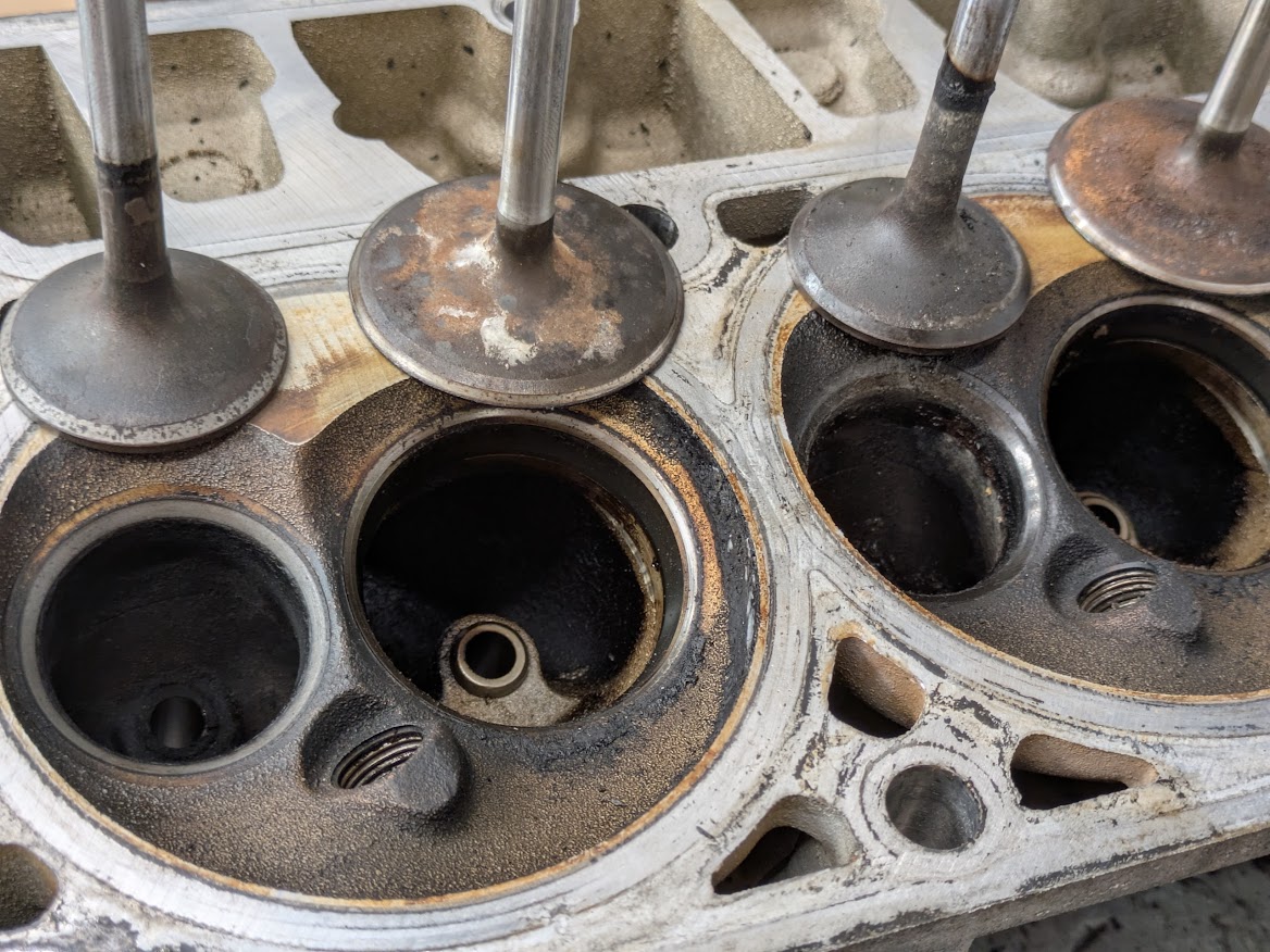

    Took one of the heads apart, they need stiffer springs for the new cam. I decided to do a little lapping on the exhaust seats to take away the carbon, just because. But I probably won't do much else to them, just some more cleaning, and probably new valve stem seals.

    No clean up of ports or even a gasket match. Grinding easy just time
    Sharpone likes this.

    They did a really good job building these engines, there's nothing to be gained by doing all that fun work. And this is the non-traditional forum :)

  27. RodStRace
    Joined: Dec 7, 2007
    Posts: 9,878
    RodStRace
    Yeah, I saw the ports and thought, hmm. Then remembered forced induction. Other gains elsewhere.
