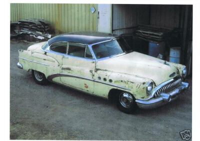

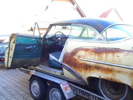

    just need to start my first rebuild thread about my Buick. The car was standing for more than 30 years in a junkyard and a Dutchman picked it up at 2002 and brought it home. He was an Alfa Romeo Dealer and thought to start a custom to be cool. As he saw the car first time he was scared about the condition and sold it as it was to a german guy. He sold it as a untouched and nice car in good shape that needs about 2k$ to let her back on the track :D
    He bought the car aslo unseen - what´s happened? To much work and to left hands and a call to god told him don´t start working on that car - you can´t do it!
    Until now it was 2007 one day after christmas and i checked the lists again to find my first own car. I just was helping my neighbour "Baumi" here in HAMBland. I checked the car one day after christmas and i felt surprised. It had a few owners during the last time but nobody touched the car. Everything stock and unrestored.
    Just needed some floor pans and a lot of time to beat out all the dends around the cars.
    Here it start´s coming to europe in 2002
    Here i picked her up in 2007 Christmas

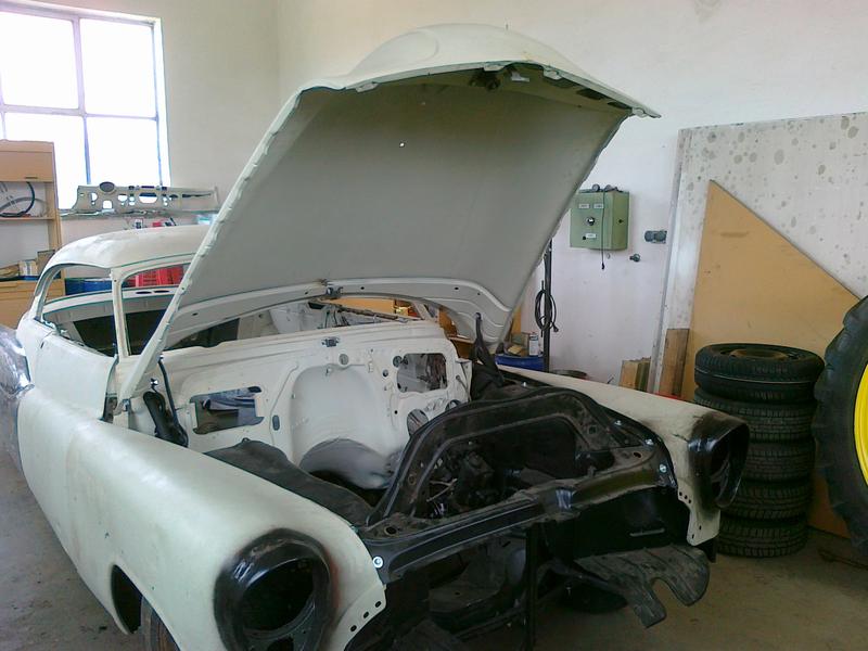

    I started to make a plan for the car. My plan was to french the headlights and but other rear lights on it. After i saw that the stock engine was gone i decided to replace it with a 401 and a 700R4. I love the nailheads and as long as it is a Buick i need to be fired by one!
    I also planed to upgrade the frontbrakes with dics and make a conversion to an open drive system
    So in case of that plan i decided to pull the body off
    (don´t ask, in that time i spend all the money i hade on her. I didn´t had money to rent a workshop and a lift, so i disassembled it in an old stall
    After stripping the body i rewelded all rust spots and decided to spend her some sand and primer

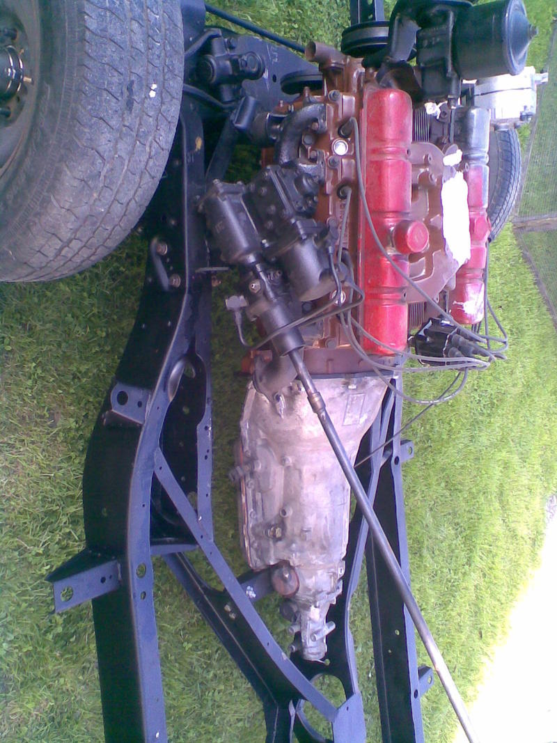

    Next step was to upgrade the frame to put the body back on it
    I replaced the torque tube and cut the frame to install a dual exhaust like it came from the factory
    Here i start the cuts in the X - Member for a symetric dual exaust
    Open drive conversion like 67 - 72 Chevy trucks
    (don´t worry, i welded u strud on the pick up when the body was back on and i knew the exact drive shaft position)
    Here after frame sand blasting and primer
    The next was to build the tranny adaper to fit the 700R4 on the nailhead. I know that there´s also a ready for installation kit for sale but this costs over 1000 Bucks until it is in Germany.
    Here we go
    Don´t ask about the job to get the exact Bolt pattern. I clambed the transmission onto the plate and used a gauge for the flexplate. I used the inlet shaft of the tranny to find the middle. After the tranny was in place i marked the holes and finished the adapterplate.

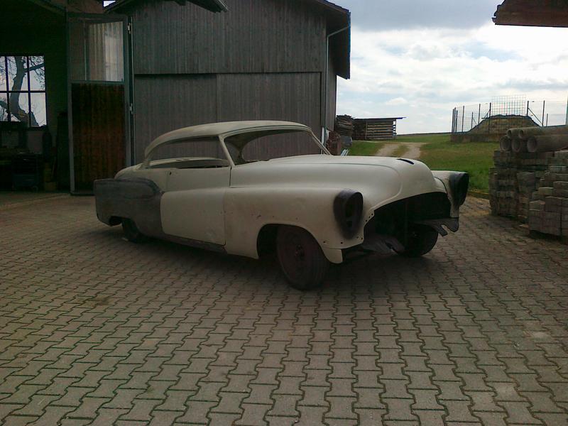

  10. As next the bodywork could start
    I frenched the headlights and replaced the stock taillights through ´54 Chevy lee lenses. Also a lot of dents must be beaten out of the body before it came to the work shop. A friend of mine is a real metal artist and he could fix nearly 90%.
    As you see - it was owned by an old lady....
    As it left for the dent repair. All bodymods were done. To french the taillights is hard work if you do it for your first time. Made it 4 times until i got as i looked for
    And here before she get the color
