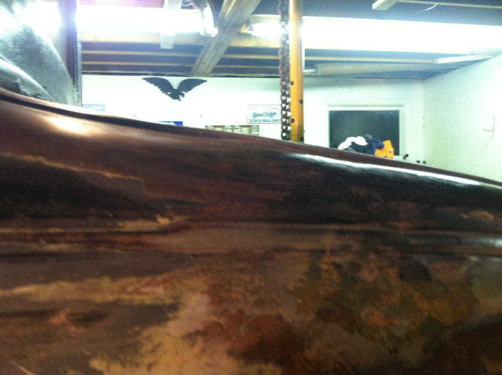

    Well...trying some metal bumping for the first time ever. I'd say be gentle, but f' that, ill never learn that way so criticize away!!
    From this
    To this...I know it's not even close to being done but any guidance would be amazing.

    I've been banging it w a hammer for a few weeks and finally feel like it's "close" sure is a lot to learn! Especially when yur teaching yurself. I got all my patch panels and have been taking off the poor patch work done by the previous owners

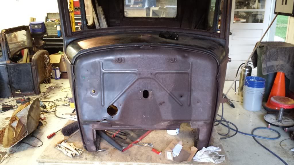

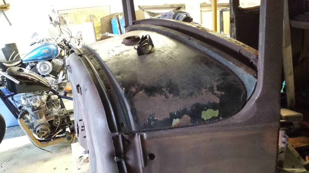

    Had a few hours yesterday so I decided to get off my *** and do something. Welded nuts to the cowl/gas tank screws that wouldn't come out with a screwdriver or drill. Got all the bolts out and cut the tank off of the cowl top. MAN DID I FIND A SURPRISE!!!
    Not surprised to see the dirt but there sure is a LOT of it.
    Got the top laying on the cowl to see how it looks. Fits pretty well. I'm gonna get the bottom cleaned up where I cut the tank off and get it ready to be fitted permanently. Any thoughts on welding the seam between the cowl and tank top? I think it may look a little better. Any reason not to do this? Just a thought.

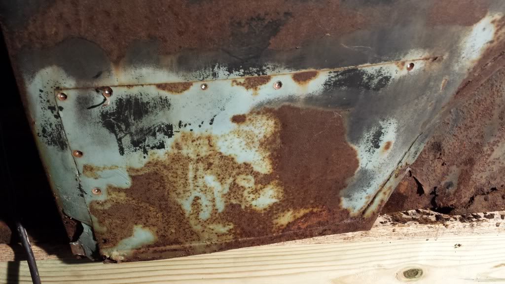

    Also, here's a few shots from a few days ago when i removed the riveted/body fillered "patch panels" one of the POs put on.

    if you are looking for patches none of them fit . all of them have different beads and dont line up to the orig beads. have fun with that rust !!:eek::eek::eek:

    As far as welding top of cowl on, I would at least wait until you are further on in your build. I have had the top of my cowl off many times while working up behind the dash. Dash comes out as well, so anything on the back of the firewall, need braces for steering etc. was easier to access. That is just my thinking.
