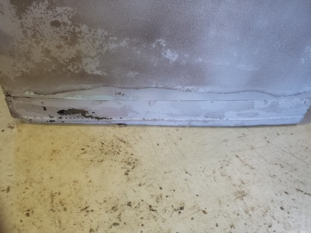

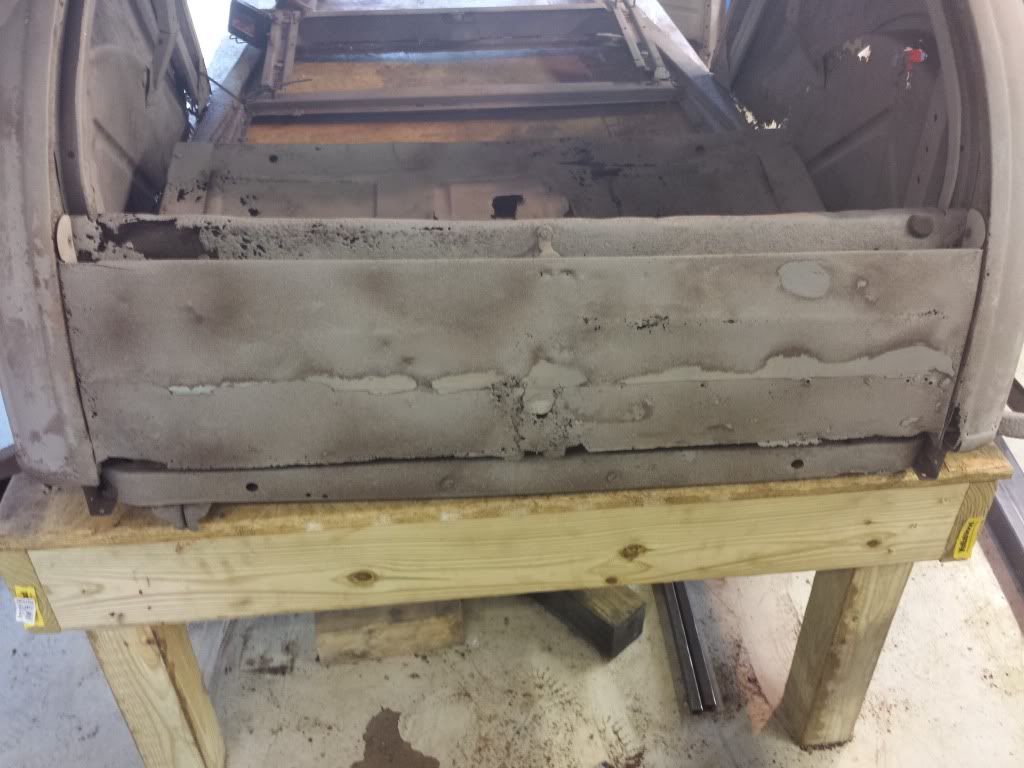

    Well, got the blasted coupe back earlier than expected. Its about as good as I could have hoped. The spots I knew were bad were bad... But nothing else. The only surprise was the mud on the bottom of the door, but that was getting swapped out anyways.
    Here's what that paint was hiding...
    The good
    The bad

    When it comes to complete bolt in panels, like the below deck lid piece that you'll need I'm sure you'll find Brookville parts will be just fine.

    the brookville is the better version of the panel under the decklid . put an original brace in it instead of the crap that is in there . Have fun taking the back apart !! Its the biggest pain when it comes to model As . Also if you use the whole cowl patch its too long and the line under the cowl band and the brake wont line up .

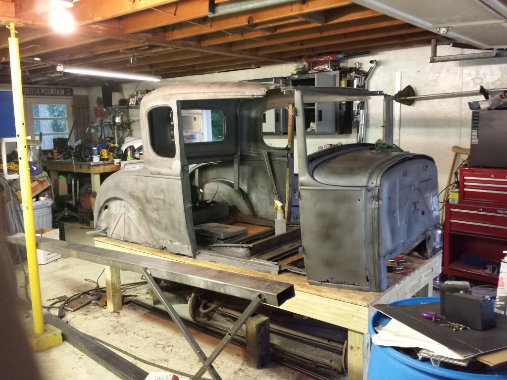

    Wow. First of all, sorry for the lapse in updates for those who were watching. I've been very busy the past few months getting the garage ready for winter. I upgraded to 220V power, which is SOOO much better than the 15A fuse that was there previously. Also, I ran natural gas to the garage and installed a 80,000 btu heater to keep me from wishing I was dead all winter. So, there's my excses for being a turd and not posting. Back to hot rods...
    This was about three weeks ago, frame (finally) was on its way and I spent a few days cleaning the shithole I'd created over the past few months.
    And then...On a magical Wednesday in November...IT arrived.
