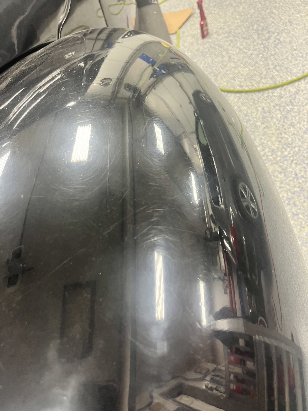

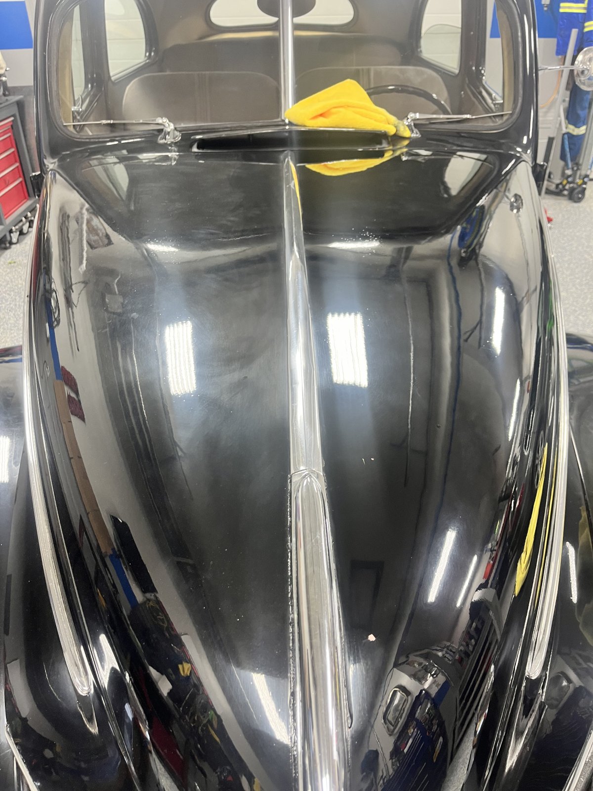

    Not knowing where to start I figured tackling the paint would be a good first step. The paint was very tired. The black was a gritty with lots of scratches. Someone had tried waxing or polishing before and created large swirl marks everywhere. I played with a few compounds but quickly discovered there was a lot or area to do by hand. So I purchased a DA polisher and started to learn. I figured I could make it any worse so why not learn polishing on a black car. I Started with a clay bar to pull the grit out of the paint. Then cutting compound, polish, followed up with a wax. The results were amazing the old paint job cleaned right up. It still has runs and embedded dust but now at least it shines. Moral of the story you can polish a turd.

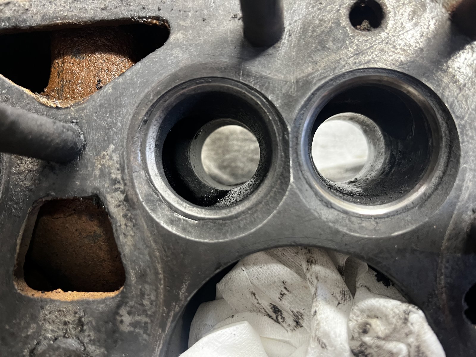

    Next up was find out why I was running rough a compression check on the engine and found #2 was down to 30PSI. A leak checked had it leaking out the exhaust. I pulled the head and eventually managed to get the valve out as the guide was stuck in the block. The seat was not in the best conditions but this a a budget fix on the engine as it seems to be very worn and needs a full rebuild anyways. Hopefully I can get one season out of it before I have to deal with it any further.

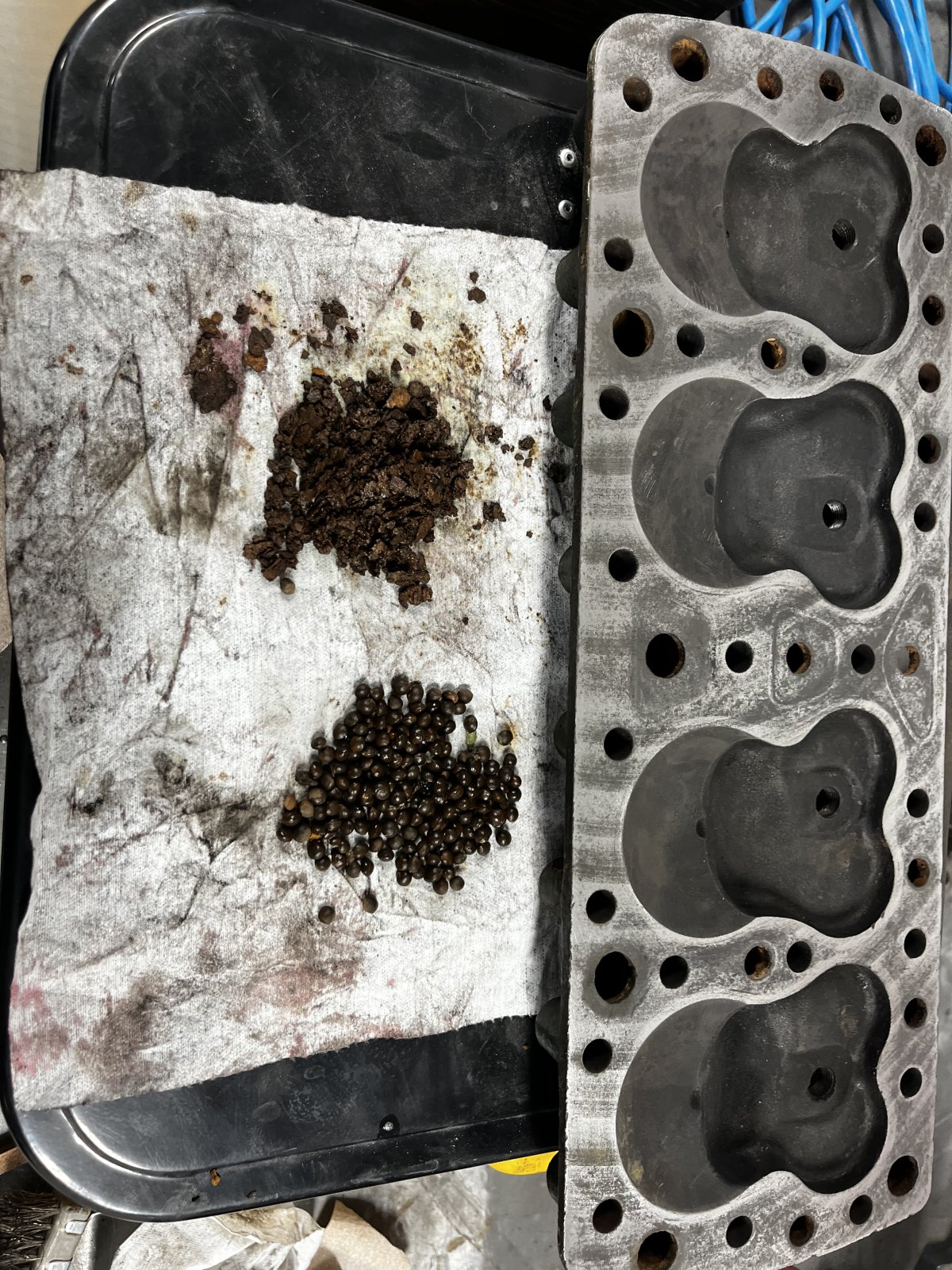

    With the head off I was able to clean out the cooling p***ages and got handfuls of rust scale out of the cooling system. After what came out of one side I pulled the second head and cleaned that cooling system out as well. The other sider had just as much debris in it as well. At some point a critter had found the rad tank was a great place to store food and I pulled old cherry pits from the top tank.

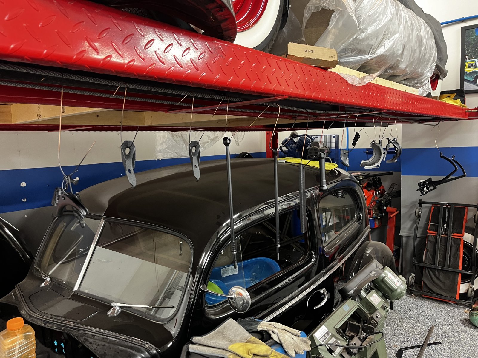

    At this point I decided it would be best to just get the body off the frame so I could have better access to the body mounts for repairs. I stripped down the interior cutting the patchwork of wiring out of the car including multiple house hold wire nuts. It was just a disaster so figured starting from scratch was going to be easier (also I really enjoy wiring).
    I stole this idea off some other builds on the HAMB and created a front spreader bar to bolt to the hood hinges. Out back I used a floor jack on a wood support in the rear of the body. I lifted it a few inches at a time and used some cribbing to support the body until it was up far enough to get the frame to slide out

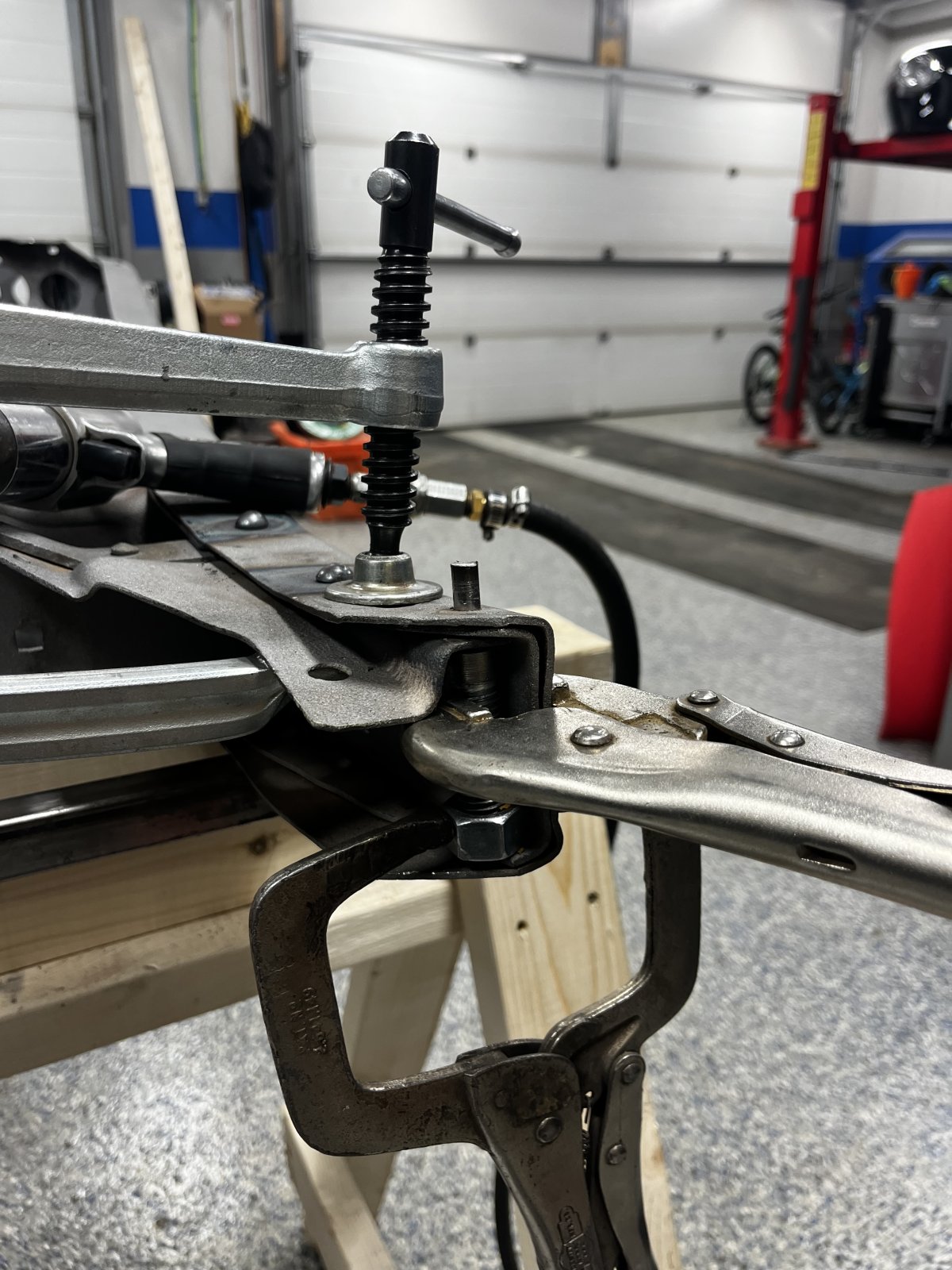

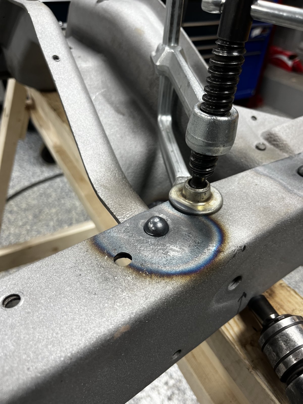

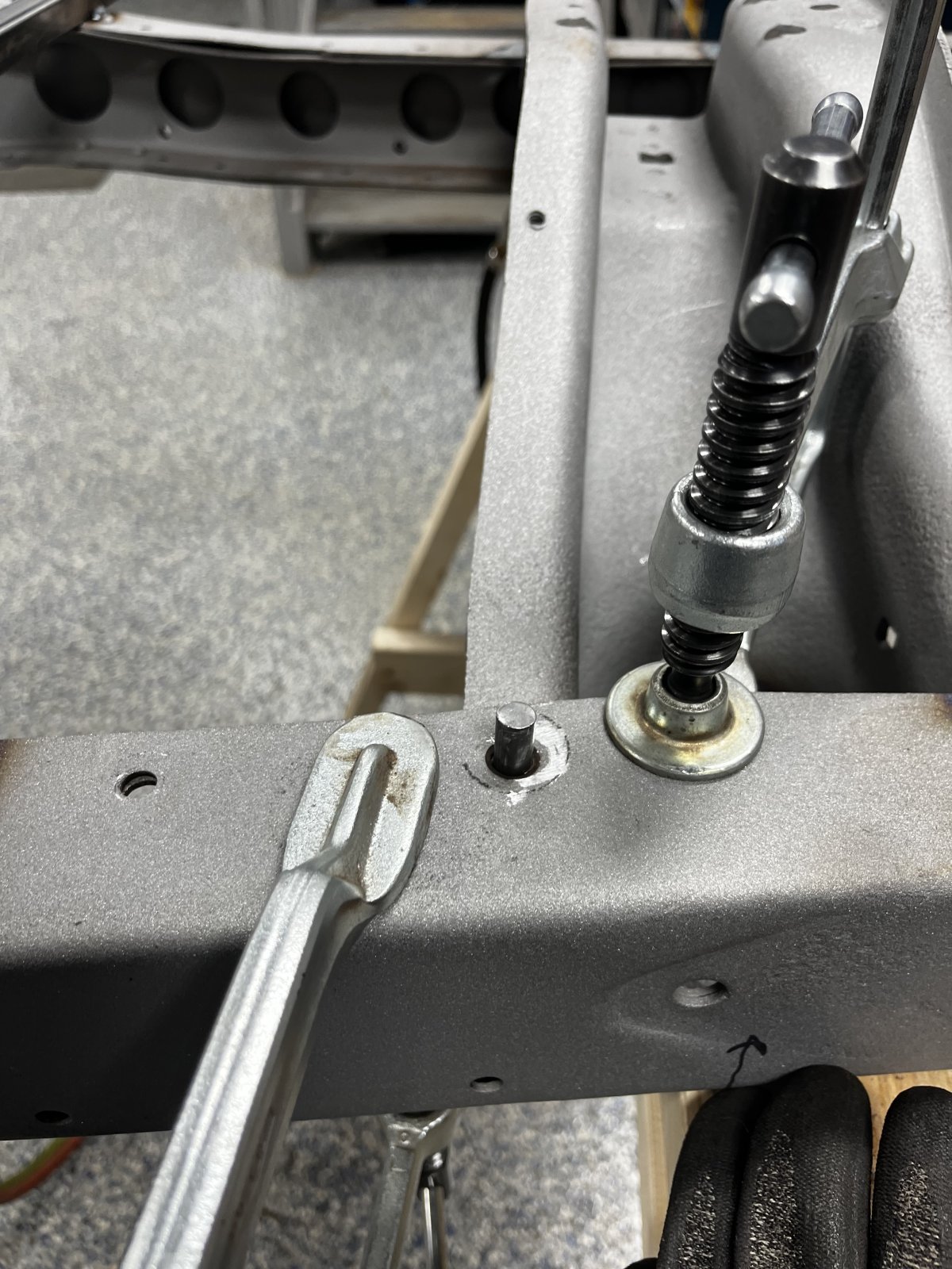

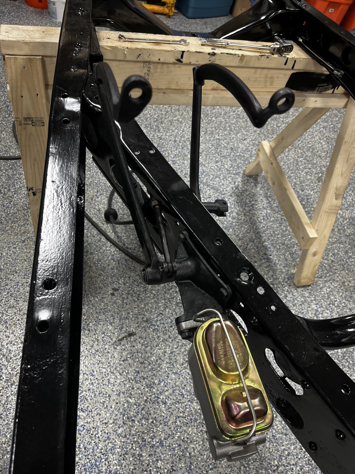

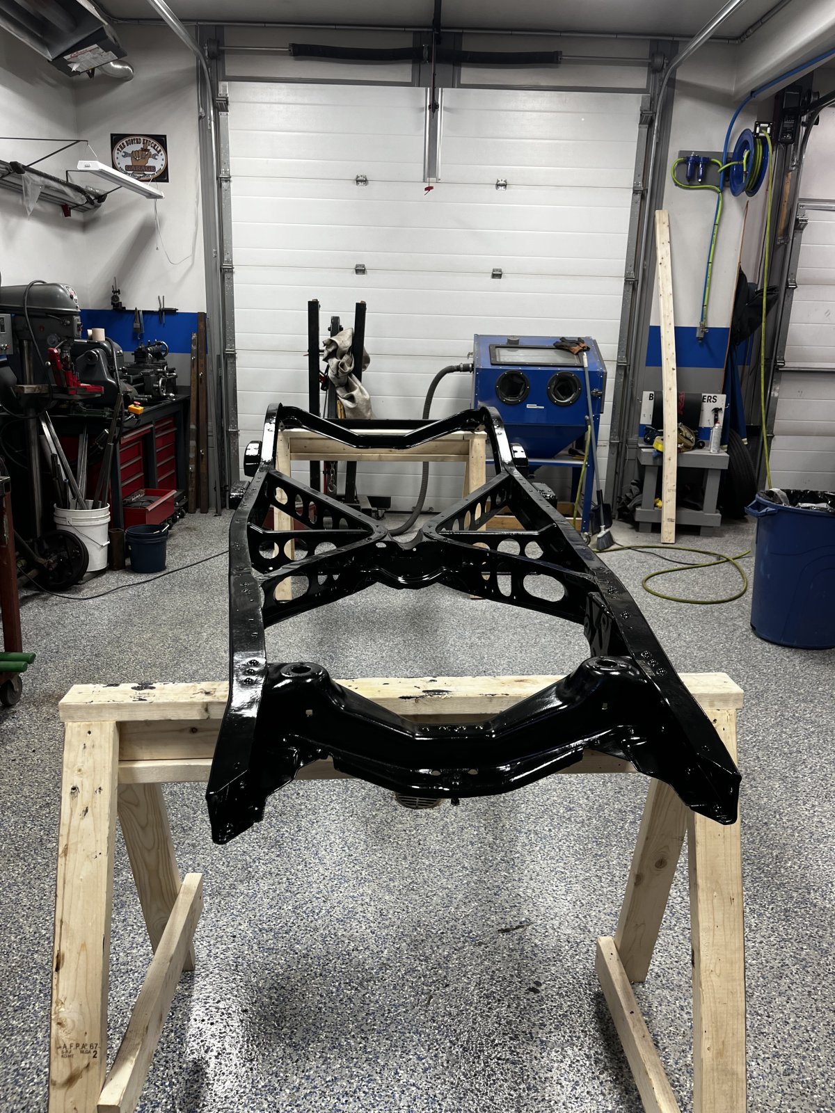

    With the body off I was able to got a closer inspection on the frame. After 85 years it was in need of some attention. The front crossmember was cracked and poorly repaired. This is where the snow ball started picking up speed. I figured why stop now and I just stripped it down to the bare frame. I took it over to the locate U-Blast and cleaned off 84 years of rust and dirt.
    I was able to locate a good front cross member so out mine came and in went the replacement. @jordabennett customs gets credit for the great YouTube videos on hot riveting. Gave me the insights to try it out and it seems to have worked. Only thing I did differently was built this adjustable buck to wedge inside the frame to hold the rivet in place as it was a one man operation. It was a noisy job with the air hammer both my kids notified me that it was to loud to fall asleep in the house (another flaw in having a attached garage with kids rooms above) The steering box mount was cracked so a good replacement was installed.
    Once everything seemed good I was able to paint the frame with KBS rust paint.
    So this is where the project sits now. Time to get busy cleaning and painting all the other parts off the frame too keep it going back together. Fix the body mounts, completely rewire and plumb the car. The goal is to have it ready for the 2024 season while maintaining a full time job plus 2 kids.

    Thanks the paint is far from perfect it still has lots of issues. I was not brave enough to try wet sanding yet but it sure came up looking better than it was. It still has that old paint look and I won’t have to yell at the kids for getting to close to the car when swinging hockey sticks or parking bikes.

    Wet sanding is easier than polishing. But, your DA buffer will very likely not remove the scratches from even 3000 wet sand. For that you will need to master a variable speed buffer with wool bonnets for the first p***, I switch to microfiber bonnets on the same machine for the second p*** and then I switch to my variable speed DA from Griots Garage with microfiber bonnets for the final glaze.
    That wool bonnet on a high-speed buffer can burn through paint FAST! Start on the wife's car. :cool:

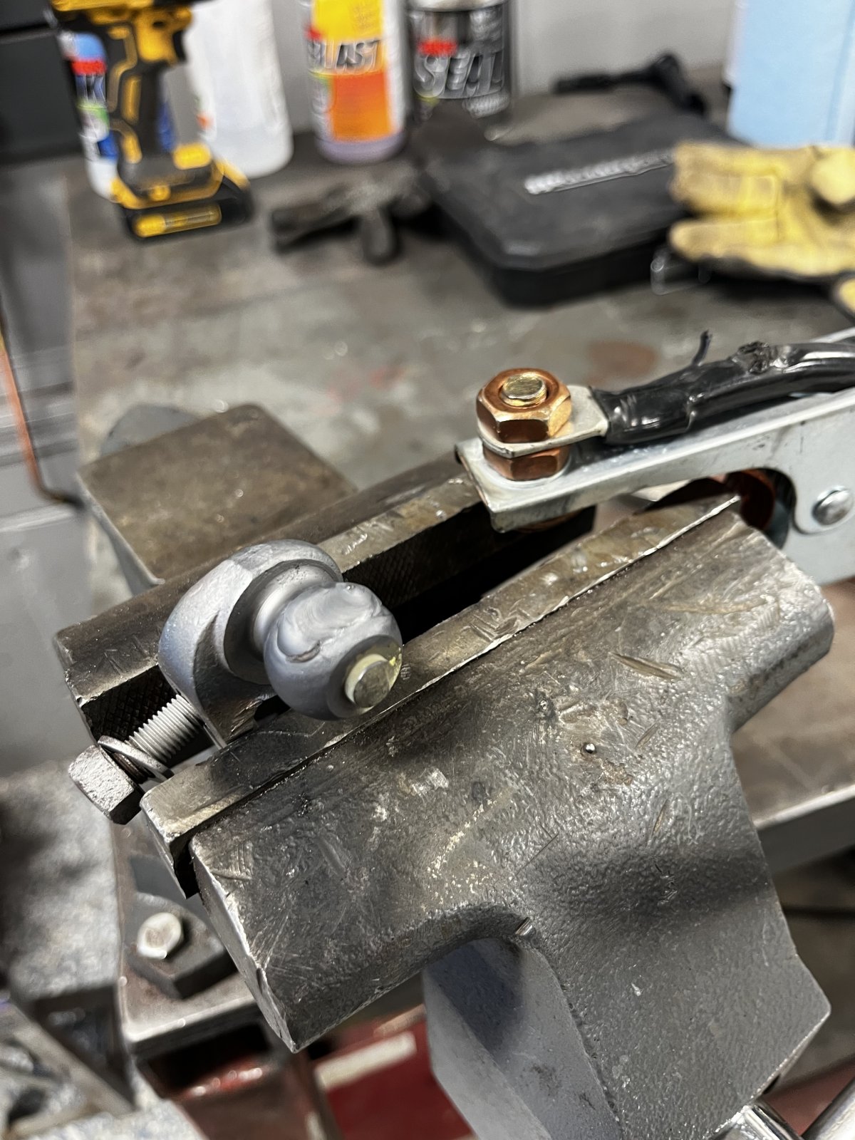

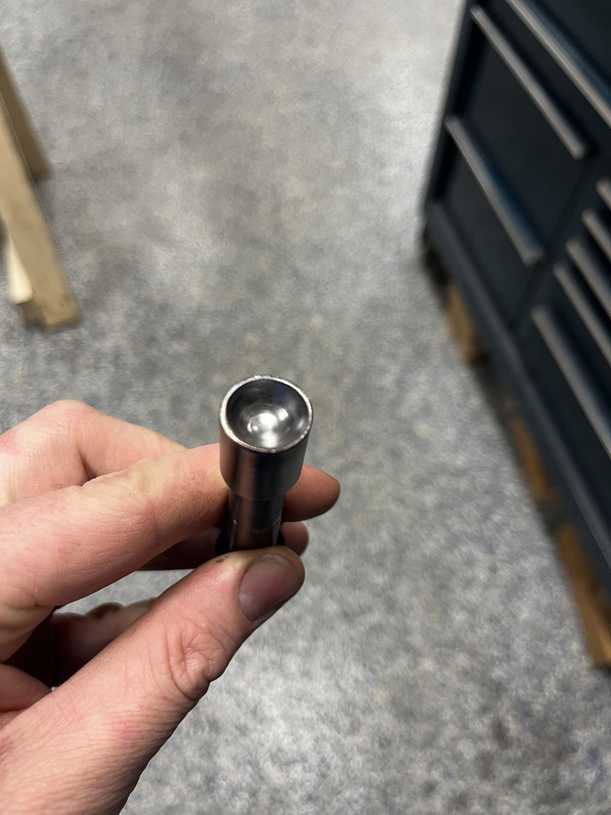

    After 84 years the pedals had some wear and play. Found the original bushings were worn right through. I Forgot to order them and didn’t want to pay $40 in shipping for $15 in parts. Checked my extras and I had some bushings from my experimental 28 roadster clutch linkage so I was able to turn the OD down to fit inside the pedals. I’m sure the real machinist will have a better solution but to hold the bushings on the 3/4” stock I used a drop of supper glue. Once the machining was complete I heated section up with a torch as that release the glue so it could be slid off.
    Next up was building up the worn section of the clutch pivot ball and then shaping it back. Hopefully the pedals will be good to go for another 84 years.

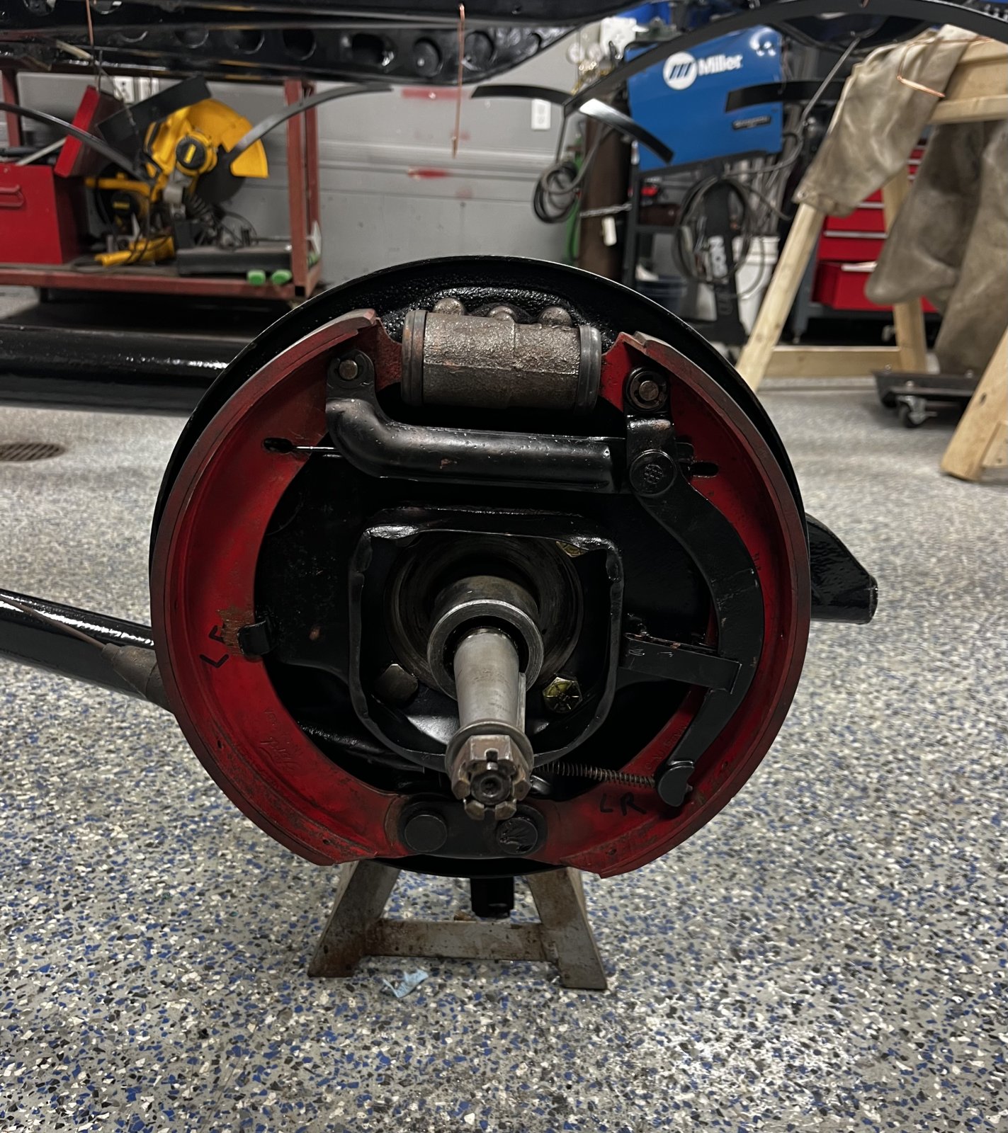

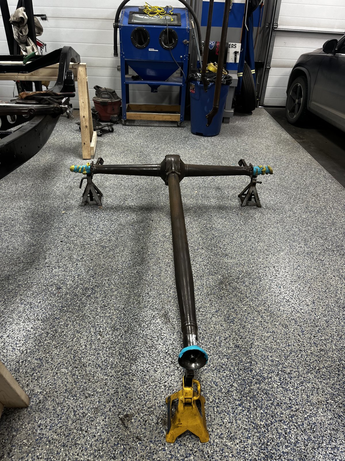

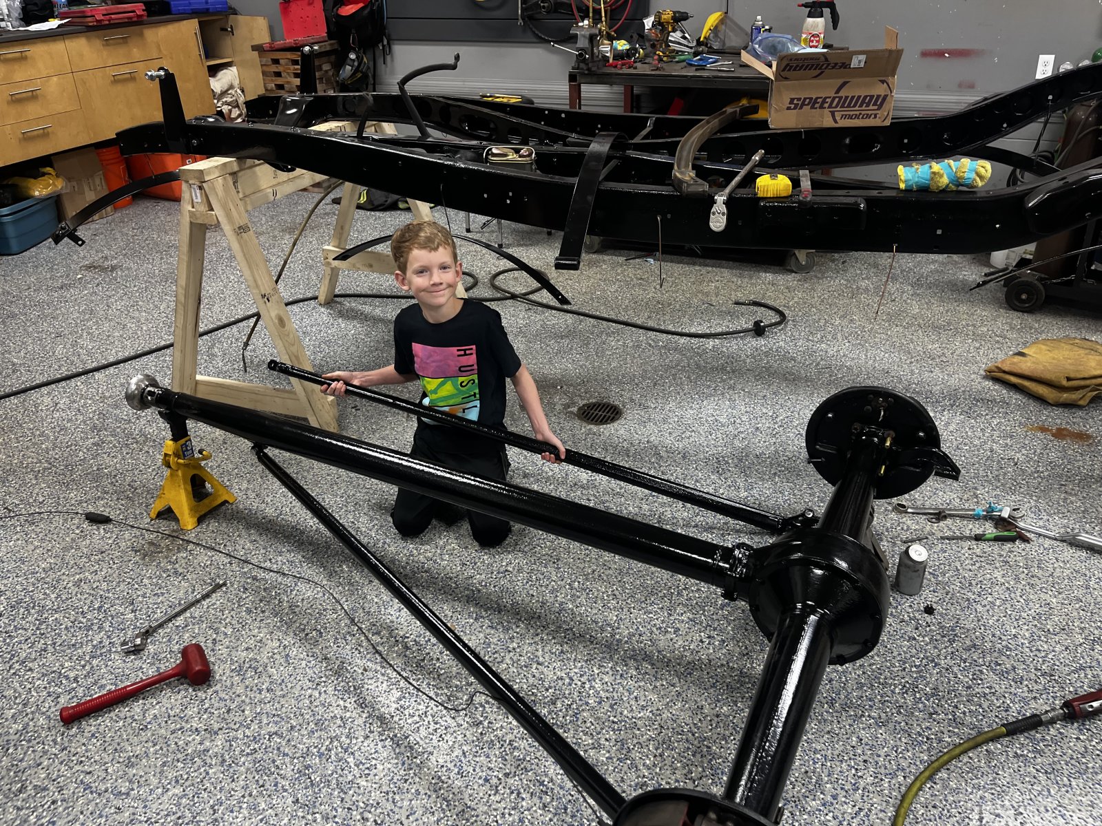

    I have been spending any free time over the winter holidays cleaning up and painting parts. First up was get the front axle apart. The perch pins were very stuck after a few attempts and a lot a heat I was able to get them free and out. Cleaned up and painted the wish bone.

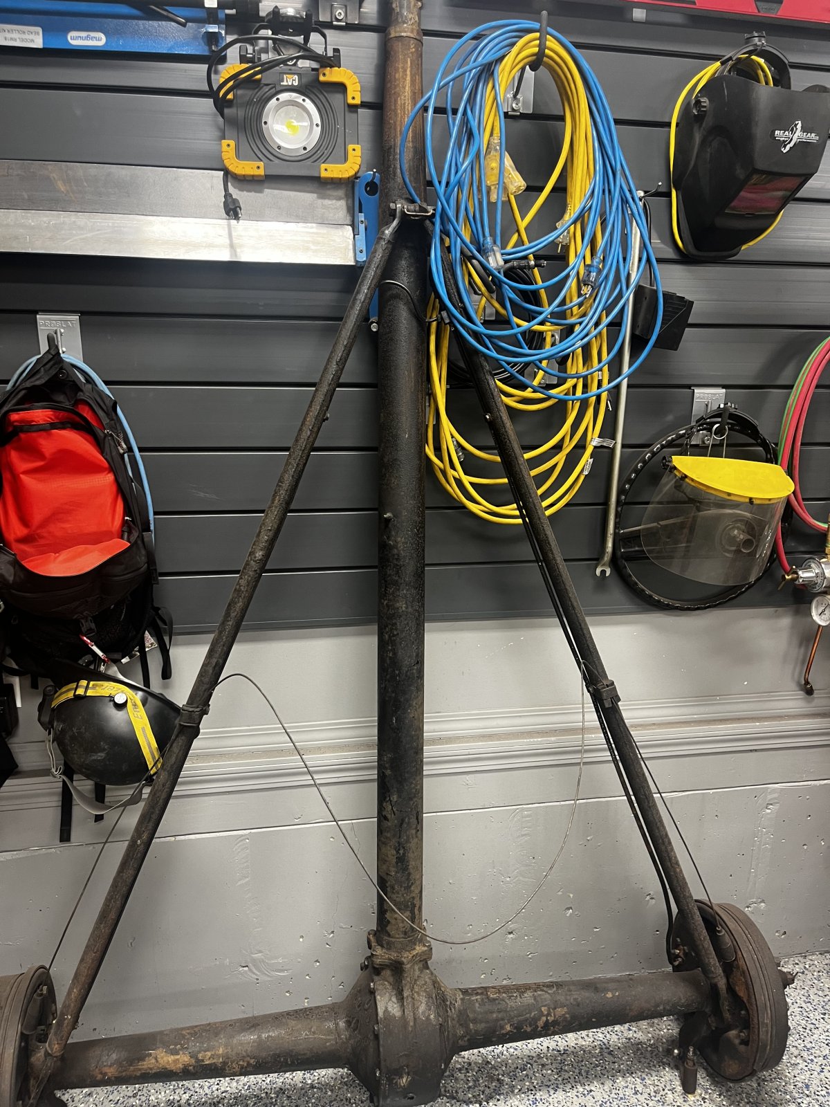

    Pulled the rear axle apart for cleaning as well wire wheeled 84 years worth of rust and crud off it and gave it a fresh coat of paint.
    Same was done with the brakes everything was cleaned and lubed up. I then cleaned up the axle tappers and lapped them together with the hubs for a tight fit. Started putting it all back together with my helper

    Love the last pic! So - you going to put a 5-speed in it for all the long hauls you will be making with the boys/entire fsmily?!

    The plan for now is to leave the original 3 speed to see how that works out.
