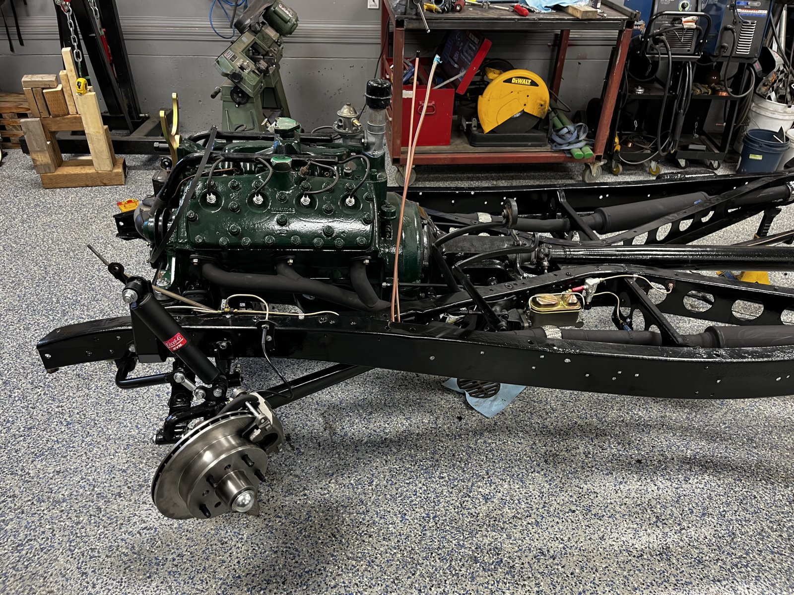

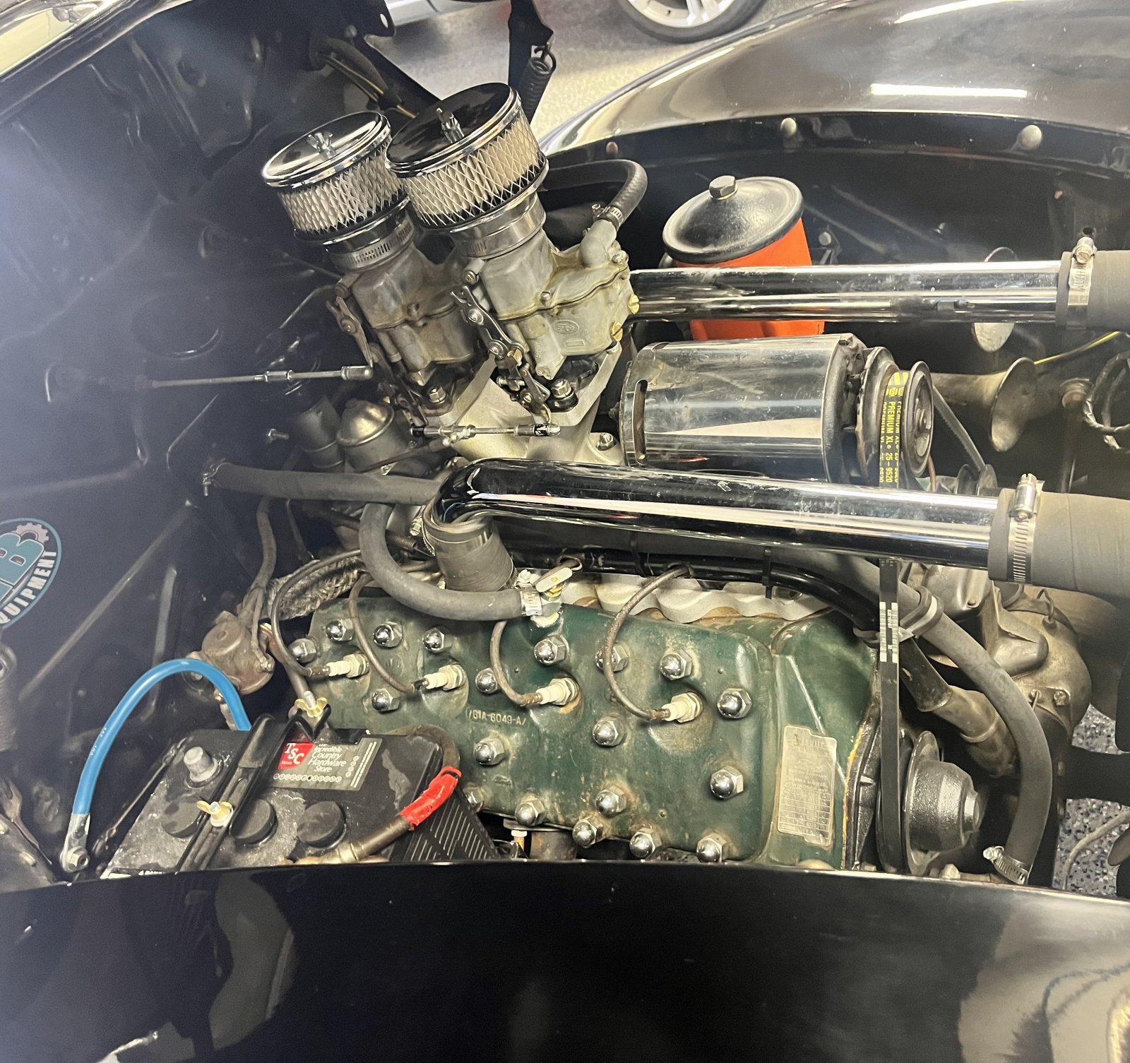

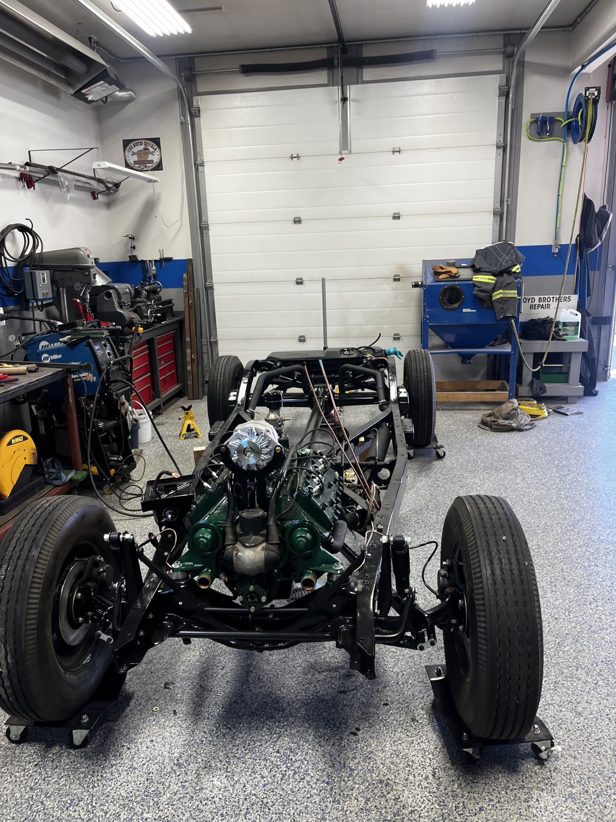

    At my work we have an expression “Big parts win hearts” decided to drop in the drive line today. Looks like I’m close now doesn’t it? Now it’s all the details that chew up time.
    Working on fitting in the @Weedburner 40 shock kit. He makes a very nice product a few minor clearance modifications needed to get full shock travel (axle touching the frame) as close to bolt in as one could expect

    The PO put a Edelbrock Sling shot intake on it that’s sitting up on the self. I figured it would be easier to get it up and running with the signal carb first before you introduce a dual carb set up doubling your variables.

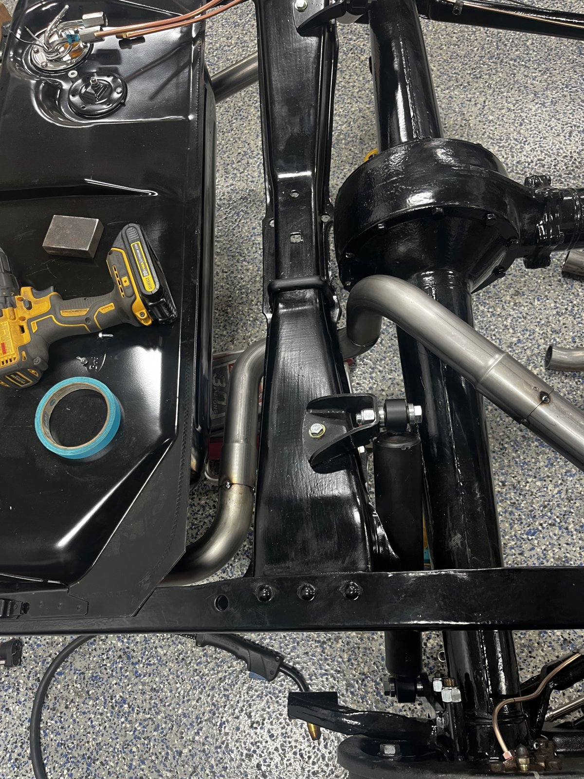

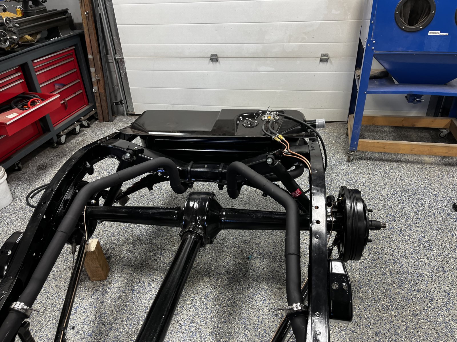

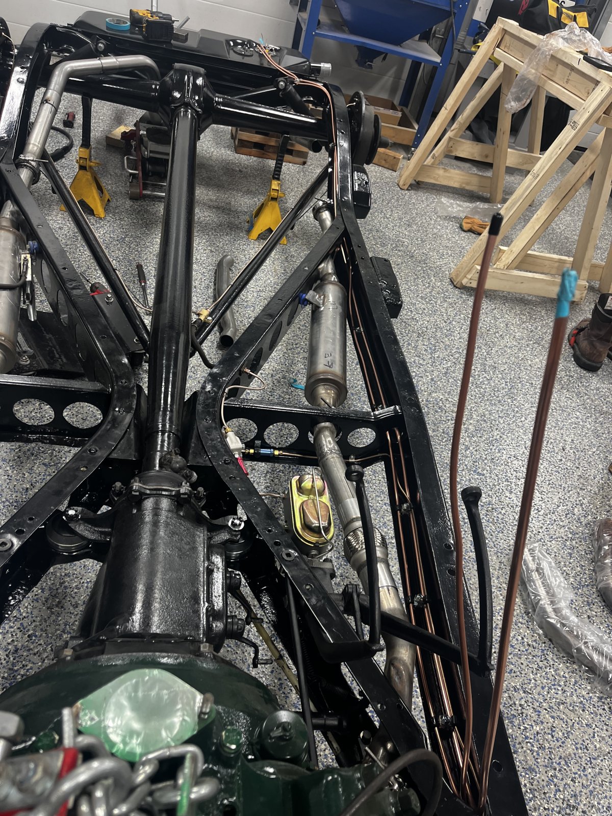

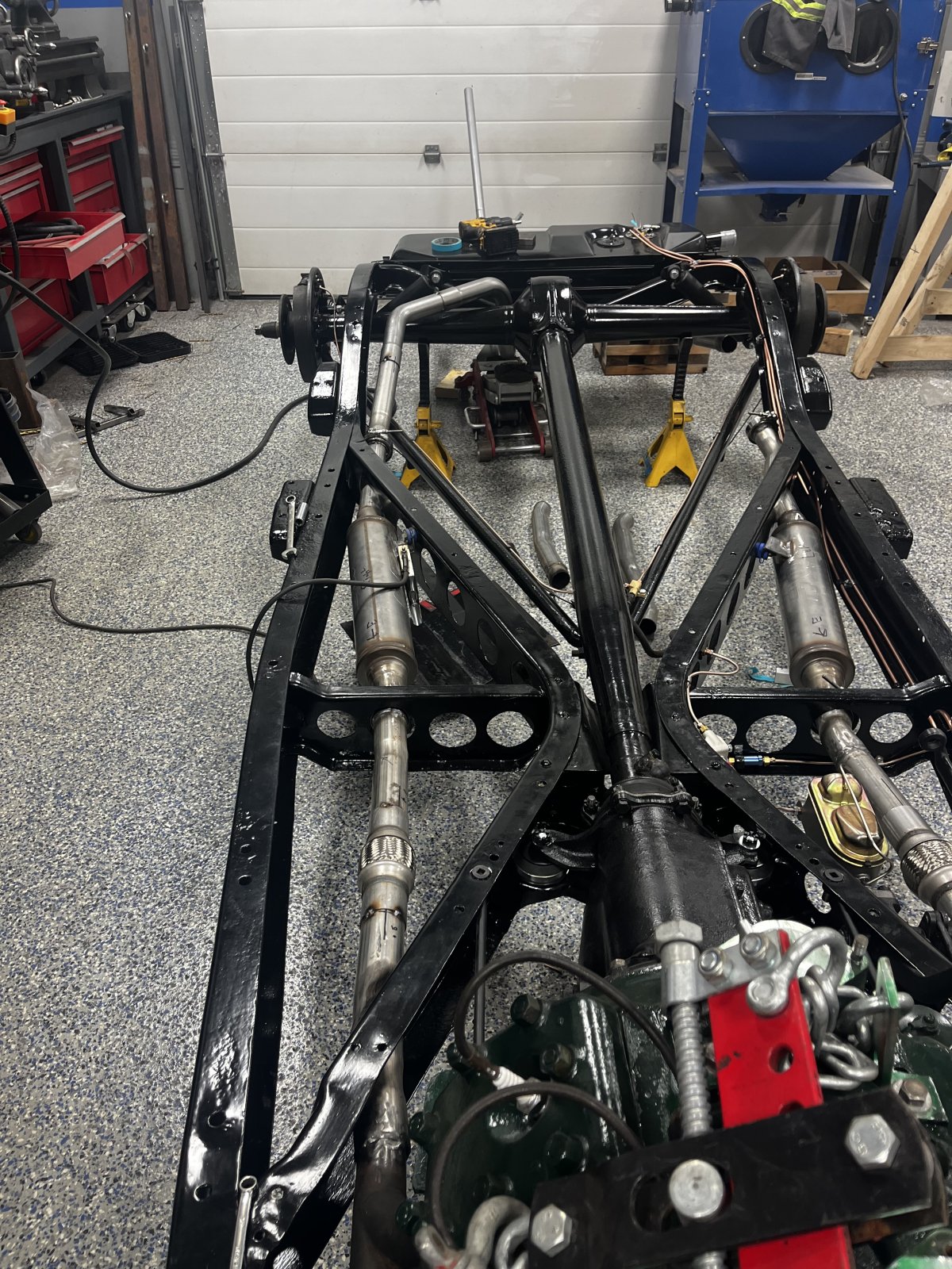

    I have spent the last few weeks on plumbing the car again. I installed new 5/16” fuel lines including a 1/4” return line so I can hopefully avoid Vapor lock by having a venting fuel filter.

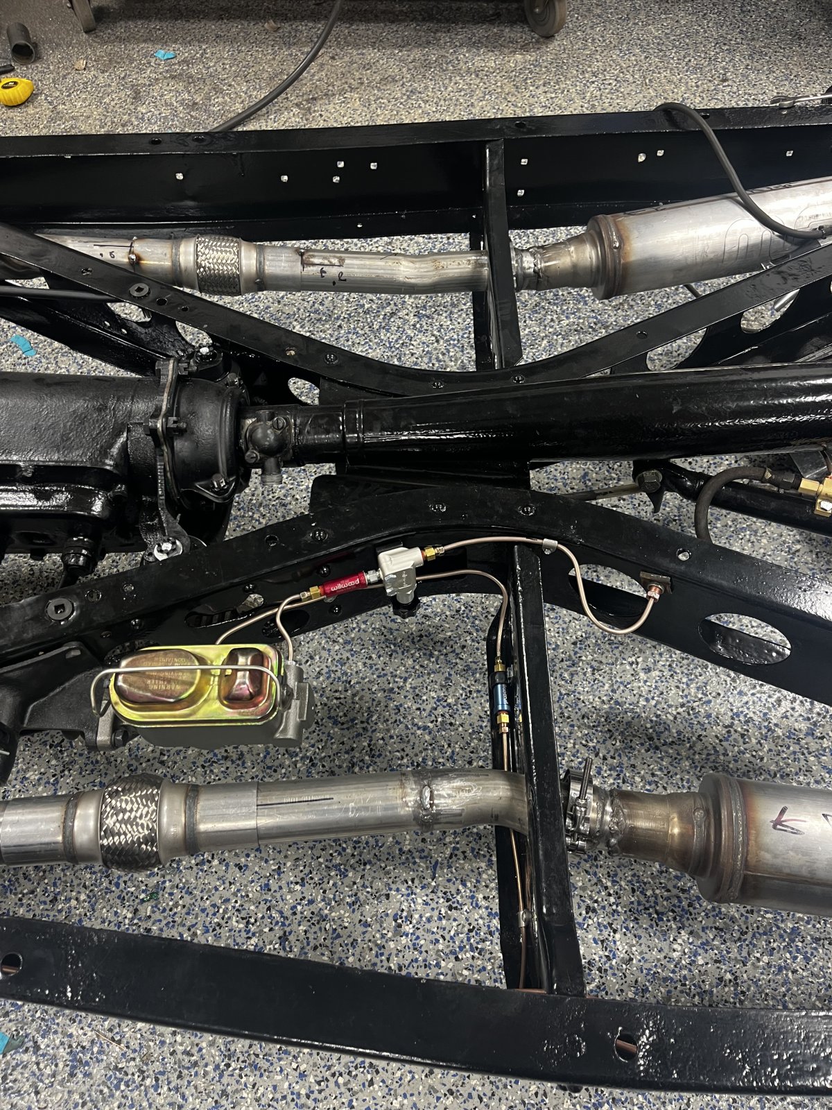

    Brake lines are going in with a dual master
    Along with trying to fit my exhaust system back in that I had to cut into 3 pieces to remove. My new tube shocks take up the space where the exhaust routed over the axle so I’m having to route it over the axle and then under the spring to get out to the back of the car. Slowly it’s going back through together. I have added some flex joints and V band clamps so I can remove the exhaust if needed once the car is assembled.

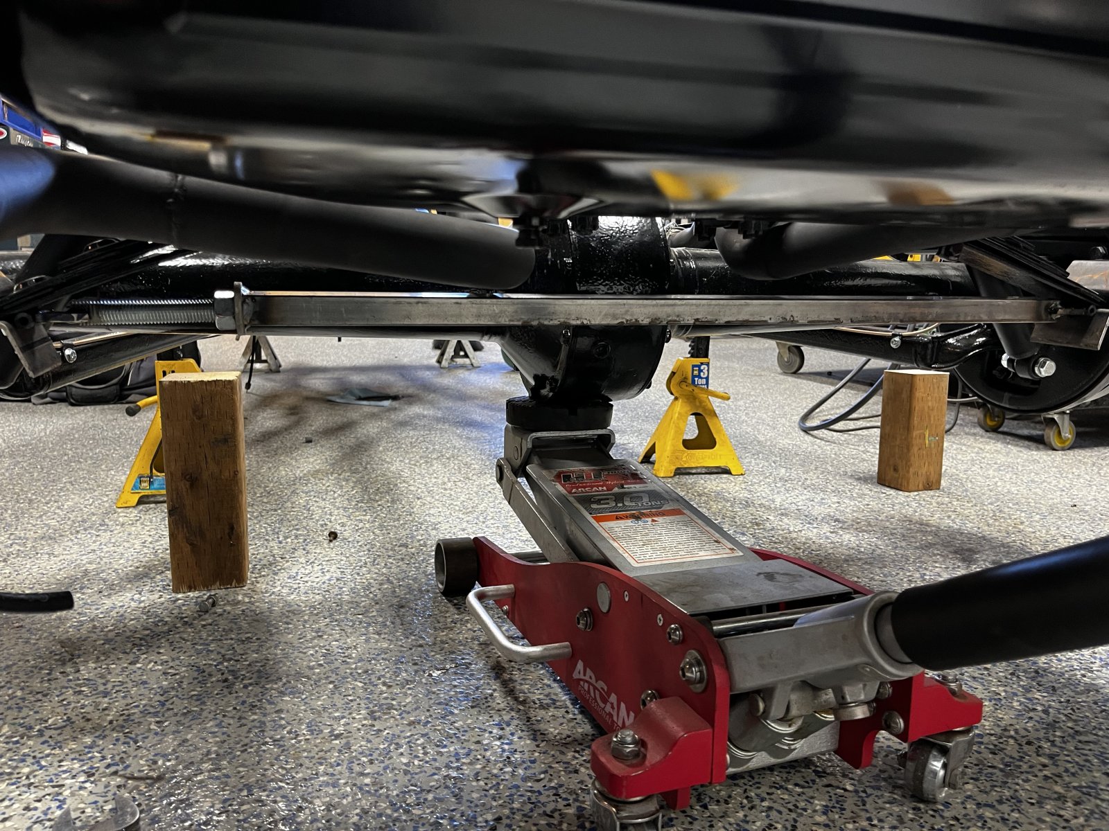

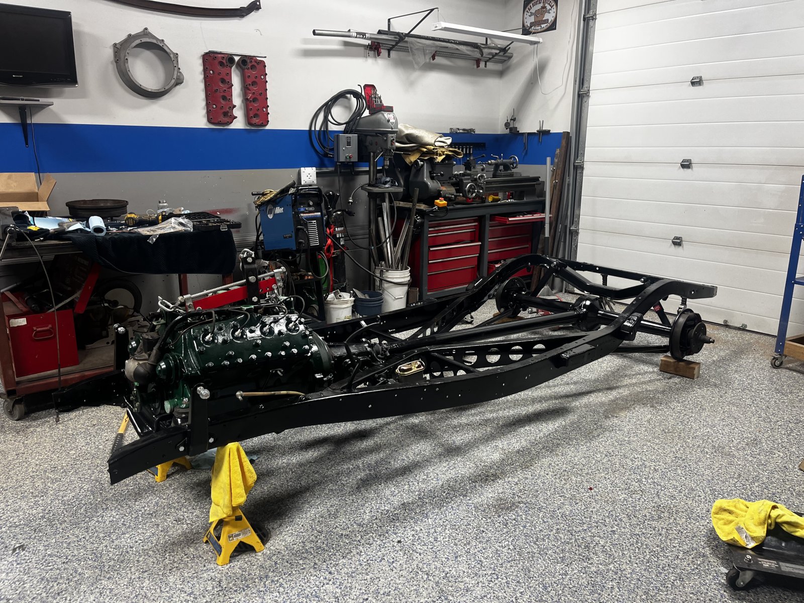

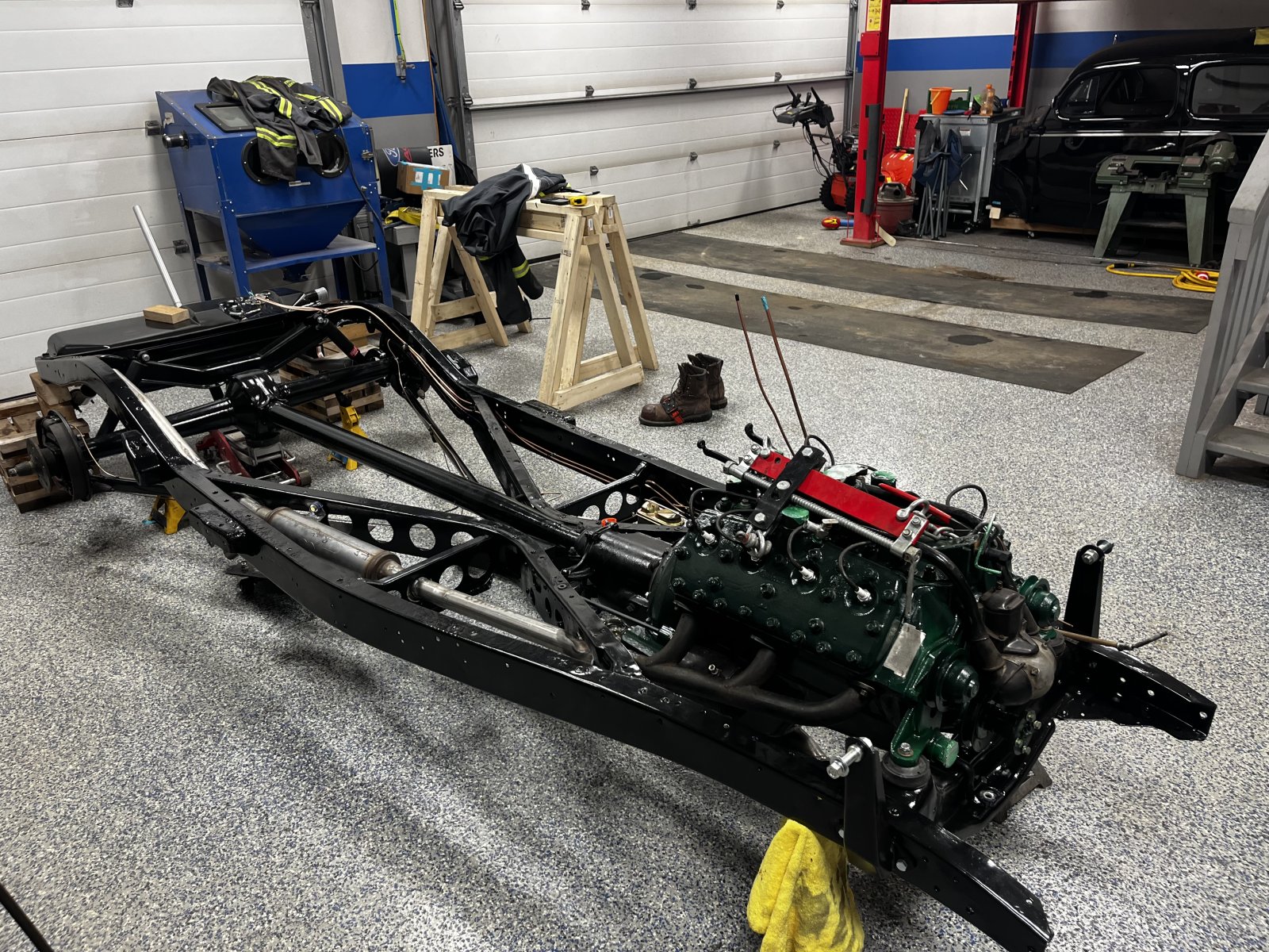

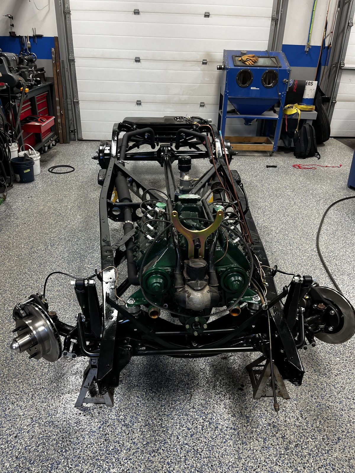

    The frame is almost back together. Waiting on my rear spring shackles to connect up the rear spring to make it a roller again. Exhausted is modified now to fit with the shocks. New fuel tank as well as the old one had a bunch of brazed over pin holes and filled with rust.

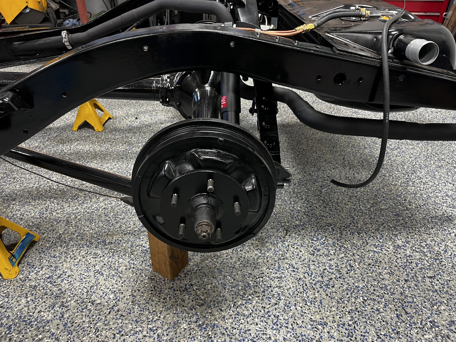

    I was able to remove the wrong wheel studs the previous owner installed and tried to weld into place for some correct press in studs.
    I put the front brakes together and bleed out the system. The front brakes are the Roadster Supply disks. No major complaints had to grind a few areas on the calliper due to it was just touching the disk and create a notch it the casting to get the brake lines pointed in the correct direction. Weedeater supplied shocks and sway bar.
    Few more small details then hopefully bring the body over and start on that project.

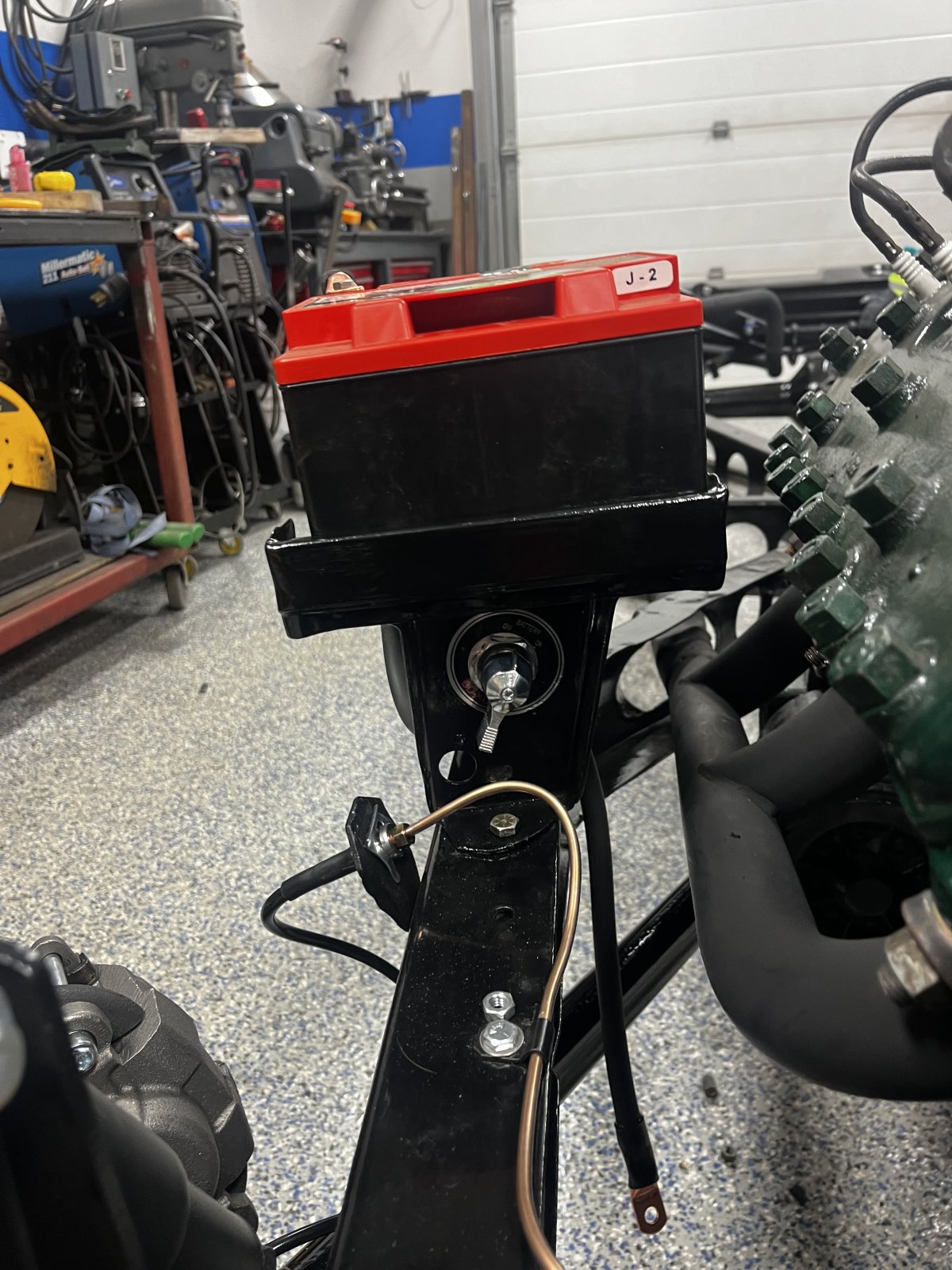

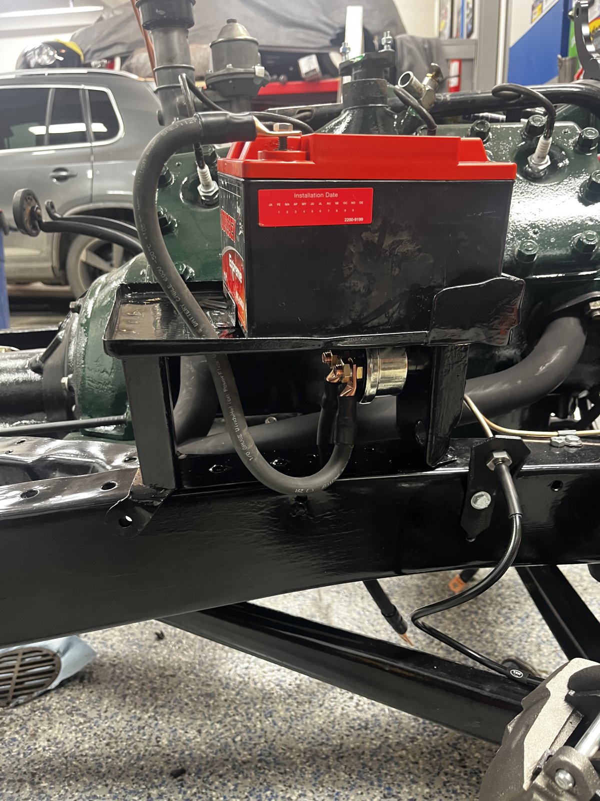

    The work continues on the frame I Put the original battery mount back in but installed a cut off master switch under it. I made up my ground cables to the frame and to the engine to connect everything.

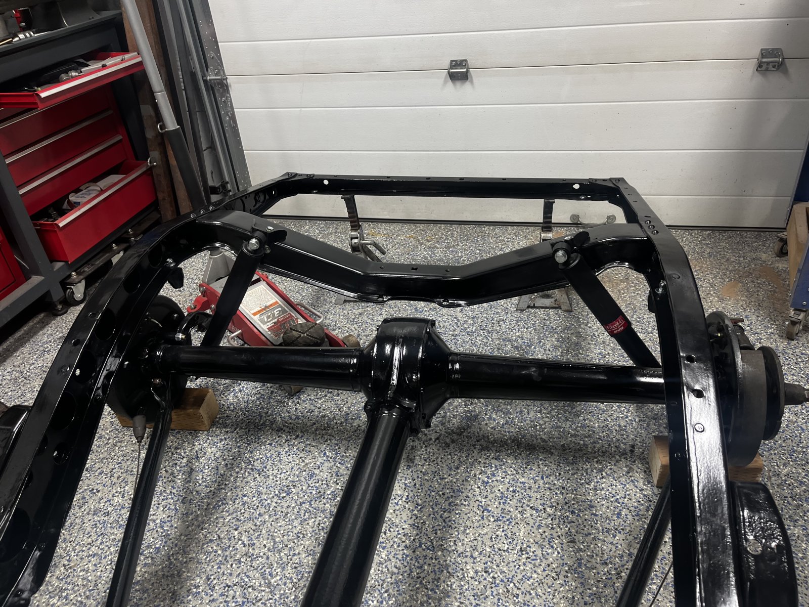

    I made up a spreader bar to install the rear spring. With that I now have a rolling frame again.
    Next up is to fix some issues on the body before it all goes back together

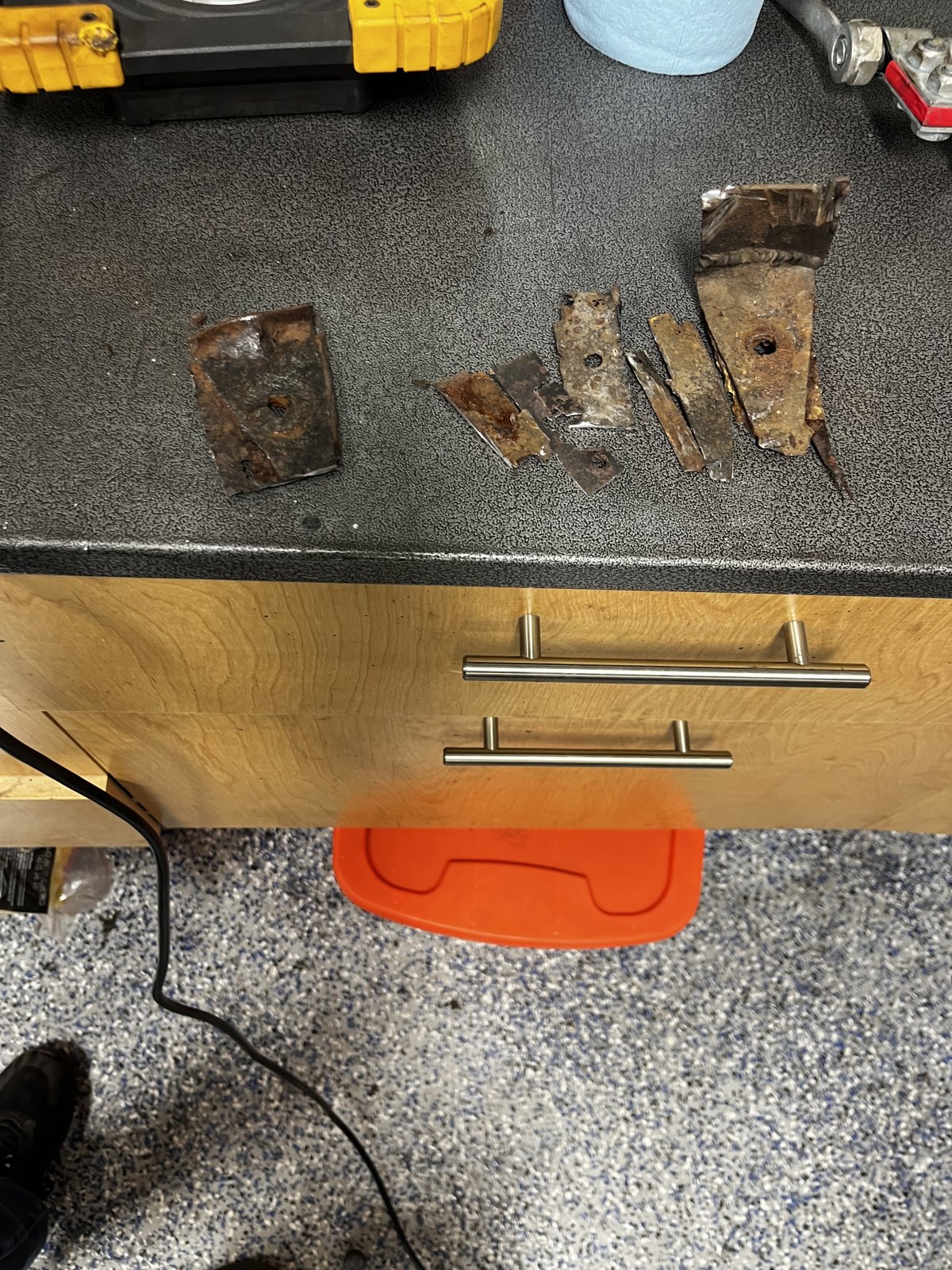

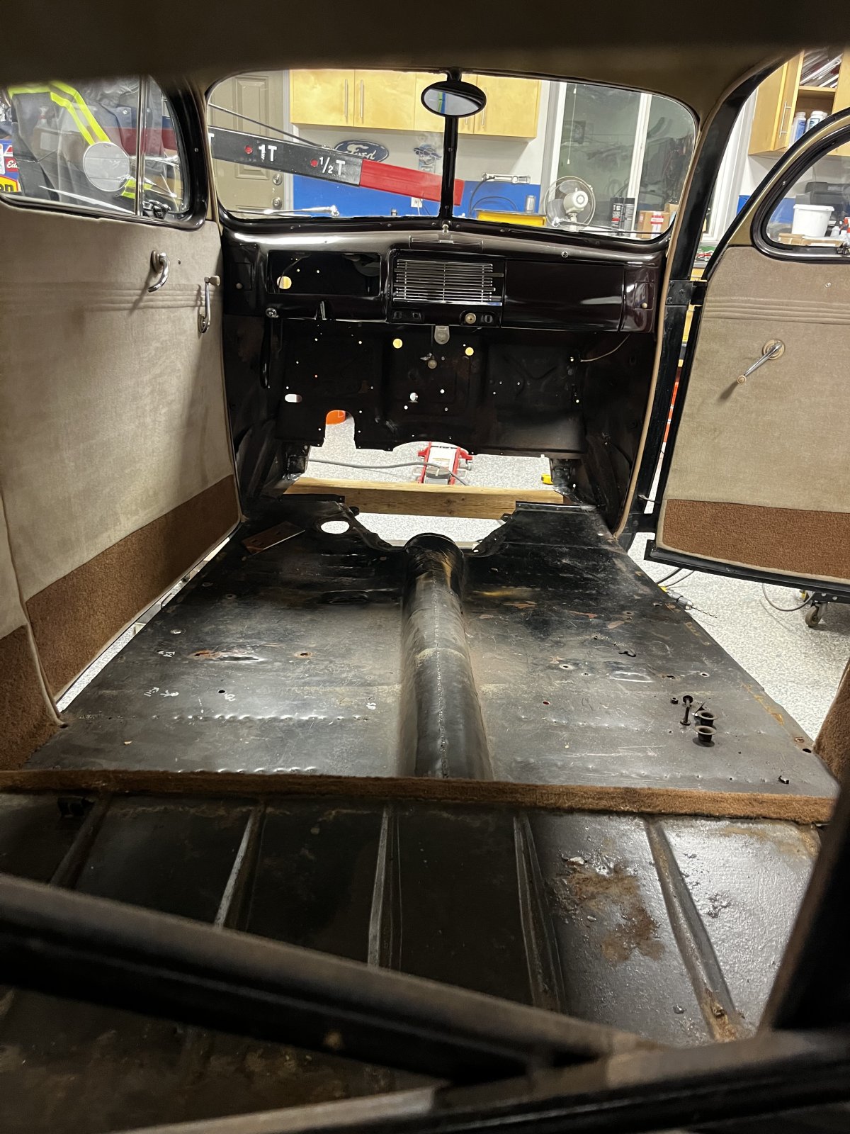

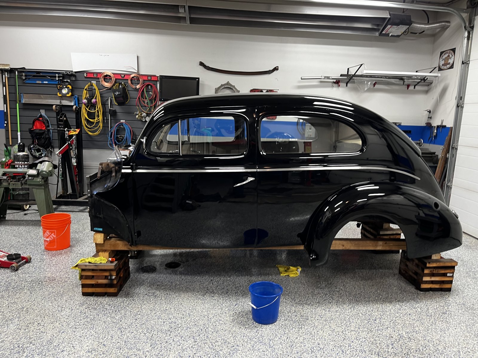

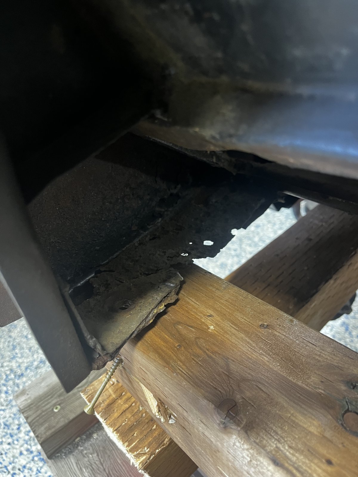

    Time to tackle the body. The unfortunate truth about this car is that it was an extremely rusty car somebody spent a bunch of time in the 80”s “fixing”. What I have discovered was a bunch of overlapping patch panels over Swiss cheese.
    So a decision has to be made do I spend the next 5 years stripping the car down to metal Fix everything last thing properly? Then cash out both my kids Education fund to pay for the paint job. Or accept the car for what it is and get it on the road. I’m not competing for a Riddler award just wanted a cool Hotrod to get ice cream in with the family. I figured the work may be sketchy but Hell it’s lasted probably 30 years already. From the outside the body looks okay especially with the shined up old black paint no bubbles or rust coming back through on the outside.
    So my plan is to fix any structural issues around the body mounts. Rust paint the what is there, Seam seal it, then pretend like it doesn’t bother me deep down inside and get out and enjoy the car.

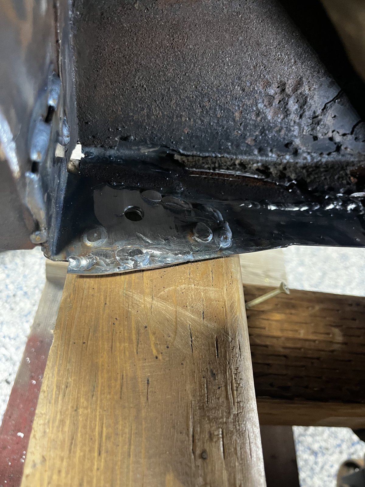

    Staring from the fire wall and working my back. First up were the front body mounts. Drivers was cracked very thin. So cut out the old and in went some new steel.
    Passenger side was next. This one had been “repaired” about %70. With the body off the frame I was able to cut out the bad original part and weld in a new mount. Now to just keep going back until I get to the tail pan.
