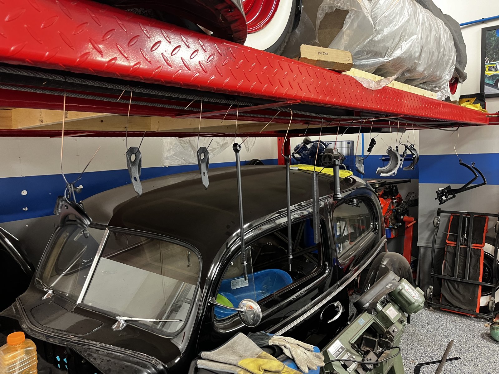

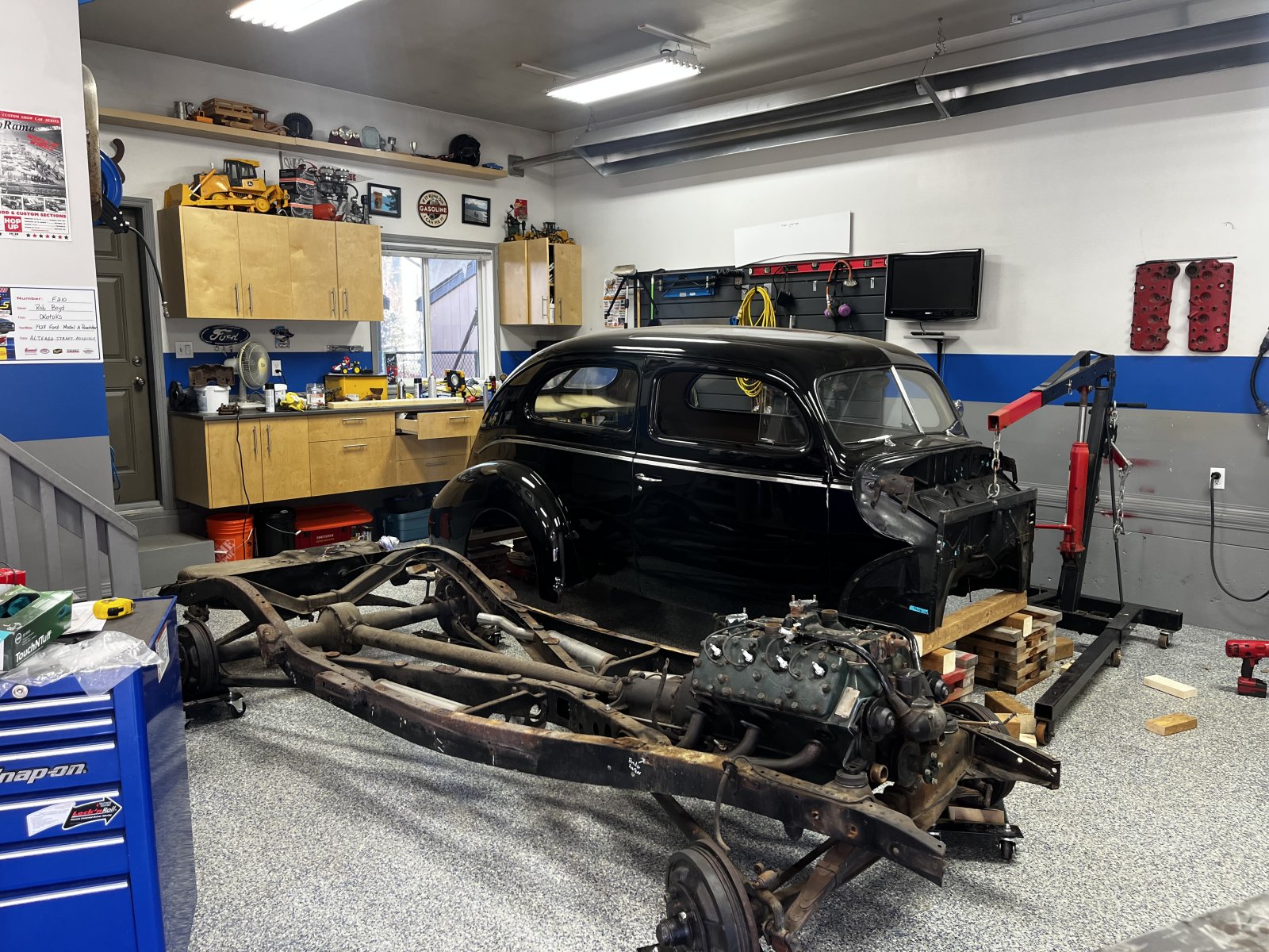

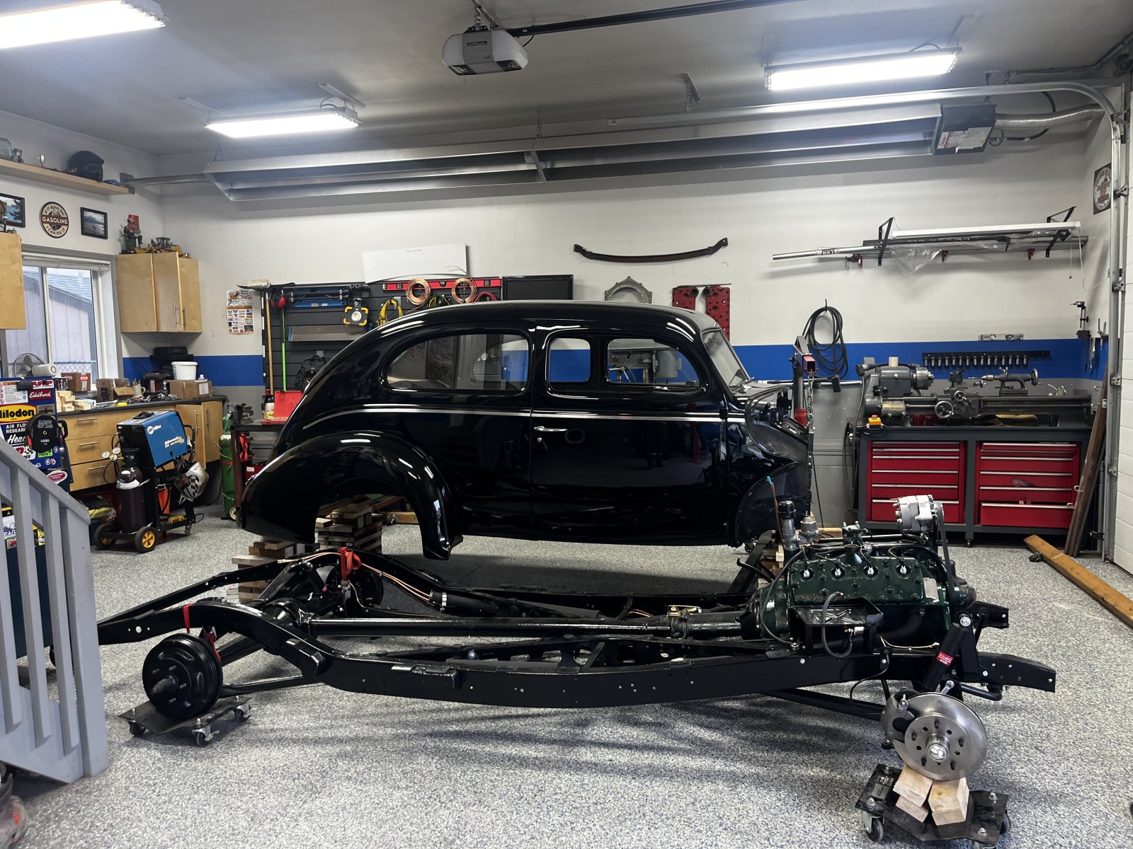

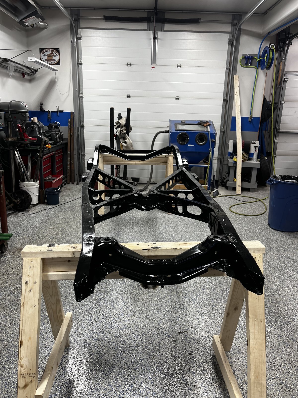

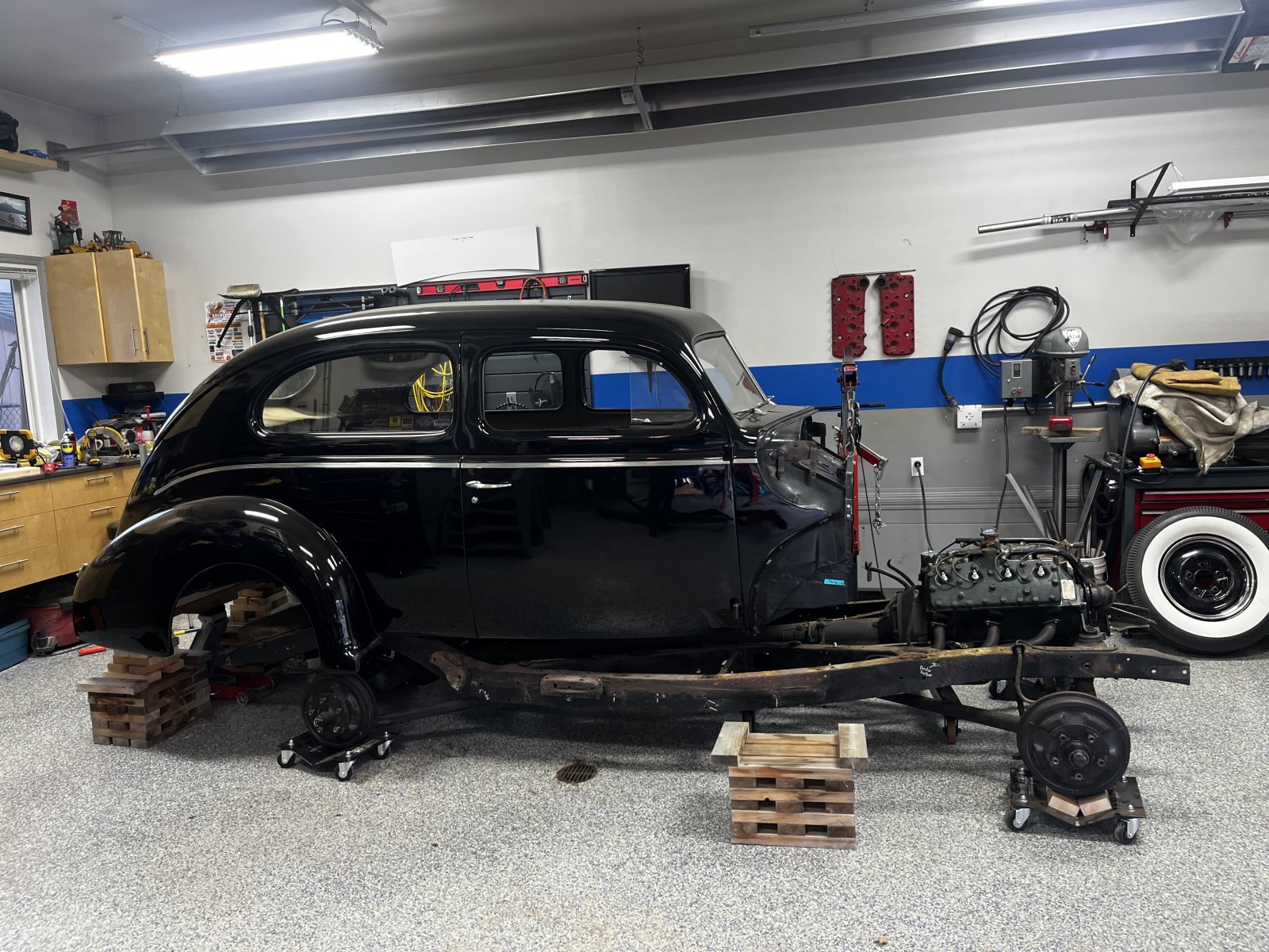

    Well the underside is “fixed” far from perfect but it should be solid now. I have hidden many sins under POR15, Seam sealer, and undercoating.
    Had a friend stop in this morning he lended a second hand to get the frame under the body. Very nerve wracking but it’s down now.
    Next up is install all the hardware and rubber isolators

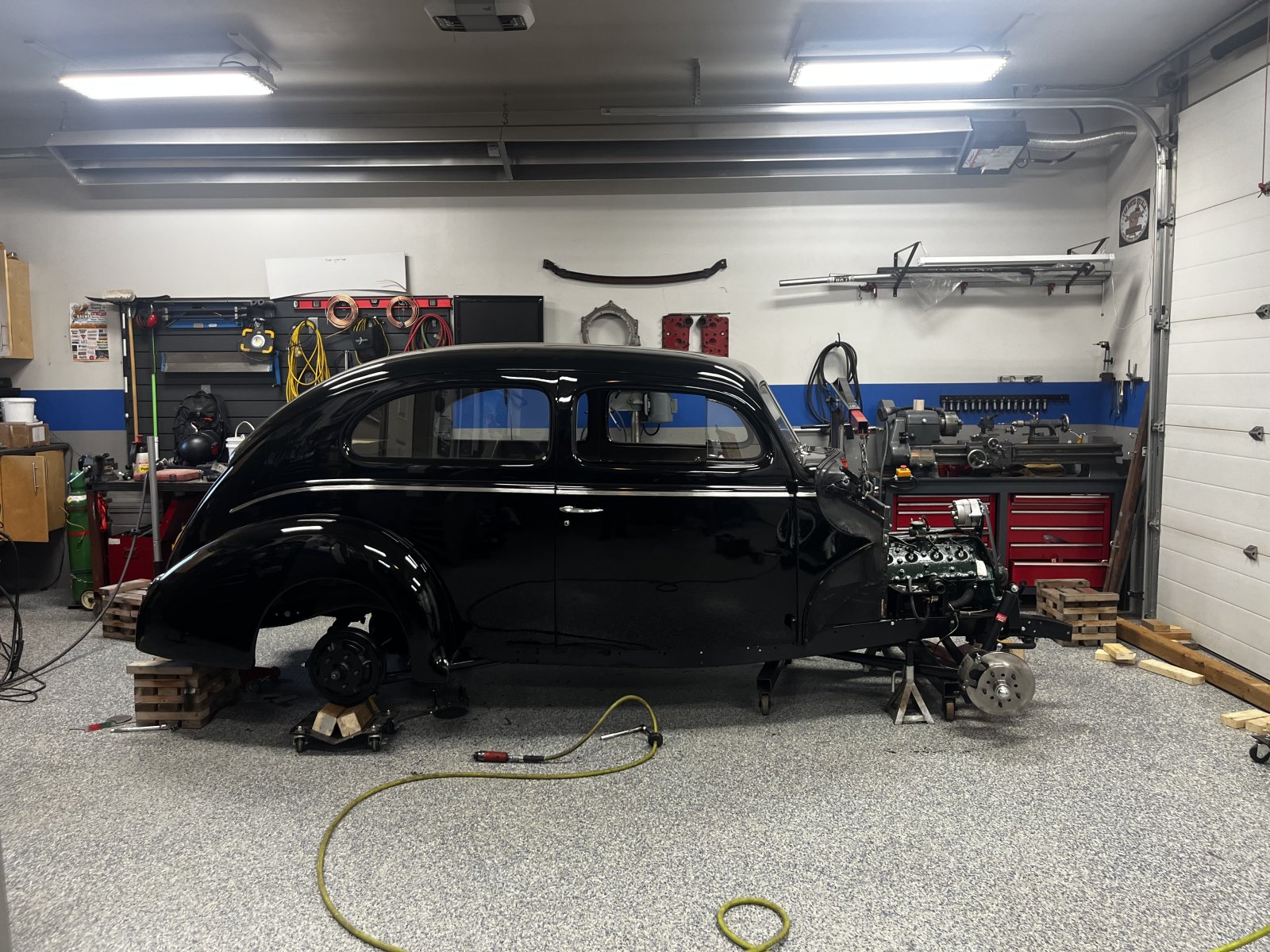

    Body is bolted down now. Doors seem to work even better than before. So I will take that as a win.
    looks like my new drop spring dose not have as much as the original with 4 broken leaves so hopefully that settles out a few days inches

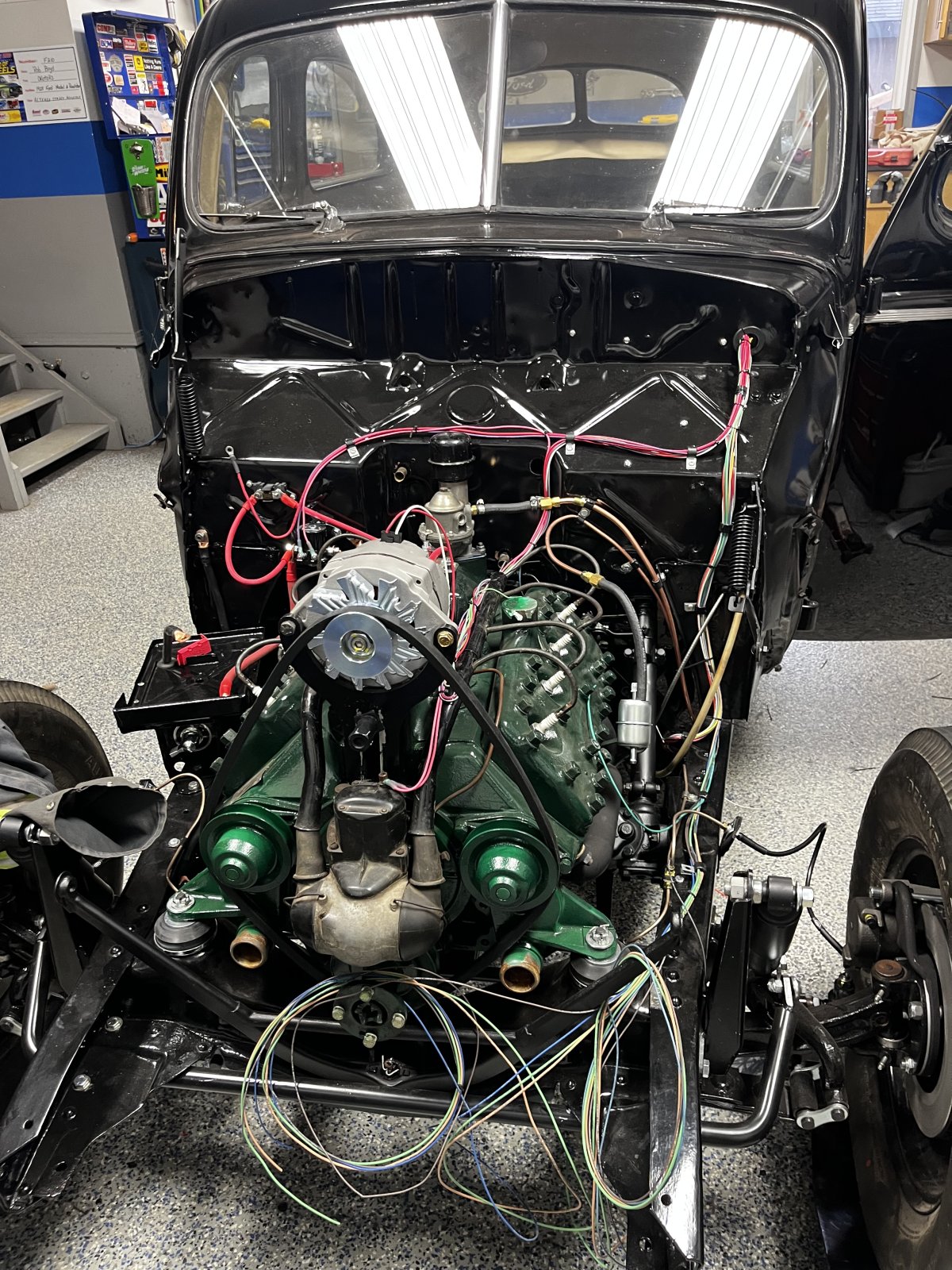

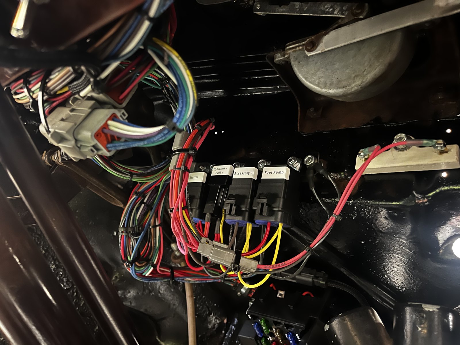

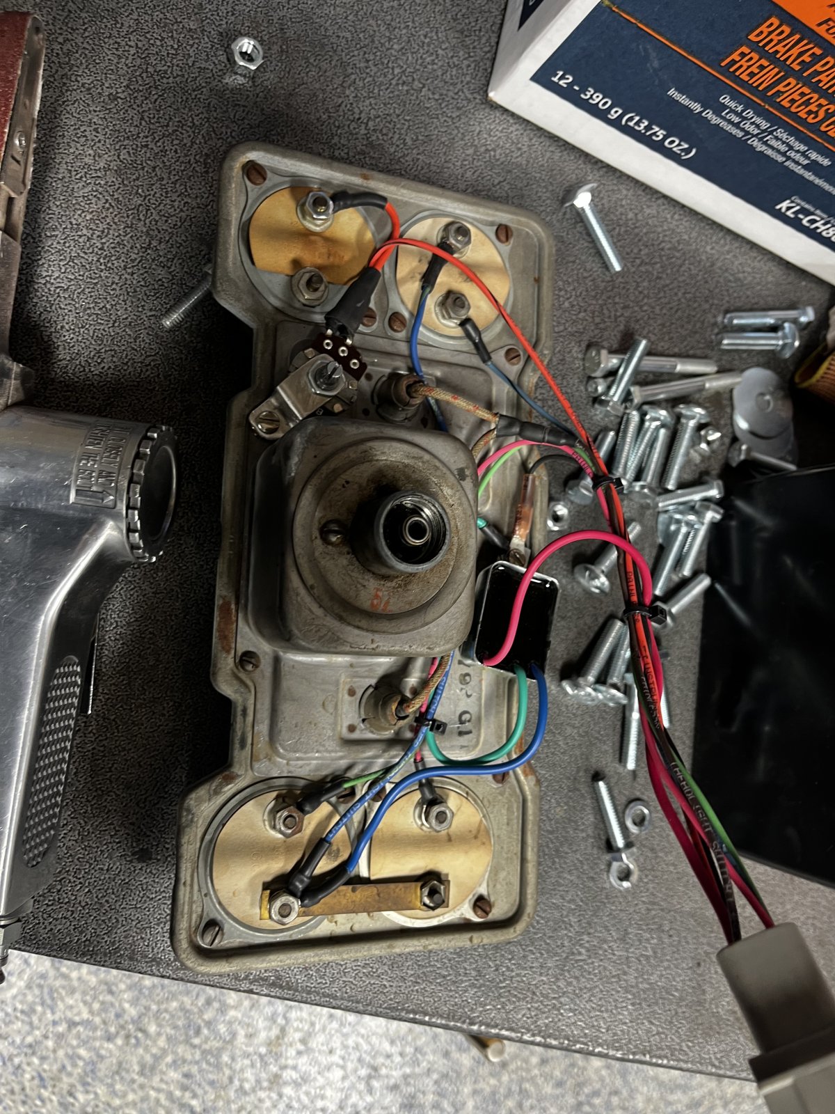

    Next up on my list is laying in the harness. I’m running a universal painless harness. Same one I used on my roadster. Having to make some modifications to keep the original ignition switch and starter ****on. To do this I’m just using the factory switches to control relay.

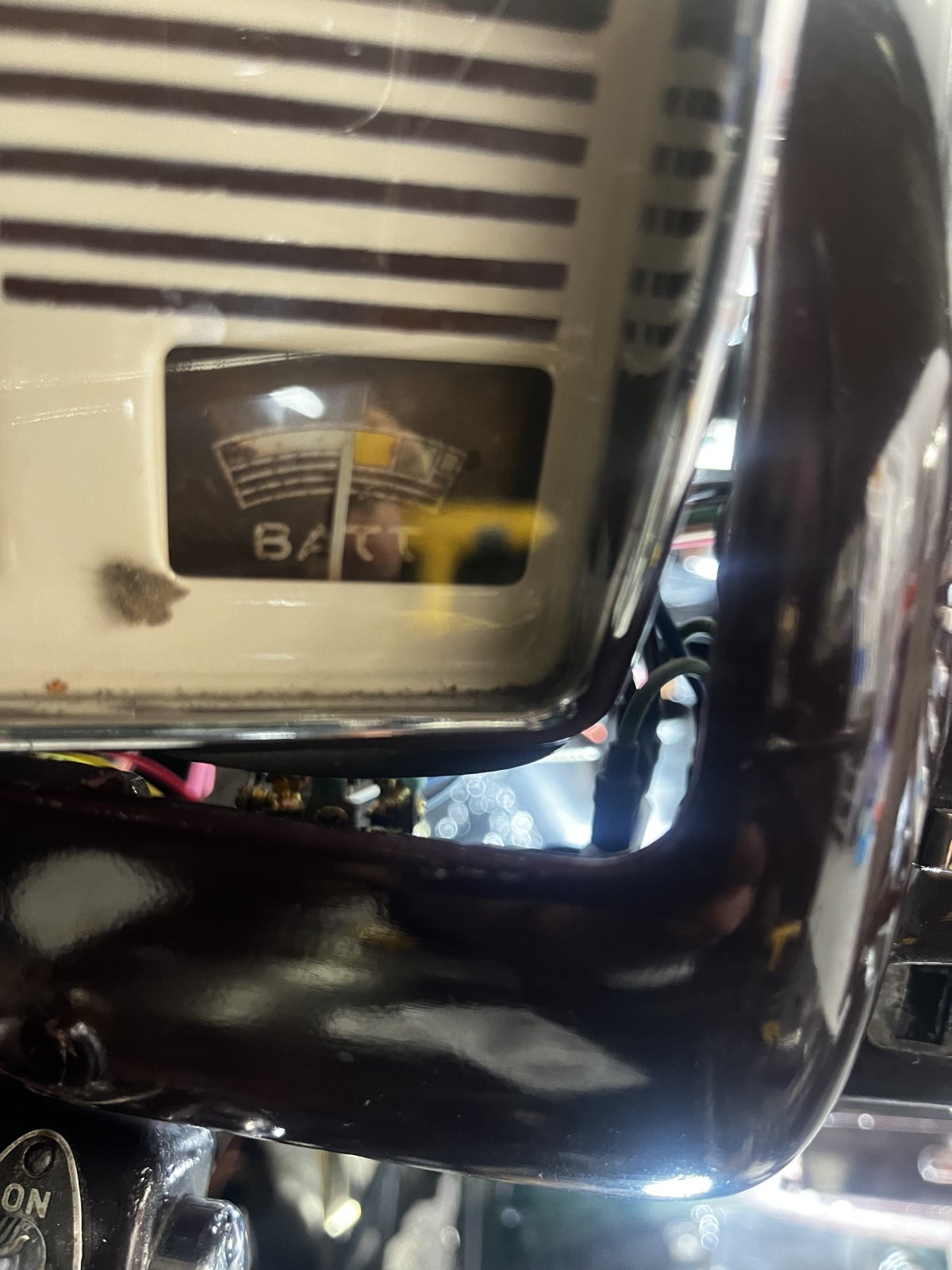

    The gauge cluster is a bit of a science experiment. I have a 12-6V converter for the gauges but I wanted to keep the battery gauge working. Doing some reading it was advised to run a 60 OHM resistor in line to drop the voltage to the gauge. Instead I installed a 0-100 OHM adjustable resistor. This way I was able to dial in my reliance. 66 OHM Seems to put it just hello the yellow so hopefully with the engine running @14V that will push it into the green.

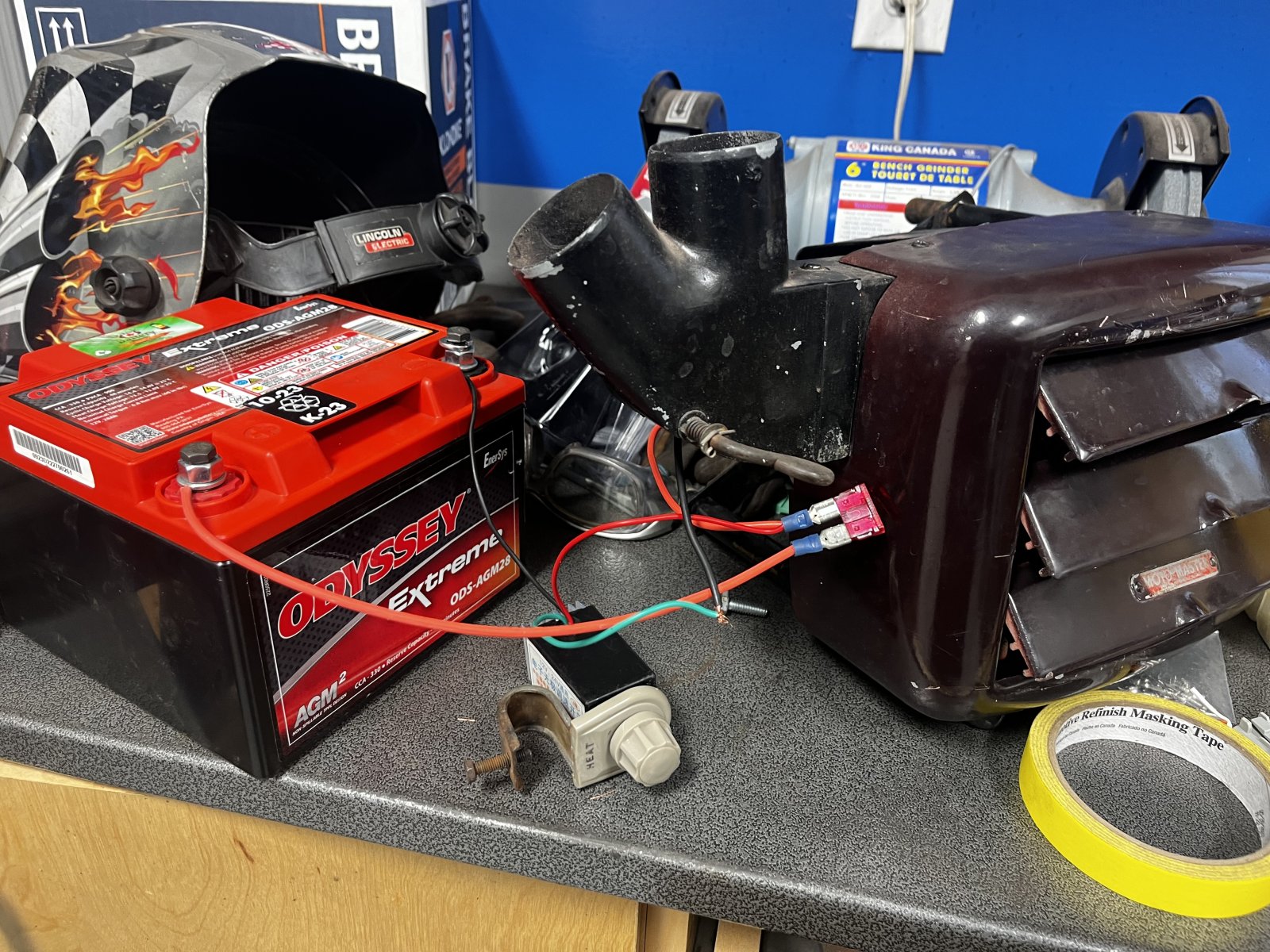

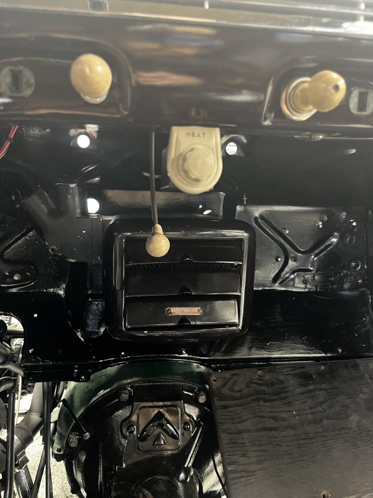

    Next up was the heater. I used an Amazon 10A speed control so I have full fan speed adjustment. I mounted in the original bracket and adapted on the face plate and knob.

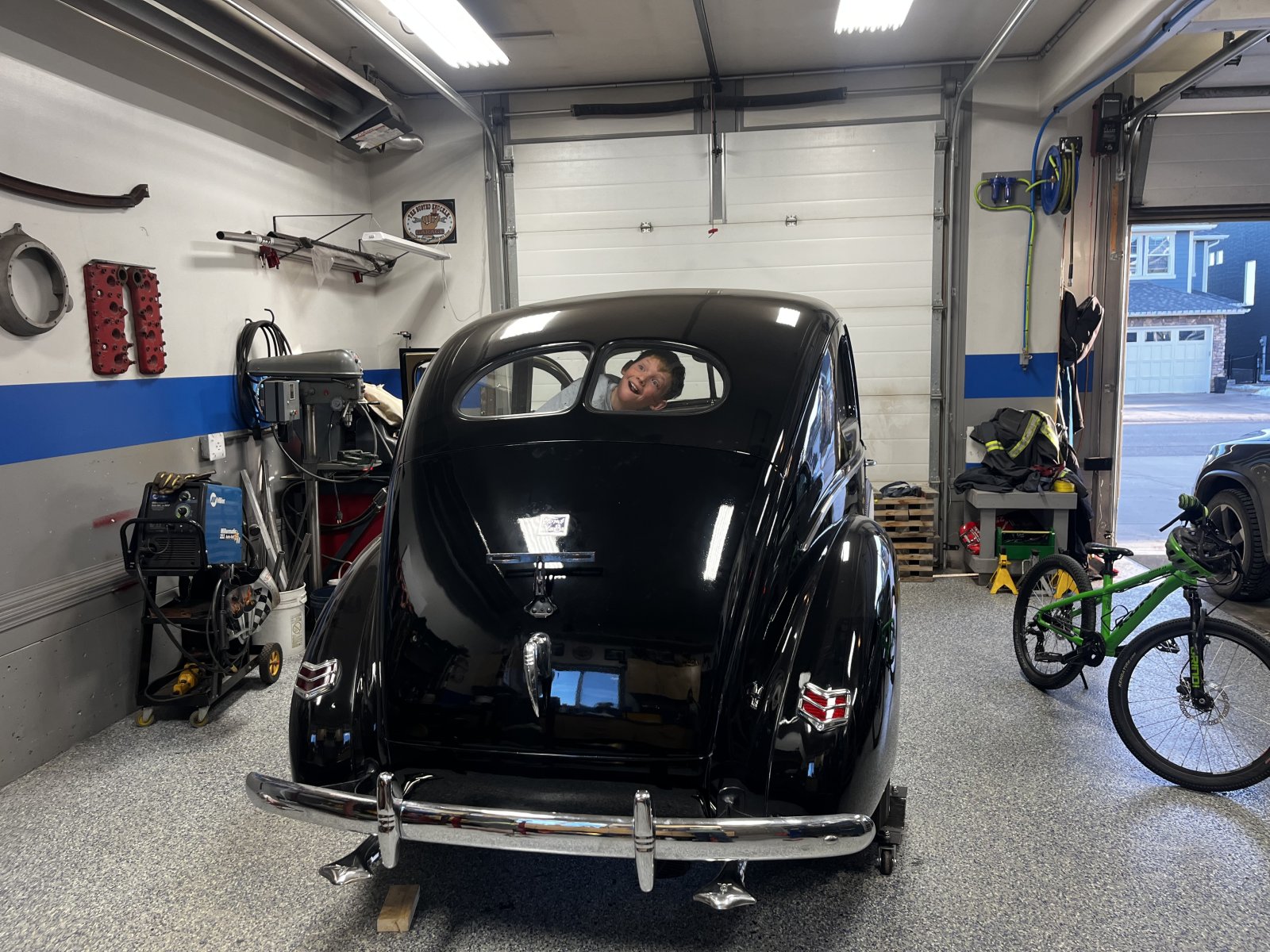

    Thanks the benefits of a long winter is extra time in the garage I guess. Shooting to have the car on the road for May.
    Back seat installed with 3 seat belts and all the trunk panels in today.

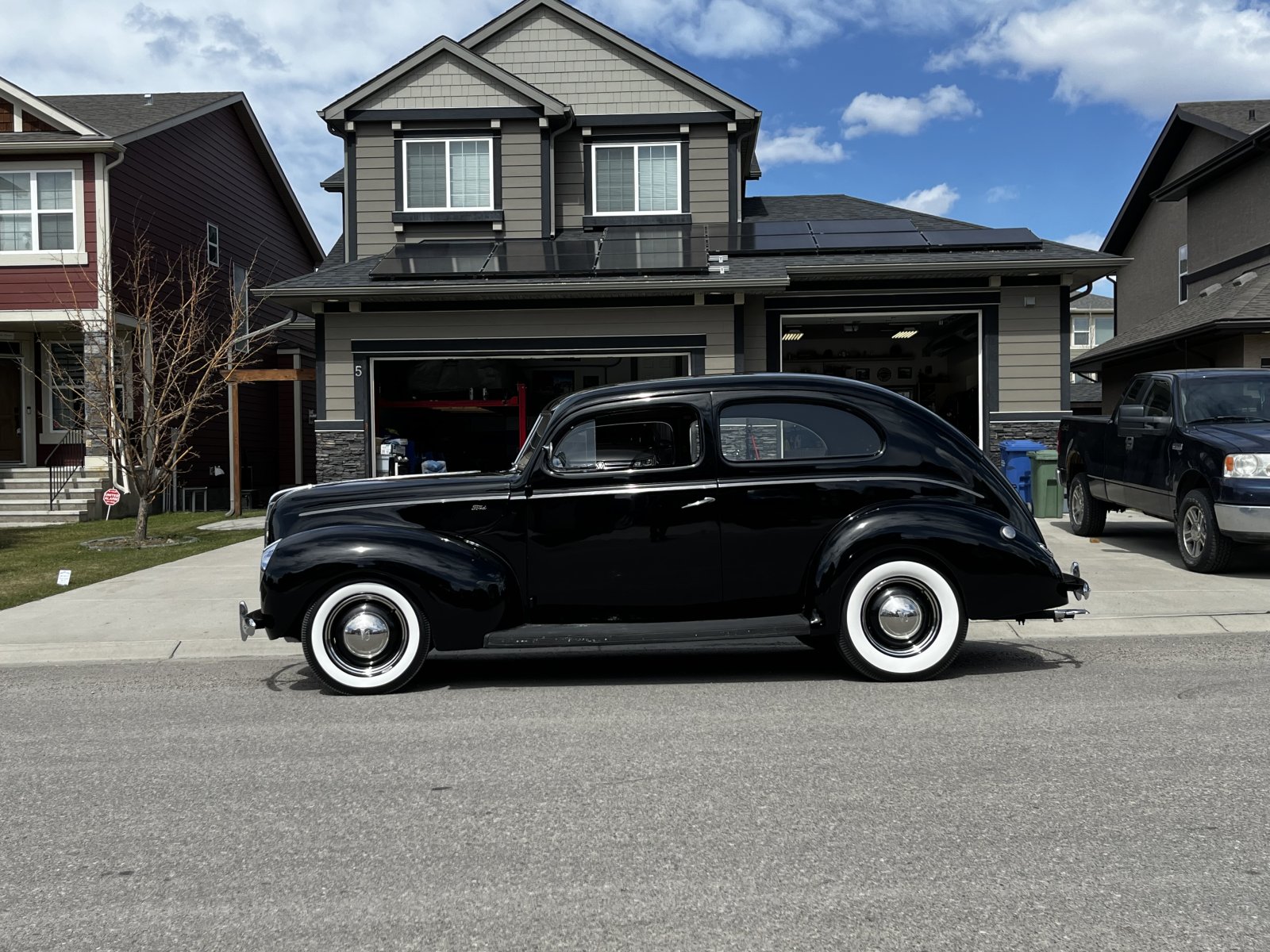

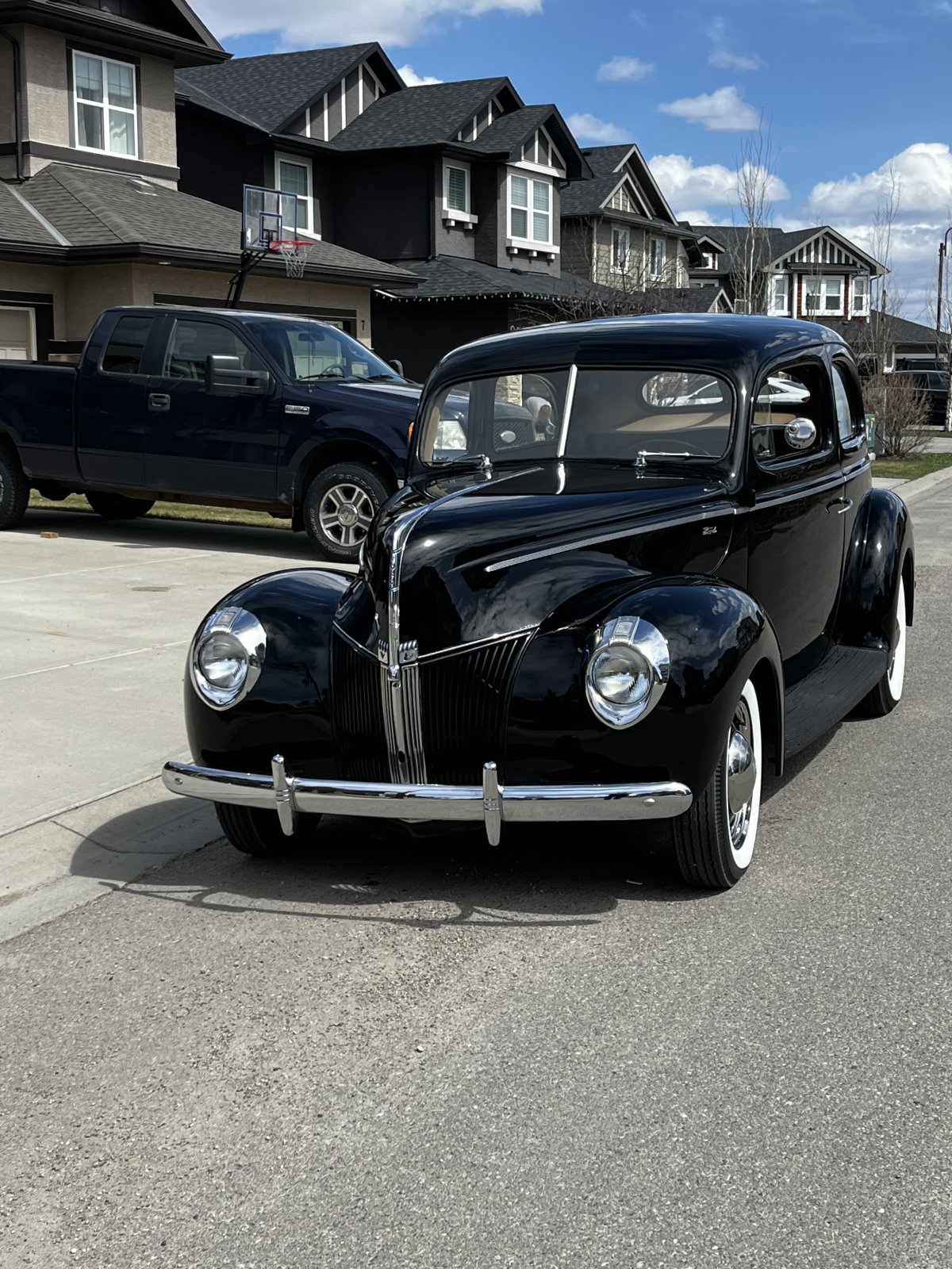

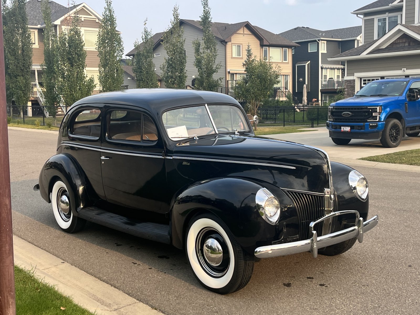

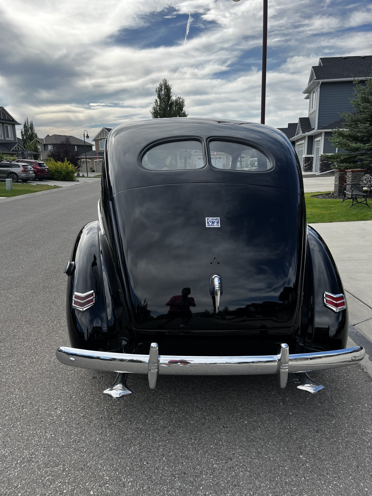

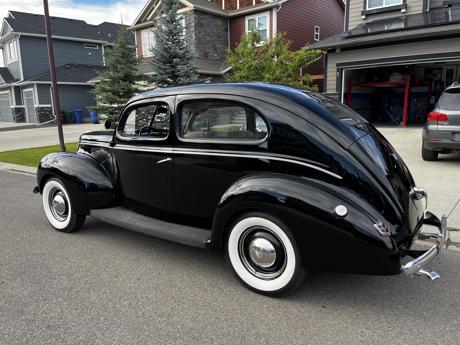

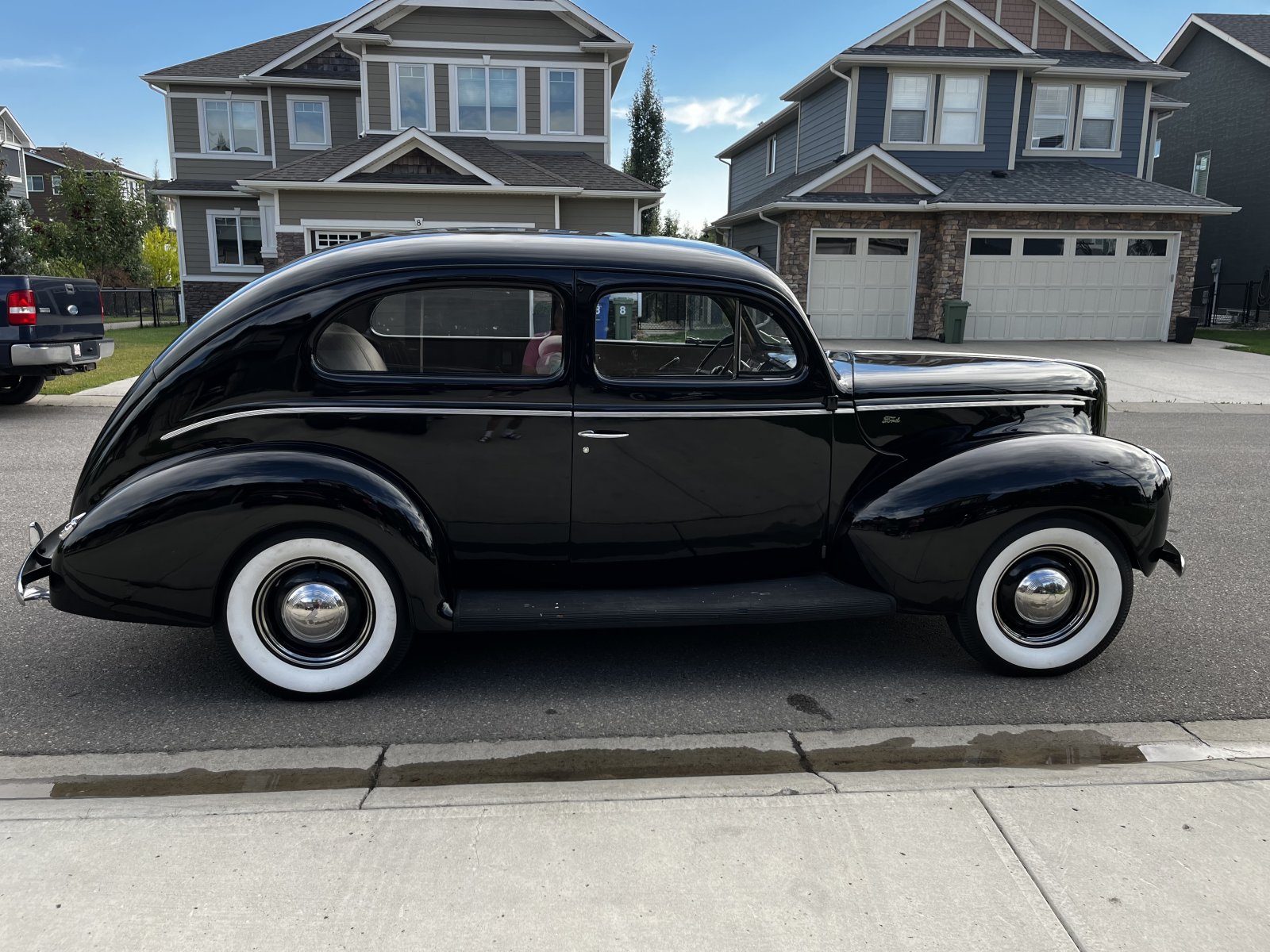

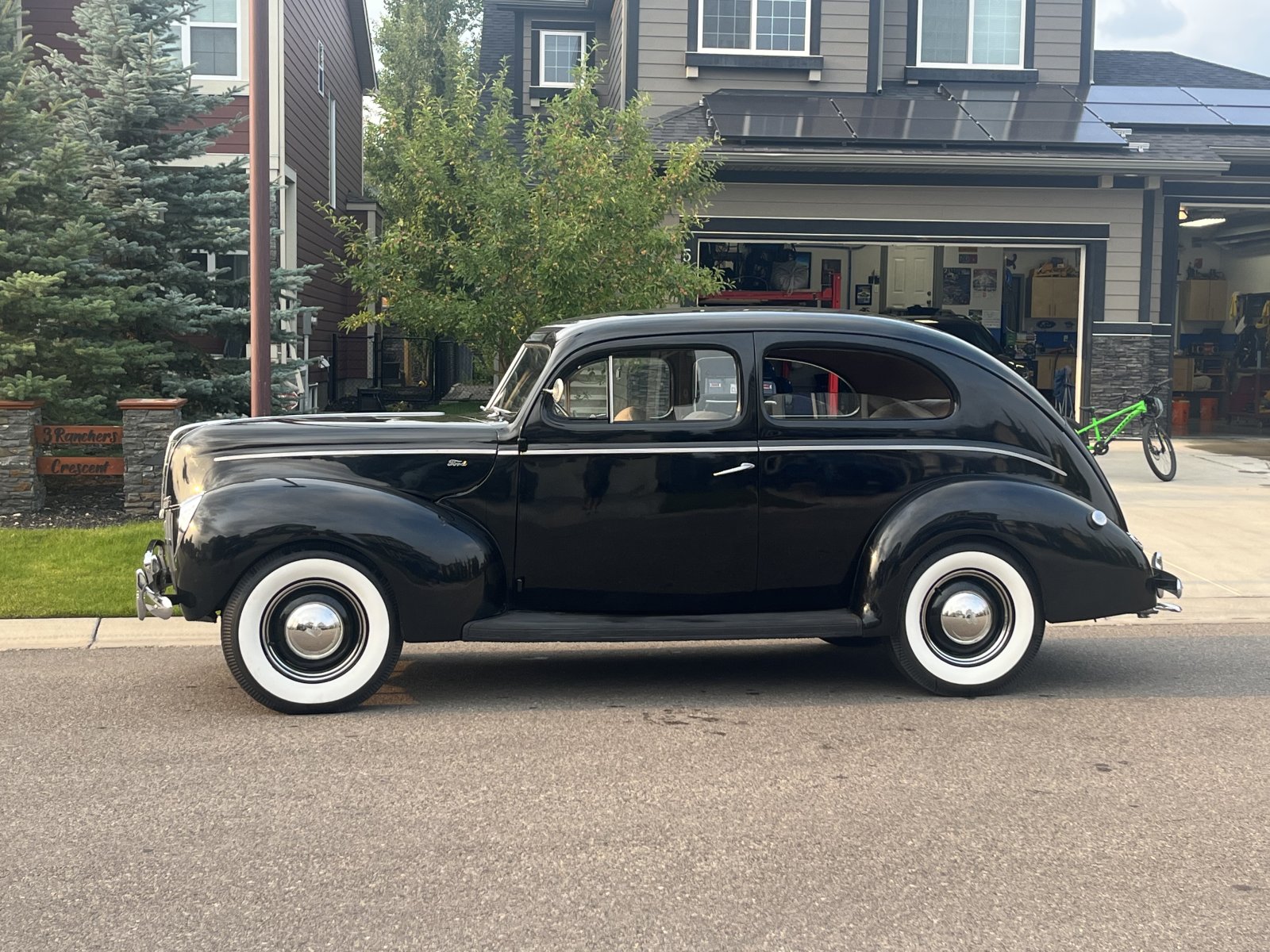

    It’s been a busy few weeks working g in the car tying up all the small details to get it roadworthy. Today I was able to get it through the government inspection and it’s road legal today. Spent the afternoon running around town doing errands. The car definitely has its quirks but all in all it’s a neat ride.
    The transmission is not happy shifting I had some 80-90 oil in it but last night swapped in 140W GL1 and that seems to have made for hard shifting without grinding gears. May go back to 80-90 to see what that dose
    The cars make a nice pair together in the driveway

    Actually it was 8 months since I purchased the car. I was very motivated to not let this thing turn into a long term project. Just get it on the road in a safe manner was the priority. I can fix it up as I drive it now.
    Tonight we made it out for the first ice cream run. The entire family fit and we made it there and back without any issues.
