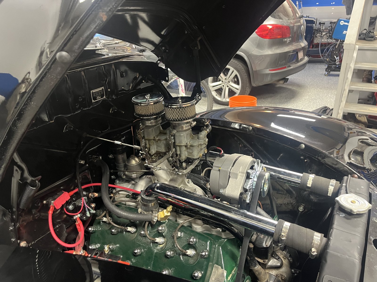

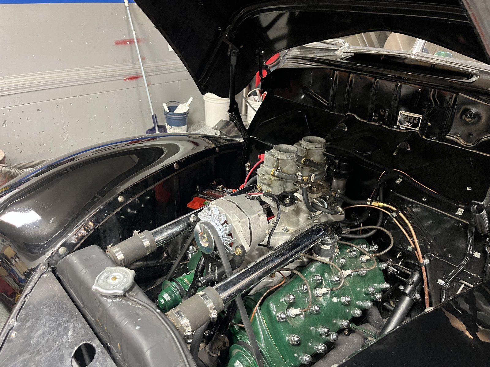

    What is that wired in from the hot side of the solenoid and the alternator feed? Circuit breaker? Maybe I missed it in an earlier post. Need it for my coupe.
    Thanks, and keep up any updates.

    This is the main fuse for the system. Battery is connected to one side and the other is the alternator and power feed for the main car harness. It came in the Painless kit and protects the system from a dead short.

    Thanks! I’ll look for one. What amp fuse do you run?

    it’s a 150Amp fuse.

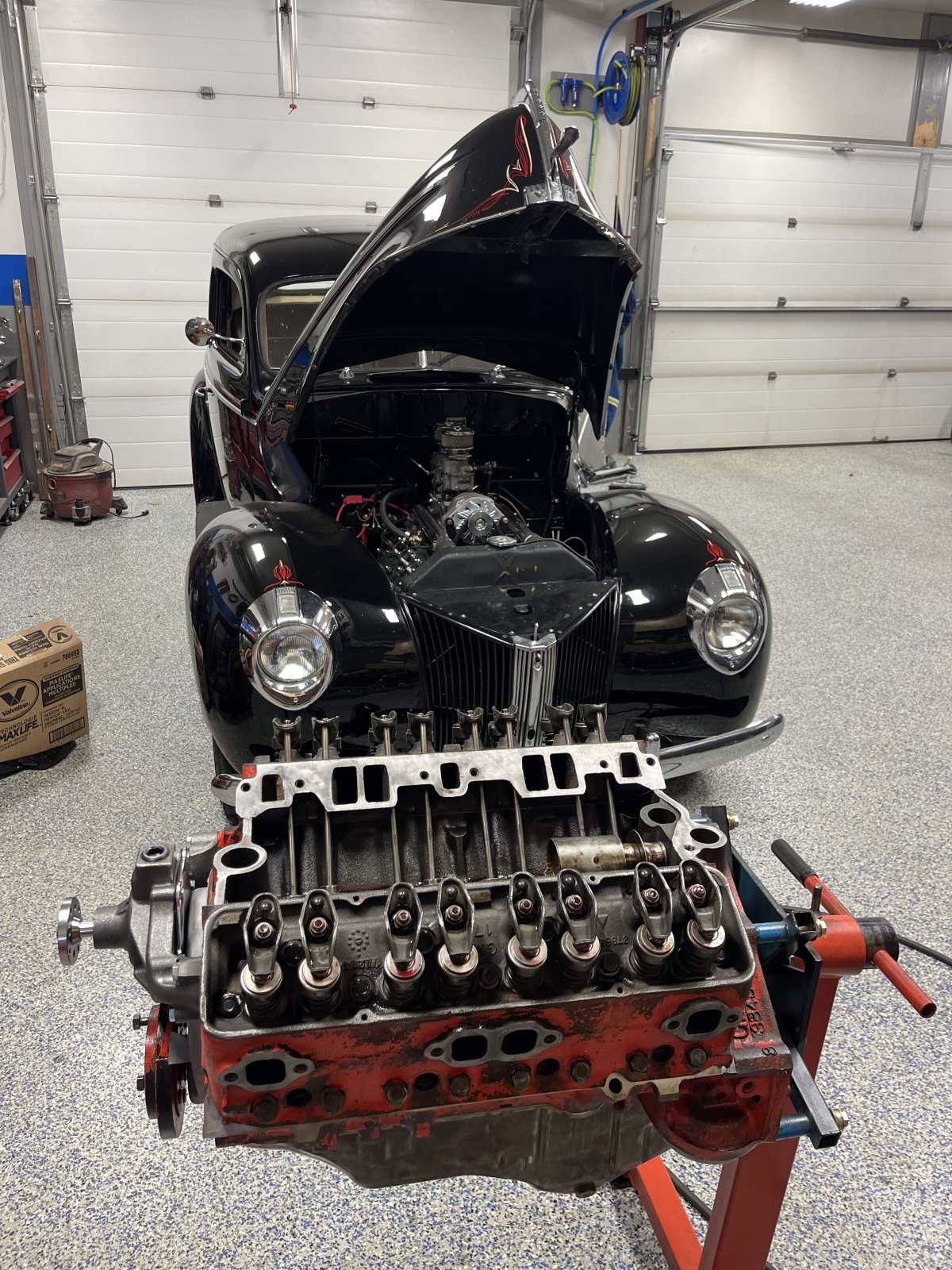

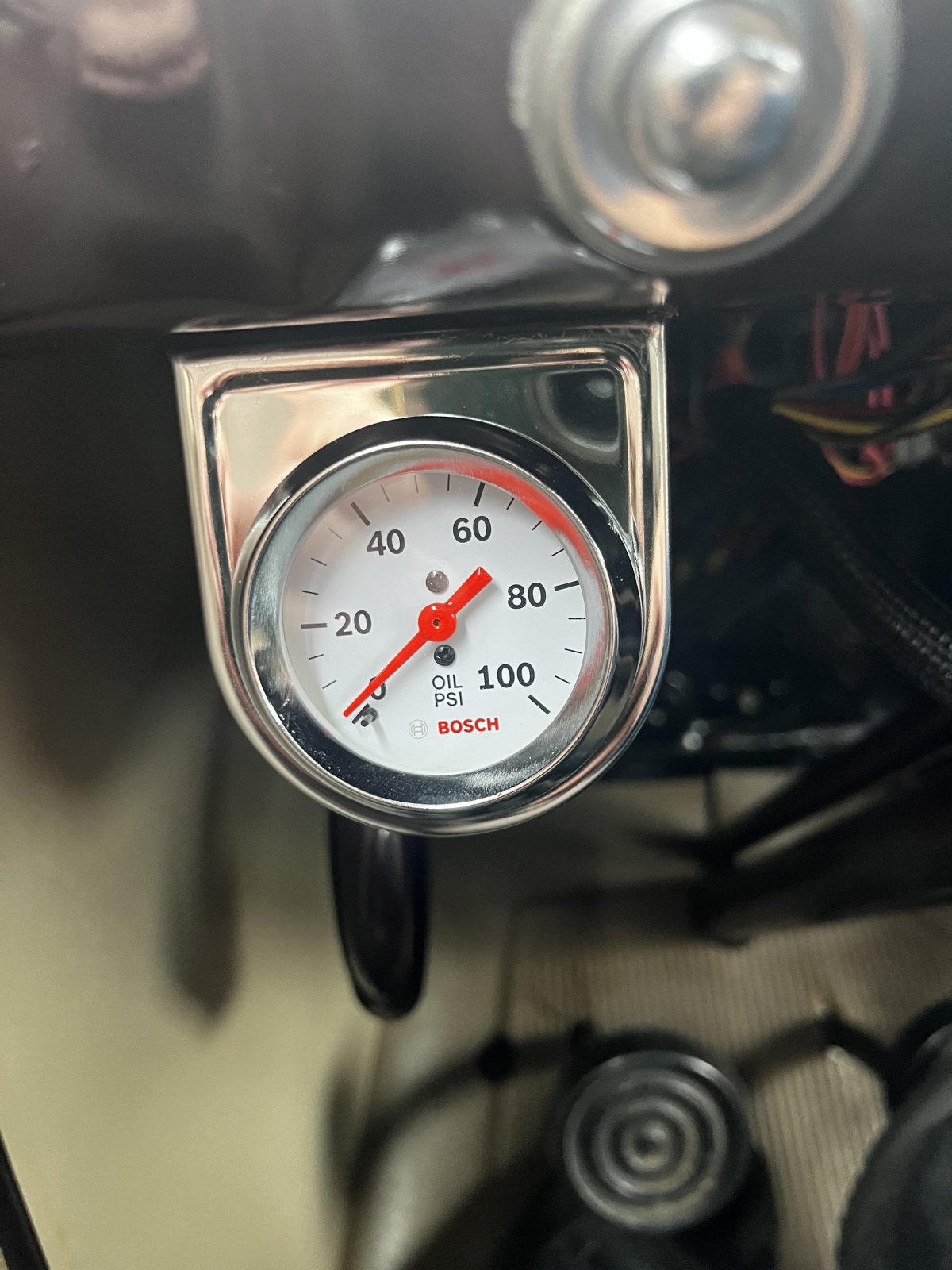

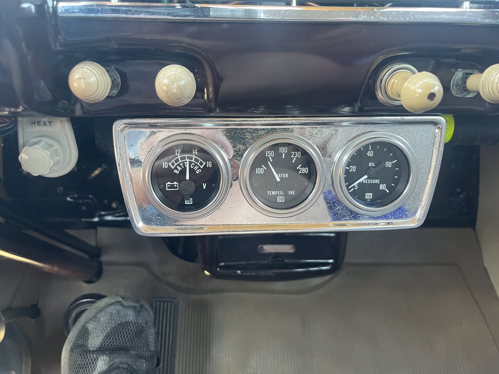

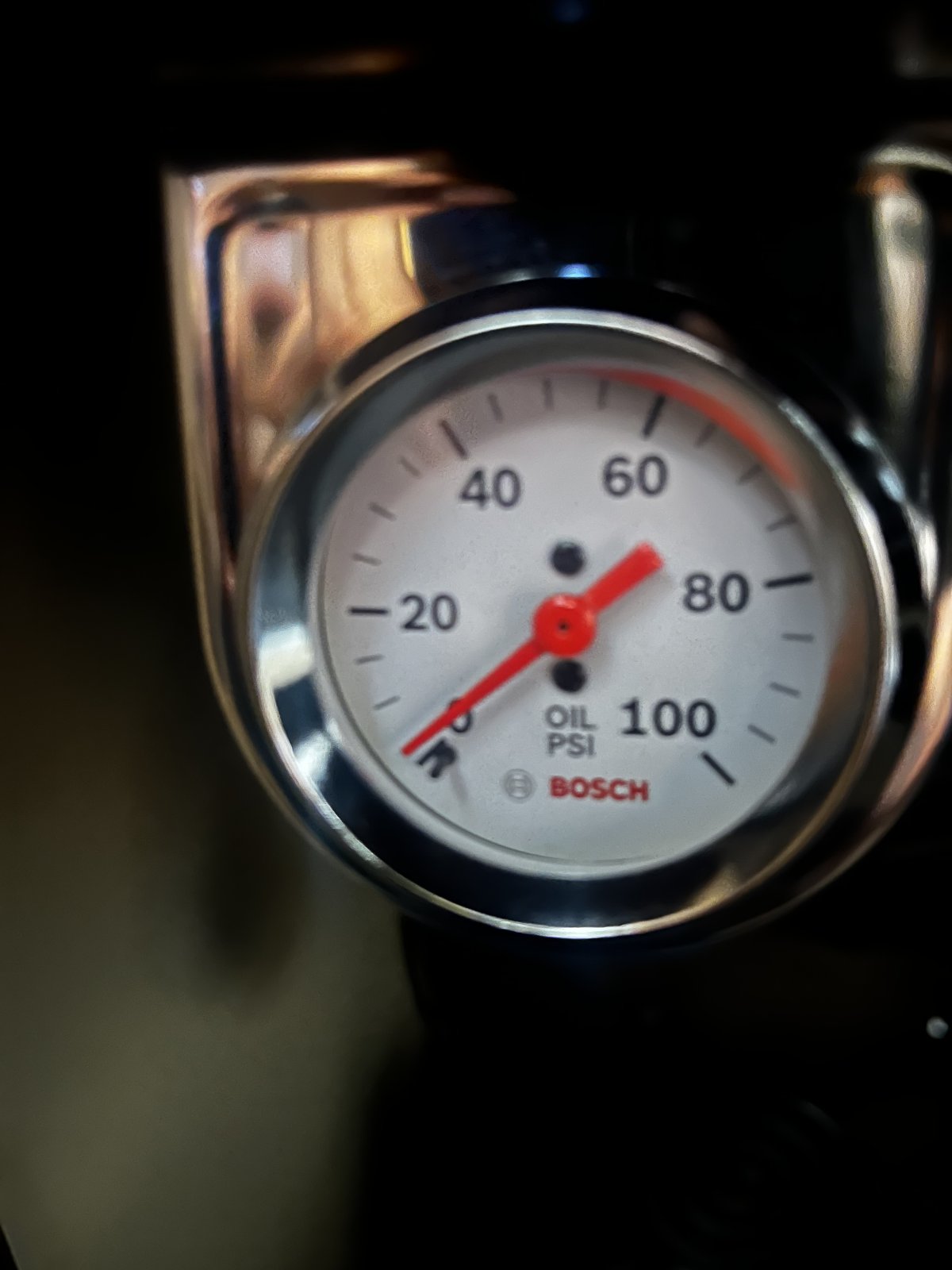

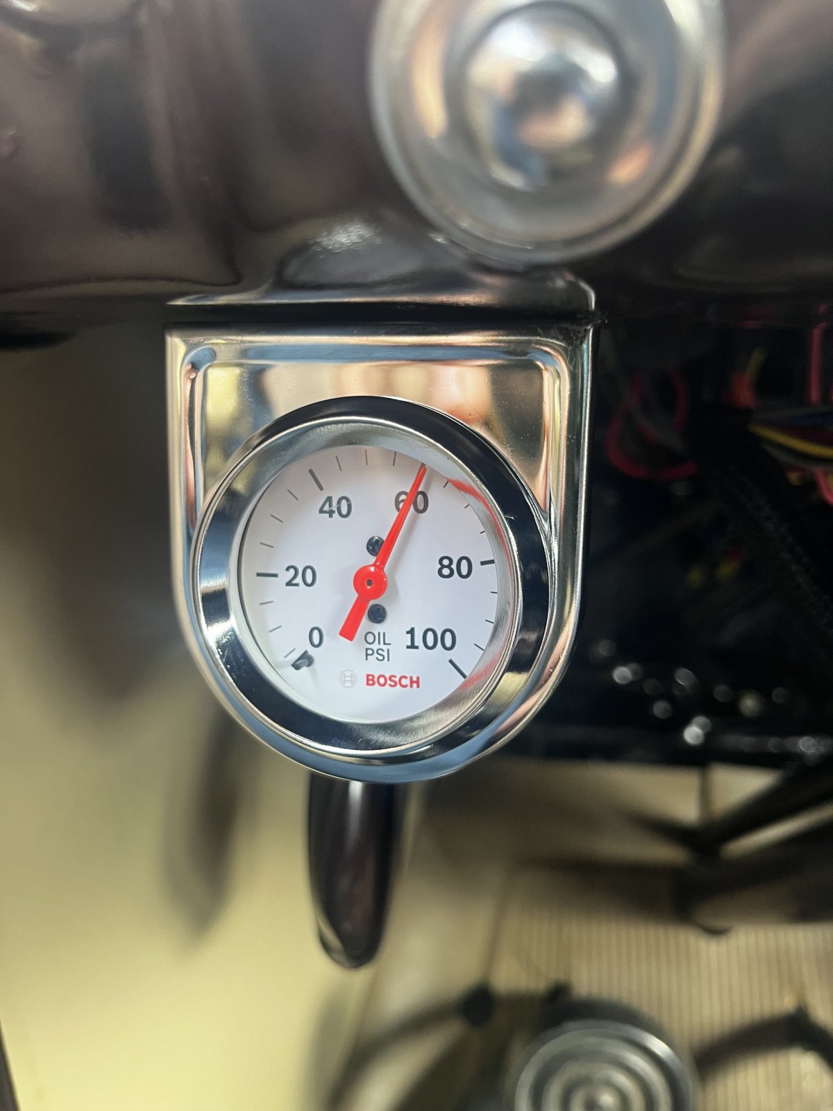

    A bit of an update on the 40. So far it’s been a good around town cruiser. Out of curiosity I put an oil pressure gauge into the car to see what the oil pressure was on this old flathead.
    Turns out I have next to no oil pressure. When hot it would be 1-2PSI at idle and 10-15PSI at cruise speed.
    Swapped out the 10-40 for some 20-50 and Lucas engine hunny with our any change. When cold it goes to 60PSI but once it’s warm I’m back down to the 2-15PSI range.
    Engine seems to run okay without any knocking or banging and dose not seem to burn any oil. At this point I think I know it’s an old worn out Flathead and we are just going to see if I can get the summer out of it.
    This morning we just did a 30 mile trip to take the family out for breakfast and again no pressure but it ran fine. Wipers even work on the car
    Seems like a good time to start checking over the 283 though to have it ready to swap in. Looks to have been rebuilt at done time with .030” pistons and standard mains and crank. Came out of a running car but unfortunately was left outside in the rain for a day or two and got water inside. Hopefully I’ll just clean it up and go back together.

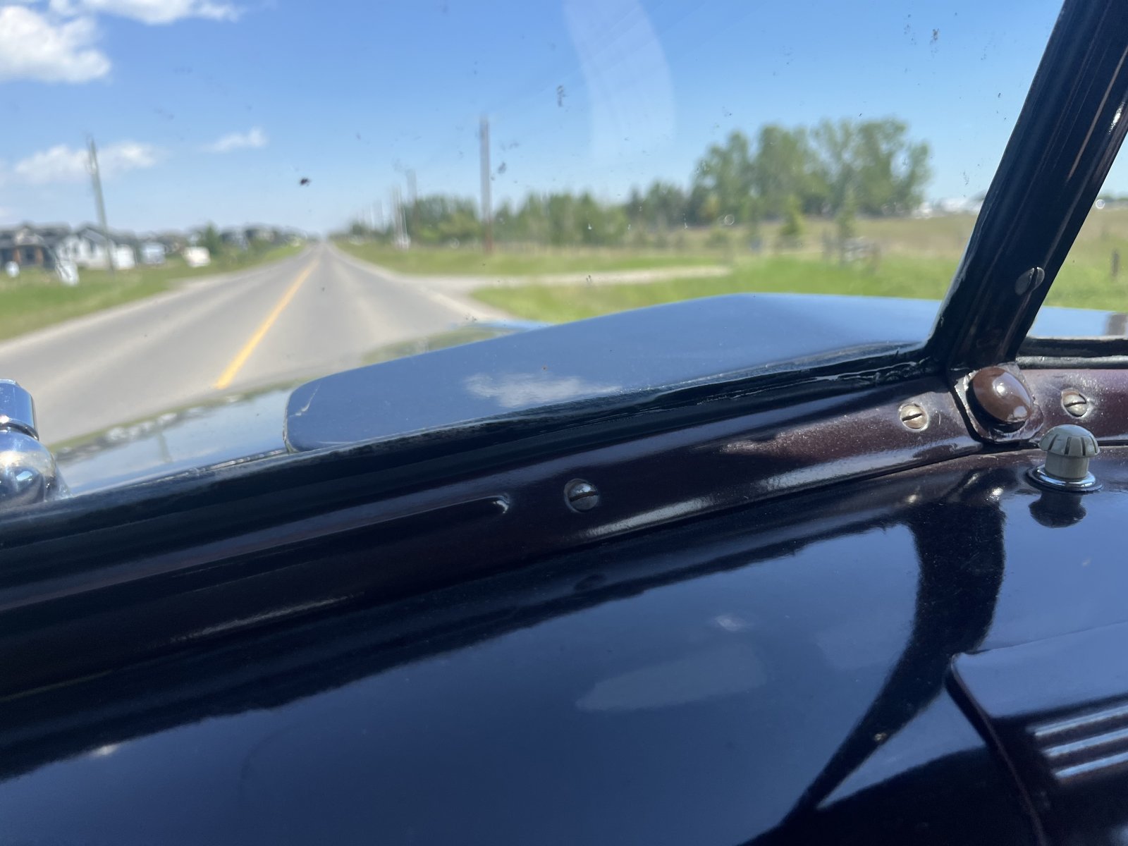

    IMG_2259.jpeg I have had the 40 on the road now for just over six weeks and 400 miles. So far it’s been a very enjoyable ride doing thing the car was built for. Sunday drives to Dairy Queen, dropping kids off at school, picking up groceries, any possible excuse to drive it even checking out a few local shows including a 80 mile round trip on Saturday.
    a few observations about driving a 84 year old car
    1)The old flathead has maybe 80HP and you use it all getting this thing moving. You are not getting anywhere fast. 55MPH is a happy cruising speed. This engine just keeps on ticking runs nice and cool doesn’t burn any oil. Realistically who really needs more the 10 PSI oil pressure cruising @55MPH. You start to understand the legends of Flatheads that seem to run forever
    2 Three on the tree transmission. - Once you get the hang of it it’s very enjoyable to drive. Something about shifting it just feels right. Unfortunately mines not shifting so nicely. New synchros are on the work bench but why pull apart a running car in summer when you can just double clutch and Granny shift the thing to prevent grinding.
    3 cowl vents - one automotive design feature that needs to make a come back. Nothing nicer than opening it up for a breeze blowing in all the right places.
    4 Enjoy it - We spend thousands of hours and dollars to put these car together. Get the car out of the garage and just drive it. I suspect I have put more miles on the car in the last month then probably car has seen for a few decades.

    Is that oil pressure gauge mechanical or electric? If it’s electric you could have a sender issue, or wrong voltage. Just trying to think about possible issues because it’s quiet with no pressure that’s weird.
    Great looking 40 sedan. I’ve had two now and look forward to the next one. Both of them had Chevys hooked to the original trans and rear end. It’s an easy, time tested swap.

    it’s a mechanical gauge I have tested it with 2 Gauges with the same results. I’m putting together a 283 and the plan is to swap it in this winter to the original transmission. Until then I’ll just keep driving it with the flathead

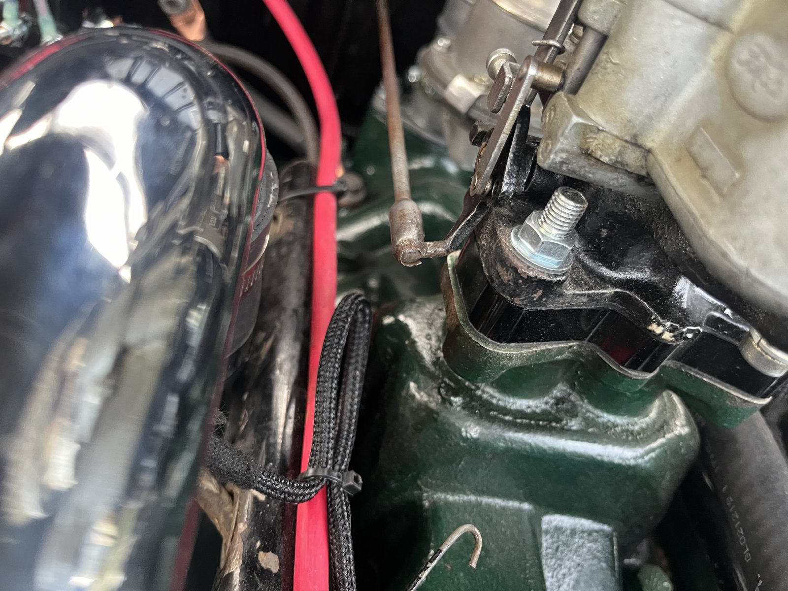

    I was out the other and my worn out throttle linkage finally pulled apart. It was a quick roadside fix to get me home. I figured if I have to fix the linkage it seemed like a good idea to swap the intake.
    The PO put a brand new Slingshot intake in the car. I started off with the single intake for the initial shake down. Pulled off the original and swapped on the dual. In stalled the 94’s off my Roadster and made up a new throttle linkage.
    Car still runs nicely you can definitely feel a bit more power(and thirsty on fuel). Did a 100 mile round trip last weekend to a show out of town. Car held together and killed a few hundred bugs

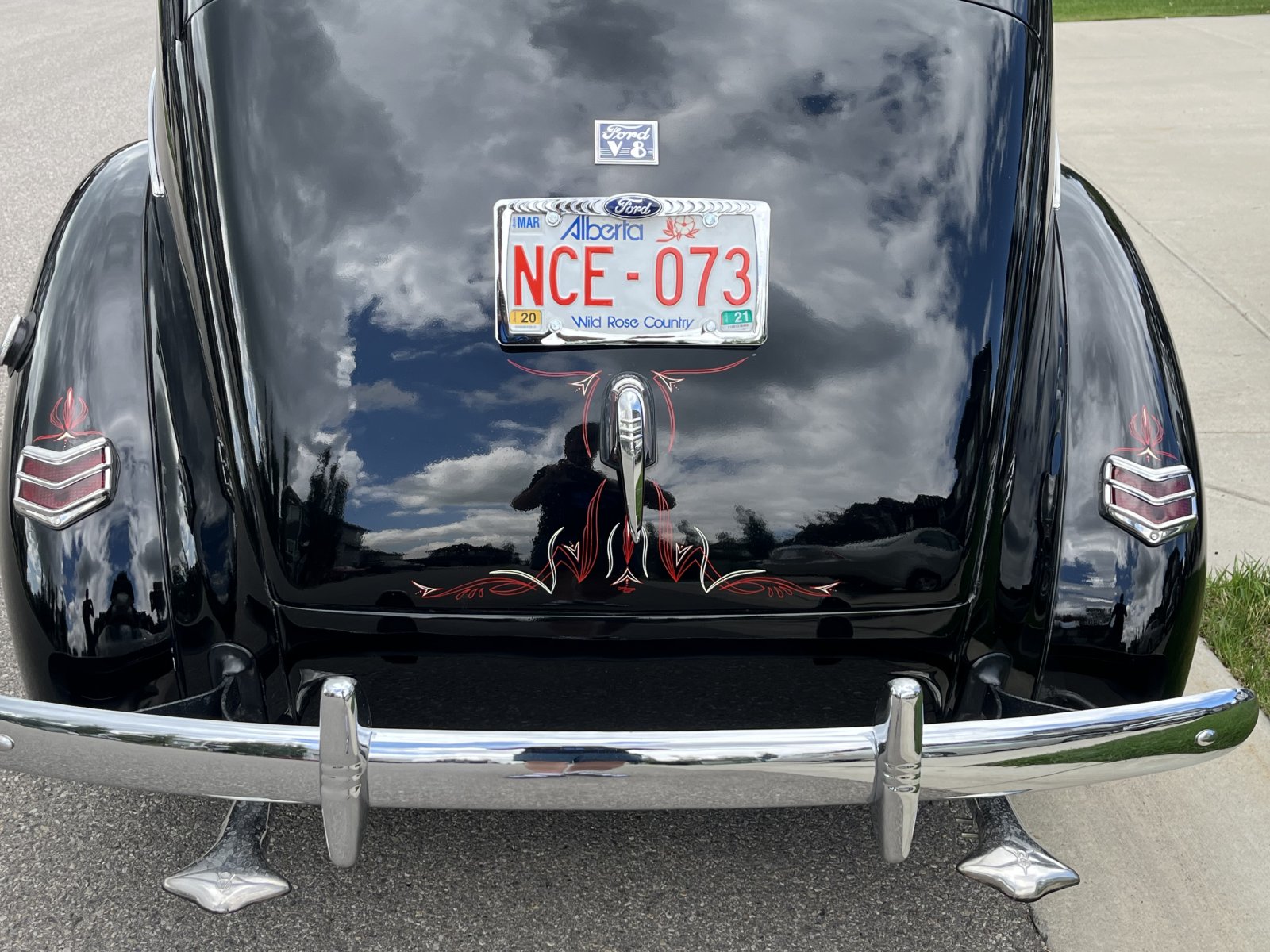

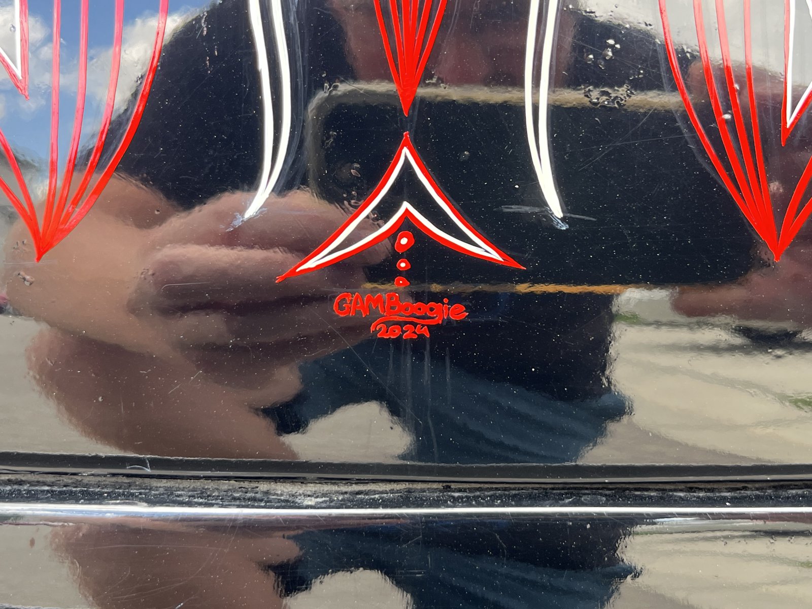

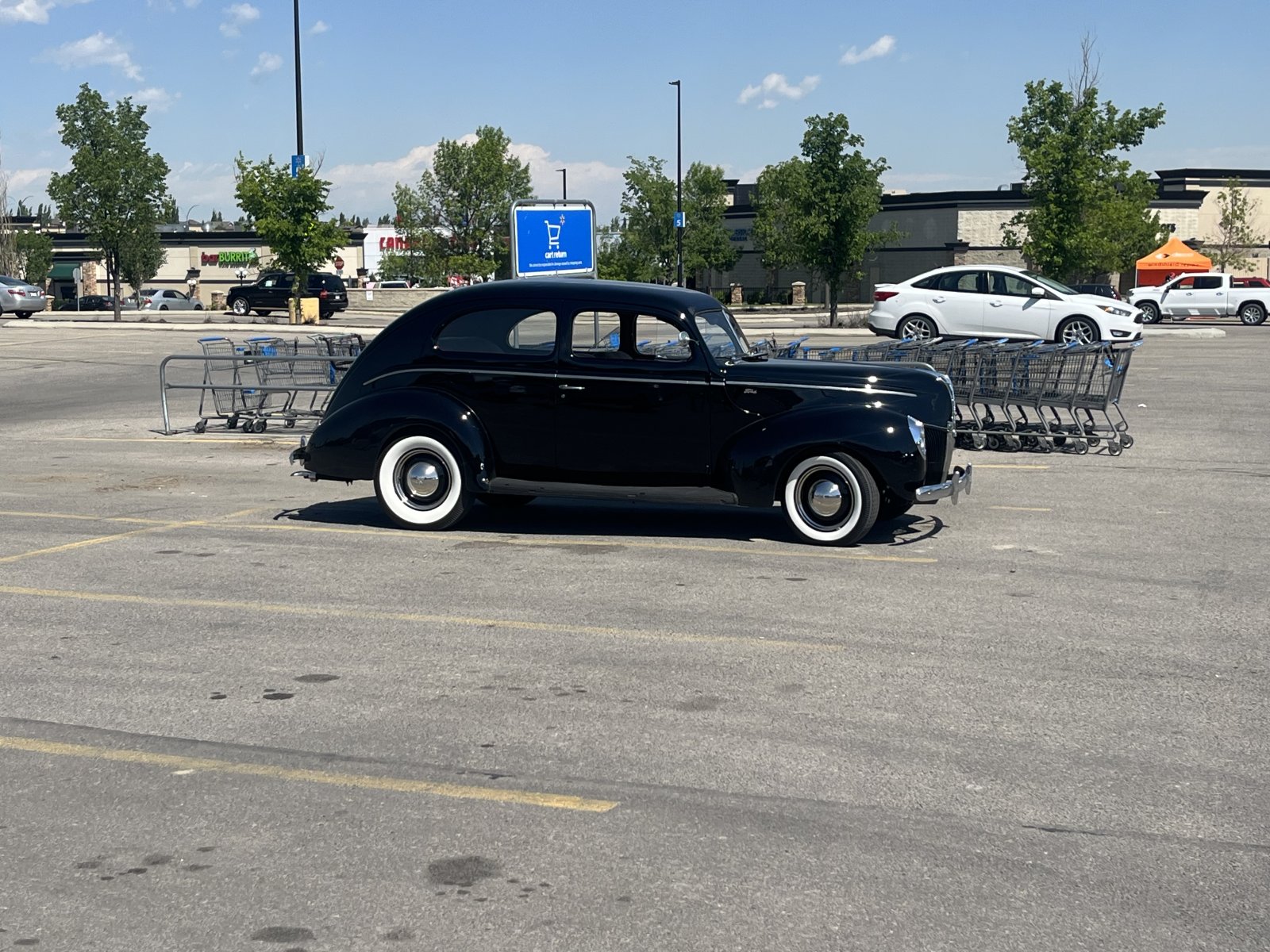

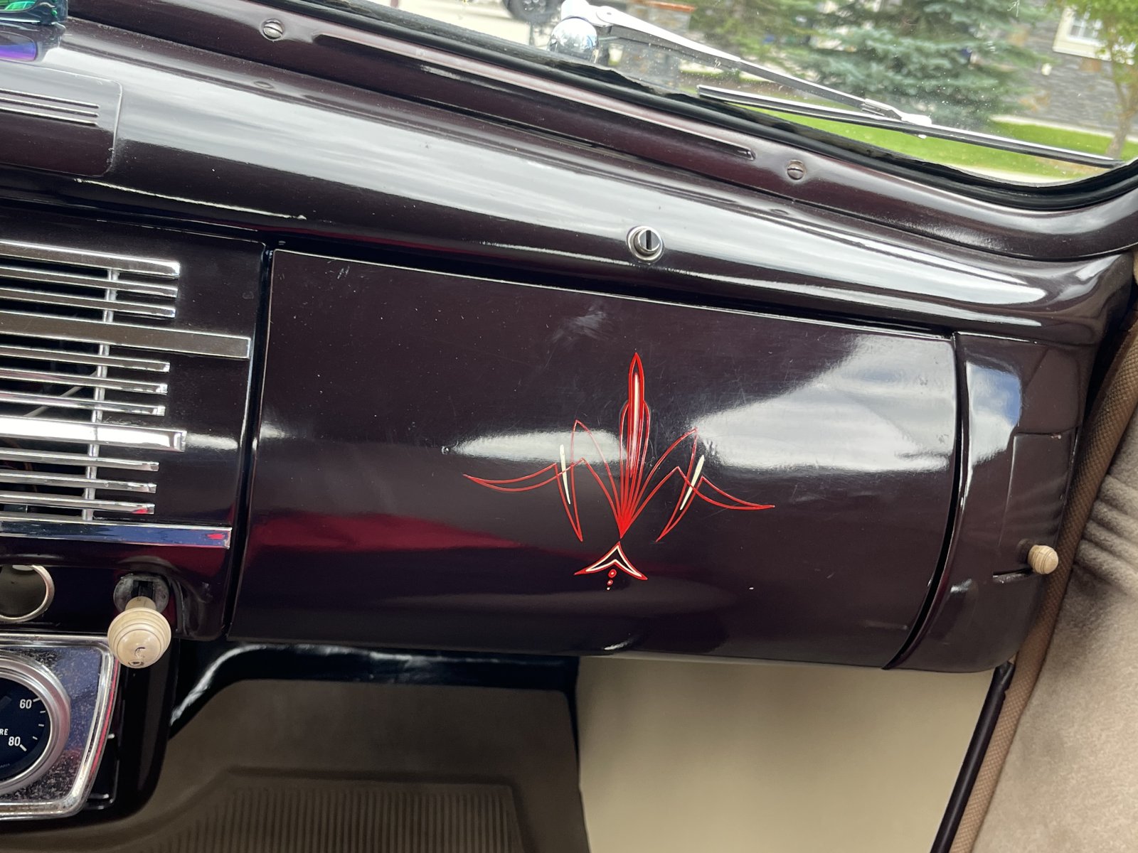

    Had some pinstripes put on the car this week. By Gary at Gamboogie Kustom painting in Calgary. New stripes called for a family cruise through town for a treat.

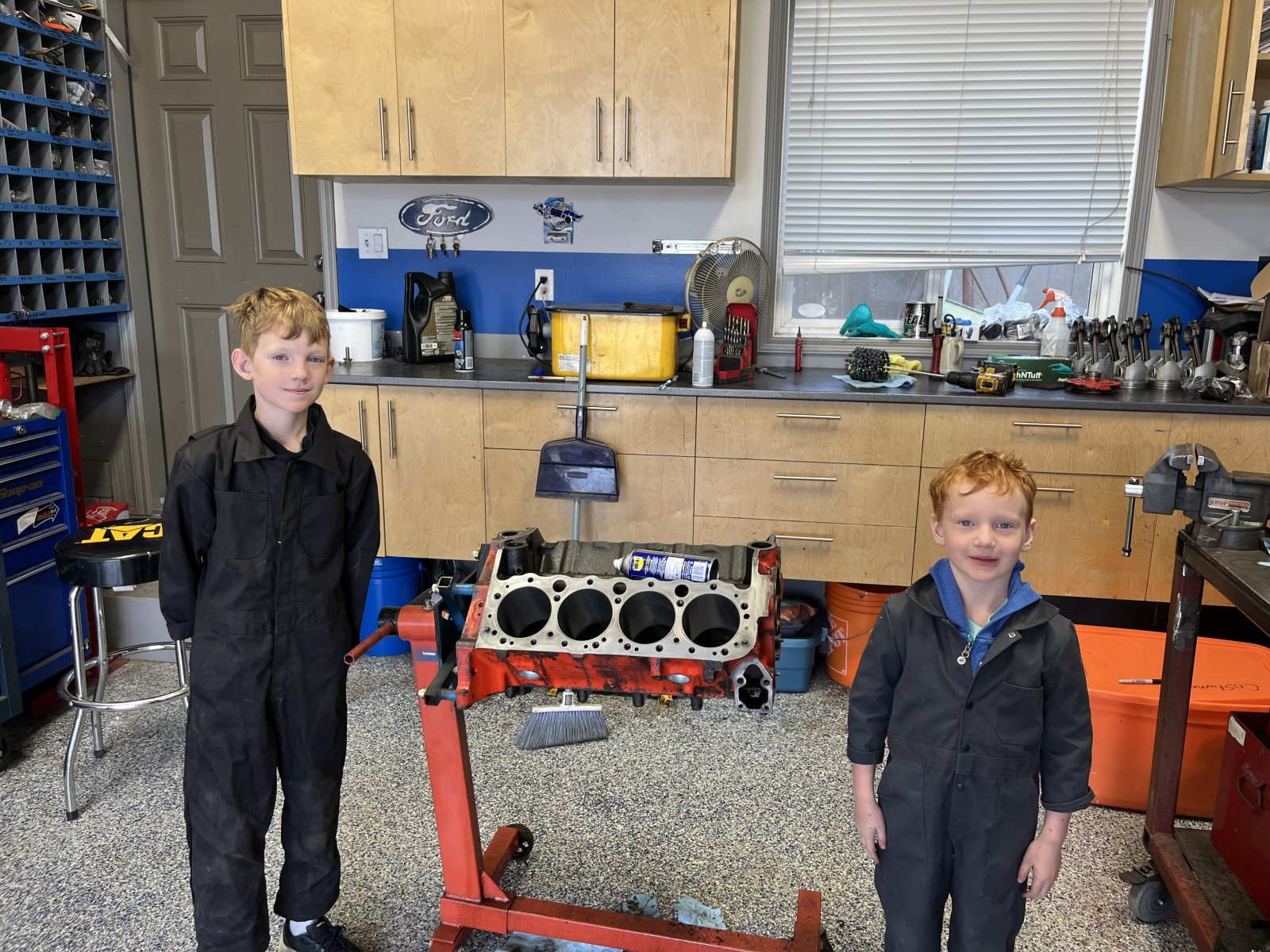

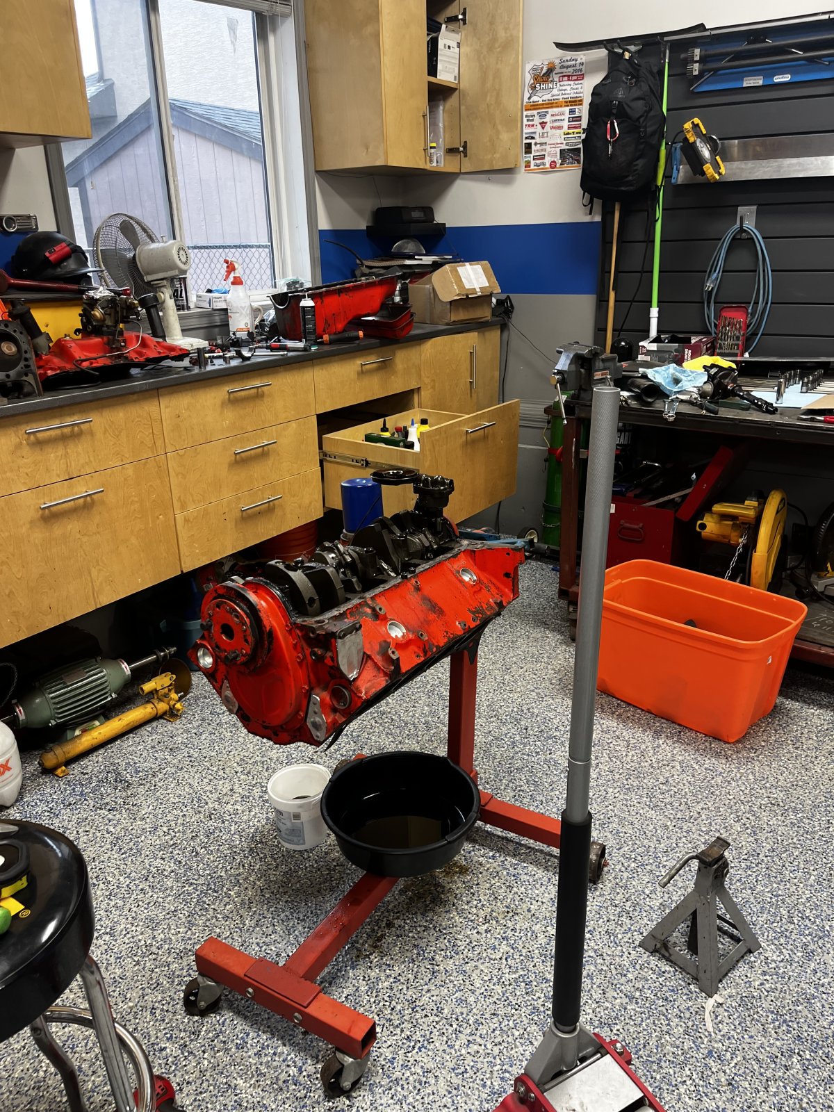

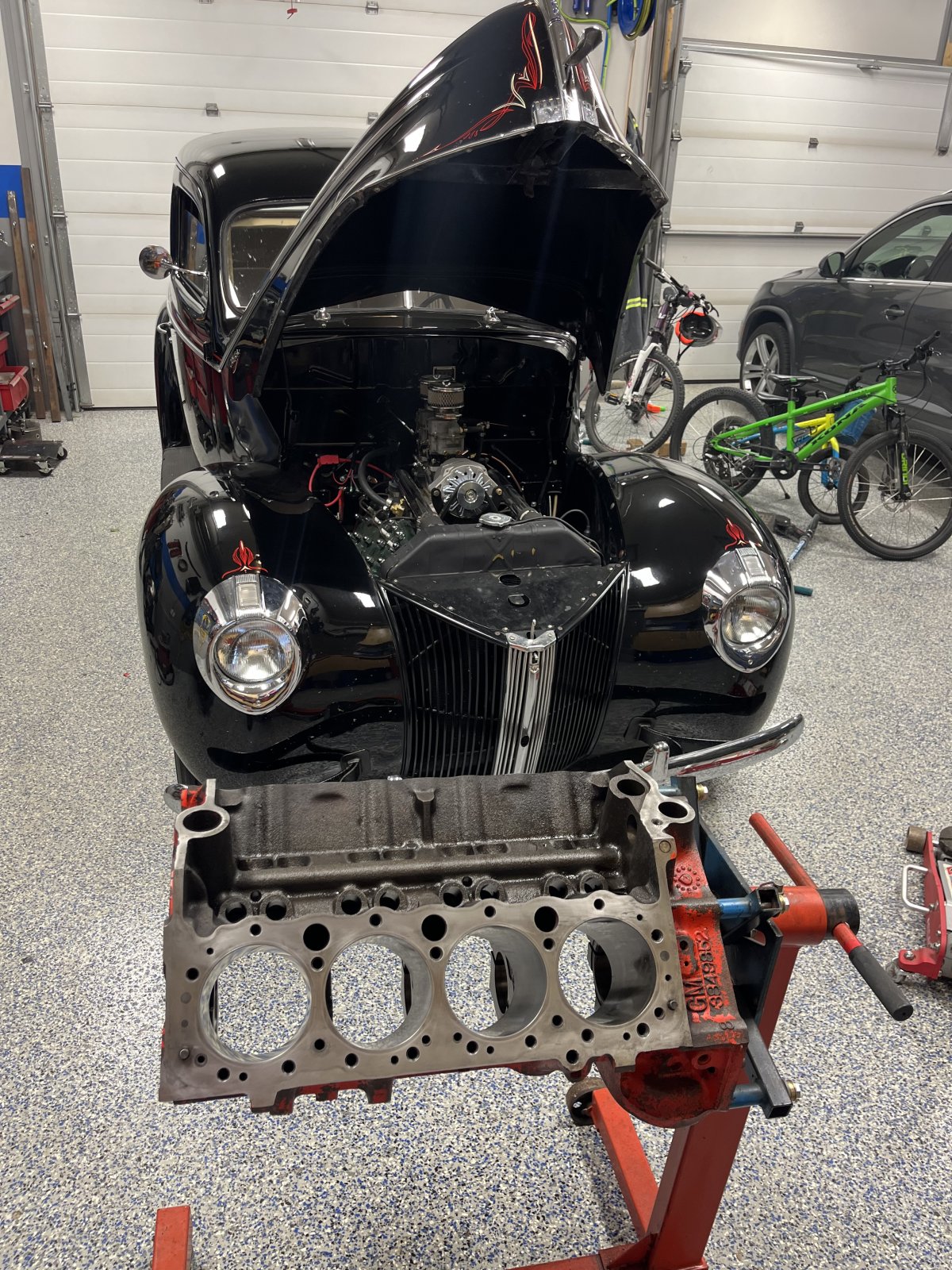

    Started to put the 283 back together. I don’t want to call it a rebuild as it probably should have gone to the machine shop.
    I’m not sure if it helps but I figured I would make the Flathead watch me build a SBC just to make sure it knows its replaceable if it gives me any trouble.
    Cleaned the crank with the sandpaper and shoestring trick.
    Dingle ball honed the worst of the cylinder walls
    New set up bearings, rings, gaskets, and a paint job to make it look fresh.

    The oldest was my WD40 spray guy and the littlest one didn’t quite understand how far he needed to stand back when the spinning hone comes out of the bore. Needless to say we all ended up covered in little black spots due to the oil flying off the hone.
