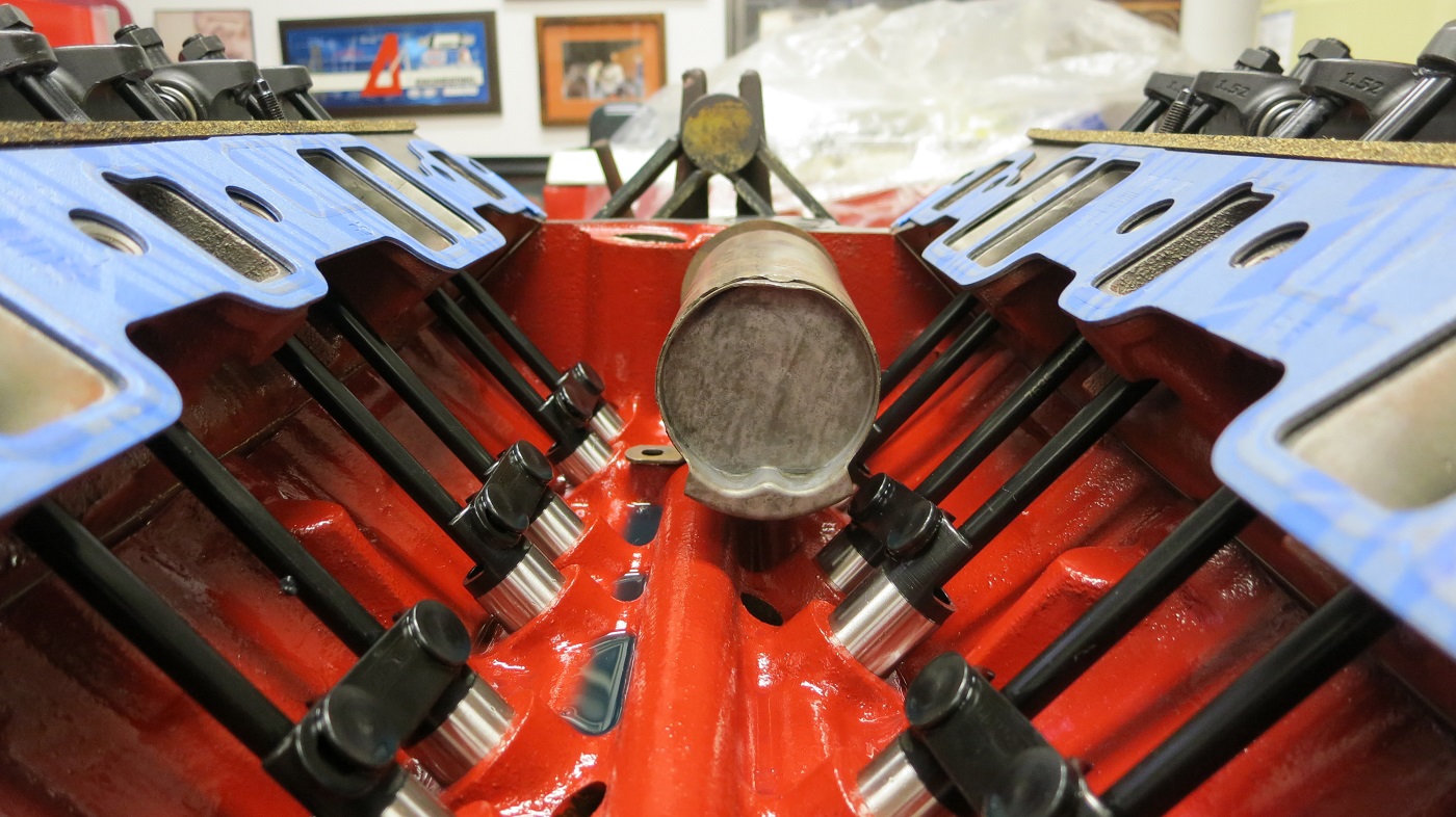

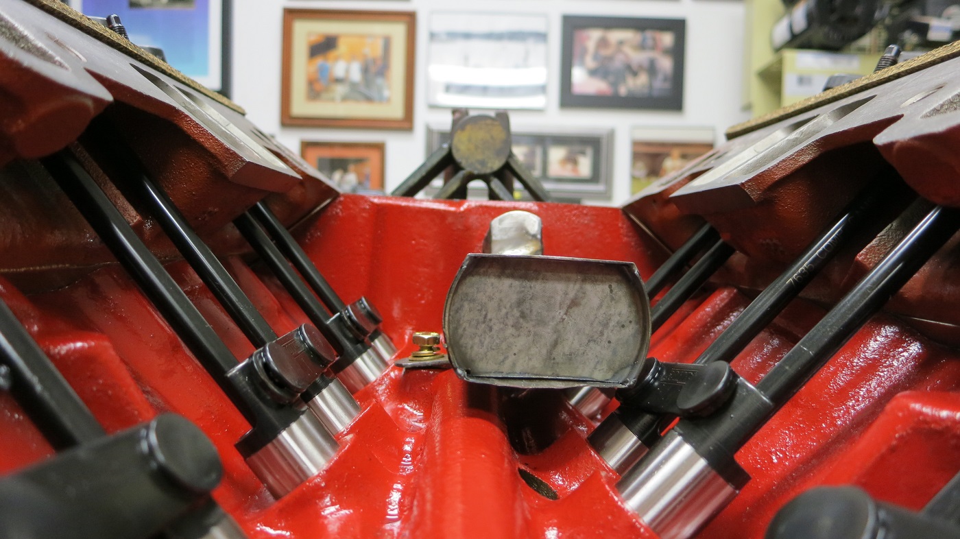

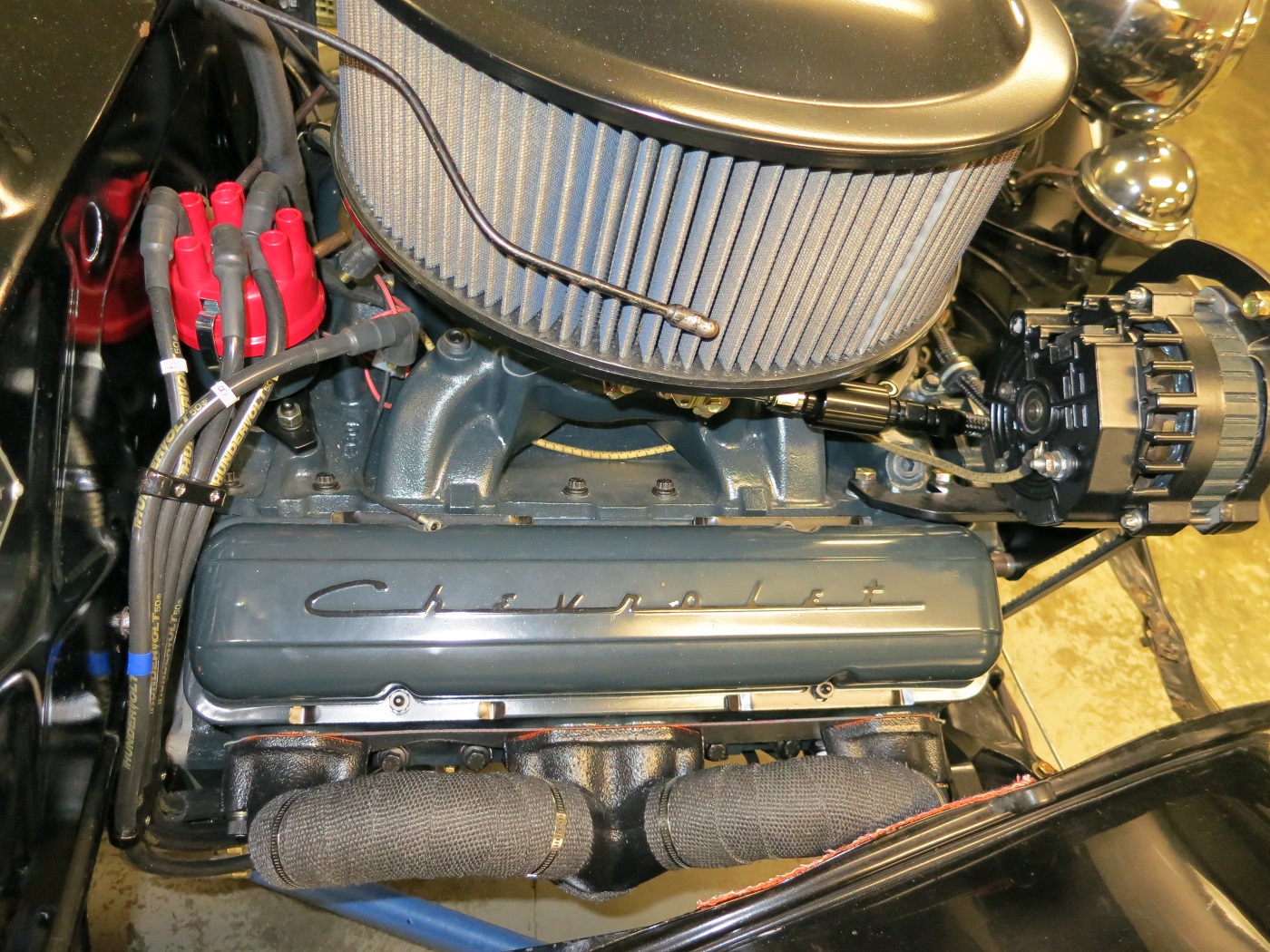

    I have really enjoyed reading this post. It amazes me at the amount of information that our fellow hambers know. I just finished a 265 that is + .060 for my 1934 Ford and decided that I wanted an Air Gap ...........
    I am not very sharp .......... hopefully these pictures will tell the story of the problem and my solution ........tp

    Hey LBH, I wouldn't say your not that sharp, the can there for crank case ventilation is a little different animal on the older blocks. Looks like you did a clean fix. What size cam are you running and how do you like the way it performs ?

    To answer your question you have to understand the application for the motor. I have a very original '34 5 window and I have been determined to preserve the car and still have my fun .......... build a hot rod. I took the entire mechanical brake front end and hung it on the wall and built a Pete & Jake's 4 inch dropped disc brake front axle, put Wilson Welding backing plates on the rear, used the V 8 Garage brake kit and thereby did not drill one hole in the car ........... got it to sit right and stop right.
    Drove it for several years with the original 85 horse 221 cubic inch flat head which is a babbitt bearing motor........ I was afraid to take it on a long trip at today's speeds. I did not want to change the stock rear end and did not want to cut up the trans mount. So I had a '39 transmission built and decided to build an old time period correct engine small cubic inch Chevy with a lot of camshaft, no low speed torque, that would sound bad *** and be as easy as possible on the drive train.
    A good friend owned this 1955 265 power pack motor for 45 years .......... it sat on the floor, I bought it. Today it has +.060 Egge flat cast pistons, .005" deck height, and Eagle rods. In your e-mail you asked about the heads ..........which are 1957 Corvette #3731539 cylinder heads, date code D-3-57, 58 cc combustion chambers. These heads sat finished in Butch Kernudle's machine shop for years. They were done by Brandywine in the old days. It has a Comp Cams roller hydraulic cam that is similar to the middle Thumper except it has more overlap due to tighter center lines and single bee hive valve springs and their best roller rocker arms, Manely 1.840" intakes and 1.500 exhaust valves.
    Of course I am biased ...... but the thing sounds unreal. I just got it running so after I get some miles on it I will be able to answer the question of how good it runs .......... tp

    NICE ! I looked up the Thumprs but was unsure exactly what lift it has int. and exh. Did you keep the down draft tube as well ? That style is unique to the 55 block they way it is.

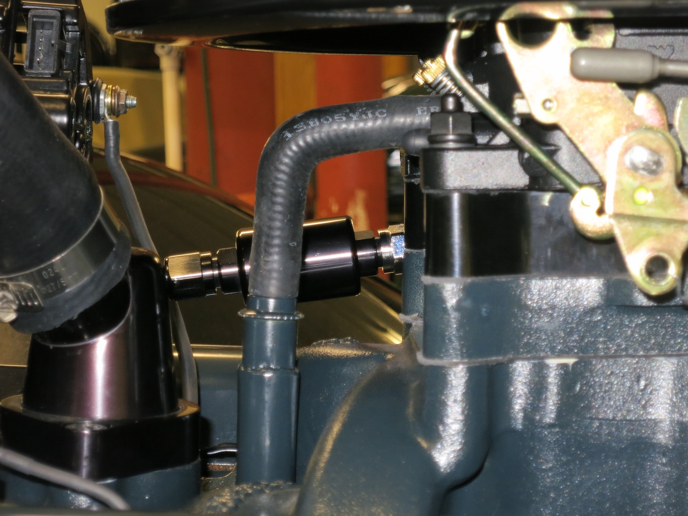

    Yes I kept the downdraft tube which is why I had to modify the canister in the lifter valley to clear the air gap intake. The whole thing was a "science project" but I knew that I had to retain the road draft tube. The original 1955 staggered valve covers have no holes in them, the intake had the breather / oil fill ..... and I did not want to change that.
    After grinding this to dust, I drilled the floor of the intake and built a tube with 4 baffles in it to separate the oil mist, then welded a 283 pcv valve to the end and rubber hosed it into the carb base ...... seems to work great. You remove the tube and use a transmission funnel to put the oil in.
    Now I am not saying that ANY of this is right ........ it is just what I came up with ..... I mean I had the air gap, I have them on other motors and really like them ......... so I had to come up with a way to make it work...... By the way.... the road draft tube joins a piece of 5/8 heater hose and runs to the back of the car and has a small K&N air filter on it. Remember, at idle with the pcv valve open air is being ****ed through the road draft tube through the valley along with what little blow by that is being generated at idle and into the intake ........tp

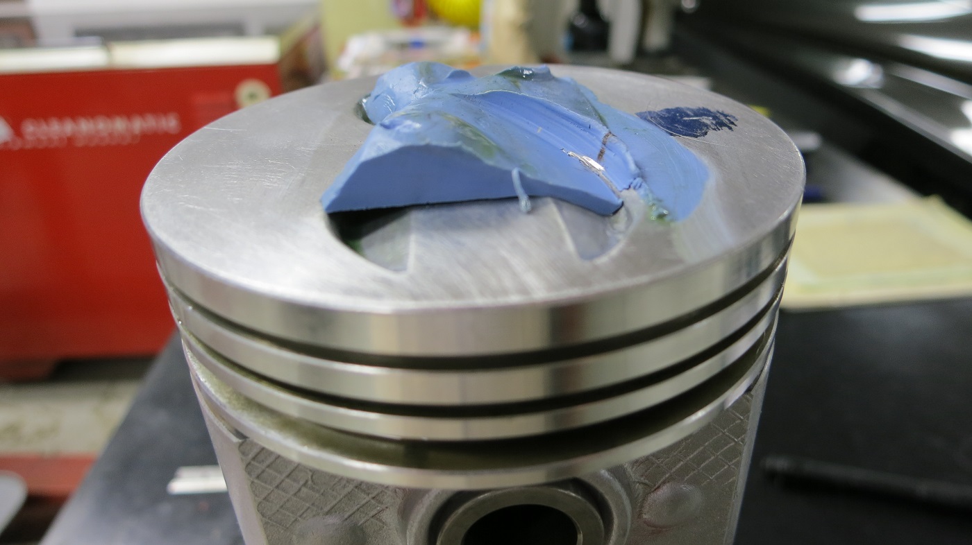

    As you know, with the small bore diameter (mine is 3.810") it is hard to make compression ...... you need a small combustion chamber ....... after surfacing my heads ........ mine are 56.5 cc's. The problem then becomes piston to valve clearance ........... I chose this cam because of it's lift ...........believe me ..........mine is tight !! ........I could not figure a way to handle more lift and keep the mechanical compression as high as possible..... which you need because these cams don't produce any significant cylinder pressure until the higher rpm ranges ................tp
