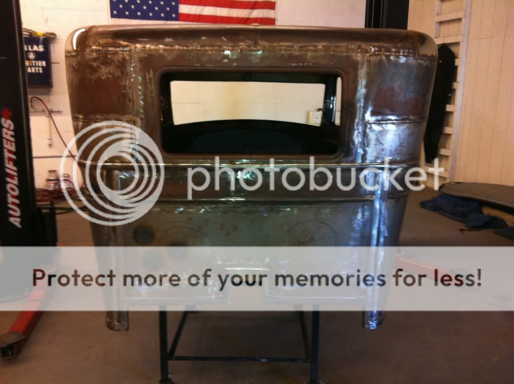

  10. James D
    Joined: Feb 8, 2007
    Posts: 4,981
    James D
    If you´re in the mood for changing things... then something struck me about the shape of the cab. Seems like the belt line had something of a gentle curve to it (seen from above), tapering towards the front of the car, but your repairs to the bottom of the cab appear to be dead straight, and follow the ch***is. It looks like there is some conflict between what the belt line is doing and what the bottom of the cab is doing. It looks a little "****ed in" towards the base, if you get me. Don´t take this the wrong way please, it´s just my thoughts on one part of this cool truck! Can´t wait to see and hear this one running.
  11. vtwinpartss
    Joined: Nov 18, 2008
    Posts: 335
    vtwinpartss
    from NOR CAL
    All of the belt lines are dead straight, The bottom of the cowl is wider than the area where the upper belt line is. The photo makes it look much more dramitic than it actually is. The cowl is 3" narrower at the belt line than the bottom of the cowl, but yes you are right the photo does make it look funny

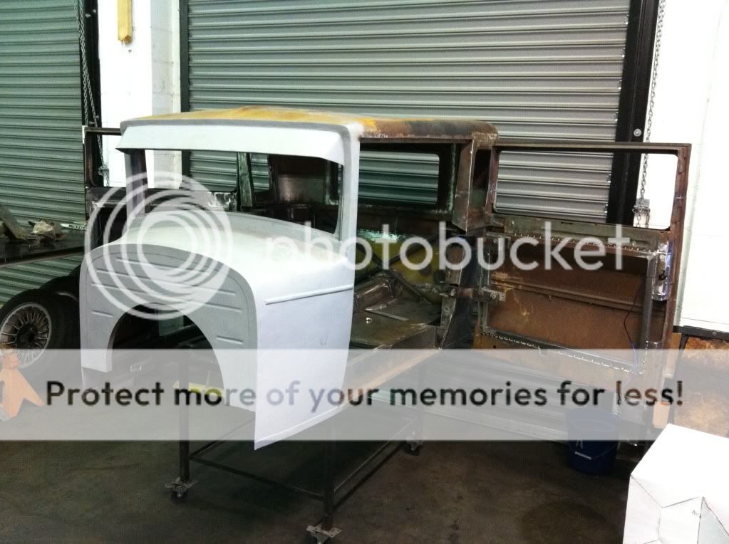

  12. vtwinpartss
    Posts: 335
    vtwinpartss
    from NOR CAL
    I have not updated you guys in a while now, not much progress has been made. The body got sent off to a friends shop for a little lower rework. I wasnt happy with the cab corner transition. I will post photos when she comes back.
    I finally welded in the rear suspension, its only take three on the rear end design. I finally decided to go with the ford 9" and a triangulated 4-link with coilovers..I will not change it again. She rolled outside for the first time in 6 months, man does the gold motor look good in the sun.

    It has been a busy summer with not much to show in the way of progress, but she did get a little more metal work. Thanks to Peterson Bro's in Petaluma.
    So the cab corners looked like **** before and now they look so much better.
