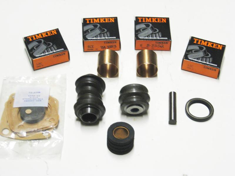

    I studied several hours on the internet. Mainly on the HAMB and Ford Barn about what to use for lube and decided to use no grease, just 85-140 weight gear oil. People have used Corn Head grease ( a grease that turns to a thick liquid state when warmed up) alone or mixed with 90 weight oil, or CV joint grease, 50 % power punch with 50 % 90 weight and several other concoctions. So far it is not leaking out the new bottom seal (Part #TSM 1152PTB). Since the gear will be subjected to considerable heat from the header time will tell whether or not I need to switch to a grease.
    I did not need to replace my bearings but researched them anyway. You should be able to buy them at your local bearing store but I did find them available for purchase separately on the summit sight also.
    The upper and lower bearing races are a different sizes but the bearings have the same number. I noticed this bearing is listed as a wheel bearing on the Summit sight.
    Upper race Timken 6
    Lower race Timken 6CE
    Bearings Timken 5BC

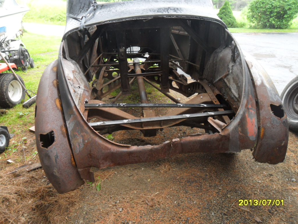

    I see a floor support cross memeber just above the rear axle! What is the height dimension? As it's sandwiched between the frame and the floor I want to make sure I get that measurement correct or the rear of my car will be too high or too low. That support is long gone on my coupe , as is the entire floor!
    Another measurement.... do you know what the dimension is from the floor to the bottom of the rear side windows.

    The floor support you see is just to the rear of the rear crossmember and no one makes them except they come on the Drake/ Carpenter trunk floor sections and of course on the full floor pan. You have a business coupe and the carpenter floor is made for a 5 window; thus the "step up" in the foor is farther forward than the repo floor.
    The first hole in the frame to the rear of the crossmember is a body mount and there is a wedge of steel on the uinderside of that hole in the frame. The crossbrace has a hole through it on each end and is spot welded to the underside of the trunk floor. A friend of mine "a tinner" made one for me and I'll post sketches. I have to get them off another computer.

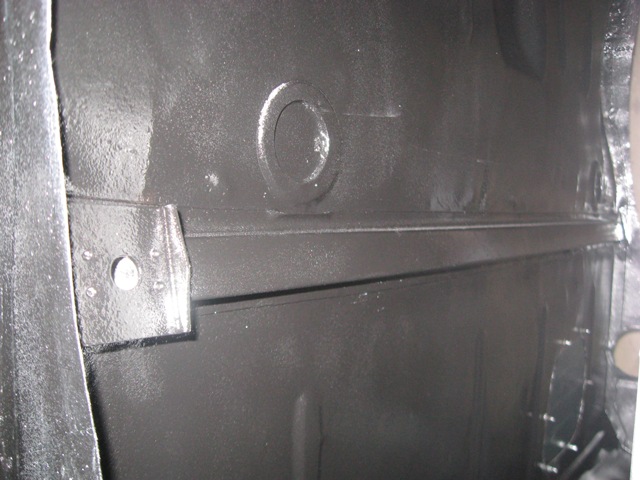

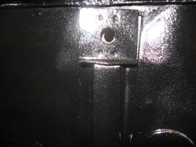

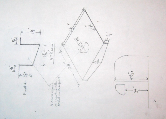

    Well White 64 you sure are much braver than I. Joel speaks the truth on the 40 coupe floors. I took some measurements for you today though. I hope they will be helpful if you decide to build your own floor. I would recommend buying a complete floor from Carpenter though.
    I added the door jamb measurement to the window measurement because I think the door jamb measurement would allow you to have to base your 1/4 panel placement.
    There is a pad at each end. Each one has an anti crush round tube welded inside.

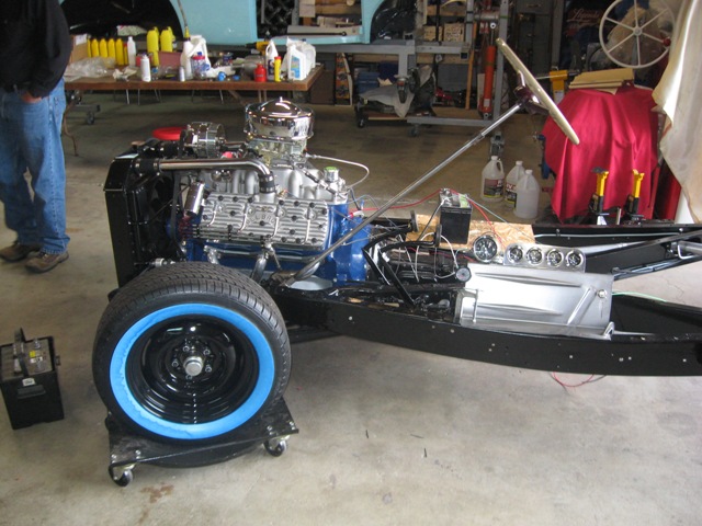

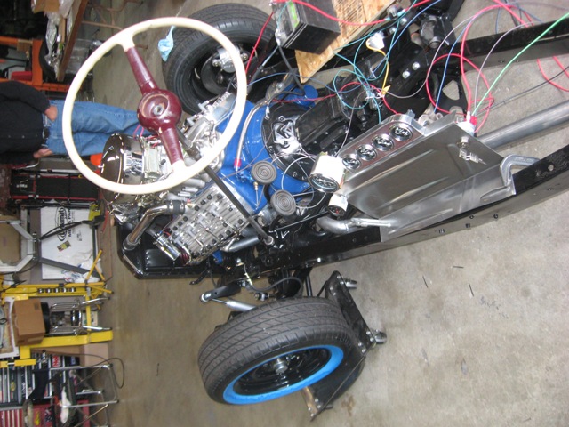

    We got a lot done today but had to stop short of starting the engine. The carburetor floats were not working correctly when we started the fuel pump both bowls leaked fuel into venturies. So we will take the carb apart tomorrow and fix that problem and hopefully start the engine for the first time.
    We made a temporary dash panel out of an unused section of 40 Ford floor. Seems like wires are going every which way. The radiator fan will be run from my RV's battery. The fuel pump and ignition from another one.

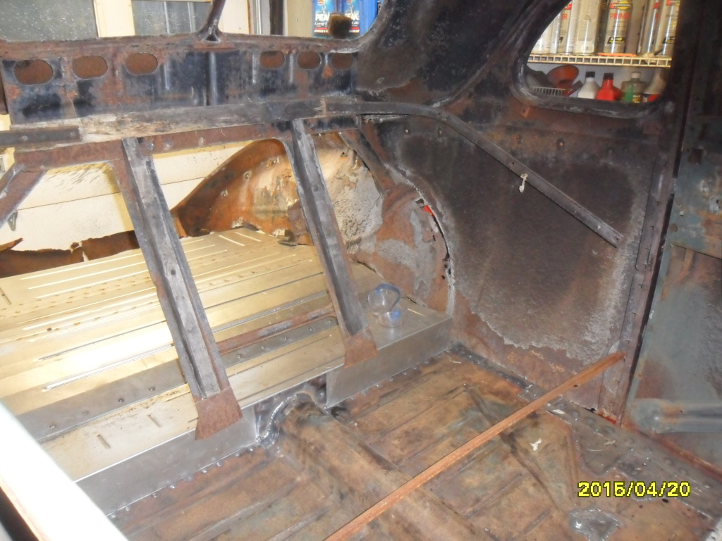

    39 guy! PERFECT! Just what I needed. Using your photos on page 2 I've been able to build the rear portion of the rocker panels. I bought the EMS floors, they're not stock in appearance by any means, but they are much better than what I had. And thanks for letting me hijack your thread for a little bit. It's very much appreciated!

    Thanks for filling in on the sketches; I haven't figured out how to get my autocad drawings off my old XP computer. Joel

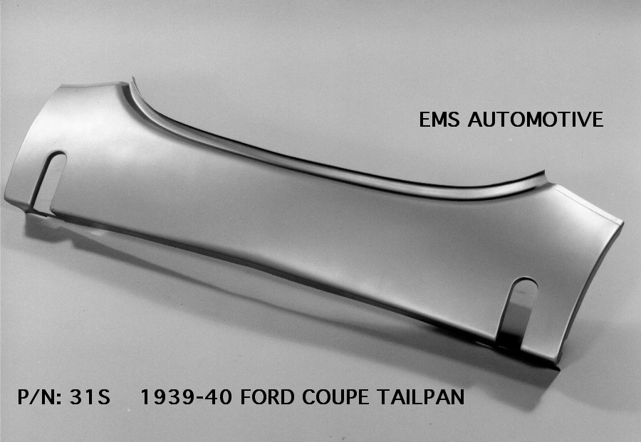

    a lot of good work shown in this thread, but to clarify our panel has all the curves, with or with out slots.

    thanks for understanding, to answer your question, as i understand drake goes mostly to china/taiwan for his parts, ems automotive makes it own parts in its own factory's in the usa, we have our own tool/die shop, engineering dept, and production equipment, so your money spent with ems auto stays in the usa ( yes we produce parts for other industries that need metal stampings),
    we have a huge inventory of cars to use for patterns or we borrow some cars when needed. we try to use the best panel we can find as a master sample. we use thicker metal then imported stuff,
    we take responsibility for any ups damage the ems customer never gets short changed by " carrier responsibility excuse", ems auto can do this as we pack the box ( usa made also) the importer from china can not they have to sell everything as nothing can be returned to china.
    our web site www.emsautomotive.com has a photo album section showing a**** other things, our parts installed on cars when we can get them,
    hey guys if you have photos of ems parts installed we would be happy to post them on our site, send me pm
    we always apply our label/name to our panels. most patch panels companies do not! no label- not ems
    attached is a photo of our rear panel installed on a 40 ford coupe

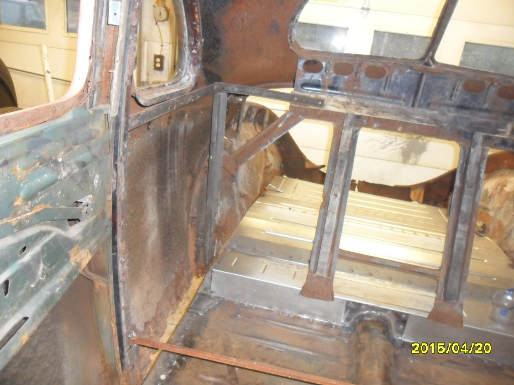

    Gee... I don't really have much of anything inside this coupe, mine doesn't "appear" to have ever had the vertical support from the floor to the bottom of the side window, and has a wooden support in the corner... though how it attached at the bottom remains a mystery. Here are a few progress pics. The EMS trunk and rockers in place, I was able to save the center section of the pink sedan's floor...
