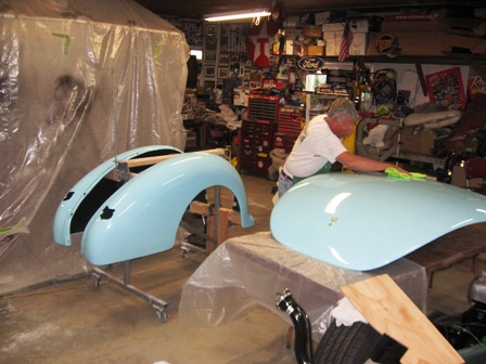

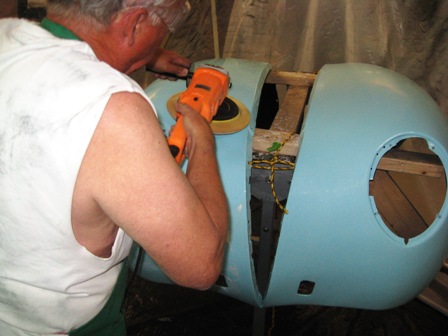

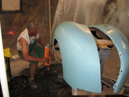

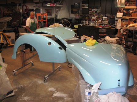

    Well we finally got around to cutting and buffing on the coupe fenders. Don shown here, has a little experience at this and I have none so we are going at it cautiously.
    We converted the rear end dolly with a little bit of 2x4 fabrication to hold the fenders at convenient height.
    A small bolt was placed at the bottom of the front fenders to hold them together and two wood screws through the rear fender brace holes hold the back. A couple of small ropes keep the fenders from spreading in the middle.

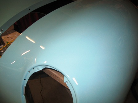

    Today we cut the orange peel with 1000 grit then gave it a second cut with 1500. I think I will get some 2000 grit and make one more pass before we buff them.

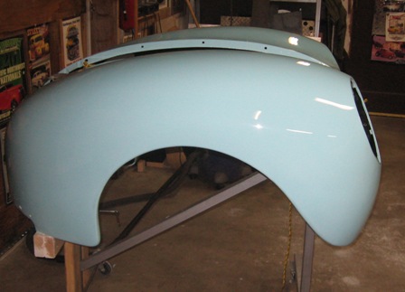

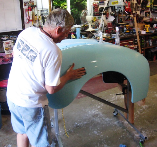

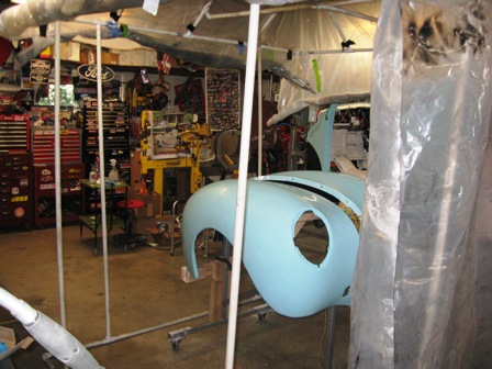

    After a pass over the fenders with some 2000 grit sand paper we set up the portable paint booth again to contain of the buffing spatter.
    Don was volunteered to do the buffing since he had done it at least once before.
    We used Norton Liquid Ice Extra-Cut with a Norton Liquid Ice #3 pad followed by a clean #3 pad and Meguiars Mirror Glaze 9 Professional Swirl remover 2.0.
    With the sanding prep we had done it did not take too long to do the fenders. Thankfully the shop is air conditioned and the lighting is tolerable.The temperature outside was in the 90's.
    The pictures can do this shine justice but I will post a few of the finished product anyway.
    Mike the painter did a good job on these fenders. The paint had very little orange peel and there was enough clear on them to allow us rookies to cut and buff the paint without wearing through the clear.

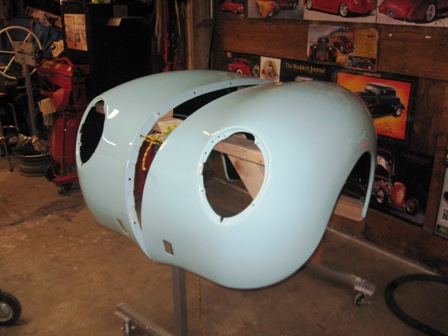

    Thanks for the tips on the fender welting guys. I had to do a lot of yard work the last few days so progress is a little slower than usual........
    We finished cutting and buffing the rear fenders and trunk lid today and started sanding the the hood.

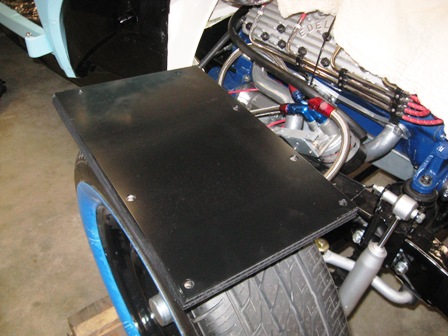

    With the body mounted we could see that the master cylinder sticks up through the floor much more than I expected. So that nice flat cover plate I made before went to the scrap bin and Don got busy shaping a new cover with a blister in it. Don used the shot bag and nylon hammer to rough out the shape before planishing.
    The HF planishing hammer has been sitting in the shop collecting dust throughout this build. Don spent some time fiddling with it and added some oil to the hammer and it worked great.
    He started with a blistered cover for the transmission governor. The governor was barely touching the floor but we thought a little extra clearance would be a good idea. We made the hole large enough to allow the governor to be pulled out for servicing from the top.
    Next was the cover for the master cylinder. Besides the shot bag and hammer Don also employed the bead roller to match the bead on the floor.
    I spent way to much time installing nut-serts in the floor to hold the covers in place. But it came out nice and will be easy to remove the covers. I painted undercoated on the bottom side of the covers and painted them with undercoater with clear coat, same as the rest of the floor.
    I decided to use the wood floor boards but also decided to put a thin aluminum cladding on the bottom side of the floor boards to protect the wood from water and oil.
    I used alignment punches to mark the mounting holes in the aluminum.
    I used 3M High strength 90 adhesive to bond the pieces.
    I didn't need all of the holes in the drivers side cover so I made some patterns for the throttle hole block off plates using clear plastic.
    I found some wood dowel for the dimmer switch holes. I glued them with white Elmer's glue.
    Sanded smooth and ready for the plate and paint.
    I had to trim the boards down a little to get them to fit the hole and with the gasket on them.
    You can see here that the Drake floor board gasket was considerably oversize.
    I had to cut the gasket apart and section it in order for it to fit snug to the cover.
    I used this 3M product on the covers for the first time . I like it better than the yellow. I had a little more time to work with it and seems to adhere well.
    I won't bore you with all of the pattern making and cutting it took to finish putting the Dynamat in. I did learn though that it should be the last thing you put in unless you intend to keep it covered with something as it it tends to ooze some of the tar ( whatever it is) out of the joints which can ruin your clothes and tick the wife off if you forget to change clothes when you go in for dinner..........
    Next was the Dyna Pad. This stuff was another time eater. It seriously tested my patience (lots of patter making) and the darn glue fumes could kill you. The pad cuts easily with scissors or utility knife but you better be careful when you place it on the glued surface because it is not easy to reposition........ I used 3M Supper 77 adhesive for this project. Before I started my second gluing session I took great care to ventilate the area.
