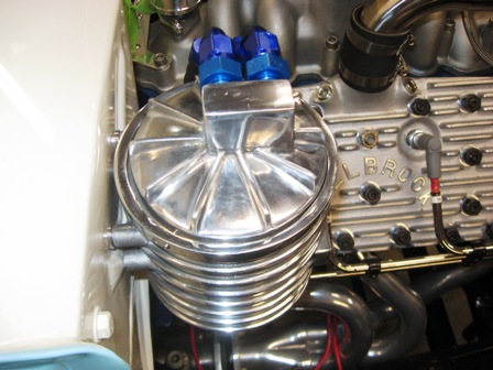

    I bought a Hildebrant oil filter system from Obrien Truckers a while back. I bought the polished version and was pretty happy with the polish on the body of the filter housing but decided I could improve on the polish of the top piece. After spending way too many hours polishing this lid I decided that I probably should have left it alone. This picture was taken after I had already done a bunch of work on the piece.
    After way too many hours of hand work it came out like this. Much smoother and easier to keep clean I hope.
    I now wish I had used black fittings for this but I will go with the blue for now.
    The hose routing.
    I used a couple of clamps to hold the oil line away from the header.
    That is all temporary wiring .
    As I think I showed earlier the hose out of the pan is way too close to the starter but will work.
    Finished!

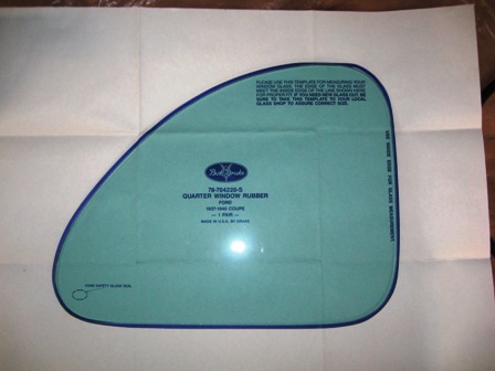

    Gl*** Install:
    My Buddy Jeff came over today and helped me install the gl***. We prepped the area with some foam packaging material and masking tape. We didn't know how rambunctious we would get and how many tools might get dropped in the process. This was my first attempt at installing gl*** other than helping Jeff with a Mustang window a few months ago. We didn't get many pictures because it took both of us to put the gasket on the gl*** and one guy inside the car holding the gl*** while the other pulled the rope to pull the gasket over the body flange.
    Here are the tools we used. I bought the rope tool and the ball ended tool from Bob Drake. I didn't use the ball tool very much because I was afraid I would break the gl*** with it. The rope tool itself was of no use to me but the nylon rope worked very well. The yellow resin tools were very handy for moving the rubber gasket around. The spray on gl*** cleaner is very good lubricator and leaves no residue when you are finished.
    Each of the Bob Drake rubber seals came with a template sheet. It says to make sure your gl*** fits inside the lines.
    None of the 6 panes of gl*** we installed matched these templates but all fit into the gaskets and the car without problems.
    I think we may have installed the front gl*** panes in the wrong order. I think you should install the PS side pane first as it's center gasket flange goes on the back side of the gl***. While the DS gasket goes on the front side of the gl***. We had a heck of a time getting the gaskets reversed.
    So there it is, I should have no bugs in my teeth on the first test drive..... It took about 4 hours for us rookies to install the gl***. I bought the gl*** from Bob's Cl***ic gl*** in Eugene Oregon. The price seemed fair and so far it all fits and has not cracked.
