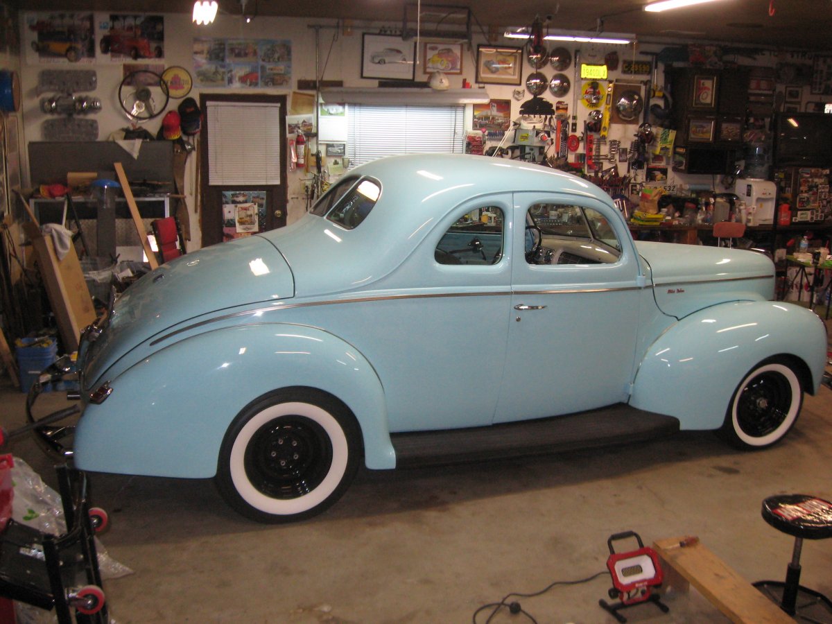

    falcongeorge the tires are Toyo's from Diamond Back. Fronts are 20560R15 24.7" high 6.5 inch tread width 8.3" section width. Rears 225/70R15 28.3" High 5.8" tread width 8.7" Cross section. The are mounted on Wheel Vintiques Gennie wheels. Fronts are 15x6 with 3.75 back spacing Rears are 15x7 with 4" back spacing

    I'm doing 6.00x15 on the front, which are almost exactly an 1" taller, so I should probably mock it up without a reversed spring, and then decide from there.
    The black one with the starfire caps that was at the East/West Reliability Run sits EXACTLY how I was visualizing mine sitting. Its PERFECT. I flipped when I saw Chris' side on shot of it.

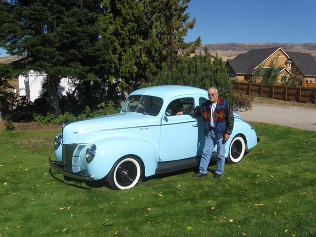

    Thank you gents, glad you like the coupe. Uncle Mike (The inspiration for the build) came over this weekend and we put some miles with smiles on the coupe! He said something like" it still sounds and drives like he remembers it when he bought it so many years ago in Montana".o_O Well it still is a flathead with column shift and we did capture the old Ford feel I was hoping for.

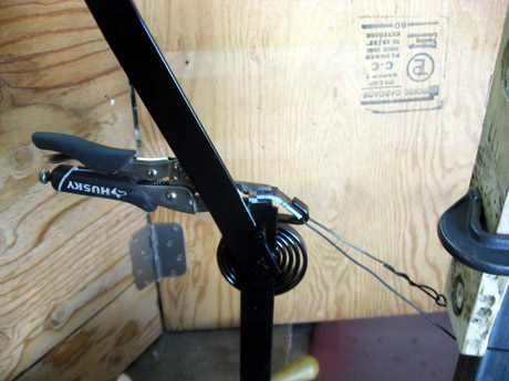

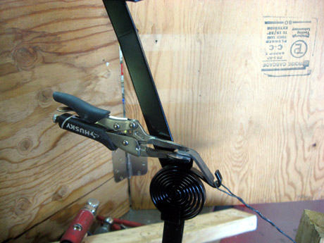

    Here is another project:

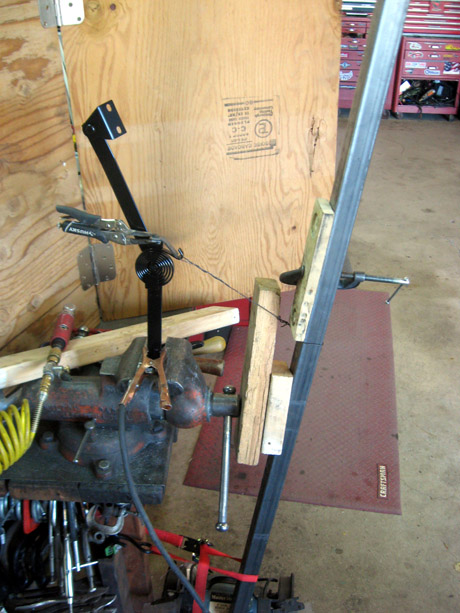

    In the mad rush to get the car together we had a casualty. Don's brother suffered a scalp gash about two inches long that required 6 staples! We thought the trunk spring was a little weak but it was holding the trunk lid up so we moved on to installing the bumper while the lid was still up....... While shaking the car around to install the bumper the trunk lid came down hard on Dan's head.
    So not wanting a repeat of this problem and not wanting to install the air shock kit I bought I went back to my saved threads and found one that 19Fordy wrote on modifying the stock trunk spring mechanism.
    http://www.jalopyjournal.com/forum/...ing-40-ford-trunk-hinges.152557/#post-1691239
    Of course I wouldn't be a Hot Rodder if I didn't make some modifications to his idea.........

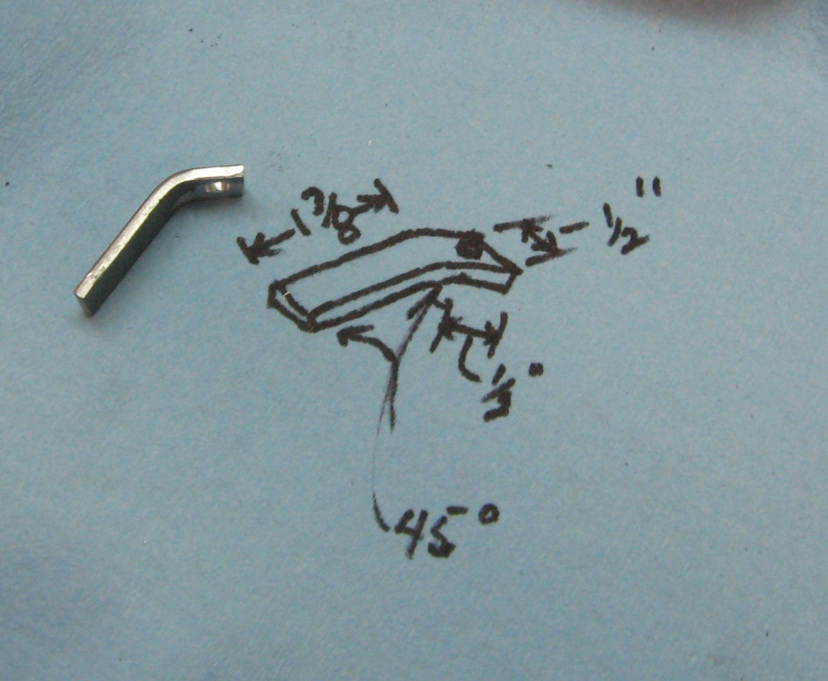

    To start out you cut a piece of 1/8" thick steel 1/2" wide x 1 7/8" long and bend it 45 degrees at the 1/2" mark. I drilled a 1/4" hole for a plug weld . 1940 bolted his on with a 1/4" x28 thread bolt.

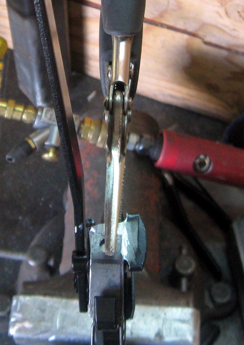

    The tricky part was pulling the spring back so that the extension could be positioned for welding.
    I clamped the extension in place and welded it on.
    A long lever made it easy to pull the spring back but getting it to stay there without another set of hands was challenging. I think I rigged it different each time I stretched the spring.
    You can see the difference between the stock spring on the right and the modified spring on the left. The modification adds tension to the spring by tightening the spring wrap.
    Finished!
    The modification is doing it's job. Some people have said that Bob Drake or Dennis Carpenter have come up with a stiffer spring for the aftermarket trunk hinges they are selling so you may not run into this problem. But just in case you do it's nice to know that you can do this modification with simple tools and a couple of hours of your time. You may be able to just modify your original trunk hinge and save a few bucks too.
    NOTE see post 463 for another modification that was made to the trunk hinges a few days later. I recommend doing the post 463 modification before doing the spring modification.

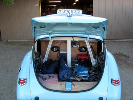

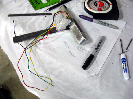

    Going back a week or two I had to modify my third brake light to make it fit my application.
    I found piece of aluminum and rough cut it with the saws all.
    After a lot of measuring and using the angle finder I found that a 45 degree angle would level out the third brake light.I drew this out and started cutting and filing with sawsall and files.
    Basic tools and patience.
    I decided to mount the big chunk on a flat flange that would allow me to use the 40's window garnish mounting hole. The one on the right.
    The bottom hole requires a new hole in the garnish molding.
    I drilled and counter sunk the bottom plate for some some size 6 screws and and then drilled and tapped the angled adapter for the screws.
    There was room under the garnish to use a nut on the bottom side of the garnish . I used a ****on head stainless steel screw in the bottom hole.
    After some more filing, sanding and paint the unit was installed.
    The angle came out pretty good. This is a Hoffman product. It is supposed to work as a third brake light and also as a turn signal light. We found that since we are using the LED tail lights and that fancy turn signal system that the turn signals would not work when my foot was on the brake. So Don disconnected the turn signal wires for now. We will look for a diode that will stop the feedback problem and give it another try

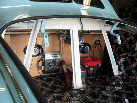

    I don't think I included a picture of the finished back wall. It is pretty busy. The stereo location is far from optimal. I did not want it to show so I hid it back here. I had hoped the remote signal would be able to penetrate the seat fabric or the wood cover. It doesn't ..... but if I point the remote between the seat cushions it will deliver the signal to the radio. I intend to run the stereo with an I Pod Nano anyway. Perhaps it will even work with the blue tooth function of the radio.The bottom line is that when you put the seat in there all of this stuff is hidden but accessible.
    Just another shot of the trunk wiring. Don spent a couple of afternoons in there.

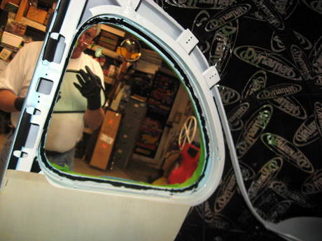

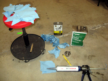

    The gl*** had initially been installed without any sealer so we took a step back yesterday and applied some sealer.
    Don...." Your are going to take a picture of this?" Yes... we put sealer on the inside of the 1/4 windows and along the inner edge as shown in the previous picture.
    I was finishing up and decided I should take a picture of the preparations. I was glad I took the time to protect paint. Being a rookie at this stuff I made a mess.
    I cut some shop paper towels into four pieces and soaked a little paint thinner on each piece before wiping up the excess caulk. That yellow trim tool came in handy for picking the seal flange off of the body before inserting the caulking tube tip.
    I went down to the local car gl*** shop and asked the installer what he used to seal flat gl***. He recommended this DOW BETA Seal U 418 Urethane sealer. He also recommended buying this heavy duty caulking gun from Lowes 9about $15.00. His second recommendation was to warm the stuff up before trying to use it. I warmed it up in my little toaster oven to around 100 degrees.
    In retrospect I would probably take the car to the gl*** shop to get the windows sealed. That stuff was hard to get out of the tube and once unleashed was hard to clean up...... The gl*** guy has a $500 electric caulking gun to squeeze it out of the tube and would hopefully control the application resulting in less clean up. The job came out alright though. It says it takes about 13 hours for this stuff to cure well enough to drive the car.
    I applied sealant between the overlapping center flaps on the front window and my wife helped me install the stainless divider. That was the easiest part of this project. I hope it all is watertight now as I seem to end up in downpours at least twice year going to and from shows across the Cascade mountains.
