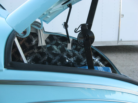

    We have put about 400 miles on the car so far.We are slowly checking off all of the little things we have found to fix or modify. We took it in for an alignment check today. We had set it pretty close with the tape measure so he didn't have to do much. The castor was just under 6 degrees. Nick said it was the best dropped axle car he had seen in awhile.

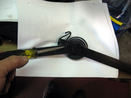

    So a few posts back I made a trunk spring modification. At first I thought we had the dropping trunk lid problem solved but after a couple of days it became apparent that the lid could still be dropped by a gust of wind......:eek: So I decided to try another modification that I had seen done on these 40 coupe hinges.
    It is kind of hard to see but the pin I am pointing out stops the rotation of the arm. My plan calls for routing out the socket out about 3/32"
    To get access to the socket I clamped the arm in a vise and then used bailing wire to hold the arm out of the way.
    I used an air grinder with cylinder bit with flat end to make the cut.

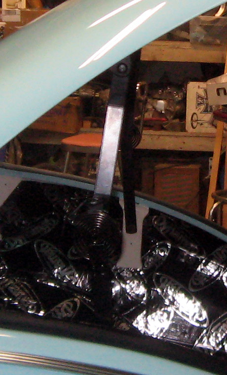

    Before the modification the open hinge angle was 28 degrees.
    After the modification the open hinge angle is 14 degrees.
    Before modification.
    Sorry the picture is bad but this is after the modification.
    Another lousy picture of a good modification.
    Hows it work? Works good. You now have to apply some down pressure to get the trunk lid move down. I would not want to apply any more pressure than this takes to start the lid down . Possibly the spring modification would not have to be made if you try this modification first. I will feel much better about leaving this trunk lid open around the grand kids and friends now.

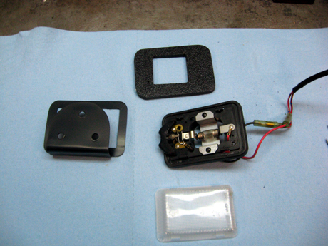

    I wanted a trunk light and I had taken this one out of a Honda P***port (I think) last summer. I had to build a bracket to mount it The bracket on the left was made from some aluminum flat stock, The piece at the top is 1/4" thick ABS plastic.
    I bolted the bracket to the license plate frame mounting studs.
    The aluminum bracket is then sandwiched between the light and the ABS piece.
    It's a little modern but I like it. It should be able to survive having the lid slammed onto the junk in the trunk on occasion.
