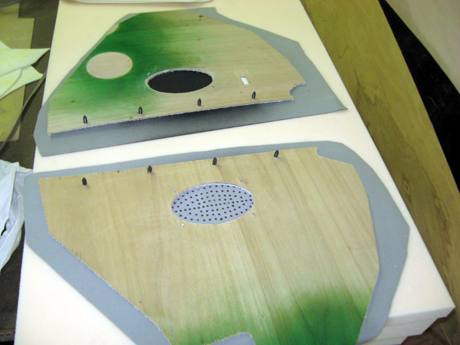

    I asked for a simple black panel under the package tray. It will not be seen much as the seat will cover it . I wasn't expecting the screws to be used to hold the panel but will let that slide.

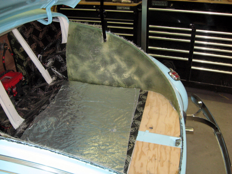

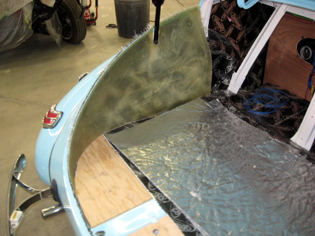

    They made these nice fibergl*** side panels for the trunk. They were going to put the removable panels in directly under the trunk drip edge. They did a nice job on them but I asked them to extend them to white braces as I told them I wanted the removable panels to be attached to the braces. I want to be able to use as much of that spacious 40 trunk as possible.
    Just noticed that nice curved edge will require modification to the tool storage covers......I will have to call and talk to them about that.

    Kick panels with perforated speaker area.

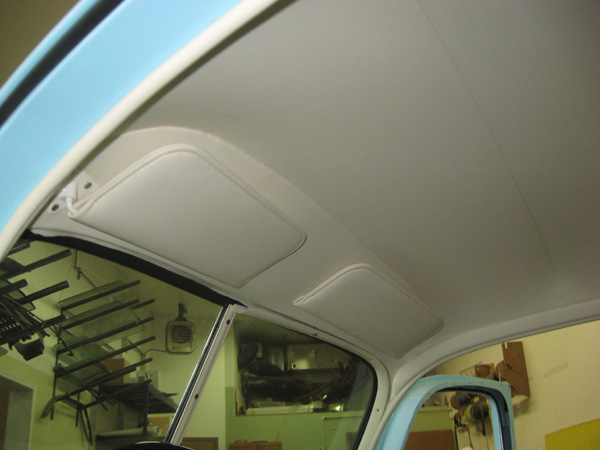

    Package tray and headliner . Jacob said that he stapled the headliner to the plywood base of the package tray instead of using the stock ford style tack strip.
    Headliner with visors.
    It is good that I was able to take these pictures of the door and quarter panels today because once the seat is installed it is hard to get a clear picture of them. Notice how Jacob made the wind lace match the trim. I think it is a nice detail.
    They got the headliner nice and tight. Those little spots above the quarter windows just would not stretch out though. Notice the trim above the door. Jacob did not want to use the stock metal strip that is supposed to go there. He said it was too crooked and that he could stretch and attach the headliner better with this fabricated strip. I am happy with that.

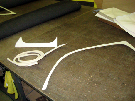

    Covering the seat back trim. If any of you guys know what this seat came out of I would like to know.
    The arm rests are new 56 Chevrolet 210 type . They came black but we chose to cover them with the off white fabric and paint the bases to match.

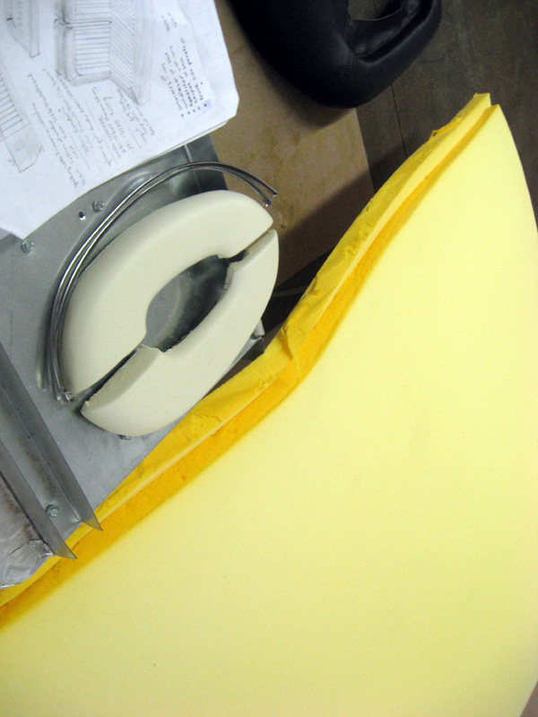

    Thanks guys! It is great to have you all still following the thread. Jacob called me again Monday and wanted me to come out for a consult on the trunk layout and the a fit to see where the arm rest should go.
    It is kind of hard to see in this photo but the pattern for the sides are drawn on the tape. The removable storage compartment door is also marked out on the plywood. The inserts will feature 2" white pleats.
    The new seat foam has been cut and I gently sat my **** on the seat and checked for arm rest position. In the end the placement will be a compromise as there is not much usable space to place them as door handles, door panel pattern and steel structure of the door limits location possibilities.
    After years of driving my 39 without arm rests I will be happy to have something to rest my arm on when it is too cold or wet to rest my arm on the door sill. I always noticed the absence of the arm rest more on those rare occasions that I was a p***enger in the 39.
    It appears that Jacob is concentrating on getting this project finished so I may get the car back in a week or so. It's like waiting for a first child to be born..........
