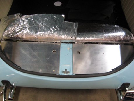

    Project number two was needed to repair the trunk tool box covers. One of the covers I bought from Bob Drake broke when I applied my substantial weight to one knee when crawling into the trunk.
    I did not have time to fix earlier so I had just been trying to remember to plant my knee on the latch brace when entering the trunk.
    I was unable to find plywood that was the same 3/8" thick as the Drake pieces but I did find some 1/4". I did intend to add some metal cladding to the pieces anyway so by using the 1/4" plywood and some 1/8" aluminum sheet I was able to come up with the 3/8" dimension I needed. I traced the pattern off of the the Drake pieces and made a few minor adjustments for a better fit.

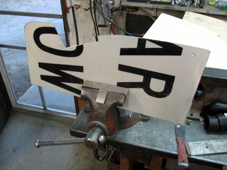

    I had some old signs that were the right thickness but did not want to leave the sign material on there.
    I used a heat gun and a putty knife to remove the signage.T hat still leaves the adhesive which came off fairly easy with some Lacquer thinner.
    I roughed up the bottom surface with some 40 grit paper. and then used some super 77 3M spray adhesive to glue the aluminum to the wood. A word of caution here. It would be a good idea to leave the aluminum slightly over size before gluing as this glue allows no movement once you have set the two glued surfaces together. Once the glue is set you can use a belt sander to grind the aluminum down to the wood contours.
    I used a 1" hole saw to drill the finger holes . The Drake pieces only had a hole in the p***enger side cover. Did any of you notice this on the stock pieces?
    The upholsterer had left the tool cover portion of the insulation attached to the floor portion for some reason. I decided to cut it loose and then glue it to the covers with the 3M spray adhesive.
    A slightly fuzzy picture of the end product. I can now confidently place my knee anywhere on the covers without fear of breaking through. For now I only have the battery maintainer in this tool area so I don't need to get in there very often.
