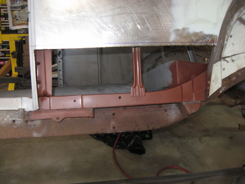

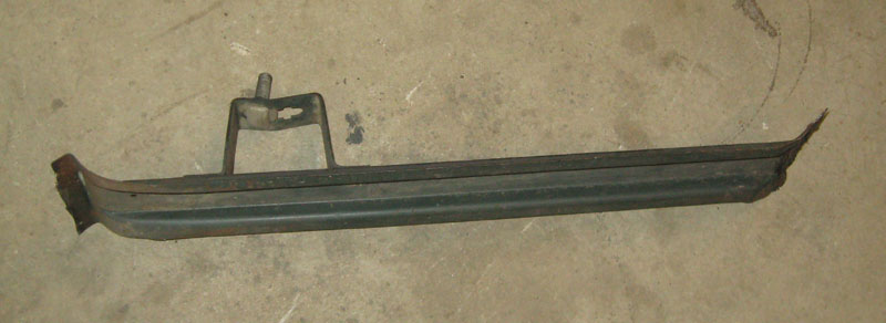

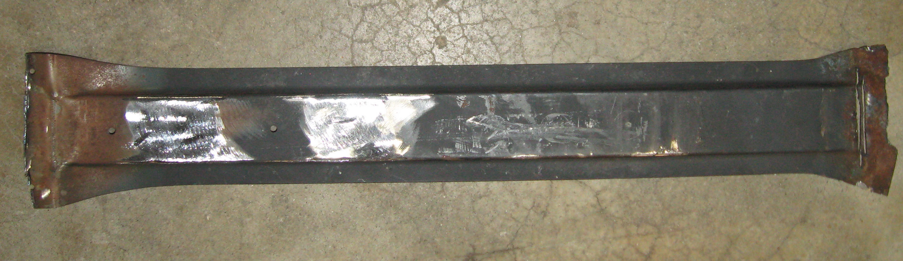

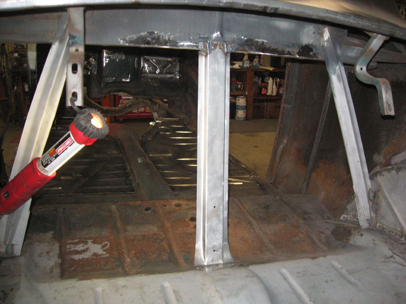

    Here is what both panels looked like. Lots of extra holes for a variety of seats and plenty of rust. fortunately a quart of 30 WT oil had been left in the car and leaked all over behind the seat leaving that area dirty but clean of rust on the top side. So we did not have to use the full floor pan.
    We welded a one inch square tube support in to keep the drive line tunnel in place.
    The floor stiffeners were cut off of the old floor and transferred to the new floor. I read on the HAMB since doing this project that these stiffeners are being made by someone. Please feel free to chime in and let the guys know if you know who that is.
    Notice the panel is drilled for plug welds. Not all of the contours lined up perfectly. We had to do some hammer and dolley persuasion to align some of them. F8.jpg
    By this time in the project we had built the rotisserie. It is so nice to be able to just roll the car over you and position it for easy welding. We had access to a spot welder but chose to use the mig, and plug welds. The spot welder required very clean metal and very tight joints. Not to say we didn't get em tight and clean but I just prefer the plug welds.
    Plug welds before grinding.
    Here the rocker panel is welded on. It was a nice piece. We trial fit the door to make sure we had it in the correct position.
    Ok, one down and we repeat on the DS.
    We cut the grooves in the tunnel so it would be easier to blend them to the new floor panel. Once the floor panel was tacked in place we went back and hammered and dollied them to shape and welded up the seams.
    Note we left some of the original floor to weld too at both ends of the door opening.
    Not a good picture but there it is , a nice clean floor with no holes.
    After removing the frame and sandblasting the area I was able to go back and weld the bottom side of the floor to cowl connection.
    After sandblasting we did find a few more holes farther back on the original floor pan where it was double thickness.
    So that's it for the floor. Not very good pictures this time. I must have been to caught up in the work ( translates, having too much fun) to remember to take pictures.

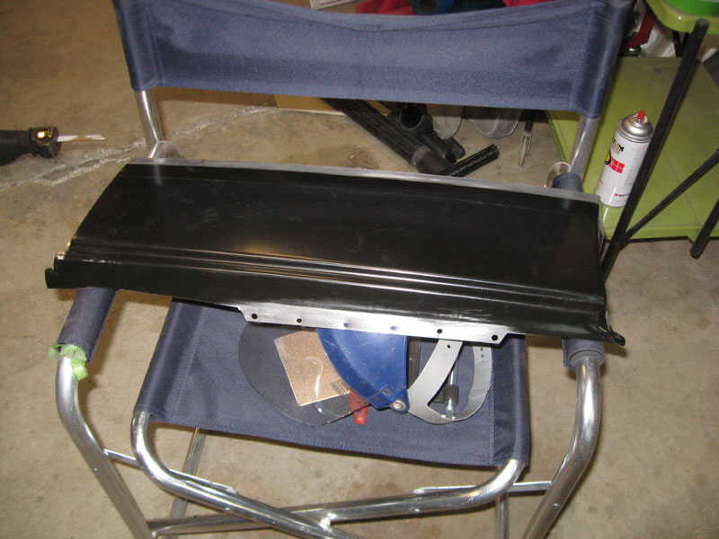

    Quarter panels were next. Before the body was sandblasted I had tried to make a repair on the p***enger side quarter panel and I did not like the results. As many of you may have discovered small holes become big holes as soon as you touch them with a welder. After sandblasting I found that the DS quarter was not only rusty at the bottom but the first few inches were pretty thin also. So I decided to take a chance on welding on some patch panels. I really was concerned that I would end up screwing up what was a nicely contoured quarter panel. As usual I took a lot of pictures so I could do***ent the process and ultimately share it with the HAMB. So this may take a couple of posts to get through the project.
    So here is the panel. It does not look like there is too much rust but you can see some of it just above where Don is drilling the spot welds out. There were also several small pin holes in the first 5 inches of the panel. I didn't want those holes to become rust bubbles under my nice new paint job in a few years.
    The new panel purchased from Bob Drake. A nice looking piece with pretty accurate contours.
    We laid the new panel over the body and marked it with a sharpie.
    We made a new cut line 1/2" below the first line to make the initial cut on. Notice the verticle line in the door post. We thought this would be a good place to hide the seem and that it would also retain the door gap.
    The first cut was along the top cut line and otherwise inside the intended new panel lines. We wanted to see what the substructure looked like before we committed to the final borders of the cut.
    You can see that even though I tried several different angles with the sandblast nozzle I had not been able to clean the metal in this area. This reminds me of advice given by a fellow HAMBER recently that if you intend to make a panel repair in an area like this you should cut the metal away before blasting so that you can get the inner metal clean.
    Substructure on this side of the car was in pretty good shape. The old bottom edge of the quarter panel was stripped off of the substructure at this time.
    Not wanting to drag this out and sandblast this area I chose to wire wheel and sand this area to clean it up.
    The area was primered with Rustoleum primer for rusty metal.
    New Panel prepped for spot welds.

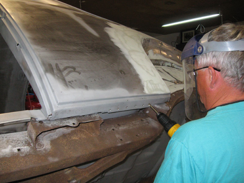

    We put the door on so we could confirm contours and door gap.
    I wanted to show how we cut the top edge of the panel and since I didn't get a picture on the drivers side I will throw in this picture from the p***enger side. With the panel laid over the original panel we marked a line 1/4 inch below the edge of the new panel and used the dremel cut off wheel to cut through both panels. The dremel is easy to keep on track and cuts a very fine (Thin) Kurf. Yes it is slow but I work for free and I don't like jagged gaps.
    Don working on the door gap interface.

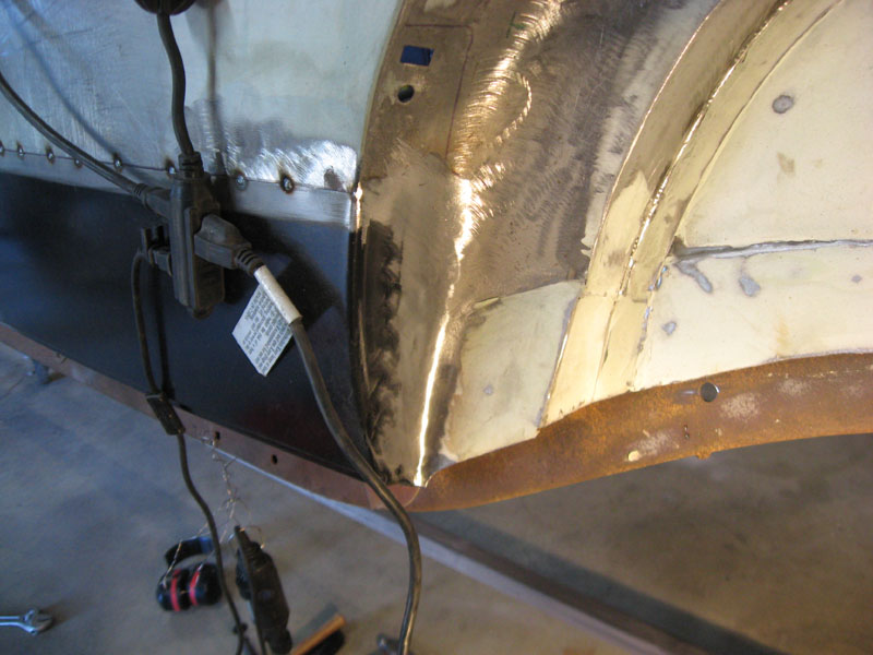

    We chose to bring the panel around the corner so that we could weld and grind the panel in side the wheel well.
    This door jamb area became quite problematic. Eventually a lot of time was spent getting the contours to match and the door gap correct.
    Grinding this to contour was done mostly with the cut off wheel of the dremel tool.
    Door jamb and wheel well welds are done and I started slowly connecting the spot welds allowing the metal to cool to touch between tacks. It helps to have other project to do while you are allowing the welds to cool.
    You can see here that the first holes we drilled for the spot welds were too far in and we had to drill some new ones and plug weld them.
    We checked the back side of the welds to make sure we were getting enough penetration. DS32.jpg
    The finished weld. We were pretty happy with it. There was very little shrinkage. We did not use the hammer welding technique that is usually recommended for this type of panel. If there is any hammer and dollie work needed on this panel we will let the painter take care of it.

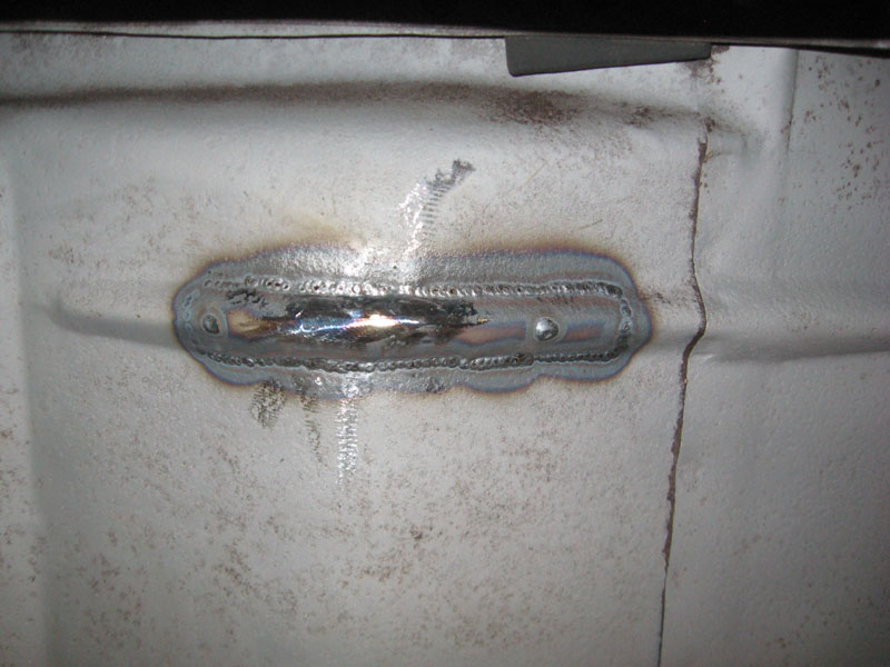

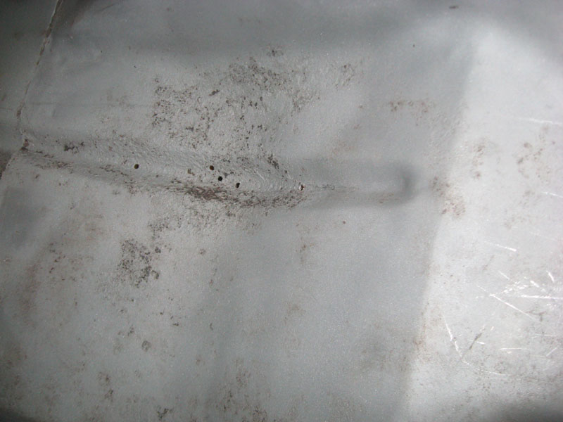

    Next was a little floor repair.
    Inside of the car view.
    Don made a steel patch on the shrinker stretcher
    I first filled the holes with plug welds while Don pushed down on the patch from above. FP6.jpg
    I then welded all around the perimeter of the patch from the top.

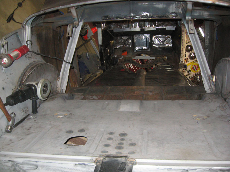

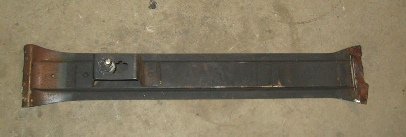

    So I had been looking at this spare tire mount in the trunk for quite awhile. I didn't like the way it went so far into the p***enger compartment. I don't intend to carry a spare since I am running big and littles on the car. Besides that's what cell phones and credit cards are for. I didn't want to take it all of the way out of the car because I think it is a good stiffening element in the car. So I took it out and modified it a little before welding it back in.
    Lousy picture but you can see the spare tire brace welded to the front of the seat pan.
    Cut it out. I had to make a few weld repairs to the upper brace.
    I also filled some holes in the seat pan while I was at it.
    The brace before mods.
    I ran some string line between the two outside braces.
    I had to reshape both ends of the mount then welded it in at the same angle as the two outside braces.
    So that's it I hope it gives me a good brace for trunk interior panels and a little bit smoother look in the interior of the car behind the seat.

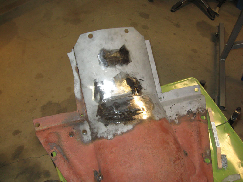

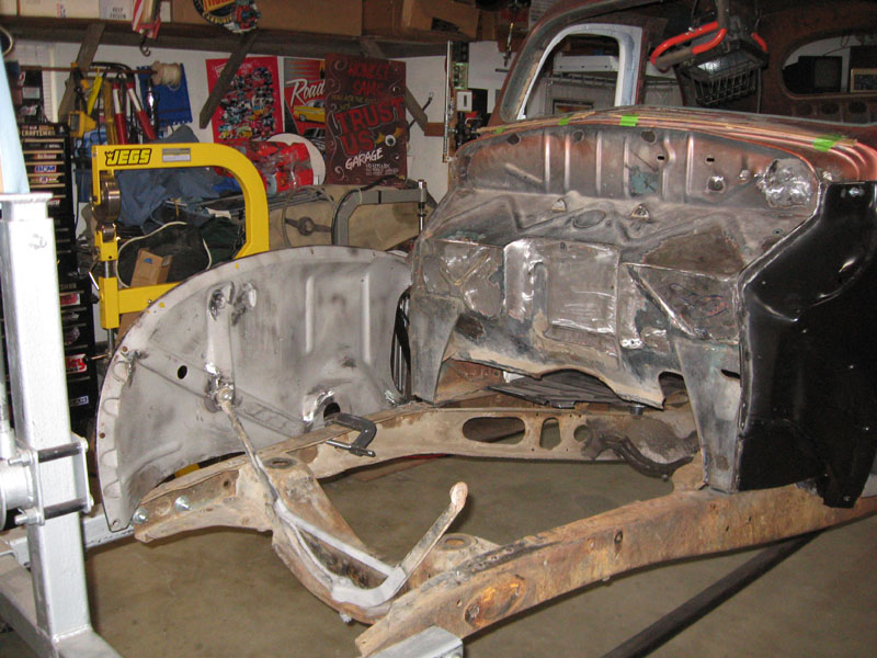

    We had this PS inner fender that was in pretty bad shape,we also know you can by reproduction ones. But I had seen the repos (not the great) and decided that this would be a good place to practice our skills. We put way more time into this piece than is warranted but we had fun,learned a few things and I think we came out with a piece that is better than a reproduction.
    It seems like all of these panels are ripped here. Ford chose to use just one bolt here and there must be an awful lot of stress put on this spot, especially when you get in a fender bender. IF3.jpg
    Just another view of the missing bolt flange and a crack that ran vertical from the middle. IF6.jpg
    I can't remember what Ford used the staples for but they sure left a ragged hole.
    We did a lot of hammer and dollie work to get wrinkles out of this piece. IF10.jpg
    Mig welded it in.
    Ground to contour.
    Another patch.
    Patched the back corner.

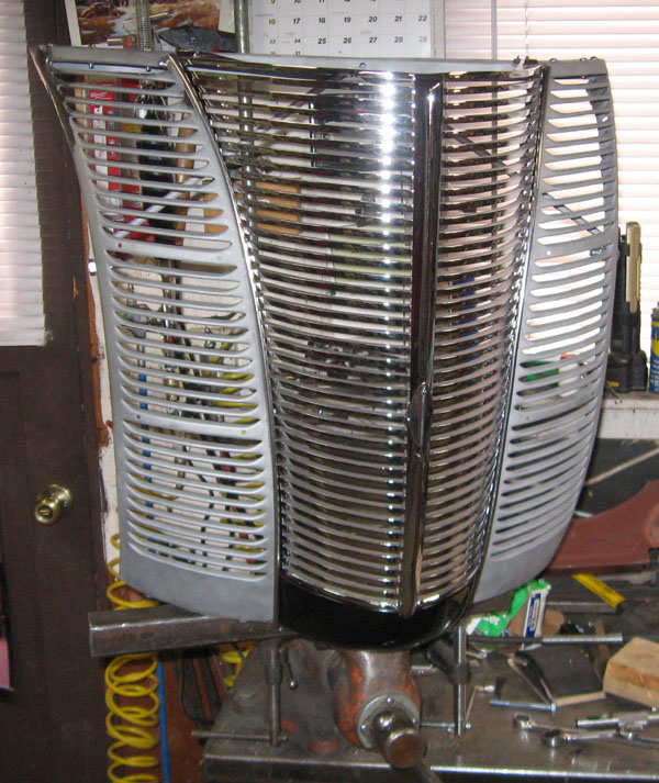

    Ok here goes the grill project. The grill center in this thing is a two piece aluminum thing. It is ugly and didn't fit well. If any of yo out there recognize this thing I would like to hear from you. I am curiuos about who made it , when and whom was it sold by.
    The grill had taken a few hits. The arc or curve was flat in the center. The top section was pulled down. and the top corners of the the grill sides were torn. Several of the fins or louvers had to be straightened and reshaped.
    P***enger side was mangled. Once again I could have bought new ones but there was this challenge.... G3.jpg
    Drivers side.
    A little more evidence that this car must have been a hunting rig or maybe a moonshiners ride. I decided to buy a new chin piece but will keep this old one and hammer it out some day for a spare.That bottom plate was saved. G6.jpg
    Another view of the grill center.
    This is supposed to be flat across here. I managed to straighten this on the hydraulic press.
    Just another view of the damage on the p***enger side.
    Inside view of the drivers side.
    After an hour or two.
    We decided to weld in some gusset plates on the back side. They are out of site but give me piece of mind that the grill will not crack and split at the weld repair.

    It took many hours of patience trying trial fitting and metal shaping to get to this point.
    The masking tape was added to the vintque grill to protect the chrome during the many trial fits.
    I decided to cut 1/2" out of this grill support so that an air diversion plate could be installed on top of the grill. G24.jpg
    My first chop job.
    The plate now fits flat on the top. I found this plate at a swap meet. I will either paint it or get a new one.
    After a trip to the painter I laid out all of the parts for the ***embly.
    Putting freshly painted parts together can be nerve racking.
    A few hours later and some pushing here and pulling there we have the final product.It took about two weeks of work to restore just this one element of the car. It now sits up high and out of the way waiting for its final install. I take a look at it when I get a little bogged down in rusty stuff and dream of seeing the rest of the car looking this good someday.

    I'll bet that original grill center was a J.C. Whitney type South American repro. That was what was available before Drake & others started reproducing better parts. Great build, by the way.
