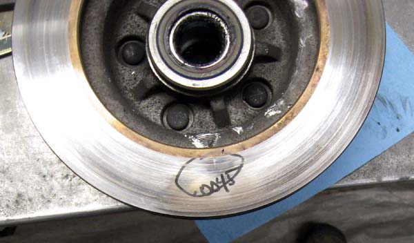

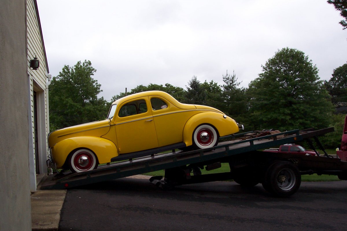

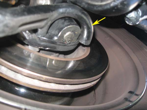

    Here is an update. Not all trips go as planned. I was cruising along about 65 miles an hour last July in the middle lane just 2 miles short of summit Snoqualmie P*** in Washington State on my way home from a Goodguys show.
    All of the sudden I heard this terrible metal on metal sound. So I quickly made it to the narrow shoulder of the road and proceeded to ***ess the the situation. All vitals on the motor check okay and the a quick look under the car showed no problems. So I tried moving forward again and the grinding noise was still there. So I fortunately decided to try out my Hagerty Insurance towing option. about an hour later the rollback picked me us up and the journey home began.
    The car pulled up on the roll back with just a little noise. When rolling the car off the rollback it stopped moving at one point. So the driver pulled the car back on a little and then let it back down. It rolled easy at that point. When the car was rolled away from the tuck this bolt was laying on the ground.

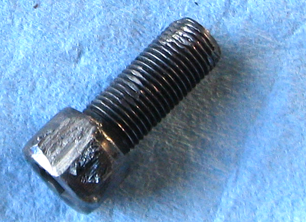

    At first we were not sure where it had come from but once we got the car home and up on blocks we found the problem.
    The bolt was from the bolt on steering arm (drivers side). It had dropped out and was tumbled around inside the rotor causing all sorts of mayhem. The steering arm was still in it's bolted in position but when I gently grabbed on to it and pulled it down to the position it is in in this picture.it was clear where the problem was.
    At first we thought that the damage to the rotor was just the superficial nicks made by the bolt as it rattled around inside the rotor. Later on we discovered that there was actually a .045 bulge in the brake surface and 3/8" crack.
    So it looks like during the fabrication stage of the ch***is while things were being fit and tested then removed for painting etc., I missed actually tightening this fastener correctly.

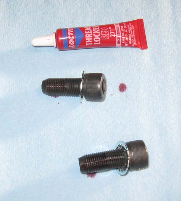

    When I put the ***embly back together this time I used red loc***e compound271 and an internal lock washer along with sufficient torque and safety wire to make it and it's three companions very difficult to remove.
    I feel very fortunate that the bolt did not fall out immediately as I may have chosen to drive the car at least another 40 miles to my brothers house before I gave it a closer inspection. That may have been disastrous for me and others on the road near me.
    So my lesson learned and now shared with you is check and double check your fasteners during ***embly and at least annually if you are putting miles on your car each year.
  19. I am relieved to learn that you stopped when you had the first warning of the failure. A tow is a lot less expensive in the long run. I can't see your repair coming apart, ever.

  20. tomkelly88
    Joined: Aug 31, 2010
    Posts: 382
    tomkelly88
    Wow, scary! I'm glad you pulled off to the shoulder and stopped.
    A similar situation happened in a friends 39 coupe. A brake caliper bolt worked its way all the way out, the caliper was then able to flip upwards/forwards and punched a hole in one of his Halibrands.

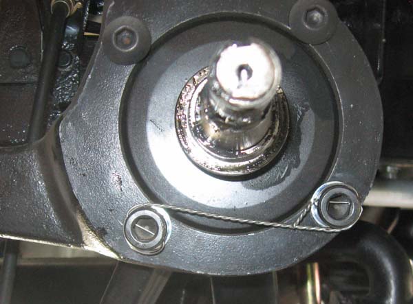

    Since I built both of my current Hot Rods and am lucky enough to have a lift... every year come spring I do a complete inspection underneath and elsewhere to at least try and spot any potential problems or failures.

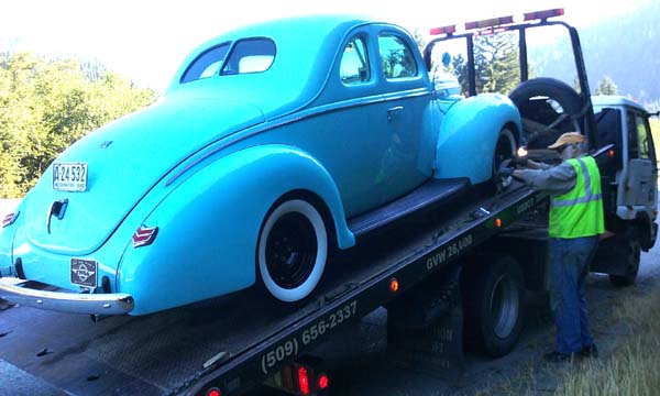

    100_9737.JPG Glad to hear you and the car stayed safe. My car has had to come home like that twice. 101_0125v2 (2).jpg

    A lift is om my wish list. For the foreseeable future I have to make due with jacking the cars up and putting them on blocks.

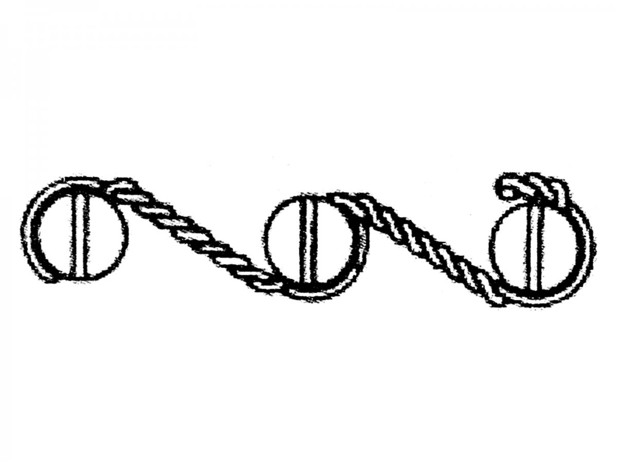

    j=jock I am certainly no expert on safety wire. I keep this drawing with my safety wire pliers and the sketch comes out of the tool box with the pliers each time I have to use them.
    Hot Rod Magazine had a good article awhile back that covers the subject well enough for an amateur to understand the theory and do a simple project.
    http://www.hotrod.com/articles/1003cct-how-to-safety-wire/#
    The above is another good example for multiple bolts.
    Not too many tools are required to do the task. The pliers and some wire will get you by. The drilling fixture is one thing I don't own and have never used but I am considering buying one.
    40LUV That sure is a pretty coupe! Do you have a 3/4 view form the rear of that car off the rollback? I would like to add it to my album if you are willing to share . Like the tail lights too. I expect if I drive mine enough that it will catch a ride on the roll back again also.

    Thank you for sharing your incident with losing a bolt. The bolt falling out and fouling things up is a relief vs them silently falling out. Good detail on safety wiring and a safety wire looks good when it is done properly. The FAA Aircraft Maintenance std AC43.13 has good information on safety wiring methods. Page 376 or 7-311.
    Here is a link to the FAA's free on line copy.
    https://www.faa.gov/do***entLibrary/media/Advisory_Circular/AC43.13-1b.pdf
    Aircraft Spruce And Wicks Aircraft sell the tools, steel and SS wire with a vast selection of AN drilled bolts. Not sure where AN bolts fall on the scale compared to automotive bolts so that would be a point to clarify before using them.
