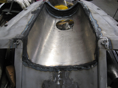

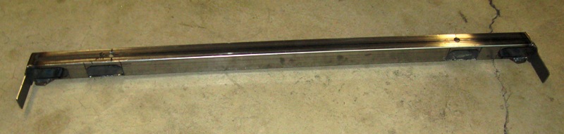

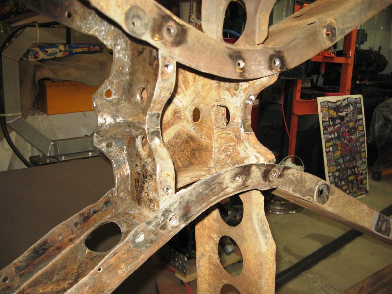

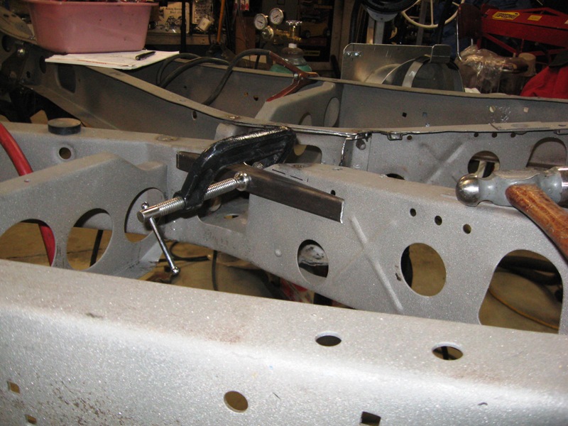

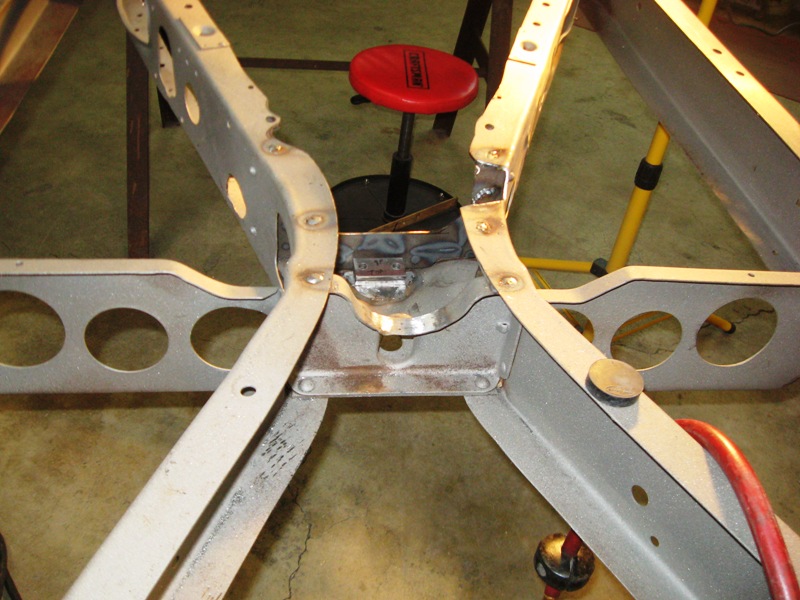

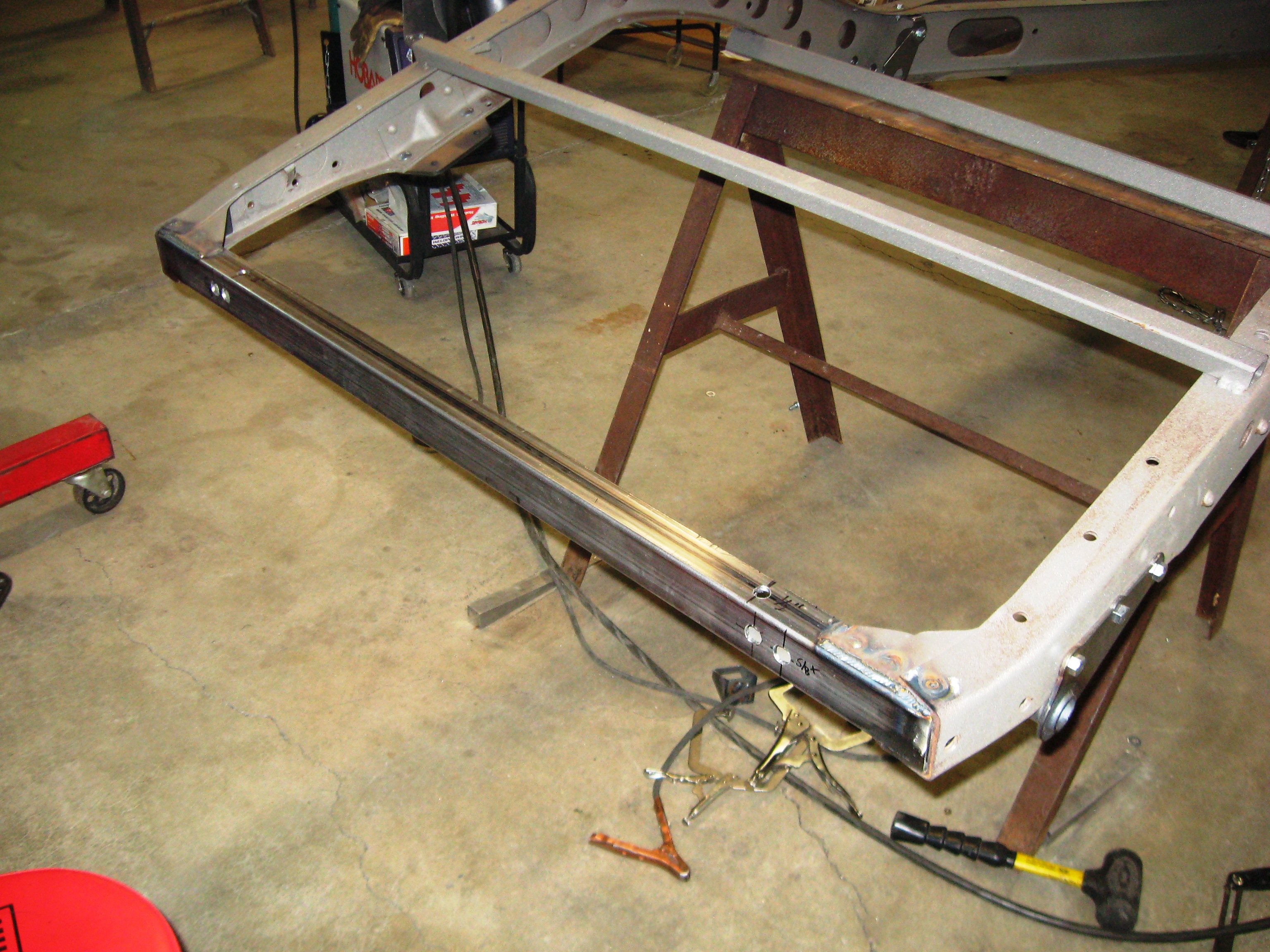

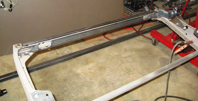

    Why was the rear crossmember removed? I am at the same point right now on 39 Ford Standard.
  12. The 39 guy
    Joined: Nov 5, 2010
    Posts: 3,773
    The 39 guy
    allanjon, we were not going to run the transverse stock spring, so the crossmember was no longer needed. If you are talking about this rear crossmember, it was removed because the original was twisted. I also wanted a more substantial (tubing) cross member there in case I want to install a hitch there some day. Having the spring crossmember out of the way also allows for easier exhaust system routing.
    So far both modifications have been working well.

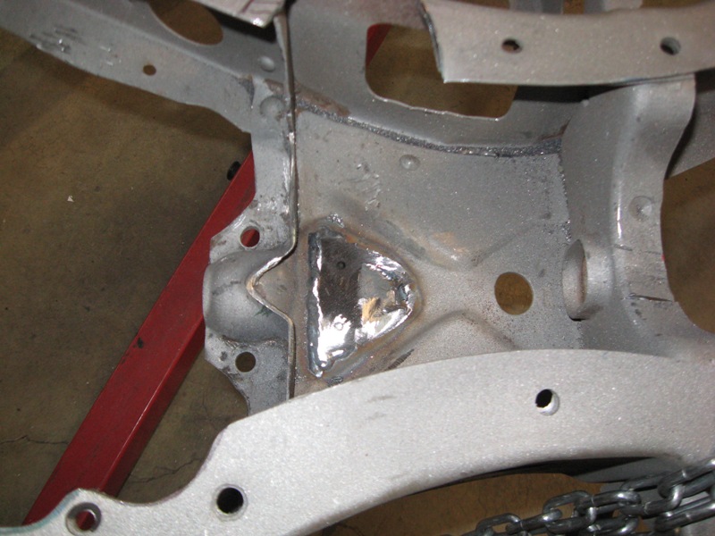

    Just curious what size wire, and heat setting did you use on the frame welds? I am patching now, love you photos and creativity give me hope I will finish some day, next is to build pvc tent to keep shop cleaner, wife already complaining. HaHa, but I will ***embe one. Thanks for all your help.
  15. The 39 guy
    Joined: Nov 5, 2010
    Posts: 3,773
    The 39 guy
    I use either Hobart HB28-28 Wire size .030 or ESAB Spool Arc Easy Grind .023 with my little Hobart Handler 135.
    Heat settings and wire speed (and memory) varies too much for me to say I just use this setting. I basically use the chart on the welder and then adjust from there. I am really not a great welder. I just get by. I usually put the .030 when welding on the frame and use the Easy Grind for sheet metal.

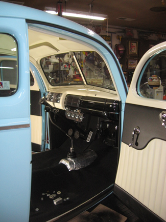

    Just caught up on this thread, love the interior, steering arm is a sobering lesson to us all, your car looks great. Your heater mods and rear mini tubs are all info all be looking back on, thanks for posting.

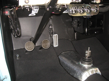

    Transmission: With the car up on jack stands it was obvious the transmission was not going to function correctly. We had to remove the engine and transmission again to see what was wrong. I had installed the first and reverse shifting fork 180 degreed off which effectively kept the transmission form shifting.
    As I had told Don before we repaired and installed this transmission this time that if it had to come out again I would be switching to a T5. Although the Mercury transmission is fine now I will not be reinstalling it.

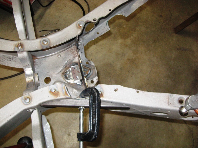

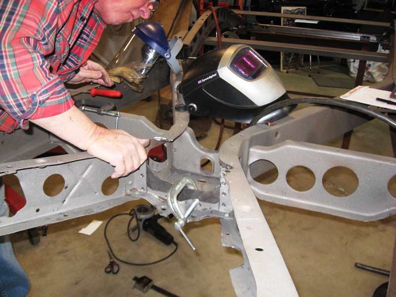

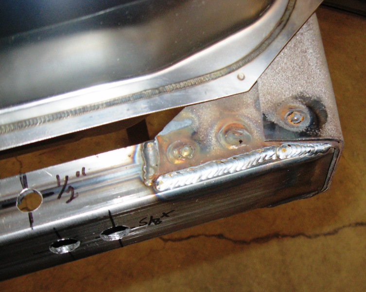

    Dimensions for the T5 were very similar to the 3Speed OD but some modifications were required.
    The X member box had been heavily modified for the 3 speed OD but would need further modifications to fit the T5.
    The front of the box had to be cut down to allow access to the transmission mount bolts. I had to leave enough metal to support the wish bone. I had already put an 1/8” plate behind the original X box face.

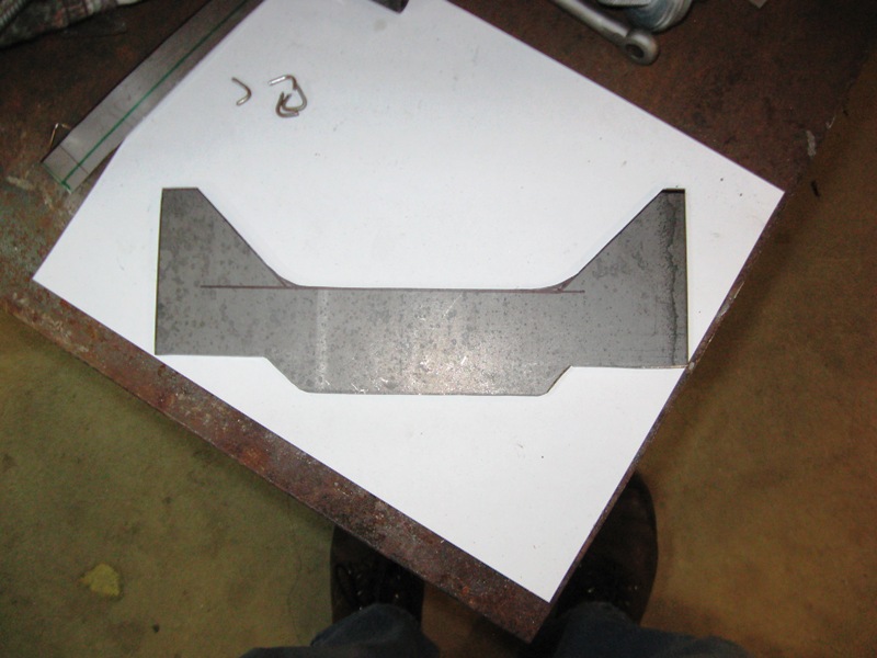

    The typical Chevrolet 350 Turbo type mount was reused from the previous 3 speed install.one spacer plate had been used in the previous install but we added one more to get a little more space between the transmission and the stock wishbone.
    The mount was modified and the plate that bolts to the transmission (black) was shortened for this application.
    After Modifications
    I had to modify the X frame support I had made to allow room for the solenoid of the 3 speed OD.A new plate for the top of the X box had to be made.
    The piece on the left was made from 3 ½ inch schedule 40 pipe. It replaced the X member top cover that had previously used in the original modification to X member.
    Some of the transmission casting had to be ground off for more clearance between the wishbone and transmission.
    That fin sticking down from the body of the transmission was cut off too.

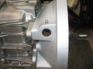

    You can see an adapter bushing that has to be installed on the stock T5 throw out bearing and bearing cap
    The throw out bearing fork had to be honed to fit the new shaft.
    The adapter did not have provision for grease fittings so I drilled and tapped for one on each side. upload_2020-9-30_21-17-8.png

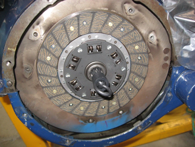

    I had to buy a new clutch shaft because the original one was too short for the new adapter.
    The old pilot bearing bushing had to be replaced with a new one. To get the old one out of the flywheel I took the advice of a Greg Landis and used bread. I had tried grease but that did not work.
    You fill the hole with bread and then use a piece of round stock that fits tightly into the bearing and a dead blow hammer. It took at least one piece of wheat bread and a lot of hammering but it finally came out. The bearing seal on the back side was destroyed but I did not plan to reuse it anyway.
    After installing the new bearing I installed the new clutch and pressure plate.

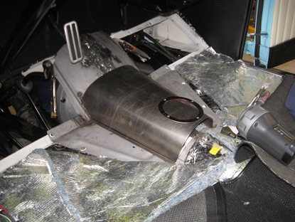

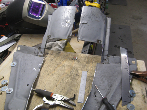

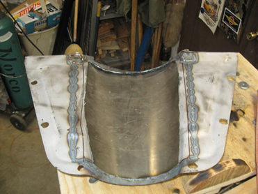

    The transmission sits higher than the stock transmission. I had a spare transmission cover sitting around so it was used for the new install. I cut the top off for starters so I could see where to start.
    After this trial fit I decided the cover needed to be widened 1 inch and that a new top cap would have to be made.
    I left the base outside dimensions alone but cut ½” out of each side to widen the front cover 1 inch.
    A new cover was bent from 18 gauge metal It was formed over a piece of pipe and the flanges bent on the HF break.
    The new hump was welded on before I trimmed away the rest of the floor pan

    Cover with the rest of the floor cut away.
    Welding finished
    I had to make new cover for the one that I made to cover the hole in the floor that was used to service the governor of the previous 3 speed OD transmission.
    The new cover fits in the p***enger side just behind the transmission cover.
    I should mention the shifter (It comes from CORE Shifters). It has a shorter shift throw than a stock S 10 It is made for a 10”or more tall shifter.
    It is also taller than the stock shifter. The shorter throw comes from moving the pivot point up a little. The shifter adapter from Gennie Shifters is bolted on here.
    I put some black silicone on the base before bolting the shifter on.
    Just needs a new piece of carpet to finish it off.

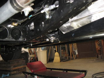

    As mentioned in the previous maintenance report I have wanted to try a different rear end ratio in the coupe to see if it would help with drivability. I delayed the project due to the cost of replacing the ring and pinion. Fortunately an old friend of mine recently decided to part with a 9” 3.50 pumpkin for what I thought was a reasonable price of $150.00. It was in good shape and just needed some cleanup and paint. I forgot to take a picture of the greasy mess but three or four hours of scrubbing resulted in a clean housing that was painted with brush on rustoleum semi gloss black. I did a pattern check on the ring and pinion and it looked good to me. All I know about it is that it came out of 68 Mustang that another friend was working on and was functioning well before removed for a ration change in that car. We eventually changed out this yoke for a shorter one we had to take off of the 3.89 gear that was in the coupe. No we did not redo the crush sleeve. We did measure the interface between the the pinion shaft and the yoke before the swap and used that measurement when tightening the pinion nut. I know it is not the proper way to do this but it is working okay.
    We were able to use the lift for this project It worked great.
    We had to order the gaskets for this swap. You would think that 9 inch stuff would be readily available at O Rileys’s for such a popular rear end. We used a Fel Pro RDS 55074 gasket for 1957-87 Ford 9 inch and Fel Pro 10720 rear axle flange gasket for Ford products 6, v8, 1948-68. Permatex Optimum Black High flex gasket sealant was used on all 3 gaskets, So far no leaks. Two quarts of NAPA 80-90 weight gear oil was enough to fill up the housing to the side plug which was sealed with Rector #5.
    I made an aluminum tag that say’s 9 “ 3.50 Ford and attached it to a stud on the left side of the gear.
    Results:
    The 3.50 gear works great! The car leaves the line well and has longer legs in each gear as anticipated by studying the chart that I made using the crawlpedia Com. gear calculator. The shifting seems much more natural. I can make it across an intersection before shifting out of 1st gear and I don’t have to slip the clutch to get started. City driving is great I don’t have to shift into 4th before 50 mph.
    I re calibrated the speedometer and it is still off a little somewhere between 2 and 4 mph. This chart is right on for the RPM at any given speed.
