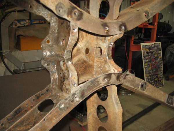

    So, how does the top of the center-section come off? I've drilled out the 6 rivets, but the top seems pretty well sandwiched in between the front and back of the center-section and the rail tops of the cross-member frames. What do I do now? Thanks!

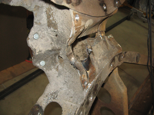

    Hi Scott? I have been enjoying your progress on your 40.
    It's been awhile so I had to go back and look at some pictures of that phase of the project. We were not planing to reuse the top of the box but did intend to use the two ends so after drilling out the rivets we cut the top down the center and then applied a chisel and a BFH as suggested by Jack Smith. That didn't work all that well for us.
    I remember it being a very difficult task. You can see some tortured metal in this photo.
    After looking at the pictures for awhile it looks like we decided to cut the top of the box
    until flush with the frame flange essentially leaving it is a doubler.
    If you are taking the whole box out it might be a good idea to knock the two ends out before trying to remove the top since they do hold the top in very tight. To get the rivets out we would center punch the top of the rivet then drill the head of the rivet until it was flush with the frame. Then round drift punch and hammer were used to knock the rivet out. That process seemed to work pretty well.

    Okay, thanks! I notice that there are also rivets between the front and back plates and the cross-members, so they would also have to come out to knock the whole box out. I think I may just try to cut out the top plate only to open up the box. At least that way I can get it clean inside. Plus, since I plan on using some kind of automatic transmission, it would have to come out anyway no matter what type ****** I used.
