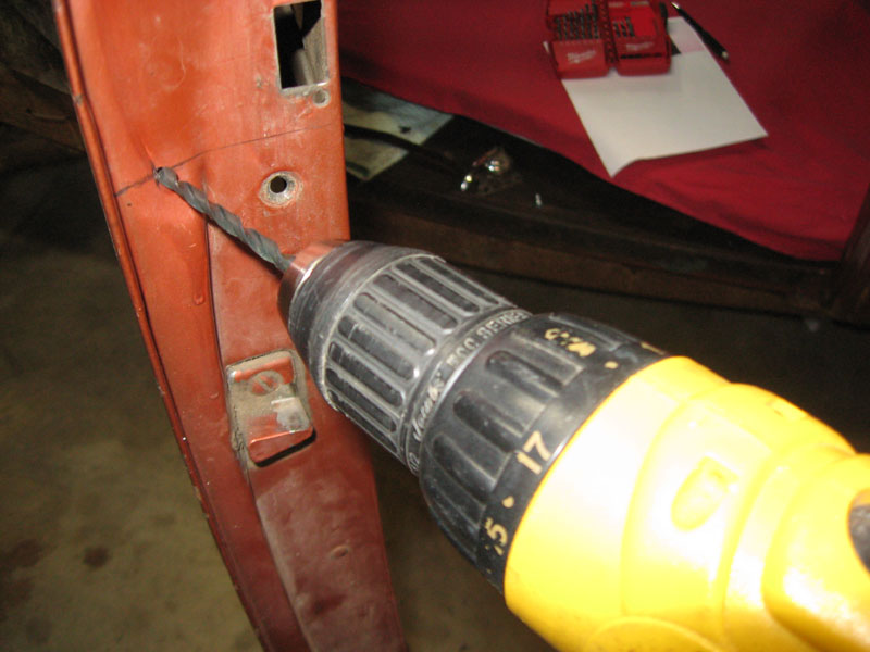

    Replacing 39 Ford Door Handles with 40 Ford door handles. I prefer the 40 door handles over the 39 so I bought a set of handles and new latch mechanisms from Bob Drake. The project is not too technical but has the usual drama and required some research and careful measuring.
    You can see two things in this picture. One is the poor door alignment evidenced by the body trim line misalignment. We took care of that later in the build. Two is that hole for the 39 handle is round and there are two threaded holes to mount the handle.
    You can see that the 40 handle had bulbous body that protrudes inside the door skin and has a screw that inserts through the door jamb into the body to secure it. The 39 handle simply bolted to the face of the door.
    So i got out my trusty dremel tool and and carefully ground out the hole to an oval shape. Notice that you grinding away the door skin and the welded on boss for the 39 handle.
    I checked out a 40 to see where the hole for the mounting screw should be drilled.
    After much time spent measuring ( several times) and figuring out the angle I drilled the screw hole and fortunately got it right. I ended up having to use a longer screw than was provided with the handle.
    I am not very proud of this cut out but it fits the handle and will not be seen when the handle is installed.
    So there is the handle installed. Notice the 5 degree down in front at***ude of my brand new handle.
    The latch mechanism is installed tight to the door and is brand new from Drake also. So why does it have this list. Looks like a 70 year old latch and handle to me. I think it is installed correctly. I called Drake and asked them if anyone else had commented on a problem like this. I got the standard answer of no.
    So my fix will be to clamp the square handle shaft in a vise heat and twist the square handle shaft to get it 90 degrees to the door during final ***embly. The other side has even more droop.
    So it was a simple project but not without the usual problems with reproduction parts. Don't read me wrong here I am thankful that people like Drake and Carpenter are out there making these parts for us and I know it is difficult to make one part fit all of these cars that were produced 75 years ago and lived such varied lives and suffered numerous reincarnations and abuse.

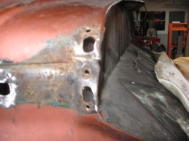

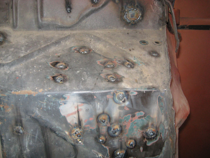

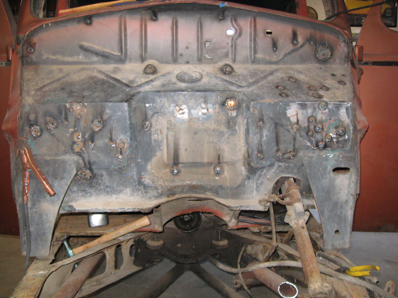

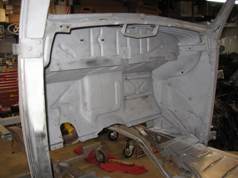

    The firewall is one of the first things I tackled on this car. I retrospect I should have s****ped the tar off the inside and sandblasted it before welding on it. I kept starting small fires on the inside and contaminating welds with the tar. But I eventually got it done. Mike the painter will have the unenviable task of making it look good in white.

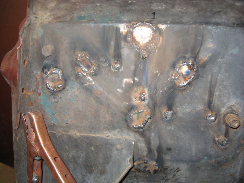

    I think I counted over 100 holes in this thing. On top of that it was dented in several places. The metal in the firewall is much heavier than the body and because it has so many strengthening beads and bends in it ,it does lend itself to easy metal shaping.
    The p***enger side must have been the host of several different heaters. It looked like the holes were made with dull drill bits hacksaws and and occasional chisel. I had to make a lot of small irregular shaped sheet metal patches to fill the holes.
    The drivers side was no better. It had a deap dent where that huge fuel pump had been. Never could figure out how that dent got there short of a sledge hammer.
    Here it is all cleaned up. The steel plate welded to the firewall is for attaching the fuse panel and wiring.The two square tubes on the p***enger side are for mounting the heater.
    Next time you see this it should be glossy white.

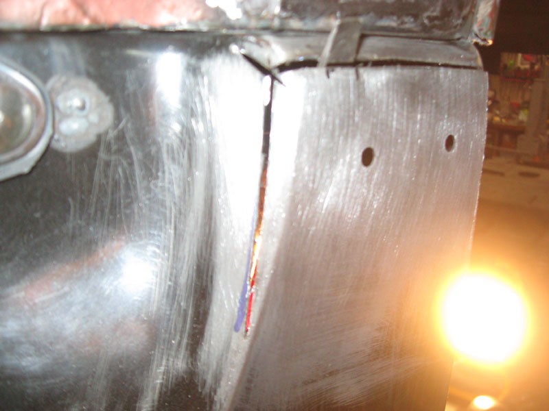

    The door alignment on this car was so bad that the male dovetail was hitting well bellow the female dovetail. As result the sheet metal took a hit every time the door was closed.
    I removed the female dovetail ***embly for this repair. I didn't realize that it was riveted twice an spot welded 4 times. So if you can do this repair without removing the ***embly I would recommend that.
    I flattened a piece of 3/4 inch water pipe and then screwed it down tight with a self tapping screw. The weld metal will not stick to the copper so this gave me something to build the weld upon and also kept the weld from bulging into the body cavity (A very hard place to grind or file).
    A little grinding and filing later and its finished.

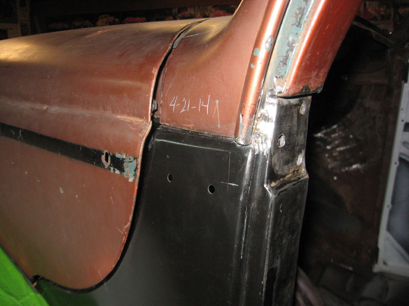

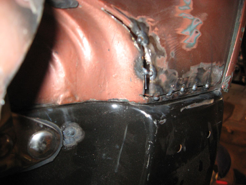

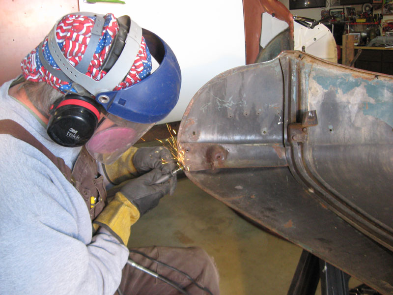

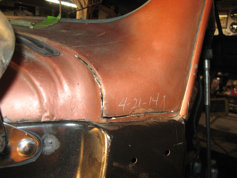

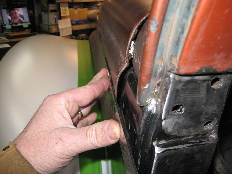

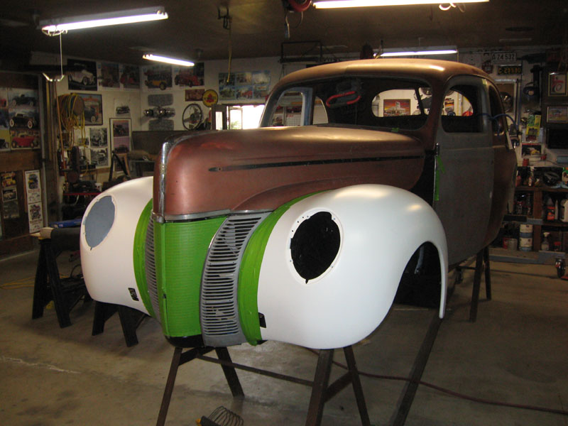

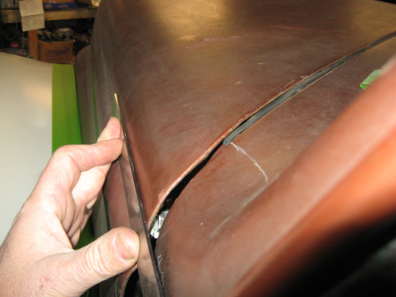

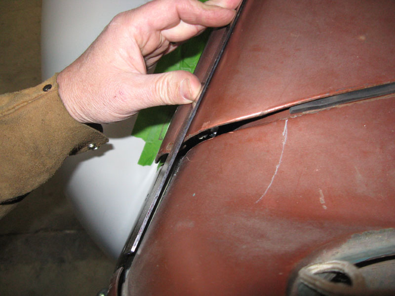

    I think it will take a few posts to discuss the hood fit project. It was very important to me to get a good fit between the body and the hood on this coupe. As you 39,40 owners know it is very difficult to get the hoods to fit on these cars. I think we spent a couple of weeks on this project. I took a lot of pictures as usual but I also missed some detail shots along the way.
    The body (still on the frame) was ***embled on steel horses with the weight centered over the spring cross members. We hope that this would replicate normal loading and flex that would naturally occur on the body. We also put the running boards and rear fenders on the car at this time to check their fit.
    Quite a bit of time was spent adjusting the sheet metal to FIT THE HOOD TO COWL INTERFACE. Every adjustment led to multiple checks at all gaps and the hood latch grill interface.
    As I had predicted the hood fit was really bad. We installed all new stainless hood hinge hardware and spent quite a bit of time trying to fit the hood as it was. I had wanted to get the top gap between the hood and the cowl down to where you could not see the cowl lacing but we never did accomplish this.When we closed up the gap the hood would hit the top of the cowl when we were lifting the hood so we had to settle for the usual ford hood gap on top. By this time we had a good cowl to hood fit on the p***enger side but the drivers side was way off. HF1.jpg HF2.jpg
    We decided to cut these hood brackets loose repair them and then weld them back on. They had been bent out away from the hood skin and cracked. The area behind the bracket was cleaned and primered before the part was welded back on. HR2.jpg HF7.jpg
    It was not a decision taken lightly but we decided to modify the cowl to get the fit we wanted. This was done after we had repaired the hood brackets and moved the hinge hardware in every direction we could trying to get an acceptable alignment. HF9.jpg
    The cowl was sprung out until it fit the hood. Lousy looking tack welds but they were cleaned up later. HF11.jpg
    Next we cut that brand new Drake cowl and pried it out to match the hood. HF13.jpg HF16.jpg
    I didn't take a picture of the hood fit after this modification but it lined up well. Some more metal finishing was done to this area later. HF26.jpg
    These pictures are from opposite sides but you can see we had really enlarged these hinge mount holes trying to find that hood fit sweet spot . Once we had decided on the final location they were marked and the holes were filled with weld metal and re - drilled.
    So was there something wrong with the new Drake cowls shape or did I install it wrong? I don't know but I also had to modify it again to get the door to line up. We will look at that later.
