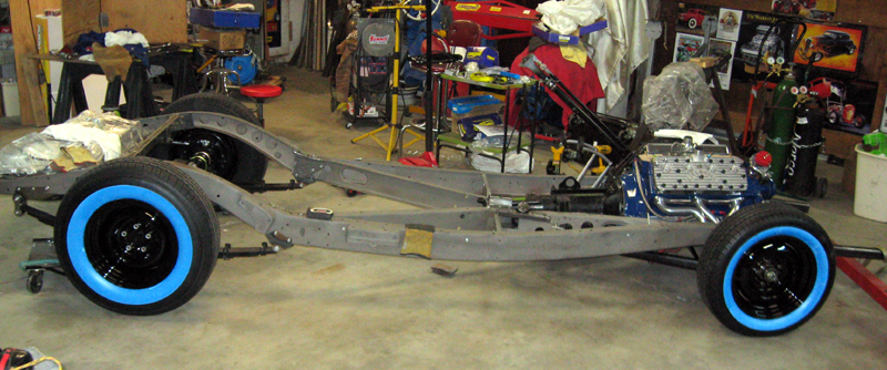

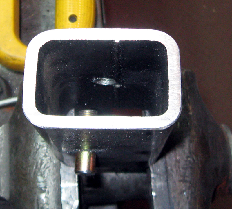

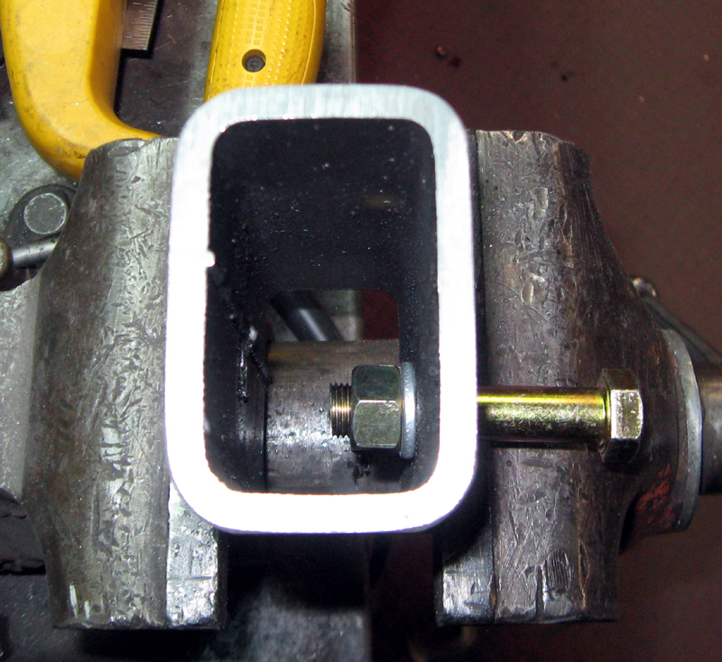

    I decided to install some 2 "lowering blocks on the ch***is. I bought some 3 x 2 x 1/4" tube and Don cut it int0 6" lengths. The rear end spring perches were 7/16" to wider per side so we drilled the bottom of the blocks on center at the 9/16" size of the spring centering boss. On the top side of the block we offset the center 7/16" and drilled it for 1/2" (actually 29/64" Tap size) to match the rear end spring perch. IMG_8088R.jpg
    I then drilled and tapped the block for 1/2" x 20 thread and installed a grade 8 bolt backed up with a lock washer and nut to hold it in place.
    The bolt was then cut off with a cut off wheel at 1/2" long. IMG_8091R.jpg
    Trial fit was good.
    So I welded some 1/8" steel plate on each end and ground the welds smooth. Sorry, lousy picture. I got in a hurry and forgot to take pictures for awhile today. IMG_8094R.jpg
    After some fiddling around we got the ch***is on the ground on her new rubber for the first time. Looks like it will have the desired rubber rake.

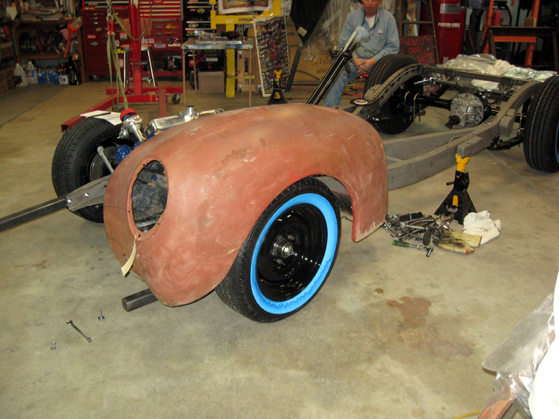

    I wanted to see what the tire to front fender clearance was so I bolted on this 39 fender to check it out. Found that the fancy harmonic balancer and pulley set up gets in the way of the fender cross brace so that will have to be modified. I just cut out the center section for the fender test fit but we will try to reconfigure the brace so it does not loose too much of it's strength. Henry would not have spent the money to put that cross brace in there it did not have to have it.... IMG_8103R.jpg
    I realize the weight of the body will reduce this clearance some but it looks like I may have made the right decision on the tire and wheel combo. IMG_8104R.jpg
    We should be able to dismantle this thing this week and start painting some parts black. IMG_8095R.jpg

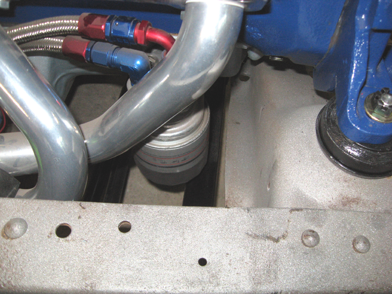

    Oh, and I almost forgot this little problem.... My fancy oil filter bracket puts the filter right over the axle and it looks like we will have to move the filter back about 4 inches to keep it from getting smashed..... That will be tomorrows first project.

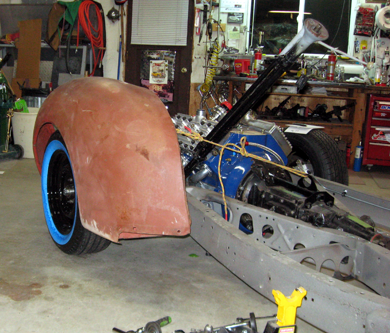

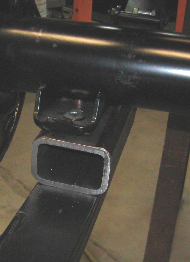

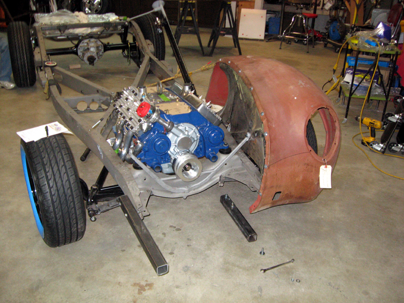

    I had to make a new cross link for the fender mount yoke ( SBC with 6 3/4 " balancer) But it's not welded on yet. I'm waiting until I have the hood and fr. fenders fitted. DSCF1211 (800x600).jpg

    joel said",I had to make a new cross link for the fender mount yoke ( SBC with 6 3/4 " balancer) But it's not welded on yet. I'm waiting until I have the hood and fr. fenders fitted".
    I am sitting here trying to figure out how you will tie that into the inner fenders Joel. My previous SBC powered 39-40's just eliminated the yoke and have vertical mounts off of the frame for the inner fenders like this one from Weed eater. I have drawing on my other PC for an adjustable version of this. I would like to see that yoke of yours installed. [​IMG]

    It replaces the original straight across link, after it is removed. You're doing a great job; I look forward to your updates.

    OK now I get it! Thanks for posting the pictures. I think I will make something similar. I'll keep you posted:)
