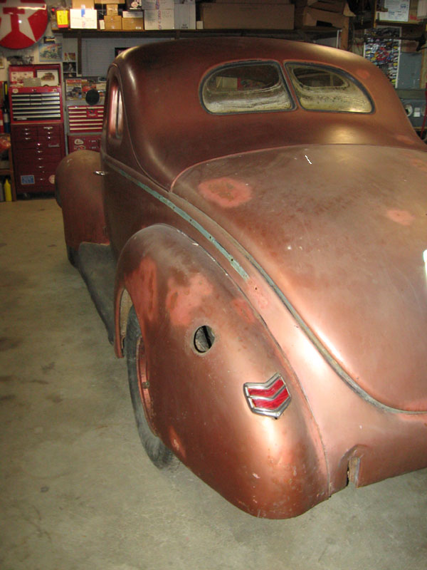

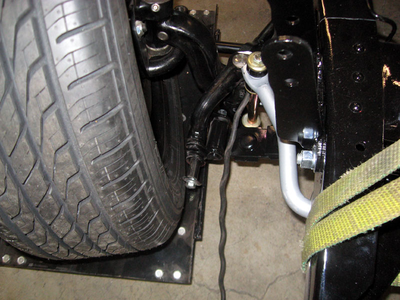

    Her is one of those items I did not expect. The bottom shock hanger that I had ***embled a year or two ago was ***embled incorrectly. Notice the hanger is making contact with the tire. The tire was hardly turned . The turning radius would have been horrendous and the possibility of puncturing a tire very real.
    This is the way I had it installed. it needed to be rotated 180 degrees. IMG_8207R.jpg
    Here it is with bracket rotated. The tire is no longer touching the tire when turned.
    The turning radius is much better now.

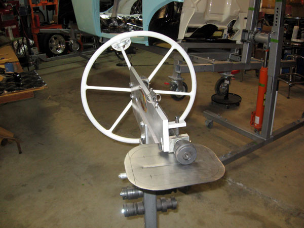

    I made the majority of the cuts with the saws all and finished them off with cut off wheel on the dremmel tool.
    I made a pattern from clear plastic and then transferred it to some leftover floor metal.
    I decided I only needed to bend the tab over on the left side. The left side tab was bent back over on itself and the void under it was later filled with silicone. That filled in the strengthening bead in the floor allowing the plate to seal better. I had to hammer and dolly the area around the original MC hole to flatten it. I cut the tab off of the right side and did a little dolly work on the shallow bead area there.
    I got carried away with the bead rolling phase of the project and forgot to take pictures of that part of the project.

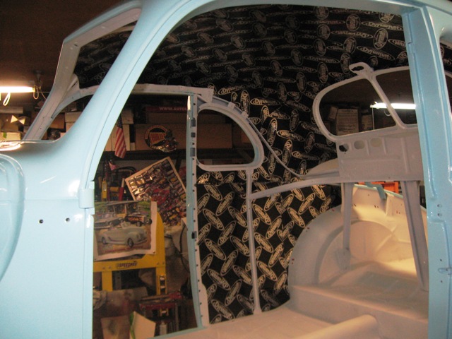

    Started installing the Dynamat. The pieces are 24 x48 inches. I thought I had asked for the old silver type. This is what they sent. It is OK but I preferred the lighter color.
    I set up a table near the car and got out a few tools I thought I would need. The roller is home made from roller off an old boat trailer and a piece of pipe. You really have to have a roller to do a decent install of this stuff.
    I strung a line down the center and marked a center line with a tri square.
    I lay a strip of tape along the center line. I should have just used a pencil. IMG_8258R.JPG
    Having the body on the rotisserie is a big help. I am able to roll the car on its' side and stand inside to place the insulation rather than trying to hold it overhead. The large piece was still difficult to get on the center mark. As you can see I went over the taped center line. I had to carefully pull the insulation up off the tape so I could
    remove it.
    First piece rolled in.
    Once the two big top pieces were in I started making paper templates for the smaller pieces. At first I used the contact backing paper from the insulation. That proved to not work too well since the markers and masking tape would not stick to it. So I scrounged around and found some old butcher paper that worked well.
    The pattens were transferred to the Dynamat. Most of the time I worked with the dynamat face down. Make sure you have the pattern in the correct position so that you do end up with a backwards piece. I only did that once so far but I was able to use it on the opposite side of the car
    This is as far as I got before my back started doing it spasm thing so I will have to take a couple of days off and let it settle down. I intend to do the entire inside. I know you do not have to do that for sound but I am installing for thermal insulation also.
    I noticed that the more of the insulation I installed the more top heavy the body became. I should have stopped and adjusted the rotisserie to compensate but did not. As a result I had to start holding the body up as I worked which probably caused the back strain. Yes the rotisserie has an anti rotation lock but I did not want to use it as I was constantly rolling the body to get in and out for fitting the insulation templates.
    I tried doing some light work yesterday. This picture is not all that great but this inside door gizmo was missing a spring. On my second try I bought the correct spring.
    I need to figure out how to take better close ups. You can barely see it here but the only way to get that spring in is to take the cover off. I bent the ears back with a screw driver and hammer. Thankfully the ears were made of some pretty malleable steel.
    Once the spring was in I put the cover back on and pounded the ears down with the hammer. Pretty easy but now I have to paint it again.
