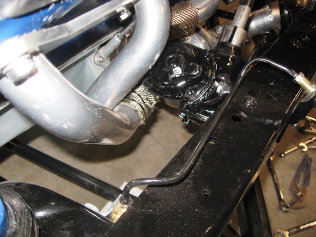

    I visited the muffler shop today and reviewed the changes made to the drivers side exhaust. He had tacked it together but wanted me to approve the changes. Looks much better and a metal heat shield should take care of the master cylinder.
    The Header to steering box clearance is another story though. I will cover the modifications to the header in some future posts. I may have to put some insulation on the steering box.

    Next project is fixing this steering box to header clearance problem. Beating the header with the ball peen hammer made for a pretty ugly finish and it still didn't clear the header. IMG_8315R.jpg
    We did some brainstorming and drew out these potato chip style cuts. IMG_8316R.jpg
    I cut out the first section using my dremmel tool and finished off the cut with a file.
    I cut out a cardboard pattern and transferred it to a section 18 gauge steel.
    This is a handy and inexpensive tool for comparing sheet steel size. It is called a wire gauge.
    After some bending and several trips to the belt sander I got it to fit the hole. IMG_8320R.jpg
    Darn header was hard to hold in a good position for fitting and welding so I decided to mount it on this s**** board. I hope to get more done tomorrow.
  28. The 39 guy
    Joined: Nov 5, 2010
    Posts: 3,773
    The 39 guy
    Continued working on the header project this week.
    It took quite awhile to fit these potato chip pieces in.
    Test fit showed that there is now a small but hopefully adequate clearance.
    All those old welding gloves come in handy some times.
    Both patches mig welded well. The ceramic coating had no effect on the welding process.
    Metal finished the pieces with a cone shaped carbide deburing tool and some 2 inch flap wheels.
    Added some VHT aluminum colored paint
    I used some DEI ***anium exhaust wrap and secured it with some stainless steel wire tie style straps.
