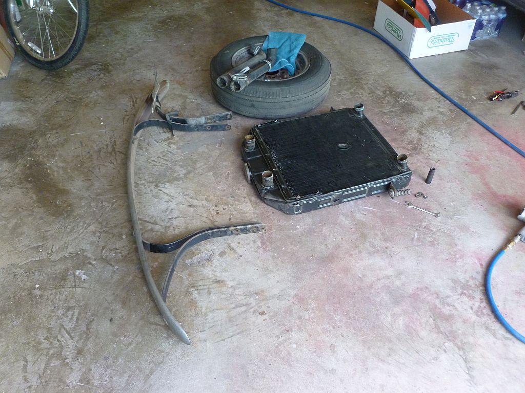

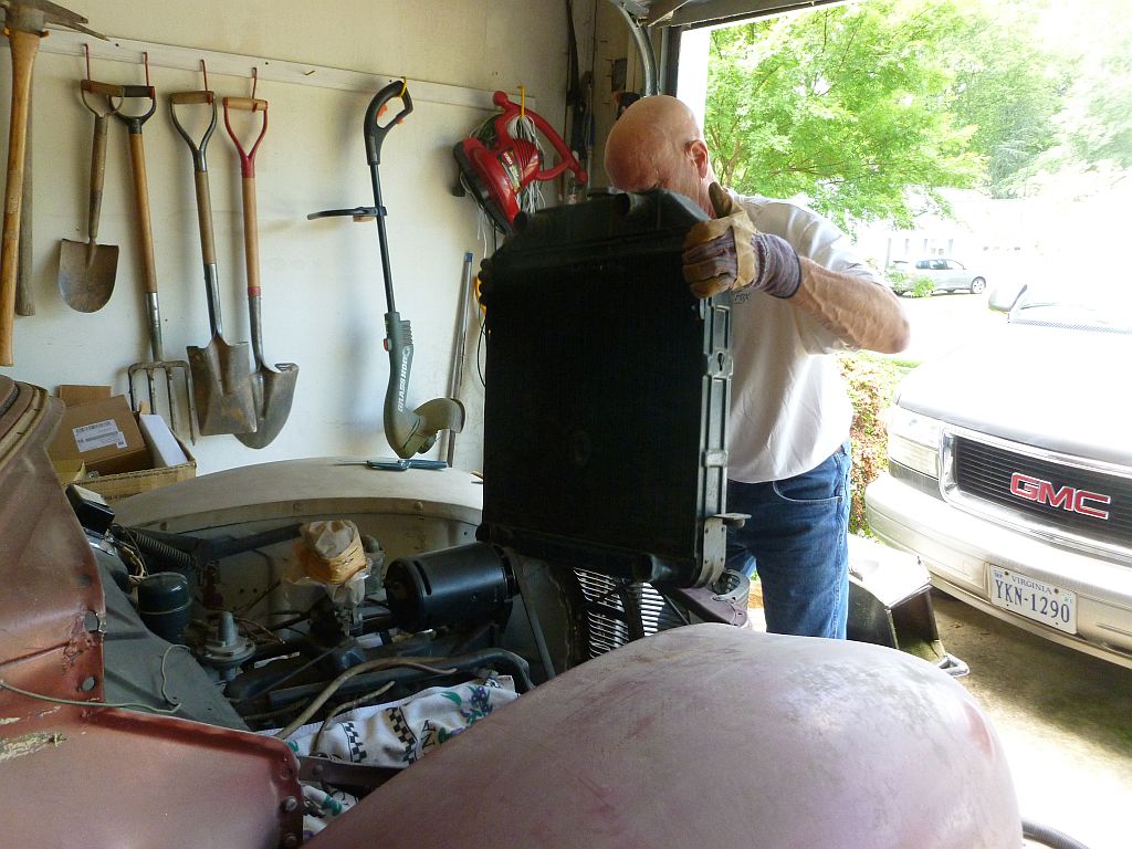

    I intended to take off a fender, so jacked it up and took off the right front wheel. But found that to remove the fender, first I had to remove the old pull-hitch and bumper. But to remove those, I had to remove the radiator. And to remove that I had to hack off the radiator hoses.

    4 hours and a pound of mouse-shit later.... I couldn't have done it without my air-wrench.
