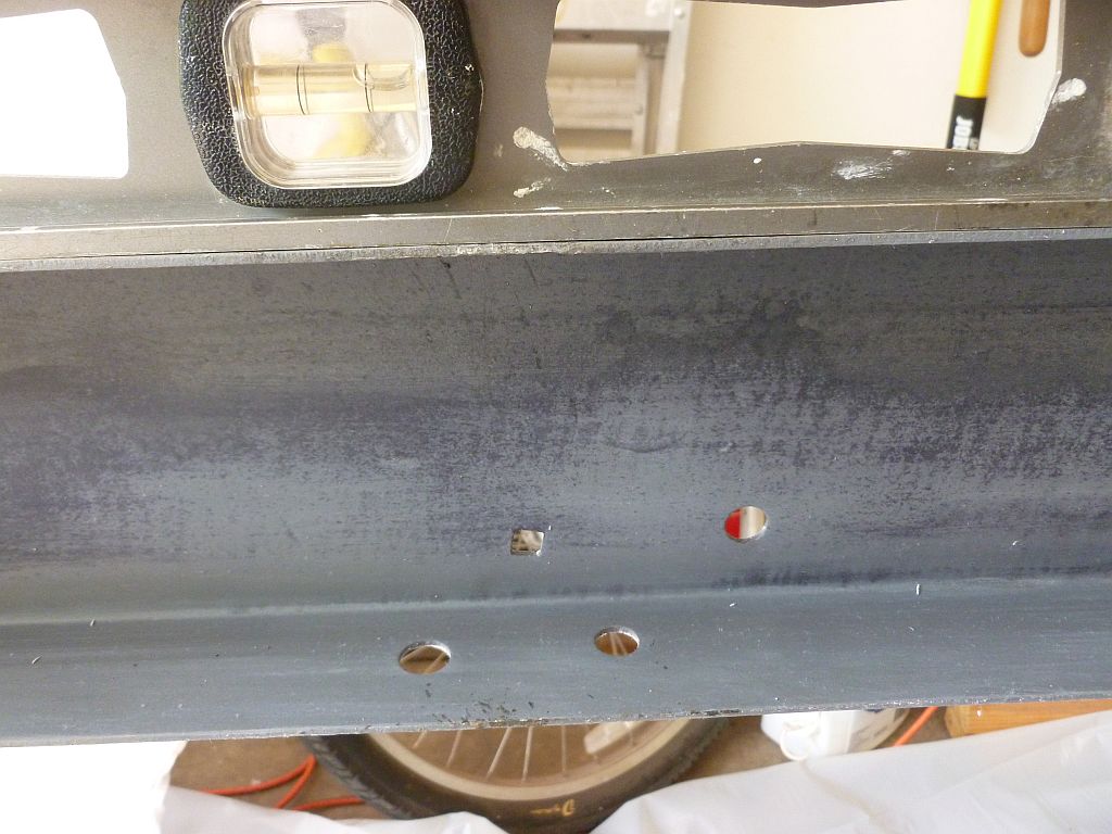

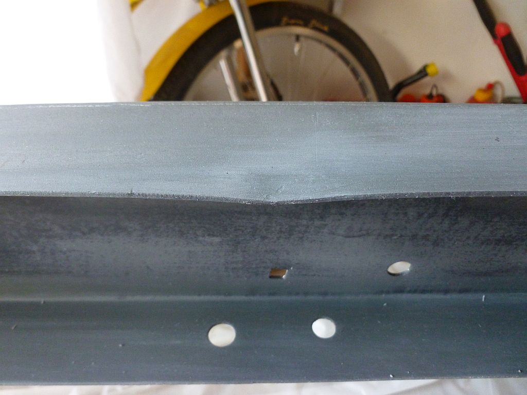

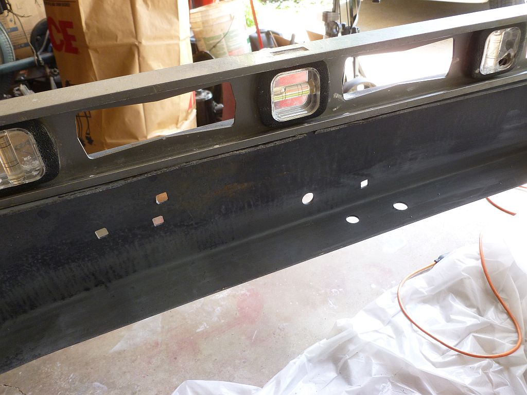

    So, I've been practicing with my new toy, running beads on coupons and welding coupons together and trying to run beads on the edge of 1/16th thick coupons and stuff like that. I finally decided to go ahead and start practicing on my frame.
    You'll recall this area on the bottom of my frame rail that didn't look too hot?
    I decided to work on it and see what I could do. I used a copper backing plate to fill in the notch at the edge of the frame and then welded the crack. Here's what it looked like after grinding down the beads:
    After round 2 it looked different, but not much better:
    And after grinding:
    Still not happy with it, so laid down more metal and then ground it down:
    More beads:
    Ground and hand-filed that down and decided just a little more;
    And ground and filed those down. Taa-Daa!!
    loudbang, joel, Just Gary and 4 others like this.

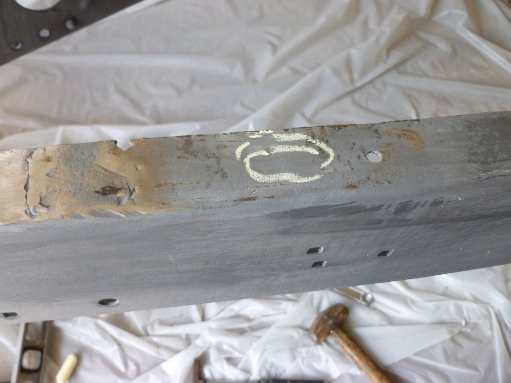

    Okay, so here is the bad one. Let's see how I do on this one...
    Here is after my first welding session on it:
    And after filing and grinding:
    Then more welding followed by grinding and filing:
    and more welding:
    Then grinding and filing and more welding:
    Final grinding and filing:
    I put on AfterBlast but it didn't turn very grey. The grey must be from the grit-blasting:
    So, at the end of the day I got my friendly little helper to give me assistance in flipping the frame back right-side up for next activity.
    So, what is the next activity? Not sure, but I think I want to get it fully leveled as I'll probably be boxing the frame next.
