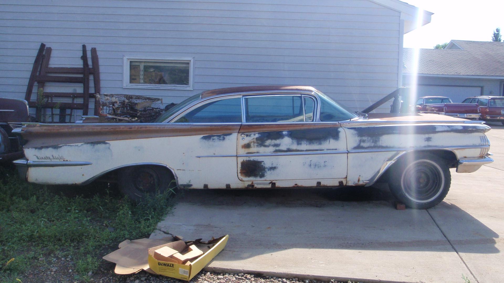

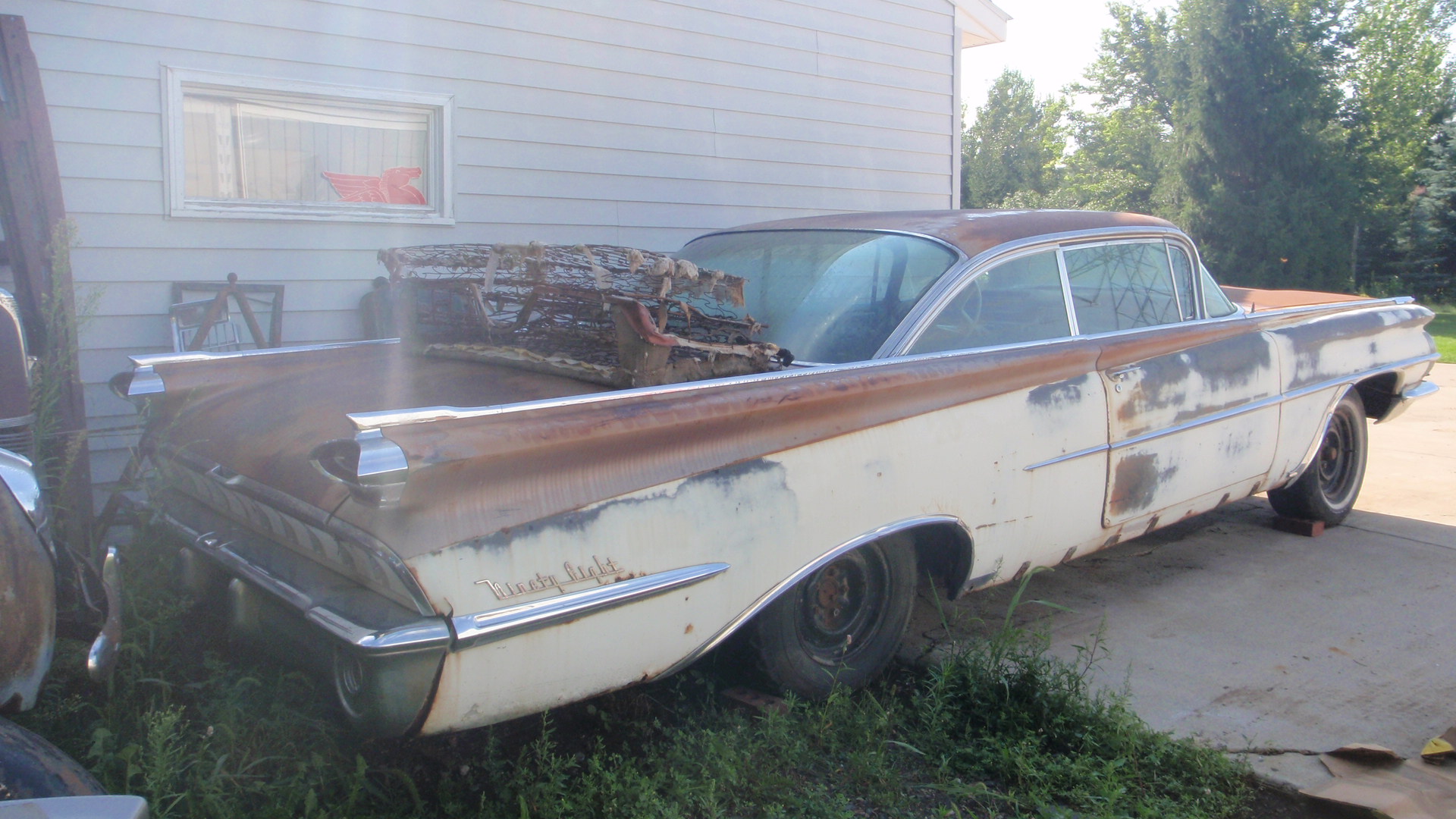

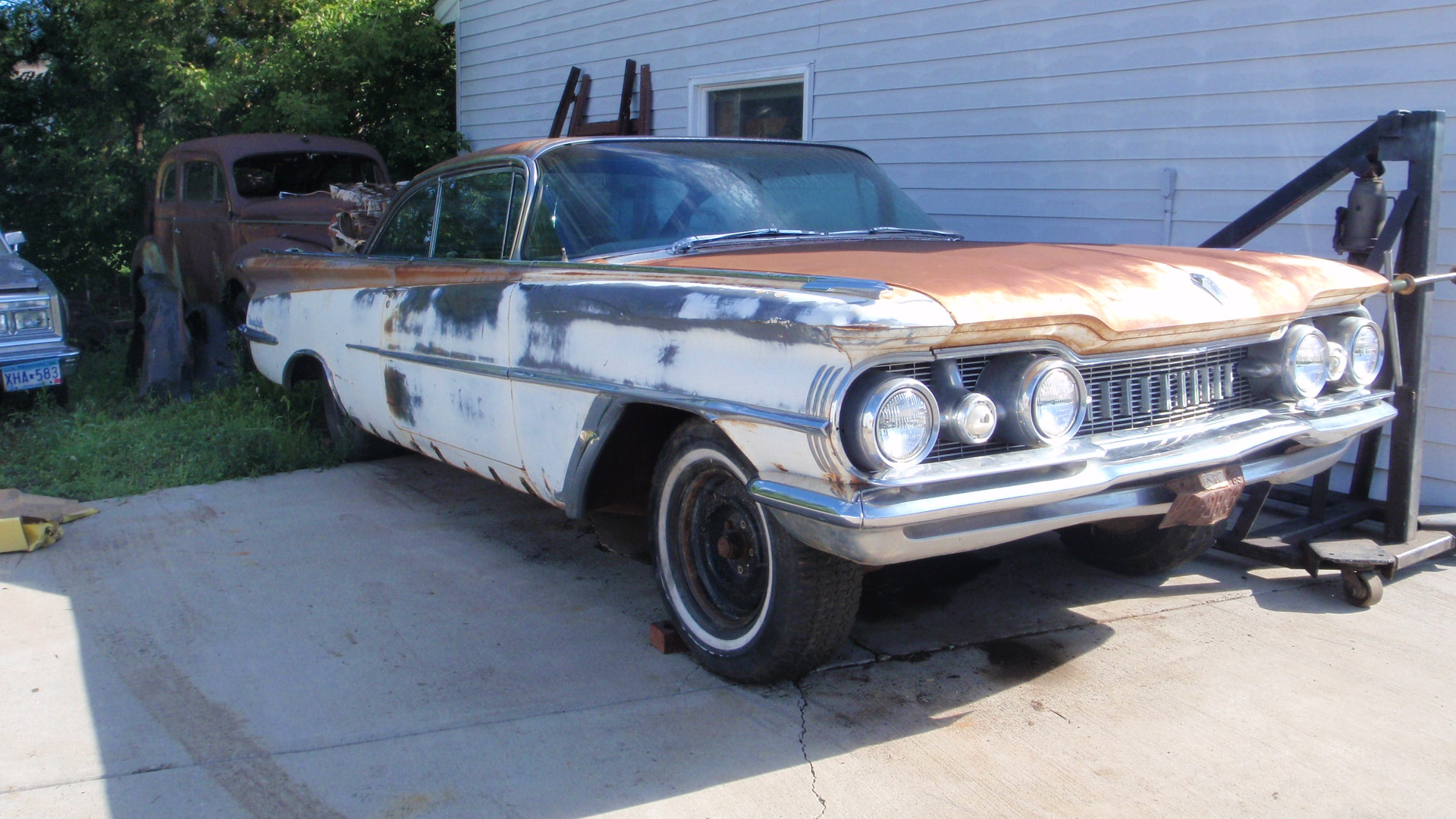

    Well since we added a new member to our family about 6 months ago me and the wife (stichbitch) both knew we needed to get going on our "family" car, our two other daily driven old cars (34 p/u and 65 camino) only have 2 seats, so we needed one with a back seat, my wife bought this 59 olds 98 from a freind a few years back and its just been sitting in the driveway waiting for us to get on it, well the time was finally here. My freind Ryan (guyontheHAMB) was gonna be in the area for the holidays and was wondering if we had any projects we were working on that we wanted any help with, i said no but we could start one, so the night before my freind Terry was over and we had the fun task of digging it out of the snow and getting it in the garage, we did that but had to let all the snow melt off before we could get going on it.
    So it was time to start on it. when we got the car the motor was long gone, i had first ideas of running a newer olds motor like a 403 or something but the SBC prevailed, im sure alot of you wont like it but its what it is, this car is going to be daily driven and i want it super dependable for my wife to drive around, so behind the sbc i put a th350 trans. so we threw a mock up block and tranny in and fabbed up some motor and trans mount, i positioned it so i could use the stock driveshaft with out shortening it, the engine bays are huge on these things so it was easy.

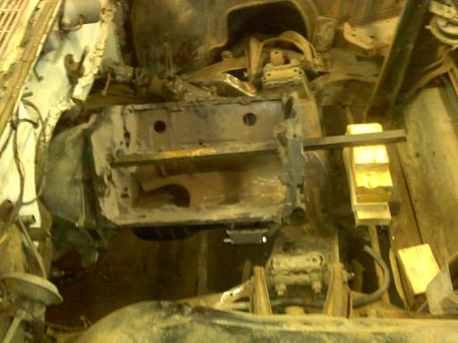

    The car was a south dakota car so it wasnt badly rusty, but the front floors were bad cause it say with carpet in it and window leaks, so i patched up the floors and po15 them.
    Its funny, i always say a rusty car is strait and a rust free car is always beet up, well this car being for the most part rust free has some dents and dings and alot of the trim is beat so itll be a fun timing finding replacements and fixing what is there.

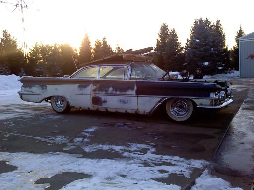

    So sunday a couple of my freinds came over to help, thanks Luke and Jake.
    We proceeded to throw a real motor and trans in so the ride hieght could be determined, we new the sbc was alot lighter than the olds, we got the front end pulled apart and got the springs out, i cut 2 coils out right off the batt, it probably sat about stock and i new that wasnt gonna fly, so i cut another coil and threw it in there but it still didnt go as low as i wanted it, so i cut another, yep 4 coils, but guess what, it was no too low! i love where it sits but it only has about 2" of travel and thats just not enough for one of these cars, so im getting another set of spring and we go back to 3 and see how much it settles once all the engine parts and radiator and water are in it, i will also probably trim and reinforced a little on the bottom of the spring pocket to add some clearance.
    so far we ended up with 3" blocks in the rear but im thinking its gonna get a 4" block.
    we also mounted up some 710 white walls on some chrome wheels, i bought a "set" of 4 a while back but knew 1 was mismatched, so while at another swap i picked up another pair of matching chrome reverse wheels so i know i had 2 pairs, one for the fronts and one for the rears, well it turned out that the first 4 rims were all different!! so i have a matching pair on the back and dimmentionally matching pair on the front, so if anyone has any 15x6 chrome reverse 5on5 wheels let me know, i could use some singles to match my singles!
    so we rolled it out for a look and im pretty pleased with where its at.
    the basic plan is to build a mild custom, a little shaving here and there, primer paint for now, and a mild to mid wild interior.
    i started removing the oldsmobile letters from the grille, thers about 30 little tabs where the letters originally bolt so its a slow process of cut them out with out damaging the thing grill.
    stay tuned for more progress.

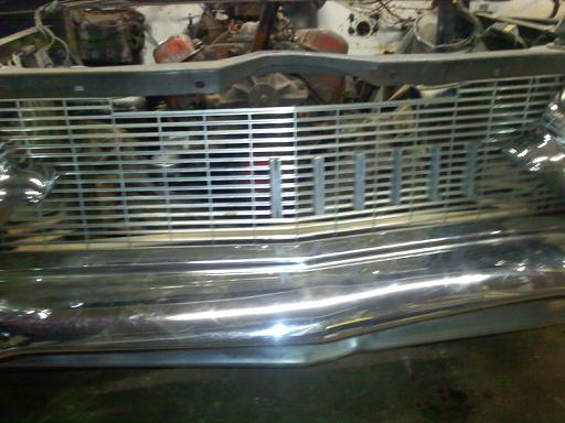

    Made some more progress on the oldsy....
    Went to French lake auto parts and pulled a power brake set up out of a 60 olds and installed that, got the motor cleaned and painted and installed, got most of the stuff on the motor, ill post another pic later of the completed motor.
    also finished shaving the olds letters from the grille.

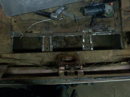

    I was working on patching up the trunk floor today, there was just one rear section that had rusted out and was pretty easily patched and wont be a noticable patch when all said and done. so no that thats done i can finish cleaning out the tank and reinstall that. i also scrapped up all the old tar/padding from the trunk floor, nasty stuff!
