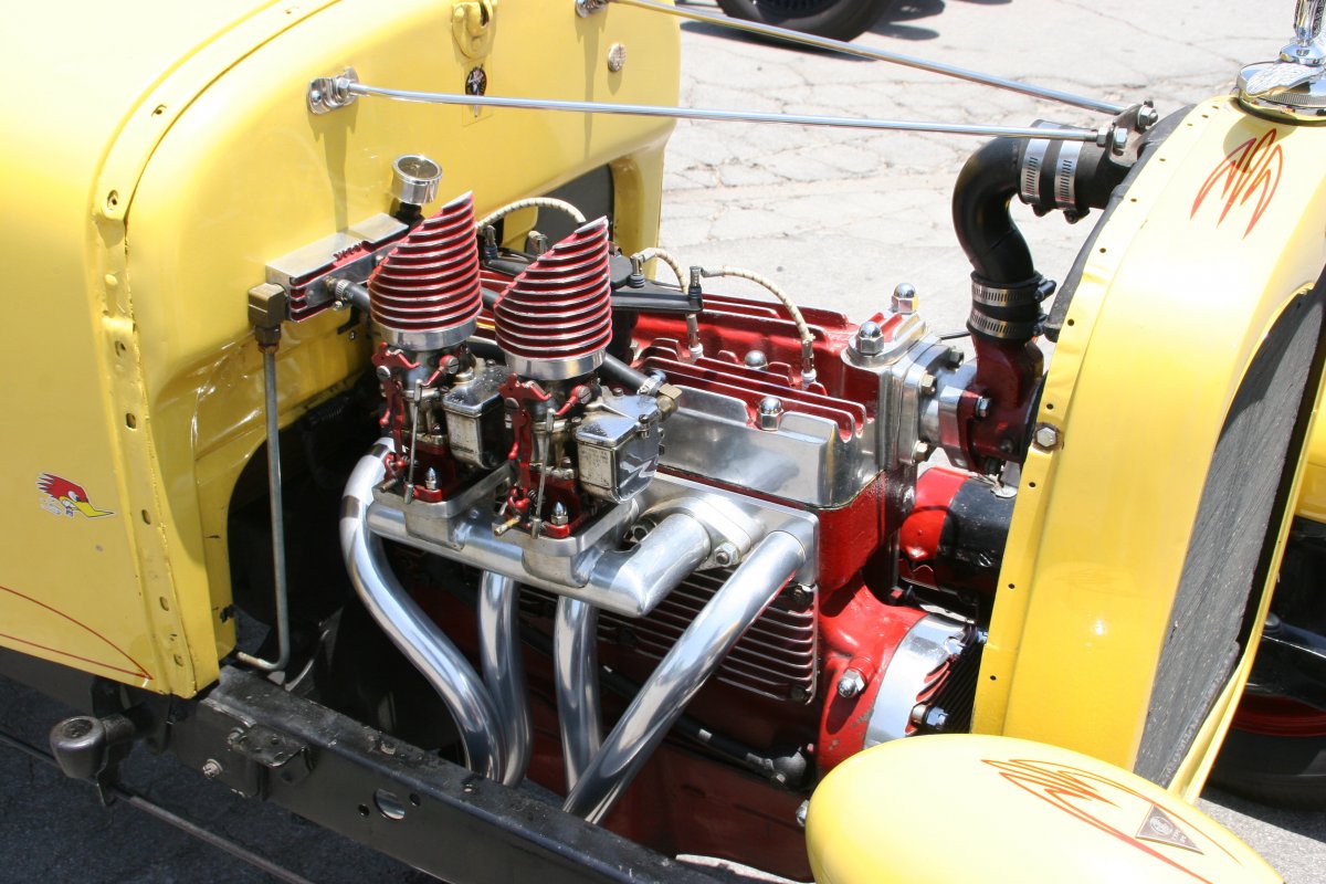

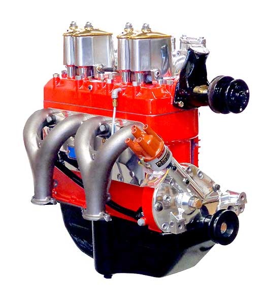

  5. A good question might be what is out there in current production. Charlie YAPP shows a Roof head and his recently discontinued 2 port Riley. I have included photos from his web site (http://www.secretsofspeed.com/roof-101-cyclone-ohv).
    Also Steve Serr makes a reproduction of the Cragar head. I have included a photo from his web site: http://www.millerhi-speedheads.com/index.html
    About two years ago at LARS I saw a head that looked like ARDUN from one bank of a flathead but haven't heard anything more about it. I will get some pictures at LARS this year on Father's Day if it shows up again.

  6. RichFox
    Joined: Dec 3, 2006
    Posts: 10,020
    RichFox
    Rutherford. may be spelled wrong but it makes hp on a banger. It's up to you how long the banger lives
  7. drtrcrV-8
    Joined: Jan 6, 2013
    Posts: 1,816
    drtrcrV-8
    That "Ardun" head is by H&H ( with in-line valve train like Steve Serr's Cragar reproduction), not like a true Ardun Hemi-head.

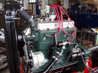

    This is a B block with an original CRAGAR head. Put out 59 HP at the rear wheels on a ch***is dyno. Also using a T-5. Used a Weber 32/36 carb on the dyno run.

    denis, is that a Ford 6 1 barrel carburetor? How does it run with it?
  11. denis4x4
    Joined: Apr 23, 2005
    Posts: 4,416
    denis4x4
    from Colorado
    Yes.....ran great. However, switched to a Weber 32/36 and it runs even better.
