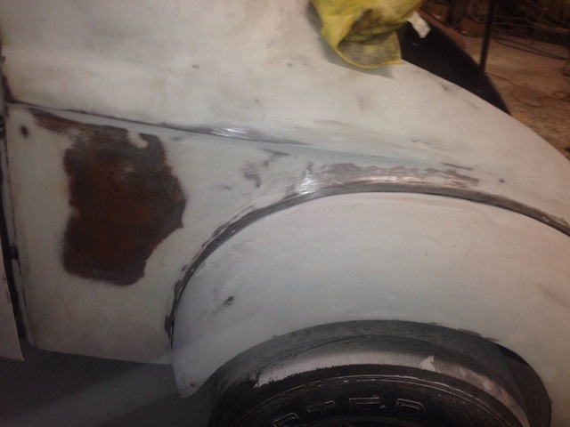

    Sorry, that really jumped out at me and if you were to find another body man now would be the time. Keep on truckin' and I do appreciate all the work you put into saving this and the 77.

    It's customary to sand the whole car to bare steel before smearing mud and the car appears untouched. Even if he's stripping as he goes it would be real easy to get lazy and fill over dirty steel. I'd say running it through a TRUSTED media blaster first would have been a good investment.
  3. Agreed. Whole car or at least complete panels should be stripped before anything else. I would expect the fenders and doors to be off at this point. Post more pics. It doesn't look good at this point.

    I've seen 2 finished cars of his and they looked great. One was a 64 impala that he painted a few years ago and the other is a VW that he painted last week. He ***ured me that each panel is being sanded down to metal FIRST then bondo. He sent me pics that I didn't want public and the roof and fender and quarter are sanded exactly like he said. I actually don't want the doors off, it wasn't a breeze getting the doors lined up in the first place and I doubt he could fit them properly. All the fenders are coming off for final bondo and sanding BEFORE paint.

    body guy just wrote me: The area where there's actually bondo is grinded before the actual bondo is put on. Bondo will definitely not stick to rust or if it's not grind it with at least 80 grit sandpaper. 80 grit sandpaper or is enough to take out the rust for sure . Well I guess it would technically dry but then you could peel off with your fingers

    Fenders will come off for sure but it's easier doing Body work on those with them on the car. So we are using the angle grinder with a 36 grit disc to grind rust off . This is our procedure for this type of work. Is this ok or did you want to get it blasted because by the end of today we are going to be deep into it. A lot of my friends and customers are car people so if there is any of your friends that you want to ask about the procedure I'm using now is probably the time. After the body work is done I am going to sand the car down with the 40 grit sandpaper to knock off the rest of the rest then I'm going to Lay an etching primer after that a fill primer. After that we block sand . How does all that sound?

    Cool build,lot's of work for sure.Just so you know,if you do not neutralize that rust after blasting/grinding with a product like Ospho (phosphoric acid) it will come back to haunt you..big time. Just trying to help. Keep up yhr good work.Love those Willy's coupes!

    I use a phosphoric acid tile cleaner I get at home depot. Works great to neutralize rust. I dilute it with water and then use a scoth brite pad to scrub the panel. Let it sit for ten or so minutes, then wash the panel off thoroughly with normal water. Turns the rust black and then you know its dead.

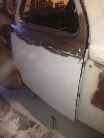

    drumyn29
    I truly value all of the opinions about my car:

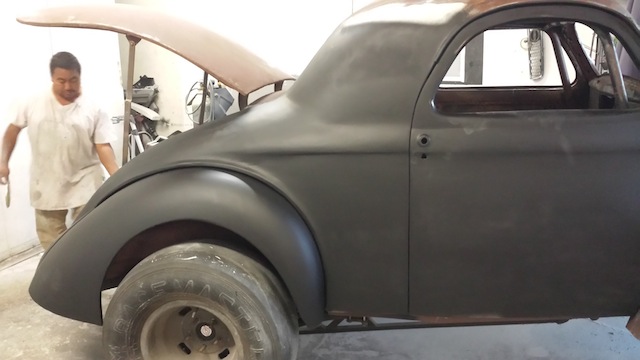

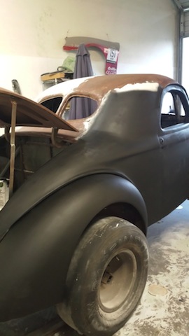

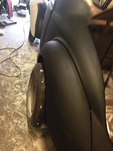

    Life is good.

  20. seriously bro, your painter does stuff WEIRD. but whatever works right!?
    now lets get that thing in some color!

    He's not doing it the way I would choose but I'm going to stay out of his way and see how this plays out. I kinda dig the dude! At least he's not taking three months to do bodywork, not over charging and I do see bare metal under his bondo.

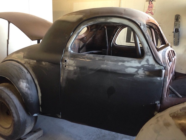

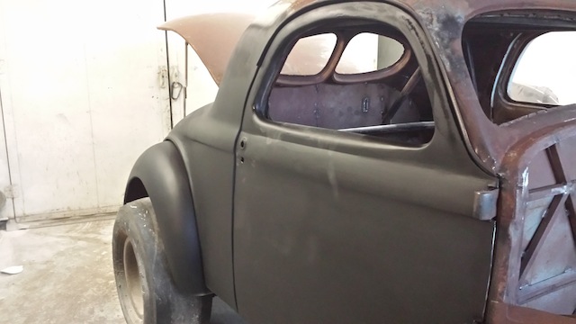

    drumyn29
    He's not bonding over rust, he's sanding an area and working on that area before he moves to next area.
