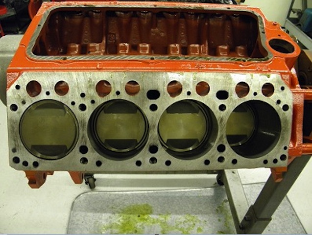

    My report from Mark Engle and my 392:
    Good Morning Jeff, Hey I didn't get much done yesterday except degree the cam and decide to replace the front cover seal. The machine shop called me and said we have 4 bent exhaust valves and 1 bent intake. The intake valves are old stock steel (not stainless) so I OK'd him to get us a new set to start with. I tried to instal the cam, but the cam was too tight, so I had to measure it against the old one, and polished the journals in the lathe, re cleaned it and installed the cam. The bolt and washer to hold the gear drive hub on the cam was bunk so I re-machined a new allen bolt and made a washer custom to make this all work. Lastly I checked bearing clearance, .004" and ring end gap .030" top steel ring and .026" second iron ring, and installed #1 piston. Today I plan on timing the cam and getting the front cover on and the other 7 pistons installed. Keep Smiling, Mark Engle

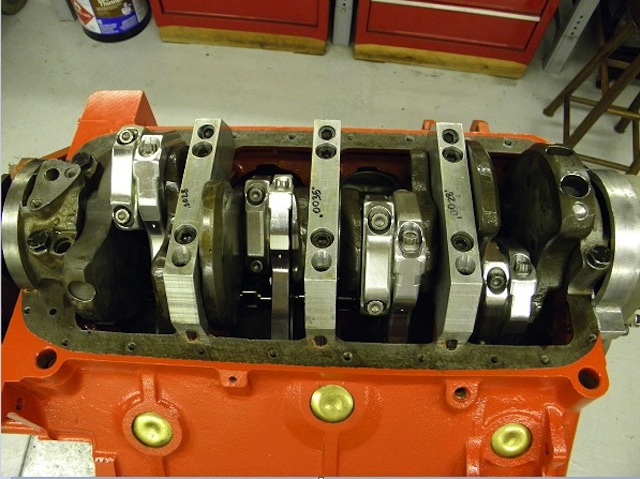

    Image 1.jpg Image.jpg Image 2.jpg Not much to report on the Willys, I brought some parts to a chrome shop, WOW they are expensive!!
    Mark Engle said I have too much bearing clearance on the connecting rods. .004 .005" measured, so he ordered some -.001" H bearings where I only have P bearings now. With new aluminum rods I want to be on the loose side which is .003-.004" planning on them closing up when they get hot.

    damn, DAMN, DAMN!!!:eek::cool::confused:
  23. Andy
    Joined: Nov 17, 2002
    Posts: 5,483
    Andy
    They will open up when hot.

    I am diggin' the detail on the motor, just the way I like em' Looks great.
  25. drumyn29
    Joined: Feb 16, 2006
    Posts: 2,405
    drumyn29
    Aluminum expands when it gets hot. Ron Shaver (himself) told me on brand new (Aluminum) rods, to run them wider because as they grow outward and inward to have an extra thou of clearance for this phenomenon.
    Ron worked with Bill Miller trying to make aluminum rods work in the sprint cars years back, ran hundred of hours of dyno testing and ran thousands of laps at the races. We are also going to run 50W racing Valvoline or Lucas for oil school bearing clearance film filling strength. So I think we are good, the pistons are down in the hole, I ordered .051 gaskets too for a little de-compression and more clearance for all considerations. We are good, and I hope to ***emble the heads today, then waiting for head gaskets, and rockers to keep moving. Mark
