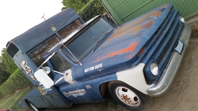

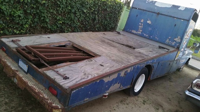

    Image 1.jpg Image.jpg I just couldn't get the $3500 in time. DAMN!!
  12. Damn, that hauler is bad ***!
  13. ^^^^ I agree that is a bad *** ramp truck!

  15. drumyn29
    Joined: Feb 16, 2006
    Posts: 2,405
    drumyn29
    Some dude in Bakersfield beat me to it.

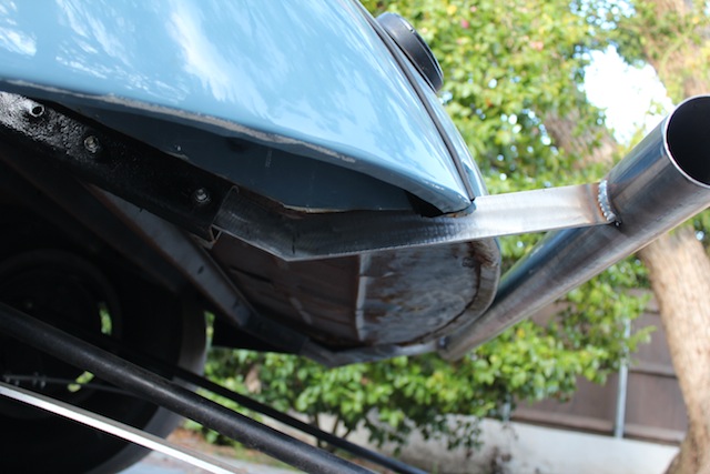

    IMG_3613.JPG IMG_3609.JPG IMG_3623.JPG IMG_3617.JPG IMG_3616.JPG IMG_3614.JPG Instead of mowing the yard yesterday, I decided I needed a bumper, my wife is pissed but what else is new! I striped a few black leather freebie craigslist couches for my interior as well.

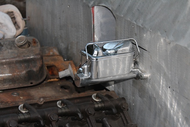

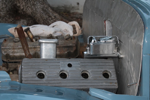

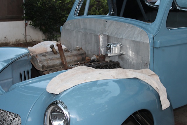

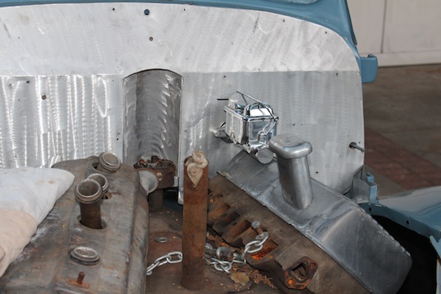

    IMG_3993.JPG IMG_4014.JPG IMG_4013.JPG IMG_4012.JPG IMG_4011.JPG IMG_4010.JPG MAN this car takes a long time to build!!!!
    I just added a big 2" torsion bar that my sprint car friend gave me. I didn't have the proper length bolts so I just used whatever I had in the bolt bin until I get time to buy some grade 8 bolts.
    Hopefully this will cure any Body-Roll that this car might have once I get it to the strip.
    Also added an aluminum brake master and Ansen brake pedal.

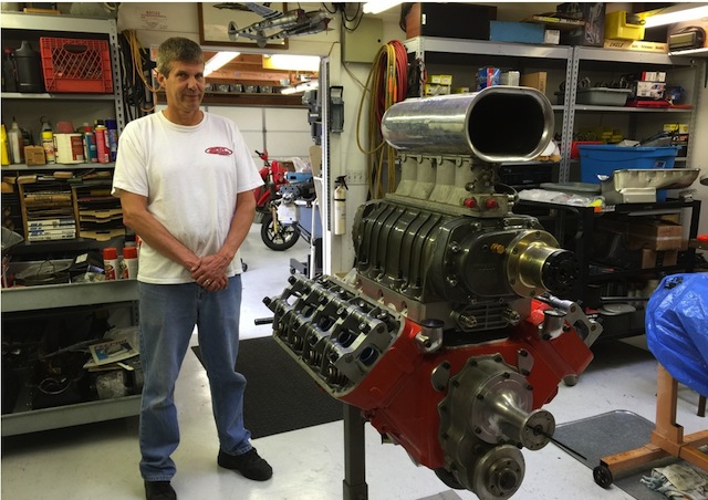

    Image.jpg Mark Engle next to the "jigsaw" Hemi.

    Nice !! You so need that. It will keep the windshield clean ...perfect for wheelies. Frekn' A man. Perfect.
  21. mutant55
    Joined: Mar 11, 2012
    Posts: 231
    mutant55
    Lookin' good Jeff, Mark looks happy too.....
    The reason Mark looks so upset is because he's never built a high horsepower engine with yard sale parts before. All of his grey hair came from this build.
    So with the intake on and torqued the over ported manifold has alot of gasket and port showing, which means that there is not much area of gasket sealing area.
    NOTE: The screw driver is 3/8 wide at the tip, the shiny part is the iron head
    the black part is the gasket. Not much left to seal with.
    You can see how much gasket and port is showing, making a reversion edge.
    He's seen a few funny car blower explosions in his life, so he's extremely cautious, I should learn from that.
