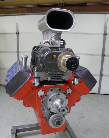

    Thats why I decided to weld in another set of motor mounts on my ch***is for my Hilborn SBC. I mocked it in today and I can have Hemi and SBC mount without issue.
    I figure I'll run the SBC until I'm used to the car then I'll pull out the big guns.

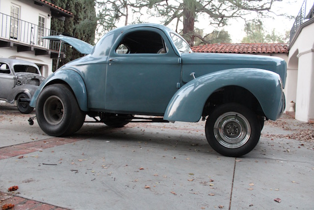

    Image.jpg Image 2.jpg getting closer to the finish line

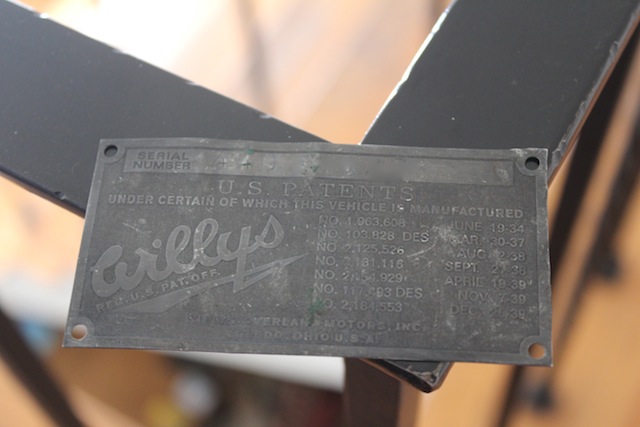

    IMG_5310.JPG IMG_5311.JPG Made my tag!
    Blurred the id number in the photos, just in case.

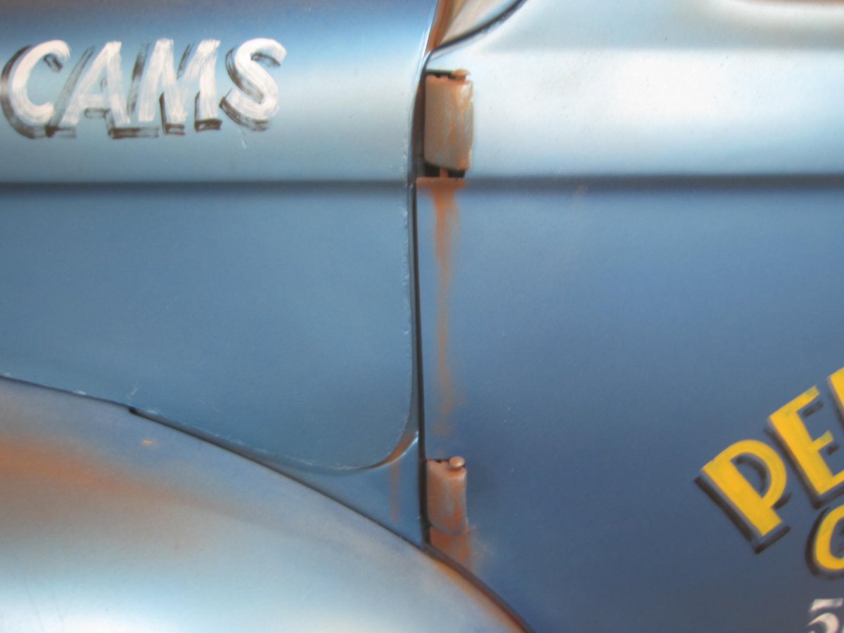

    I did mine like this, its urethane two stage with out the clear, its super durable and looks old and patinaed, just a thought....I made fake rust stains and all lol

    hi there, i took some red laquer primer and mixed a little brown tint in it to get the rust color, then I took a small model car brush and slathered a light coat on the areas I wanted rusty, and while it was still wet I took a dry paper towel and wiped it off so it looked really like a stain. the dust is done by taking 3-m panel adhesive and putting a paint spray can nozzle on it so it comes out real fine, I mist the entire car down with the glue and then I take dust and blow it all over the car. when it looks right I mist the car again to seal it in and presto permanent dust!!!!!!
