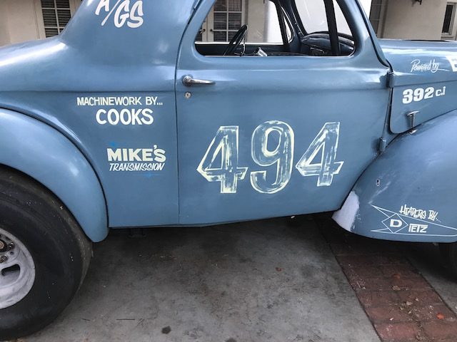

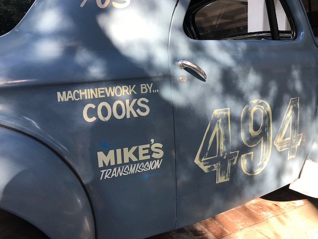

  3. drumyn29
    Joined: Feb 16, 2006
    Posts: 2,405
    drumyn29

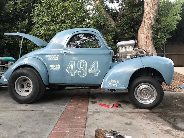

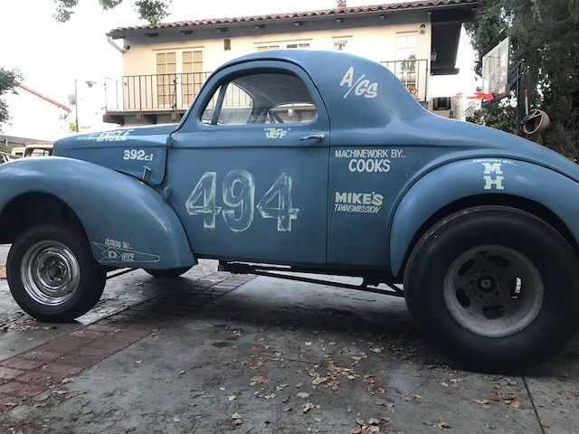

    I love the lettering but I am still on the fence with the patina numbers.. I think I have a better idea for the rear end cover.

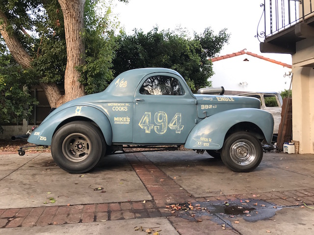

    I made some time today with being sick and taking off work. HEMI-FIED!

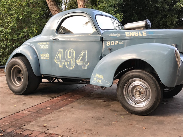

    I got my diamond seats back today and a great idea from Elgringo about Gibbs to freshen up the rears before the Gasoline magazine shoot tomorrow. I think it's the first time that i have washed the car.

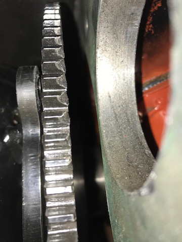

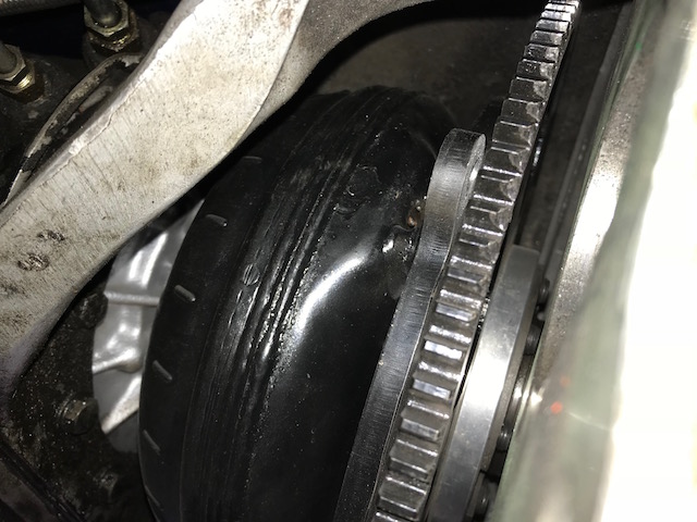

  21. drumyn29
    Posts: 2,405
    drumyn29
    Chinese junk!

  24. t-rod
    Joined: Feb 7, 2009
    Posts: 432
    t-rod
    I know nothing about early Hemi's, other than they're cool. Could it be a starter misalignment?
    Bad decisions make good stories.
  25. drumyn29
    Posts: 2,405
    drumyn29
    Everything i do is a bad decision! :)
    I've second guessed, measured and inspected starter and flex plate a few times and I can't see anything odd. It started happening within the first few starts of this motor and everything is new out of the box.

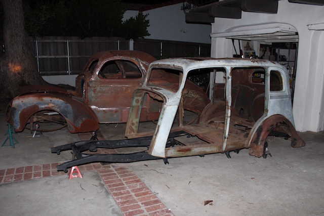

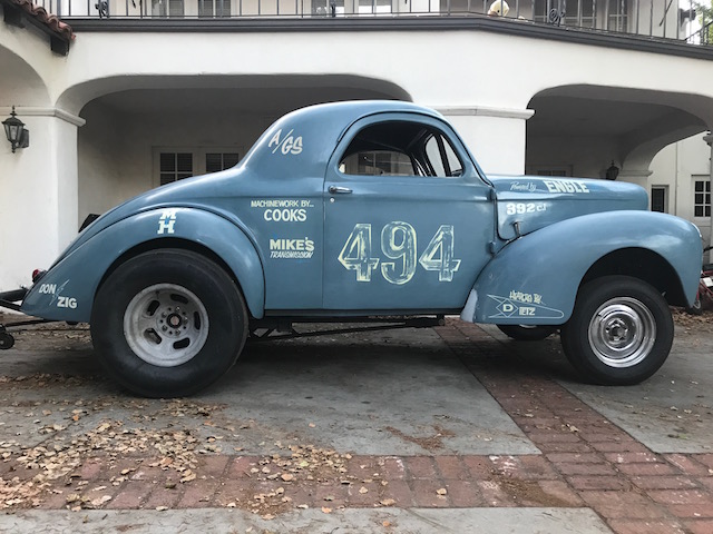

  26. elgringo71
    Joined: Oct 2, 2010
    Posts: 3,868
    elgringo71

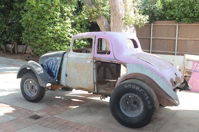

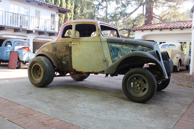

    To have gone from this
    To this
    and have done the build mostly by yourself you must have done something right
    It is all part of the journey and makes you wiser through the experience

  29. drumyn29
    Posts: 2,405
    drumyn29
    I spoke with TCI and they are absolutely useless! Powermaster was amazingly helpful as usual and we came to the conclusion that the aluminum crank hub flexplate spacer needs to be machined down a bit to pull the flex pate in closer to the starter. Either that or the flex plate isn't perfectly flat, It's only one area on the flex plate so I won't know until I take it off.
    elgringo71 likes this.
  30. greaser
    Joined: Apr 30, 2006
    Posts: 866
    greaser
    You might want to check the runout (both axes) before removal. Wear pattern looks like the ring gear is not flat to me, and distortion may relax after removal. (Problem could be related to the crank hub)??
