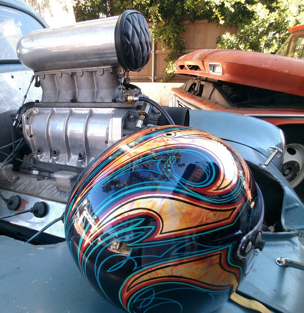

    Got my helmet today and had Bob Higginson help explain tuning a Hilborn, ready to race.

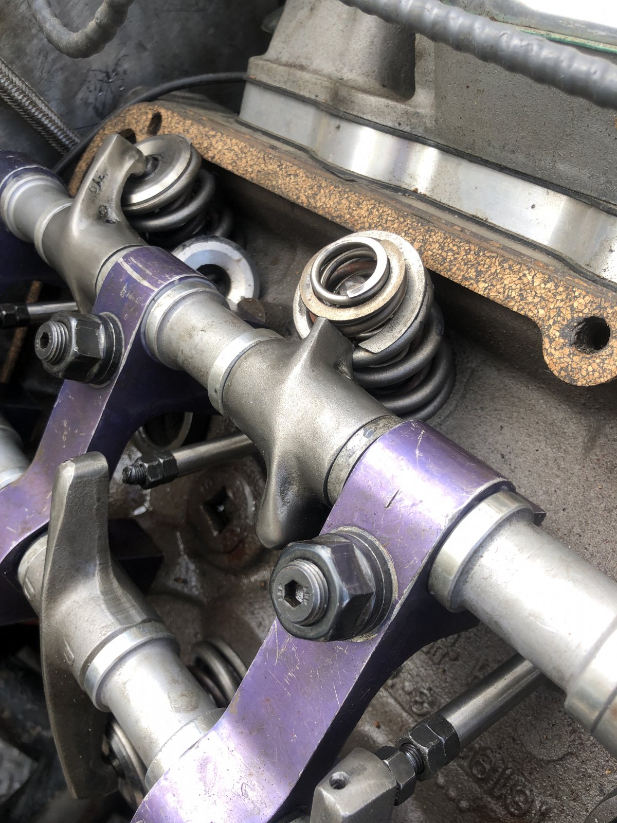

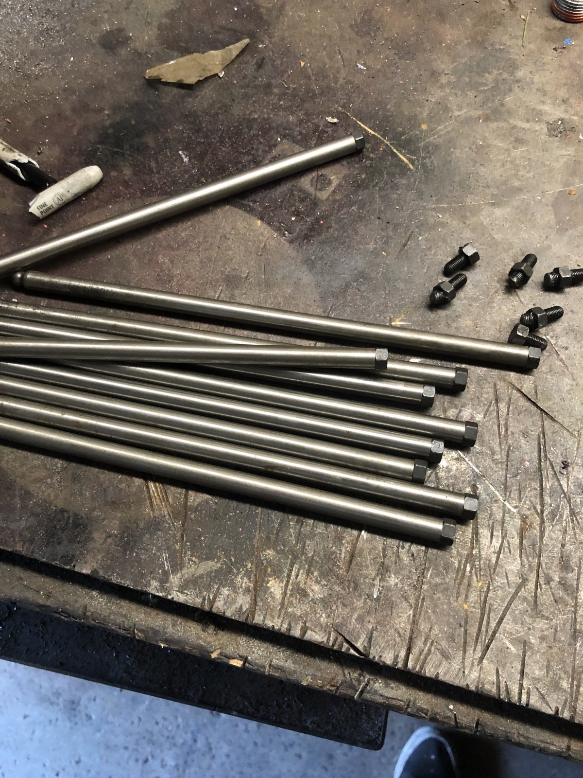

    So, last week I found a spot nearby to start my car and tune it without ******* off the nieghbors! I soon learned that I snapped of a few of my pushrod tips, so I made calls to Nick smithberg, Higgenson, Gary at Rocker Arms Unlimited and Valley Head Service. I then decided to gamble and try to learn and understand "the why", so I installed larger pushrods tips and my other set of donovan rockers that Gary built to accept the larger tip pushrods. Started up the other day and the same thing happened as well as breaking 2 rocker arms. Today I installed a different set of heads with smaller springs and smaller tip pushrods, I added 30 degrees of timing and it sounds like a ****D APE! I think I concluded that the rockers were hitting the spring retainers. This experiment cost a few dollars but I learned a lot, It's good day to be alive!!

    No oil thru the rockers?
  16. drumyn29
    Joined: Feb 16, 2006
    Posts: 2,405
    drumyn29
    nope, I need to oil between rounds.

    We use to use caterpillar peanut ****er on the rockers and tips of the pushrods on the A/F car.
  30. lippy
    Joined: Sep 27, 2006
    Posts: 6,855
    lippy
    from Ks
    And oil the rockers of course. If I had it to do all over I would put a top end oiler setup on ours. JMO. We ran ***an rockers. *****in job bud. Lippy
