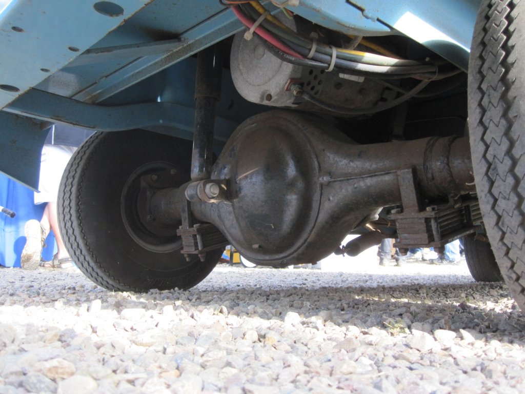

    Look for a Taylor-Dunn utility vehicle. They used the Ford 9" rear, with some tiny brakes you can swap out, on very narrow vehicles. Even the electric ones use the 9".

    What he said.....................We have the 3 wheeler electric ones at work, and they have 9 inch diffs in them, and may be NARROWER, than you wish............

    I'm in San Diego at a Navy place at a robot competition...drove my 55 chevy over here. Fun! Saw a TD cart, looked under the back, what do you know. 9" ford.

  14. Don't hold out on pics of the cart.
