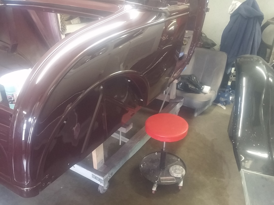

    So we have been in the process of restoring my wife's 1961 Chrysler Imperial. The guy that is doing the majority of the work for me debated with me on how to paint the car. He wanted to paint the car apart so that the jambs do not have a tape line. I wanted the car jambed out first, ***embled then painted together with a good back tape job done in the jambs.
    Regardless if all the paint is in the same can, air pressure, spray technique can all change the color.
    I let him paint his way, and this week I helped ***emble the doors on the car.
    Well now we will be respraying the car Saturday the way I originally wanted it done. Just wanted to share with you guys if you have never seen this first hand. The paint on the door and fender is the exact same paint out of the same gallon can and sprayed the same day. Needless to say my last comment to him was, "I told you so." 20180816_093706.jpeg

    no first hand experience, but I've been told metallics are good for that, especially if the doors are layed flat or hung at a different angle from how they will be mounted. the flake flows out in a different pattern and that's the result. IF you wanted to do it his way, hang the doors upright.

    The doors were upright, if I were to bet, it's a air pressure change, or pressure build up in the disposable cups, causing a pressure difference even if he was spraying the same air pressure. As the disposable cups collapse it reduces the amount of paint coming out.

    The Gravity Feed spray guns with the cup above allow the metallic to settle , must be emptied between coats , can also lead to spitting chunks if not thoroughly cleaned and strained between coats.

    I don't mind painting non-metallic in pieces but never metallic. Even on non-metallic you have to be careful on the number of coats or you can see a color difference.

    Even air temp and humidity can change the color. When I was mixing paint for a living, it was a never ending battle. Try to match a car sprayed in Detroit in January when you are in Texas in the summer.

    Yea when I teach a color match and blending cl***, I make them use 4 different spray out cards and spray each one at different air pressure, then give them 4 MORE, reduce the paint with faster reducer and 4 different air pressures and we end up with 8 different color. That's another reason why we say, "PANEL PAINT AT YOUR OWN RISK"
