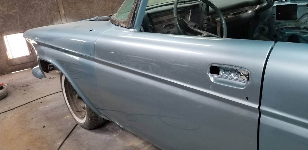

    Lol well it happens alot because a lot of trash comes out of the gaps etc. So that's why guys like to disassemble before painting, But if you will learn how to back tape and look at a foam tape line called j-tape you can assemble car then paint. The foam tape will go into a lot of gaps (like between the fender and door) and keep the trash to a minimum and hardly any type of paint line.

    Again...Thank You..... I have heard about panel paint match problems, but never seen a good example. This is a very good example!

    Almost impossible to paint a metallic panel out of place and have it match. As to full modern cars that are way apart, like no engine, interior, etc, painting it as an assembly gives you an extra effect of having an OEM look. By that I mean you'll miss everywhere "they" did. Leaving out the inner fenders or seal panels for the jambs lets you reach into the hinge area with the door closed. Some of you can see this in your heads right now I'm sure.
    For a whole car just remove the latches and open and close the doors as you go if you REALLY have worries about tape lines. But those tape lines, refer to what loveoftiki was saying about jamb seal tape. Even with the best intentions and product there's still a telltale haze, so now what? The very last thing you do before the final cut and polish, but after sanding, wipe it off with solvent. Not too much, not too little. Too much you'll "wash" too much off. Too little you'll deposit lint and trash from it just being sticky. It's a developed touch so play where it won't hurt so bad.
    Last jamb advice, paint em in after. "After?!? Are you nuckin futz?" Nope. After. Over spray? Maybe a little. Tape edges? Not if you back tape like guru was showing and watch your work. Why after when over spray and edges can happen? If you're going to sand and polish you know you can manage it from there, no? 4 decades of chasing the "ghosts of quality" or the ultimate finishes, you finally learn what matters and what doesnt. Have fun...;)
