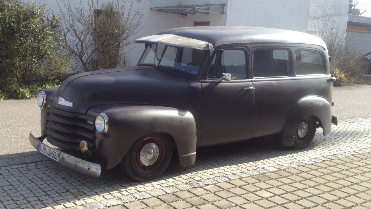

    Hahaha, Cosmo, yes, I have been asked that before and I know that :) And there are many more incorrect parts on the truck.:)
    The story is, the rear bumper which is on the front now , came with the truck and was badly twisted, so I straightend it as well as I could. For the rear, I found a pretty decent and cheap pickup front bumper in the local cl***ifieds. It was not good enough for the guy´s resto project, so he bought a new one. Good for us.
    Now that we had two bumpers, Dani took a good look at them and said she wanted the bad one on the front , just in case she would hit a curb or something else, because it would be a shame to ruin the nicer one. That´s the story behind this :)
    Did someone notice the modified radiator support? I had to do that , because we were given a perfect and free 51 Chevy p*** radiator that had already gotten a new core years ago. Obviously they were running straight water in it and it was extremly clogged, it looked like a limestone cave inside and was pretty heavy for a radiator. So I filled it to the top with vinegar based bathoom cleanser and water and let it sit for a few months. When I flushed it my driveway was completly white from chalk, but there was still calcium in there. But it worked since the radiator was considerably lighter than before. Another fuel up with vinegar cleaner and water and after a few more months the radiator was clean as a whistle inside .
    Another one....On final ***embly the hood would not stay closed. The tongue on the hood lock was worn enough to not engage anmore. Someone had already fixed it by brazing it up, but it had worn out again. I had to weld it up 1/2" and grind it to shape to make the hood stay shut. I was doubtful of that repair and explains why we had the hood strapped down on our trip to Berlin. But after the first 1500 miles of driving I´d say it worked ok, hahahaha
    The reason why I am explaining all of that is, we car guys have a different approach to a project. We buy what saves us time what we think is cool. To Dani , Urban was alreday cool from day 1, hahahahaha
    If I ordered a new hood latch from Ecklers that would have been another 200 Euros after shipping, tax and duty. Dani would have had an expense but no visible progress. That is why I tried to focus on spending her money on fixable used parts where it made sense and buy all new when things were safety related ( frontend bushings, brakes, steering components, wiring harness, bearings etc).

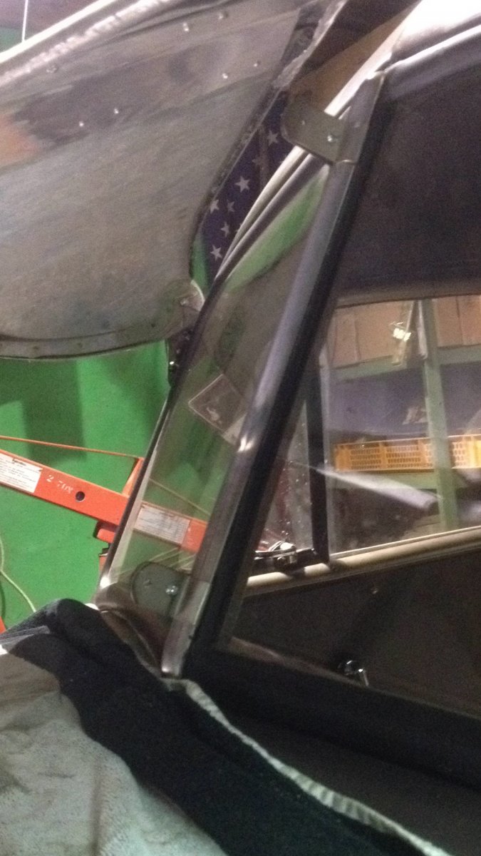

    Sooo, I have not updated this thread in quite a while because....I just didn´t do much on Dani´s ´burban other than a carb rebuild. But now, that I have some time to kill, I´ve got a "honey-do list" from her. So I put some insulation inside the roof and made a headliner out of ABS sheets, which worked pretty well. ABS is some kind of recycled plastic which is pretty flexible in one dimension and it can be formed in many directions if it´s hit with a heat gun. This was not necessary, because the headliner sheets on a suburban are only stuck into a channel inside the roof and kinda lock themselves into place. The material came pre cut, I just had to trim it to fit,like round the corners, cut out holes for the crank handles and so... It was about 100€ . Plus shipping
    The surface is a bit like artifical leather, it has some structure . Maybe I´ll fab some bow to cover the areas where the sheets **** against each other, but Dani´s said that´s find for her, so I might skip it, hahahaha
