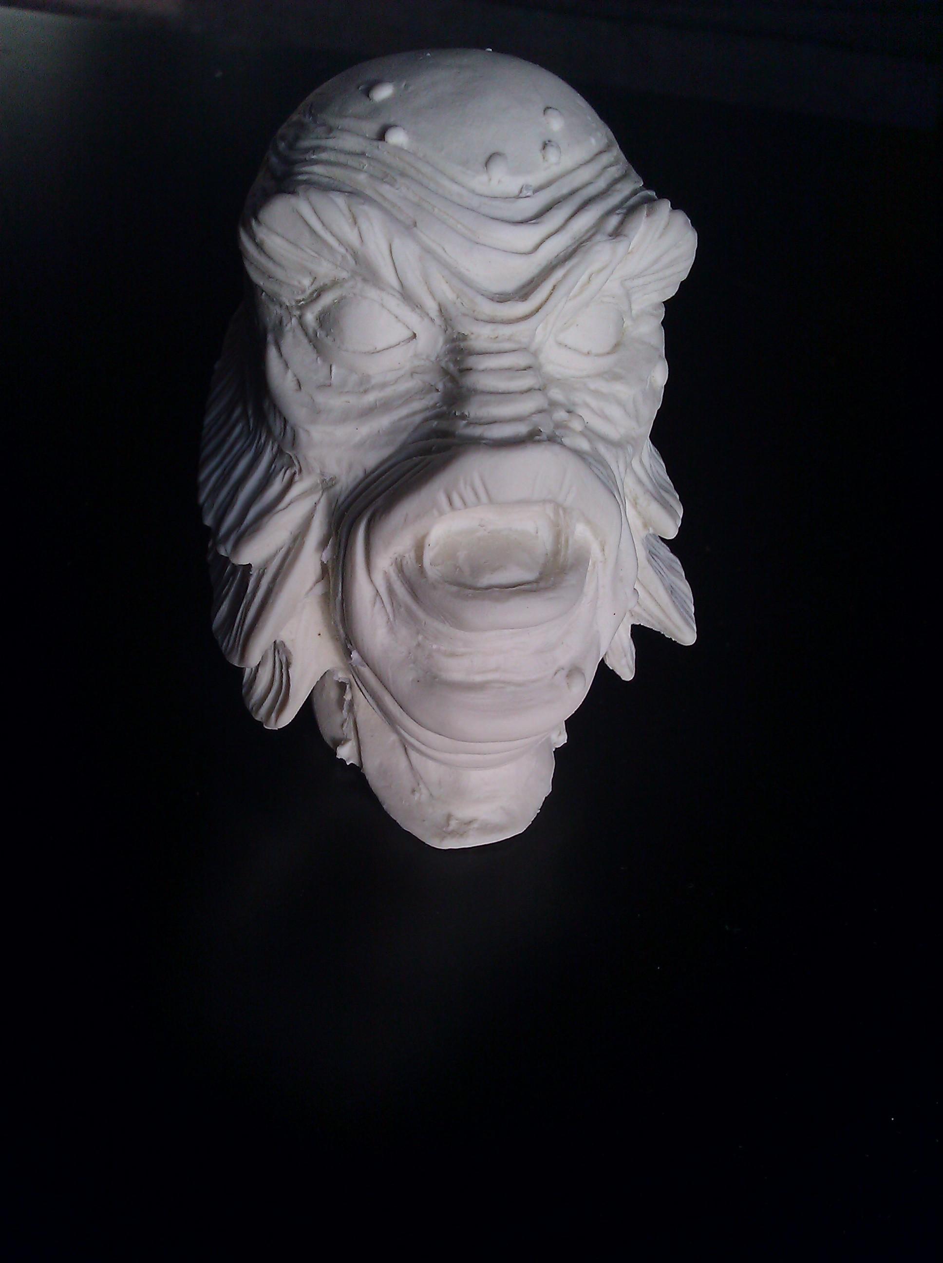

  20. Hot Rod Panda
    Joined: Mar 7, 2011
    Posts: 27
    Hot Rod Panda
    Well, waiting on the motor issue. In the mean time, Jack got me an awesome shifter knob. Just have to decide how I want to paint it now...

  23. SteppinOut
    Joined: Jul 19, 2008
    Posts: 542
    SteppinOut
    That looks like one of Jimmy Flintstone's resin knobs. If so a good soaking over night in Wesleys Bleche White white wall tire cleaner will remove the mold release. Then you can clean it up with sand paper and prime and paint just like plastic. You can even hand paint the details and then clear it. I have done a few of his using model car paint or even duplicolor or other touch up paint.
