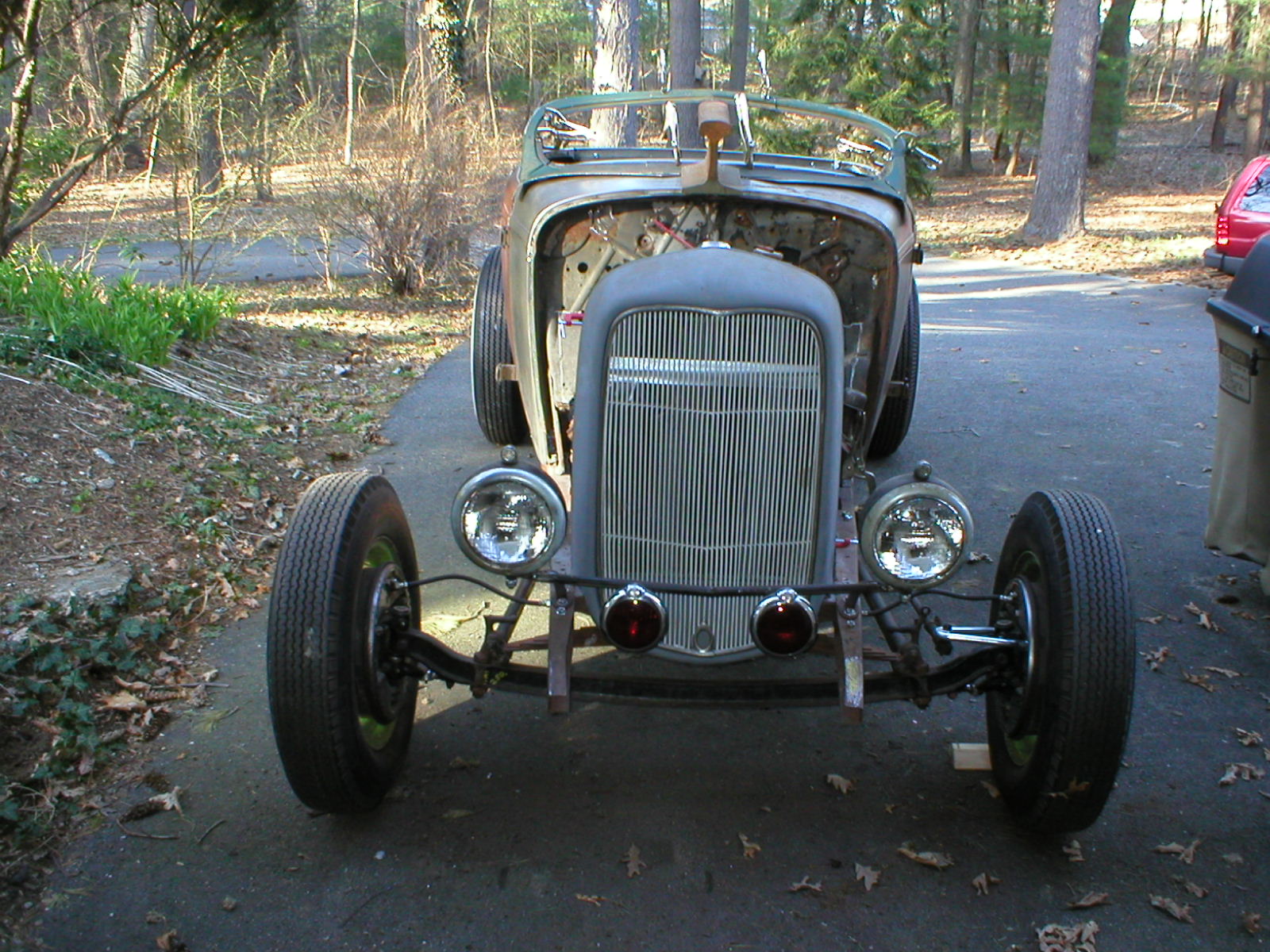

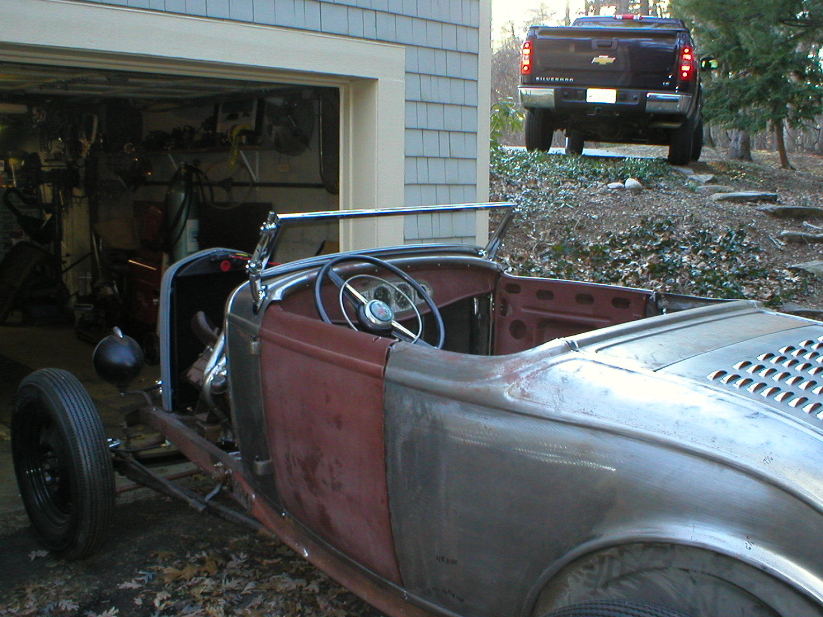

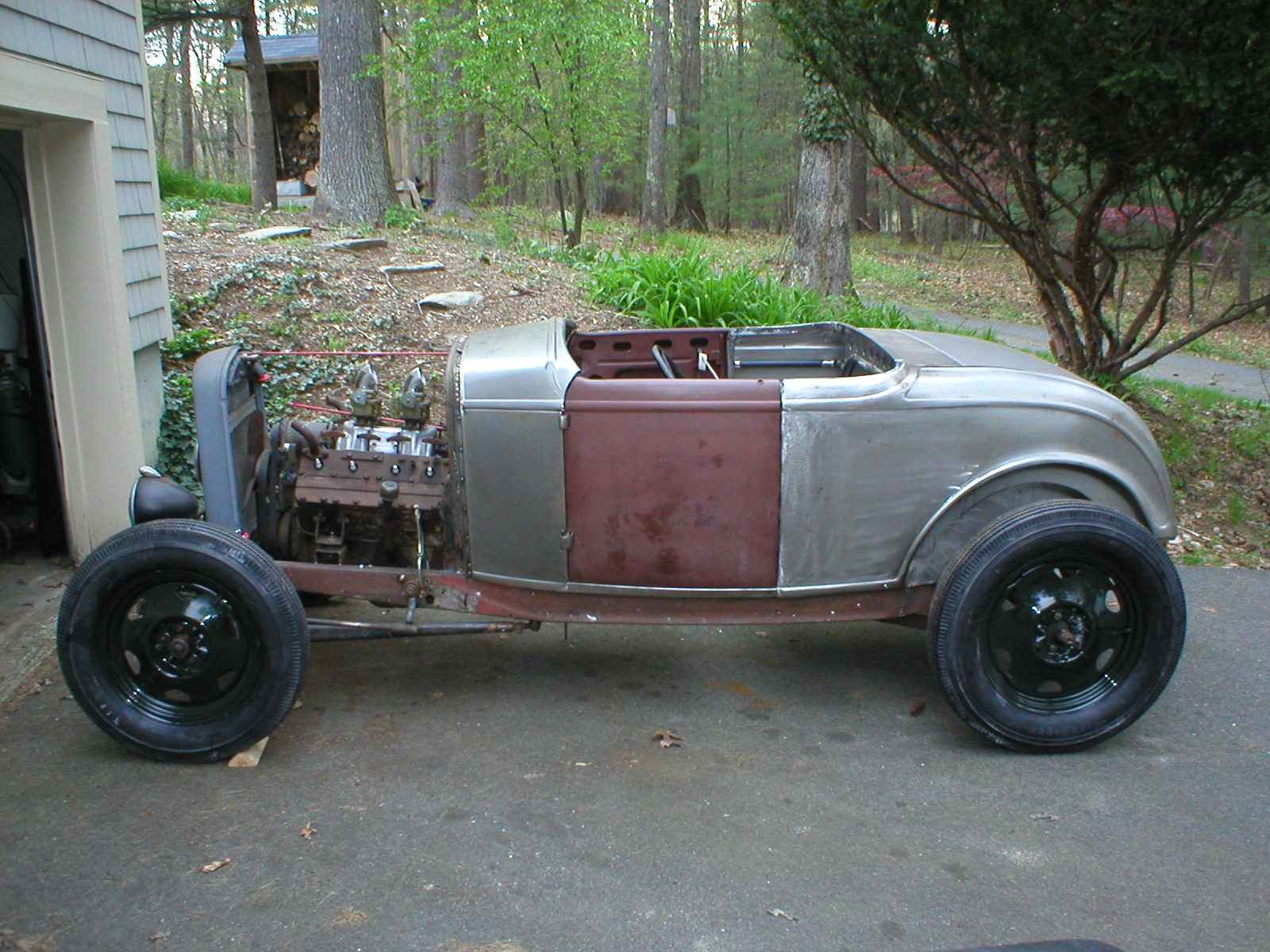

    Iv been working on this car for about 2....2-1/2 years now, it started at all repro pieces from several manufacturers with some pieces being seconds. I bought the rear quarters from Rod-bods as seconds...what a pain in the ass, these came untrimmed and both quarters were slightly different. I had to split the passenger side in several places in order to fit it properly or to a point where I could sleep at night. It sits on an original '32 frame with a 33-34 x-member, '32 big beam front axle, 33 front bones, F1-front brakes and a 46 Ford pick up open drive banjo. The motor is a '48 Cadillac with the original 3 speed laselle tranny.
    Just thought I would throw a few pics if it up...I dont really snap too many photo's while im working on it, but Ill try to take more and post as I go.

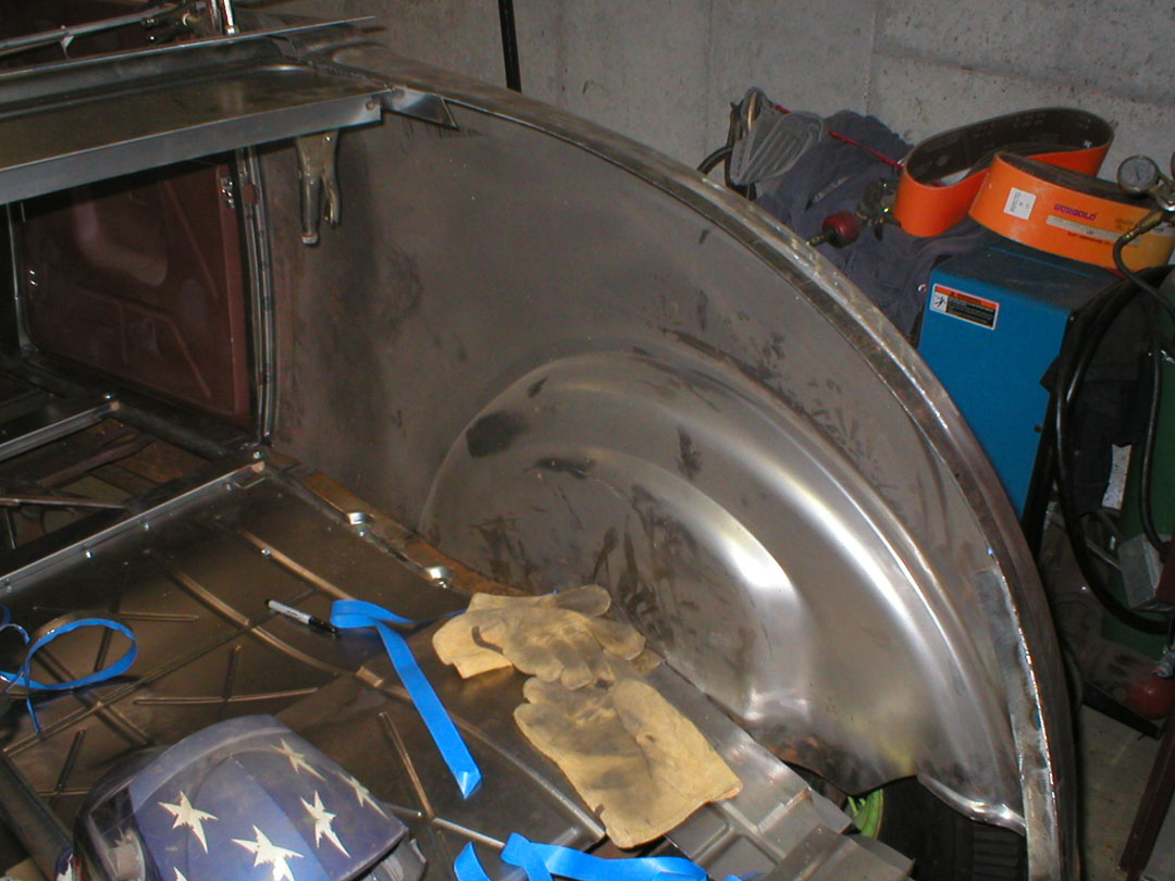

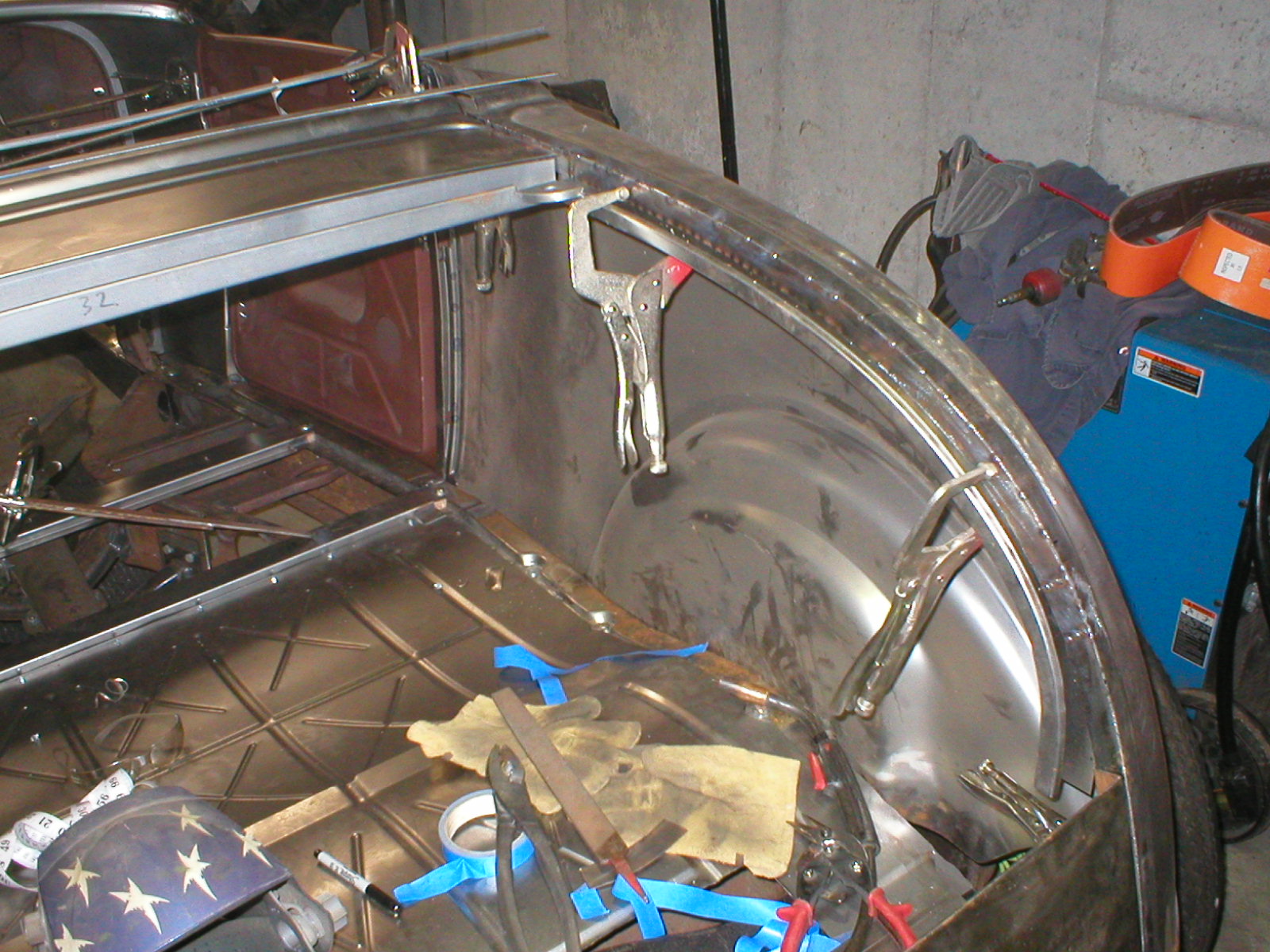

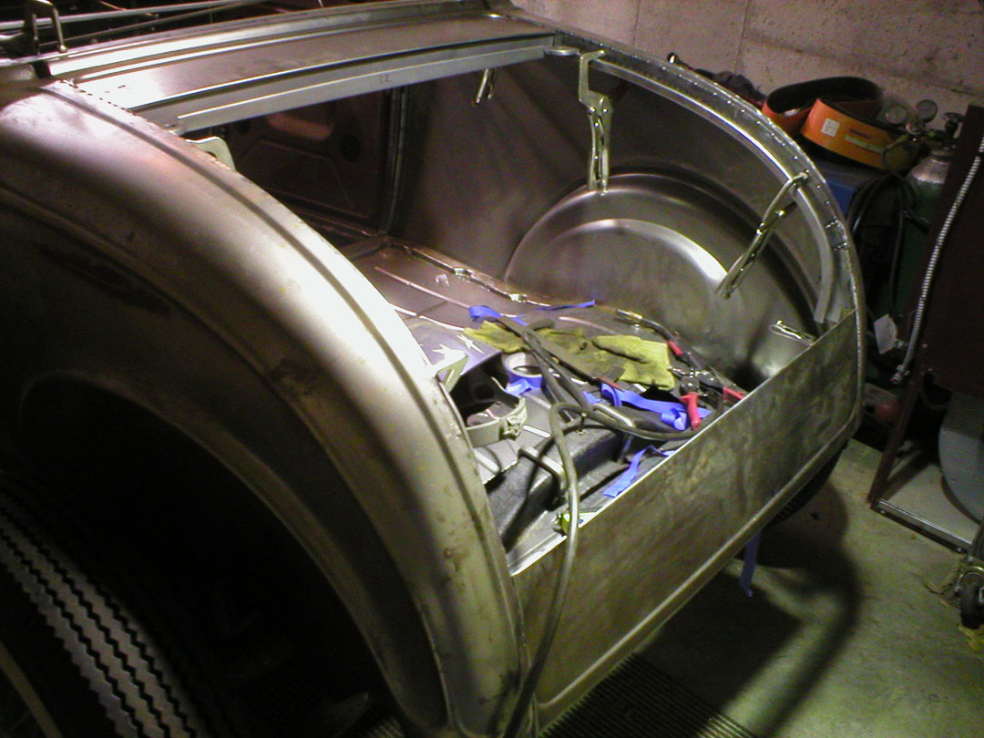

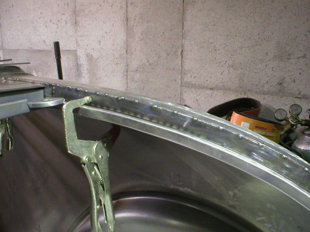

    Just found some more pics of the rear quarters. I had to trim the quarters before I could start making the inner structure that the gutters weld to.

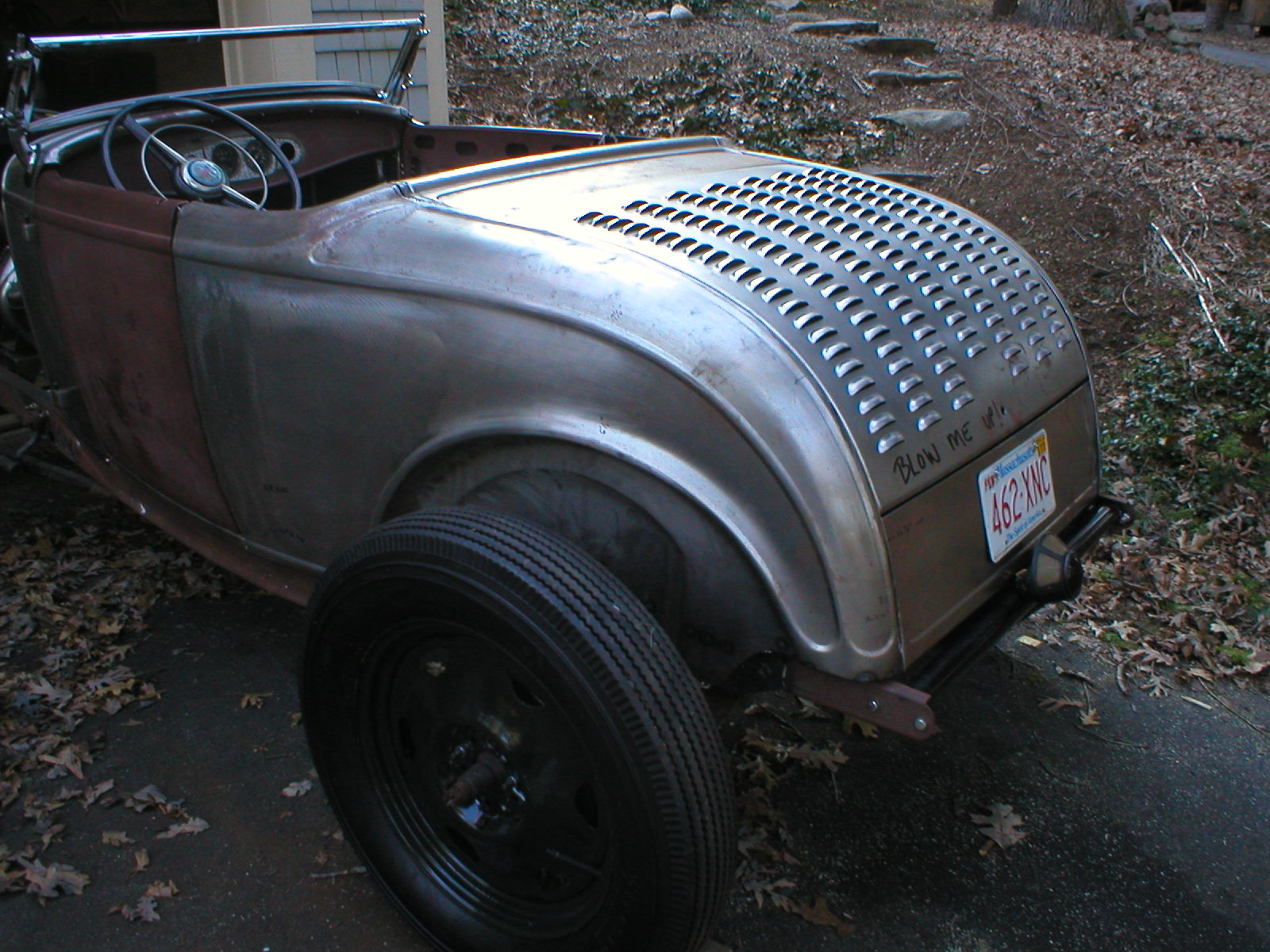

    wow love the (what looks like ) divco milk truck wheels..and the louverd trunk how many louvers are on it

    Fitting caddy motor was also pain. The fan assembly is quite long, longer than it needs to be...so If did a little finagling. I pressed the fan hub an additional 1-1/2 onto the shaft and made a new fan pulley a 1-/12 shorter using the stock one and a nailhead crank pulley. I also moved the front cross-member forward one set of holes so the fan would clear the radiator.
    Here's a few more early build pics.

    The quarters I used were second..seconds, Brookvilles are much better. Mine were missing lots of technical characters such as the B-pillar wrap around features so I had to use the shrinker/stretcher and make them. Let me know what you need for photo's, ill shoot as many as you need.

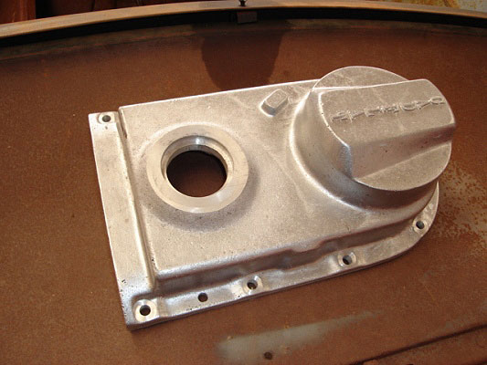

    Pete, have you thought about going with fiftyv8's timing cover and valley plates? The let you do away with the bulky fan and fuel pump( the timing cover does).
    They also upgrade you to a modern crankshaft seal.
