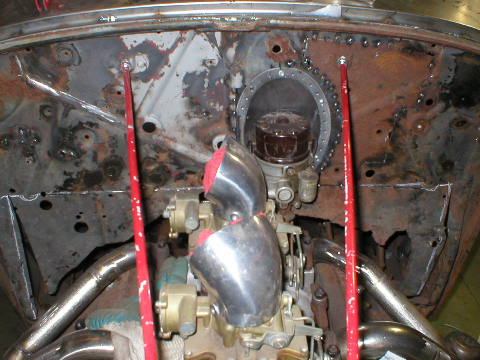

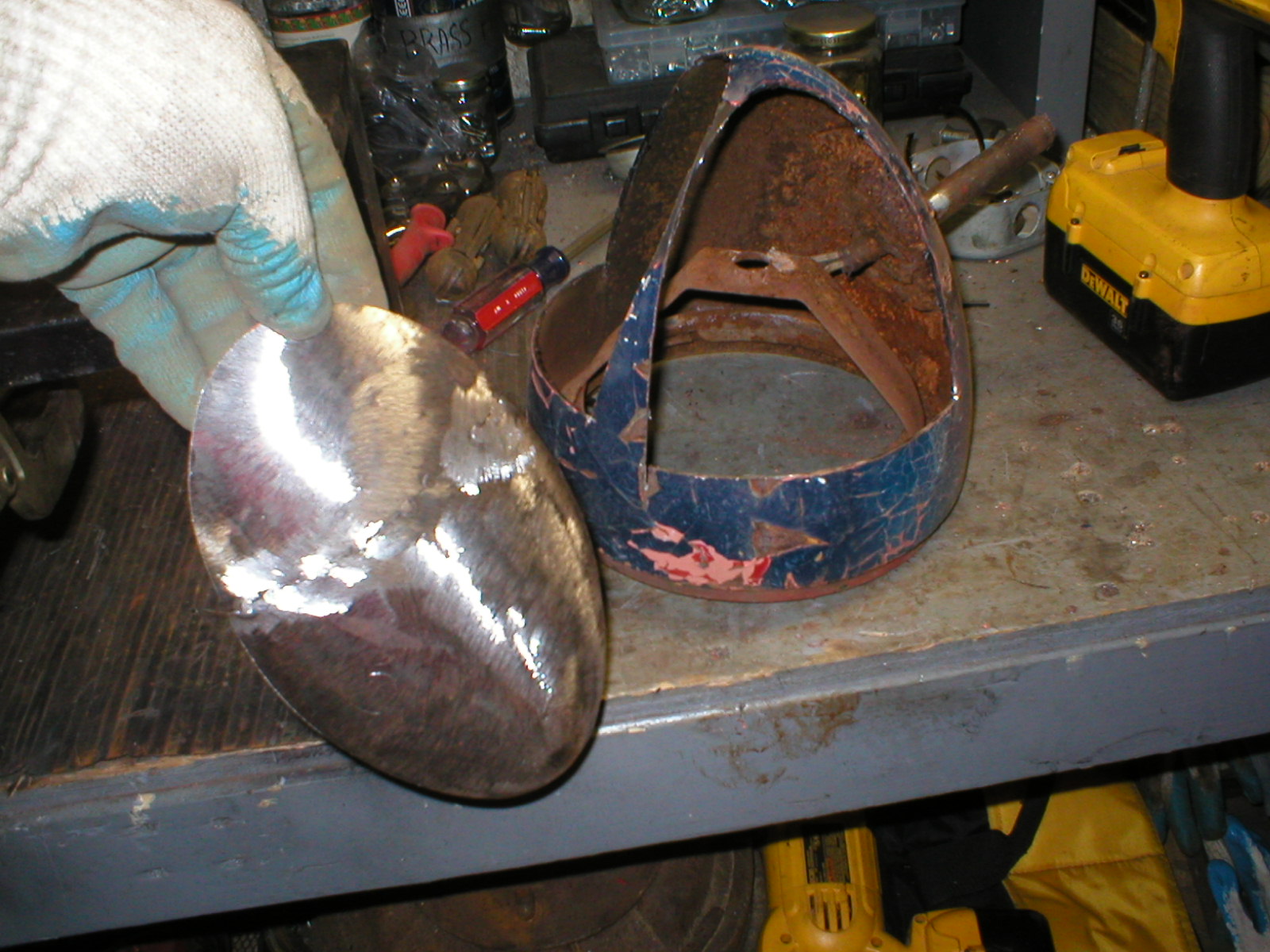

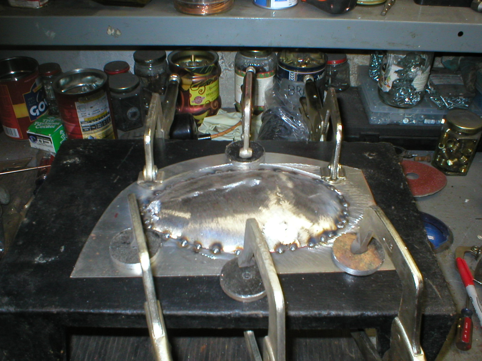

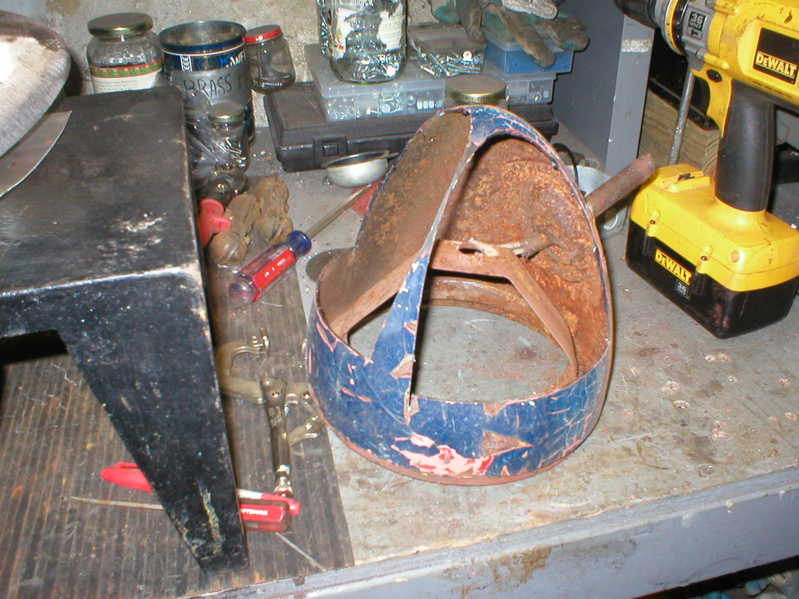

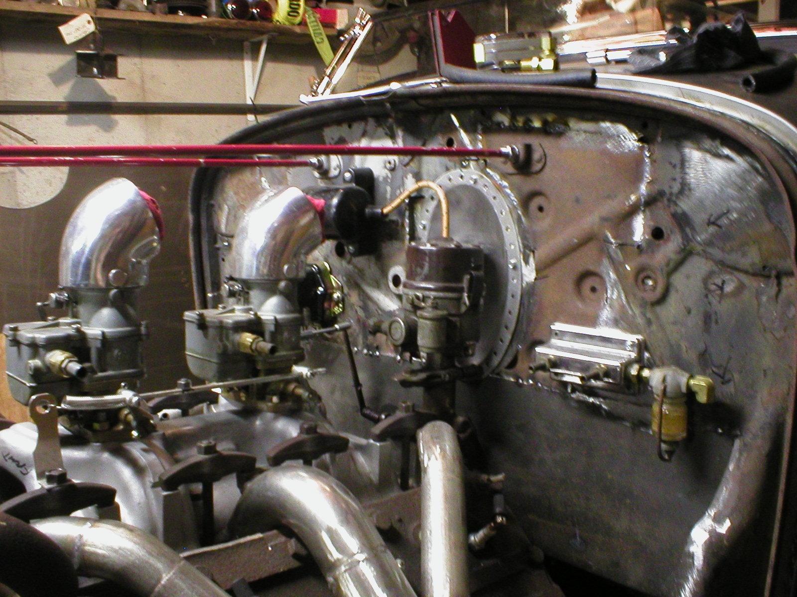

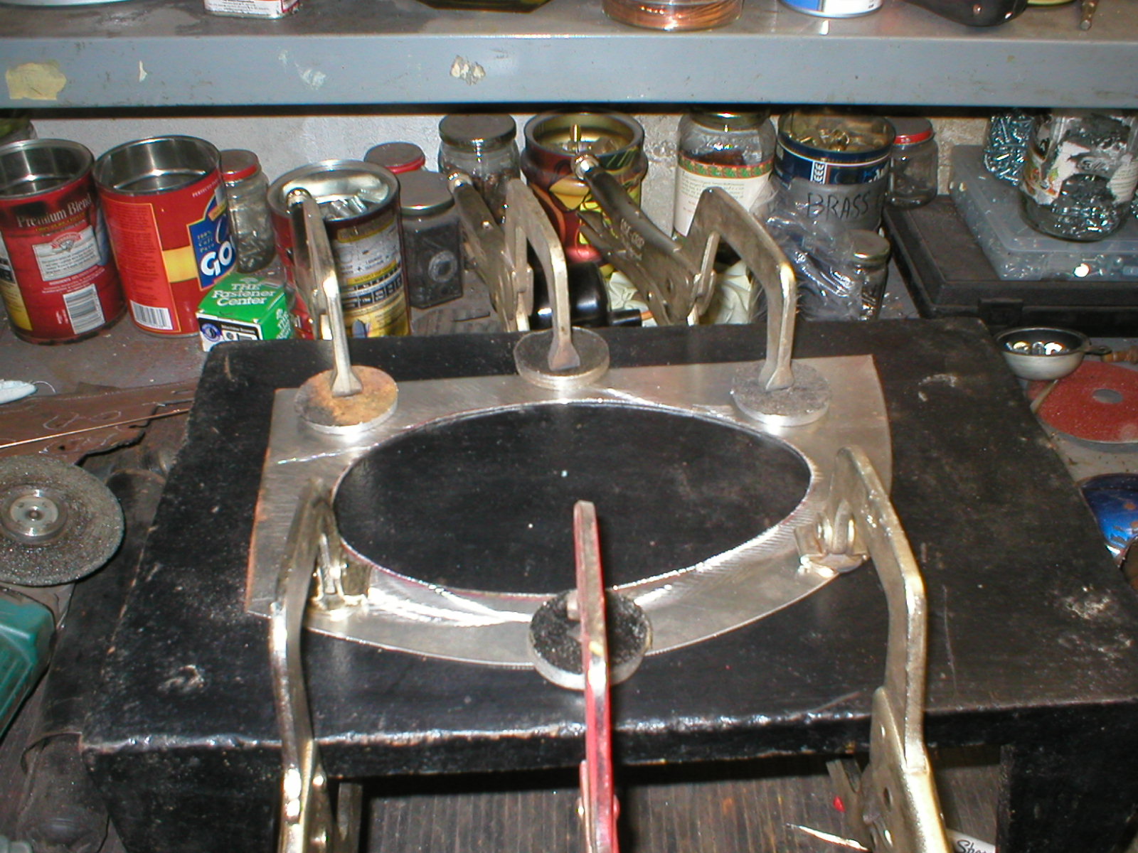

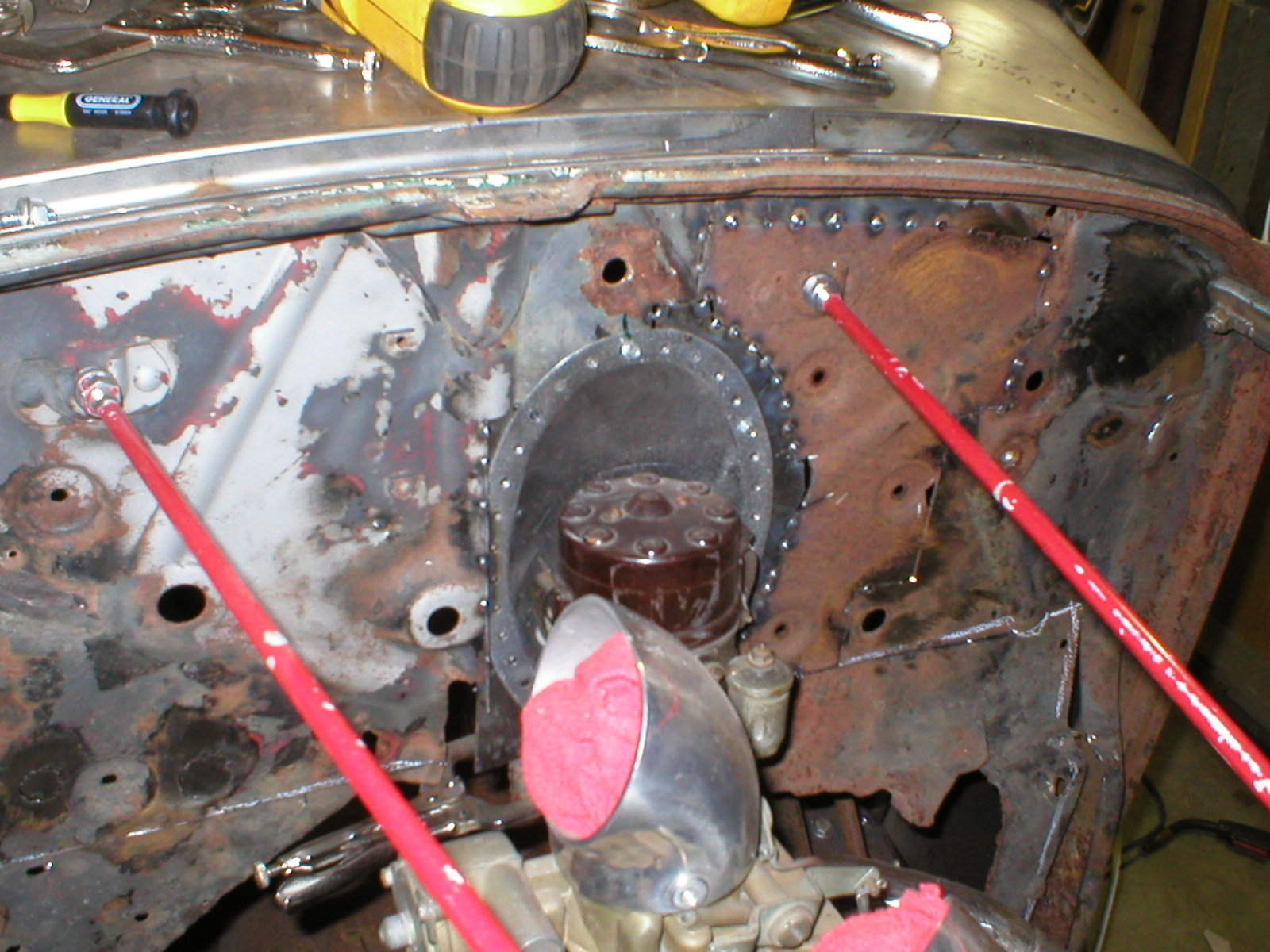

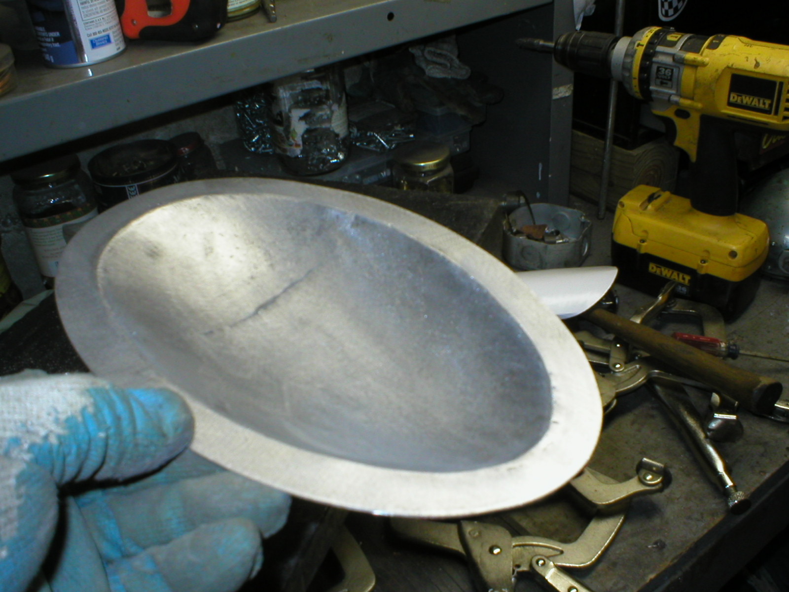

    Progress is slow but I managed to get a few small things done or partially done. The firewall I used was pretty much beat, had some serious issues and booger welded brackets all over it. I also have a real nice one but since I would have needed to cut it up to clearance the bell-housing and dist I just decided to use this one.
    Today I made a quick blister for the distributor. I used an old headlight to make the recess and some flat stock to make the band. Its currently being held in with a few screws but will eventually be riveted it.
    I have a shit load of more work to do on the firewall, hopefully this week I can get everything made and tacked into place....we'll see.

    This is why I don't throw anything away, there's always a use for it.
    Pete-

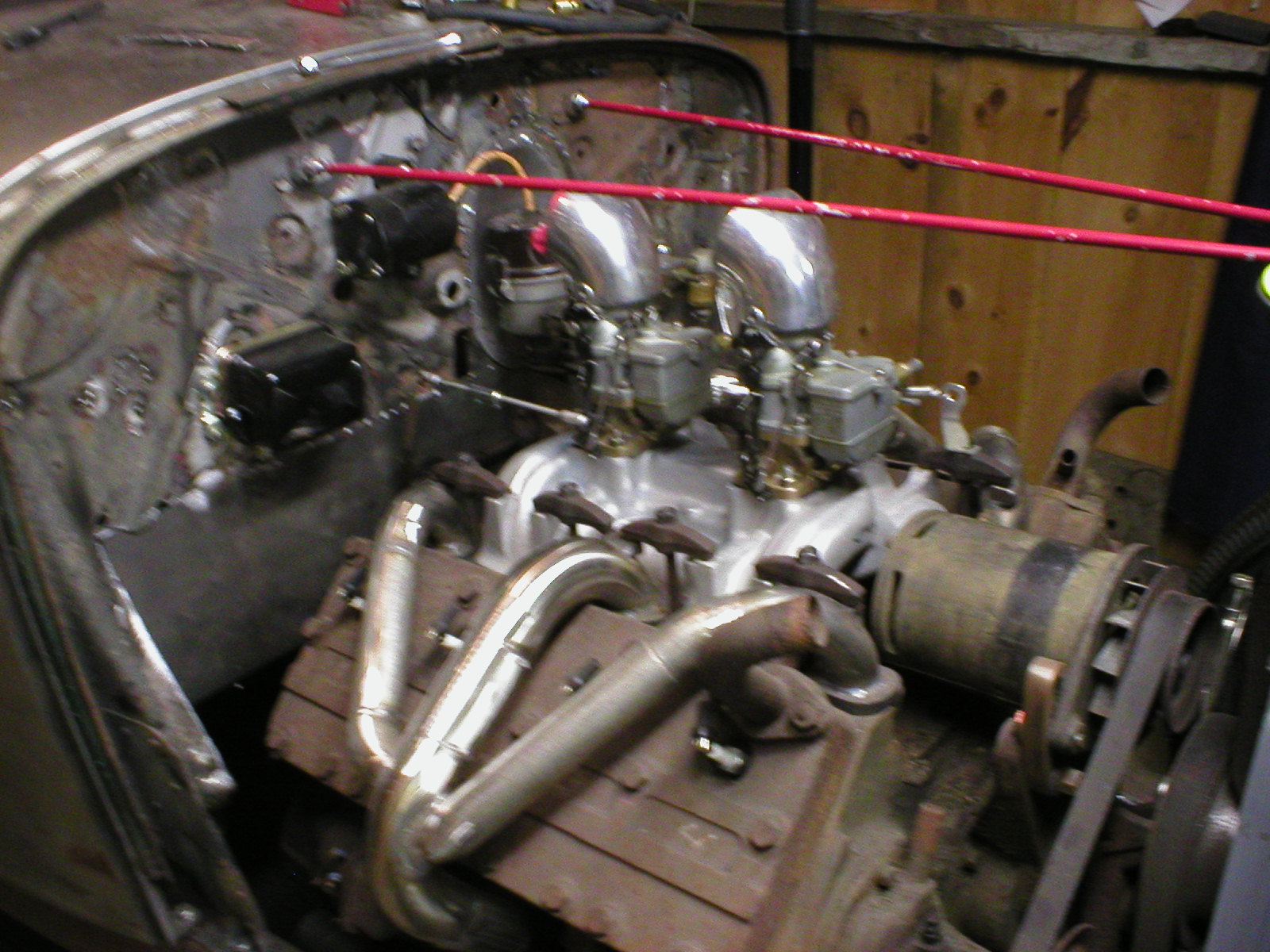

    A few updates. Had the caddy drive-shaft shortened and a new rear yoke installed, had Mitchel's in Shrewsbury do the work...in fact I have those guys do all my drive-shaft and hub work, they always quote the correct price, save the old parts and do it right the first time.

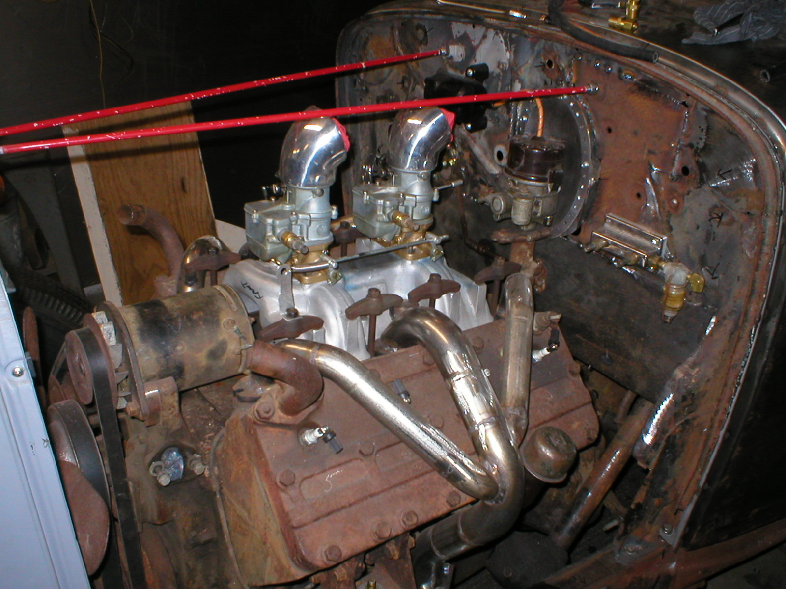

    I had the glass cut and installed for the windshield, mounted the fuel block, voltage reg., coil and got the pedal and linkage worked out. The biggest thing I did was to modify the intake. Its one of the Burrel re-pops, great intake but it only accepts 4 bolt carbs and I didnt want to and didnt want to run adapters. I kinda cheated a little in the process. I removed the bases from the 97's, set them up on the milling machine and slotted the two holes about a 1/16 th of an inch. I had to weld a triangle chunk of aluminum for the 3rd carb stud because there was no material on the manifold...all and all it worked fine and now I can run 3 or 4 bolt carbs. The reason I went through all this trouble was I already had 2 rebuilt 97's ready to go and I just really like the 97's.
    With that said, I got all the linkage made, pedal installed and adjusted,,,,,wont be long now.
