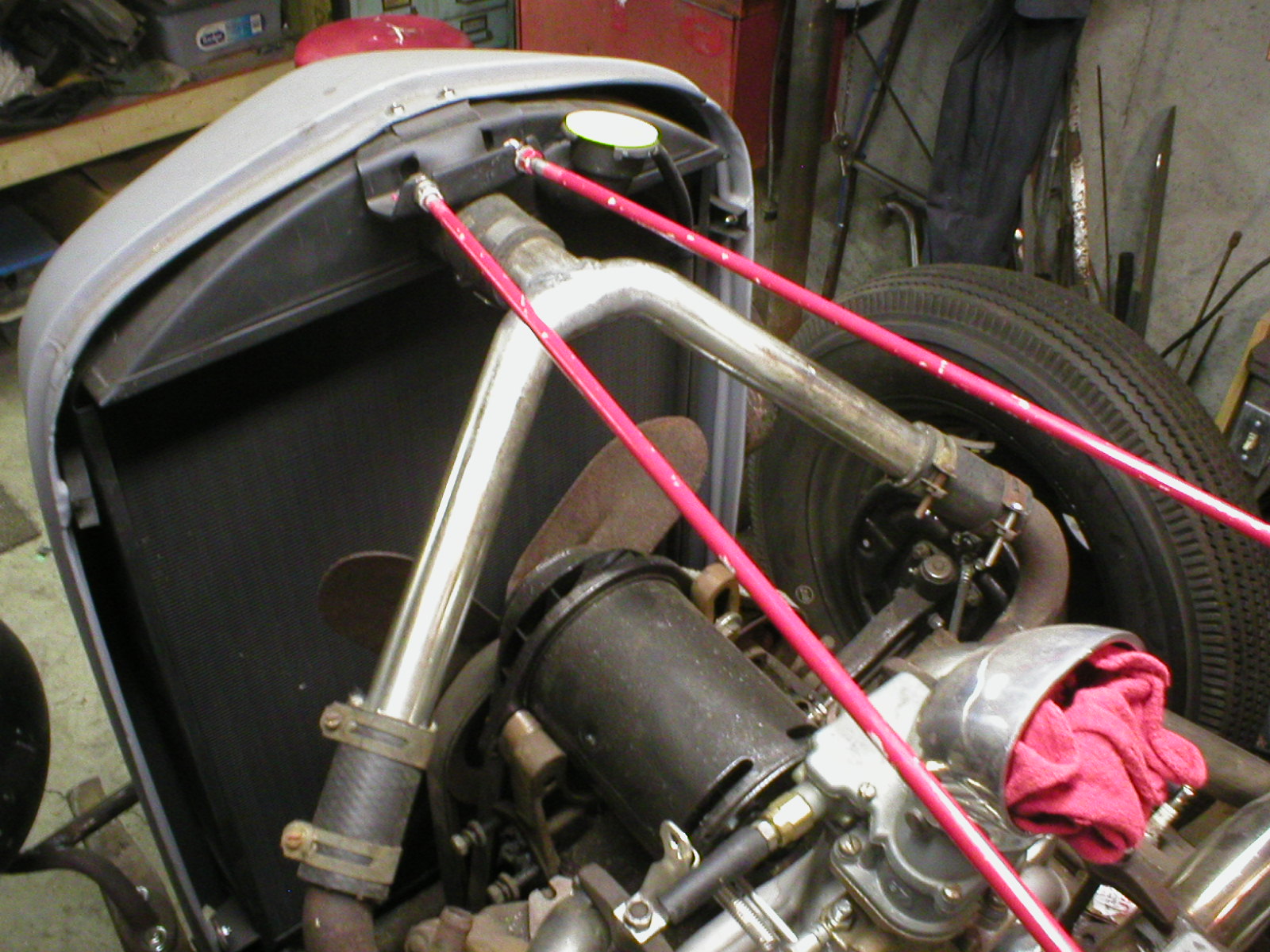

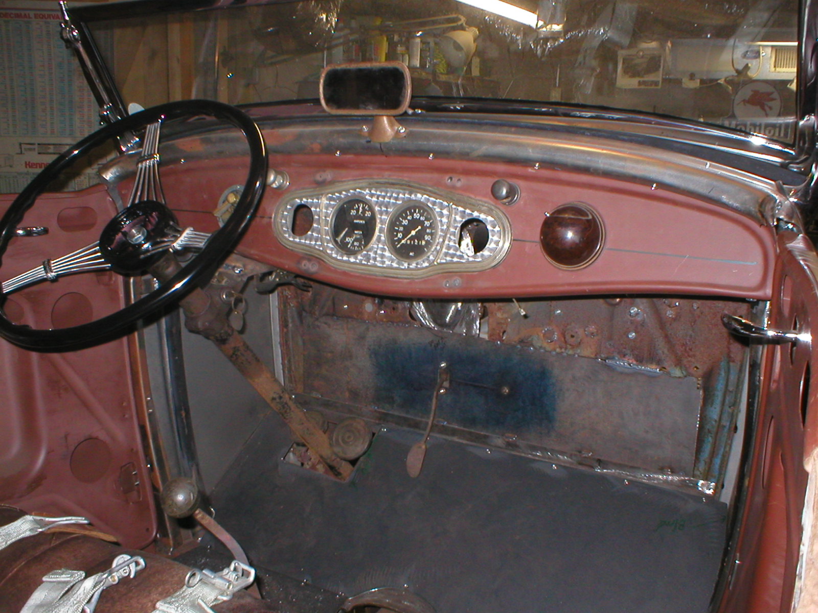

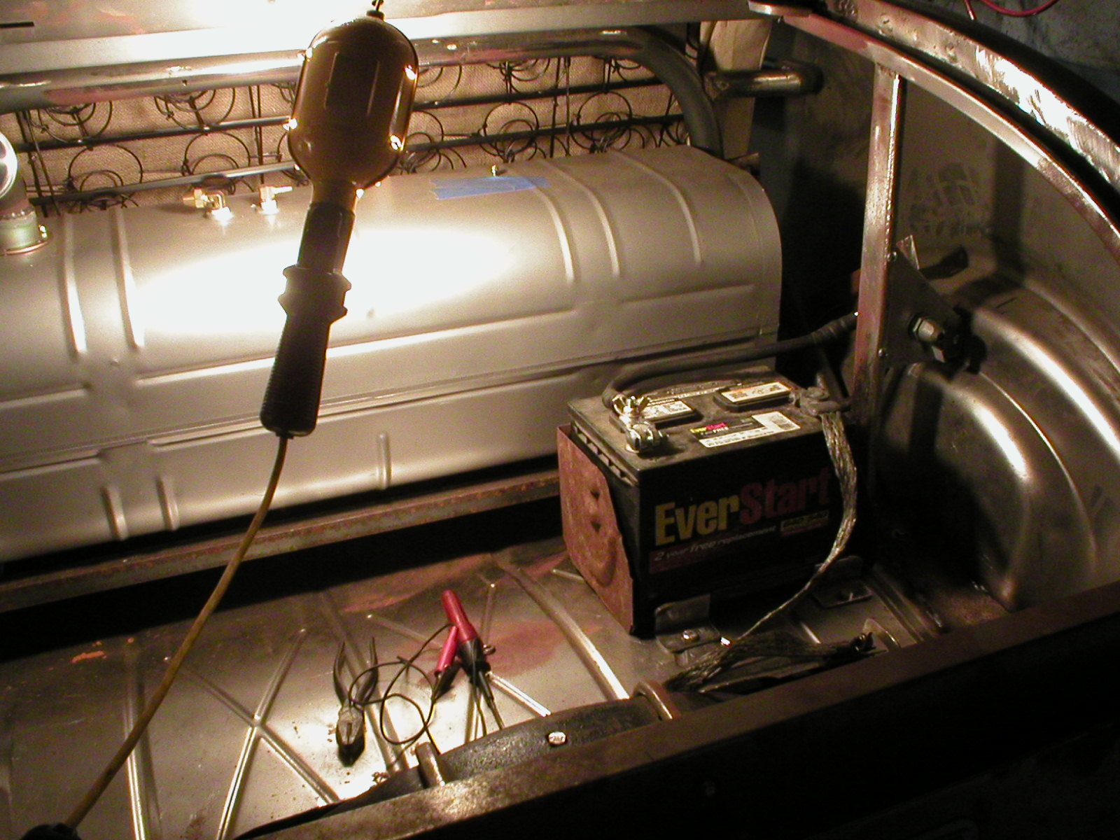

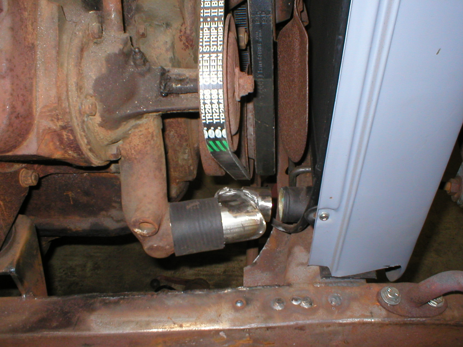

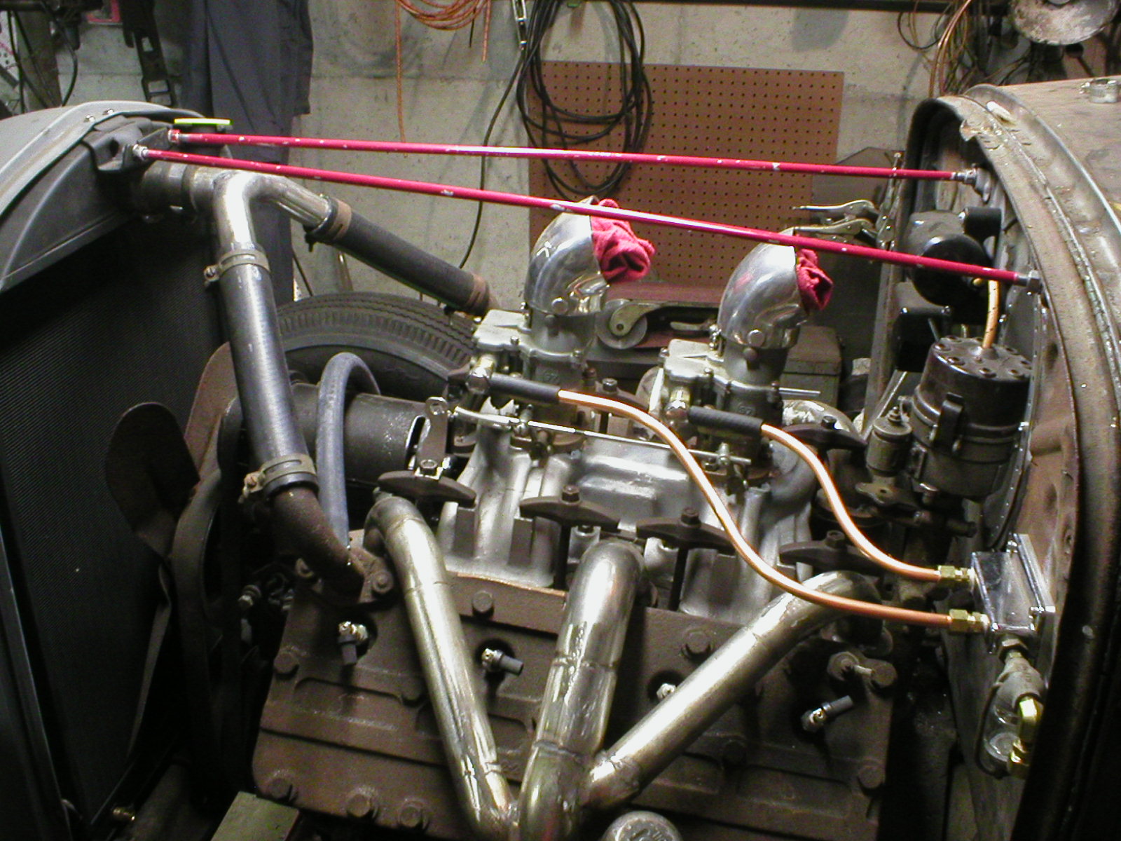

    Iv been working as much as possible on the car after work and on the weekends but between work and other obligations its just hard to get a full days work in. I was able to get some valuable time in last night and tonight. The body is pretty much ready to come off the frame and be blasted and metal finished, all the rinky dink shit that seems to take the longest is finally done....fuel tank mounted, battery tray mounted, all of the fuel line, battery cable and electrical lines have been drilled and dressed. Seat and seat belts are mounted and done, column drop was cut and re-angled. Clutch linkage and brake linkage are all done, dash has been fitted and filled with all the gauges and doo-dads. Taillight mount has been made, trunk hinges, latch and handle are finally done,,,,that really sucked.

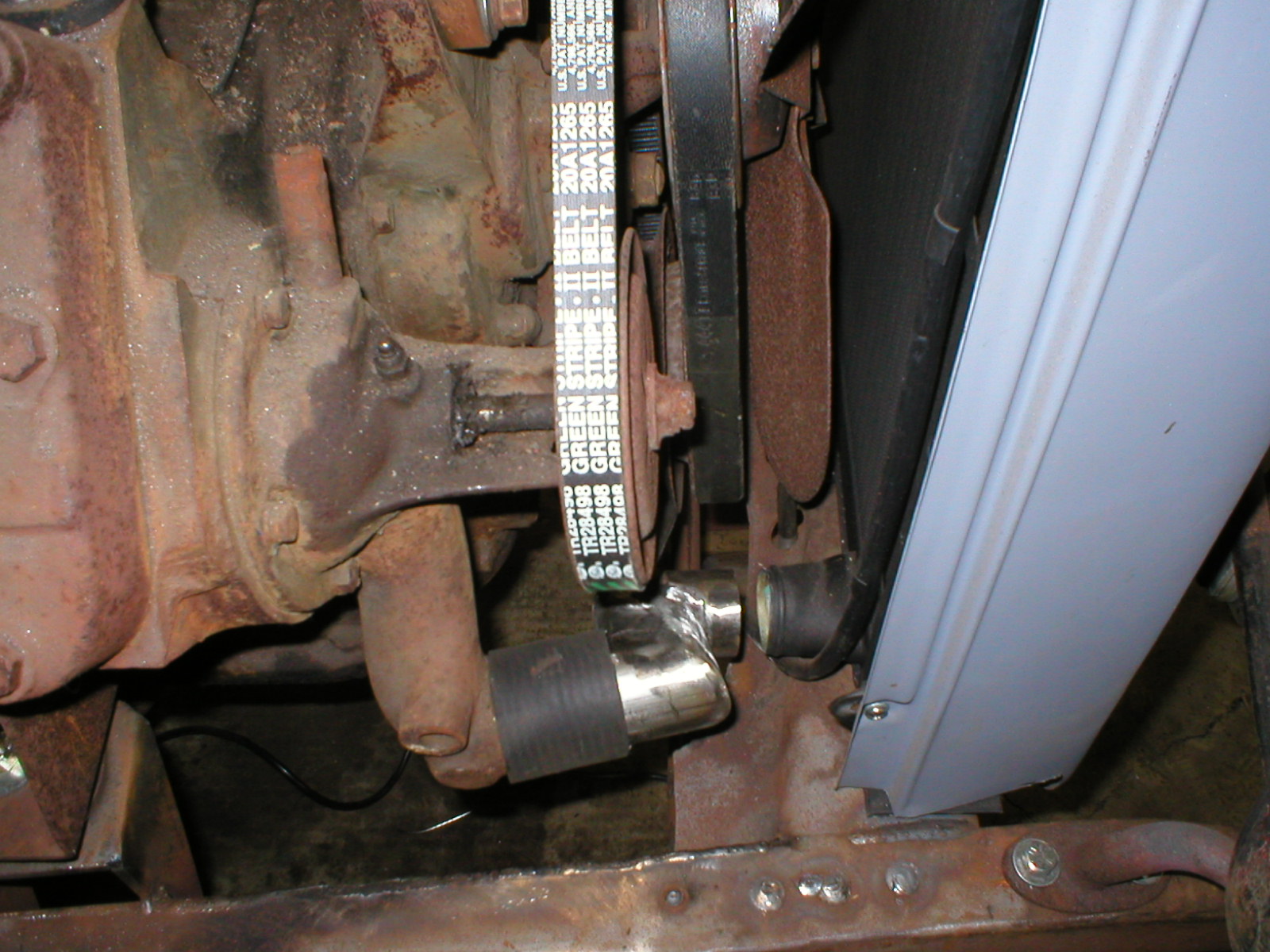

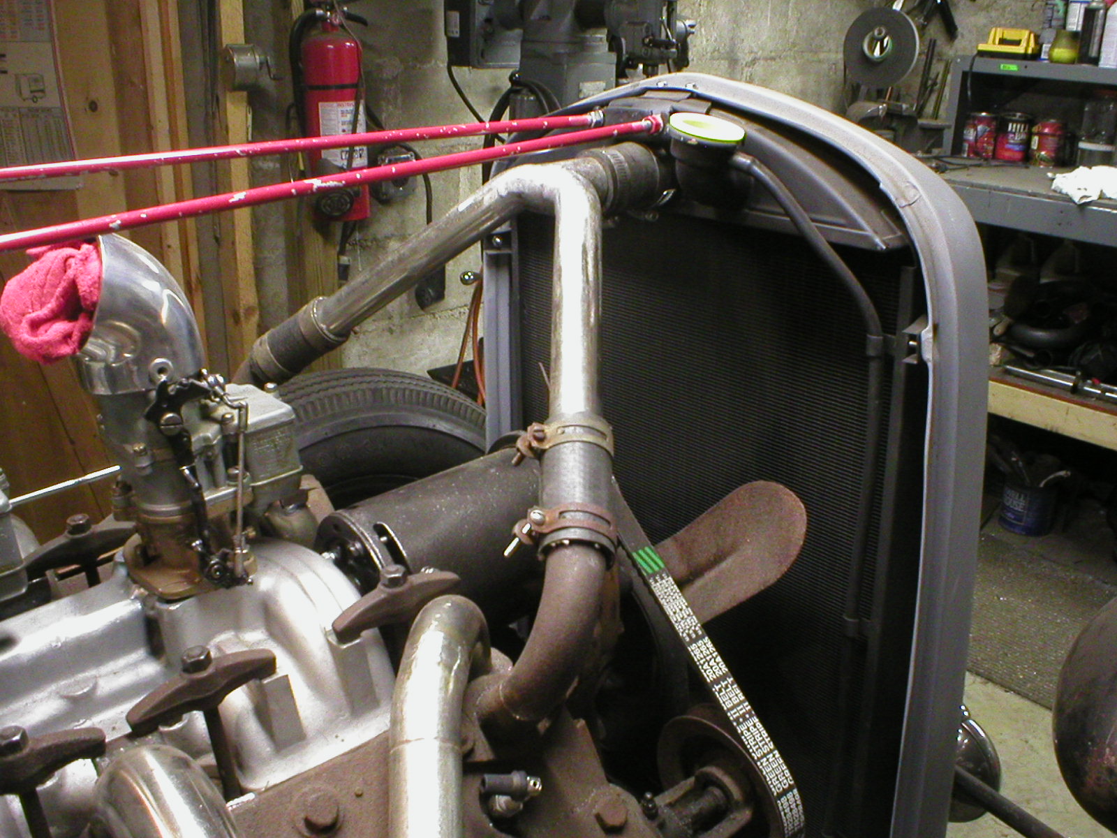

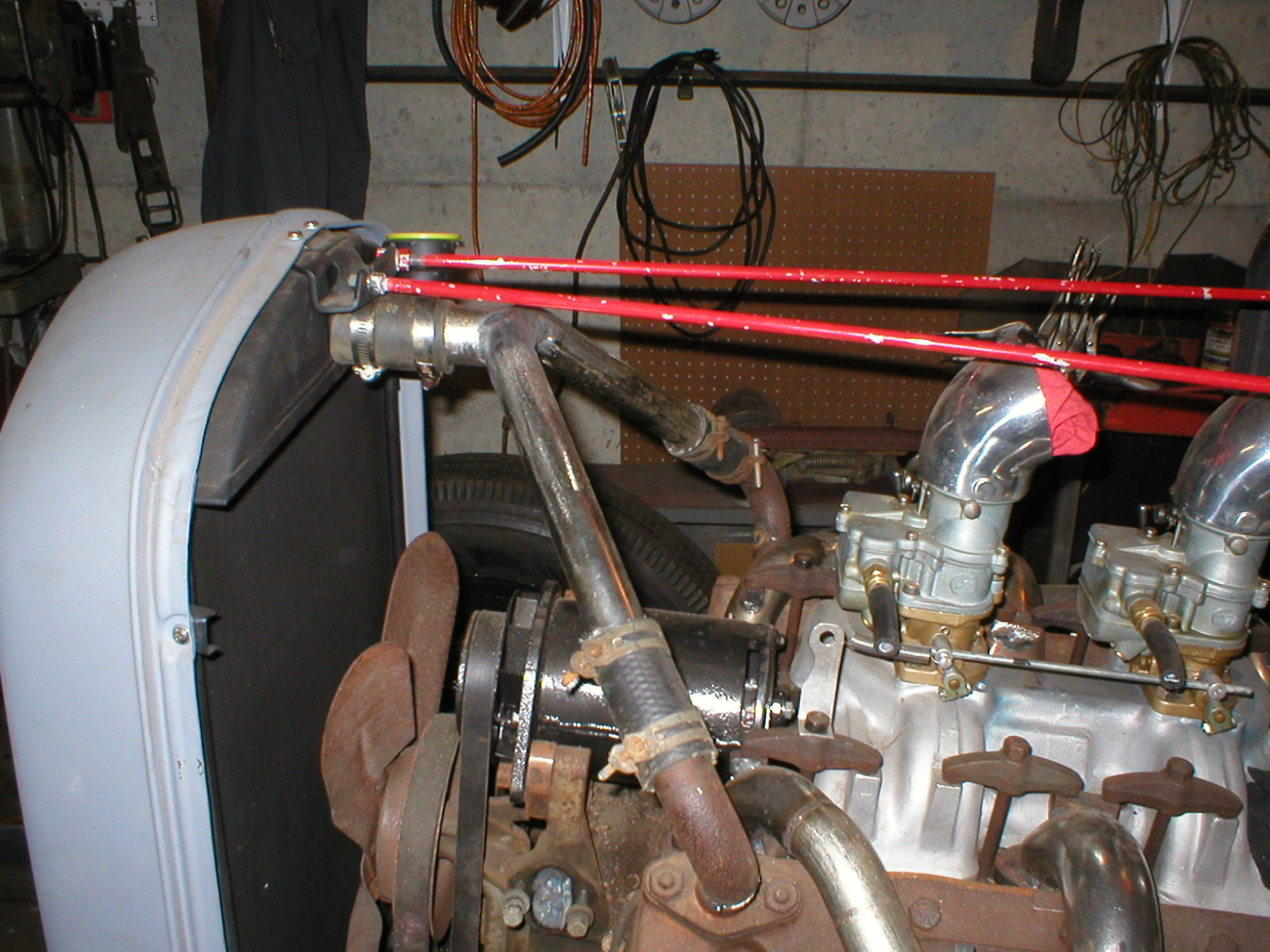

    I made the upper radiator tubes....when I ordered the new radiator I failed to get it with 2 ports, so I just made a stainless "Y" for now.....I cut and rotated the factory cooling tubes on the heads to better align the rubber hoses with the new "Y" tube. The lower tube was a "you know what"!!!! The water pump and radiator connection were close enough so that a one piece rubber hose wouldn't fit so I had to make a "Z" tube and couple it with rubber, all and all it worked out and doesn't look like total shit.....

    I thought about doing a "Y" in my '35 as well but ended up capping one port off and doing it conventionally. I like the way you did it though, That's looks pretty cool but I wouldn't blame ya for wanting to change it if it's not what you want.

  8. I kinda like the "Y". This thing is gonna be rad!

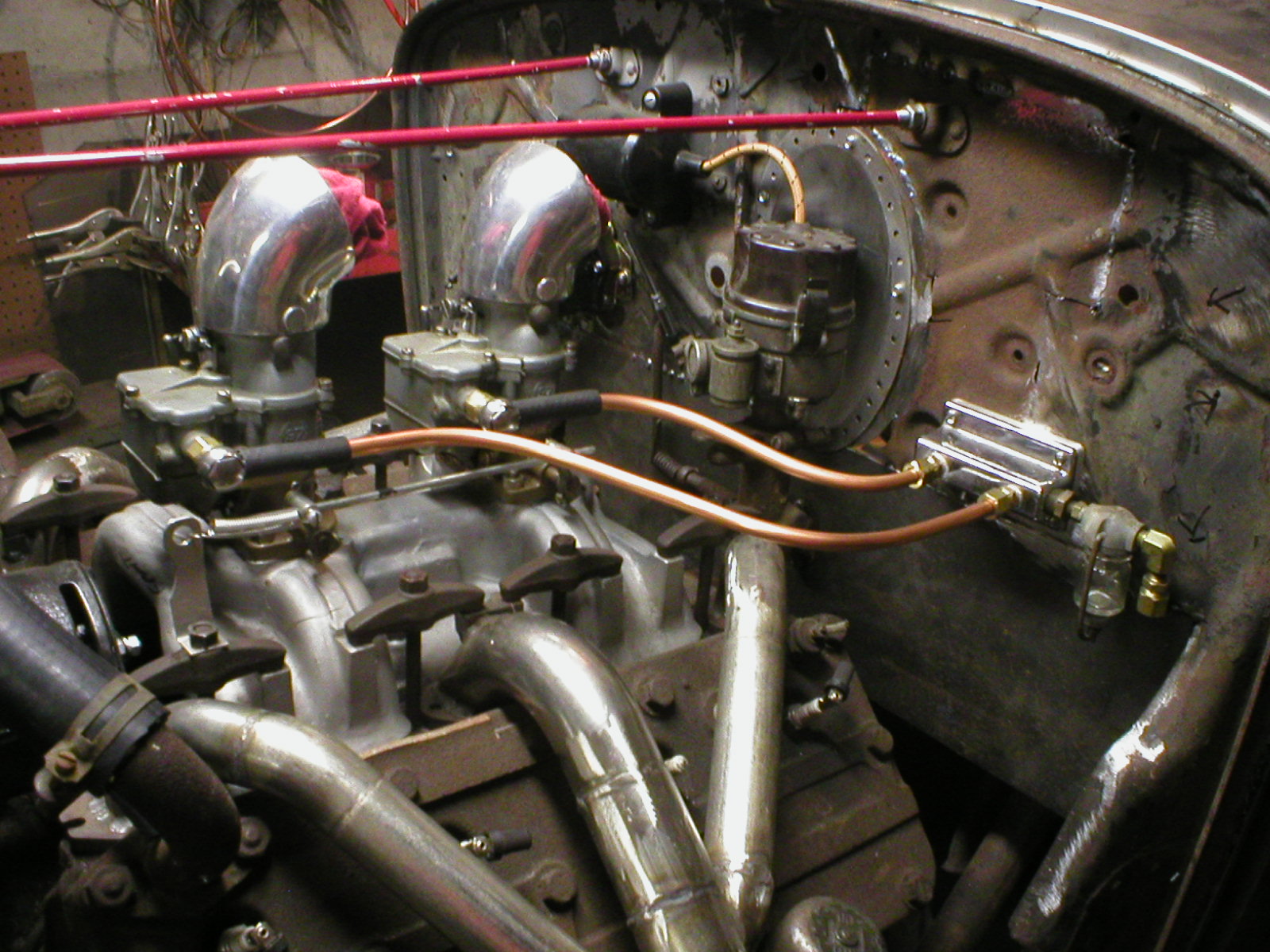

    I also found a generator that fit the motor...sorta....If you look close you can the original caddy generator mounts which were cast into the front cover of the original unit. I cut the mounts off the caddy one and used them as spacers and slide adjusters on the Ford pick-up generator....it worked slick and beats paying $1,000 bucks for a flathead caddy power gen! and, the original flathead pulley bolted right onto the Ford body...

  12. I am diggin the Y rad hose too...........unique!

  17. Pete nice work on the radiator hoses they look great!

    Dang Pete it looks like hard work making that radiator and flat Cad motor play nice together. How long did those lower hose adapters take to make?

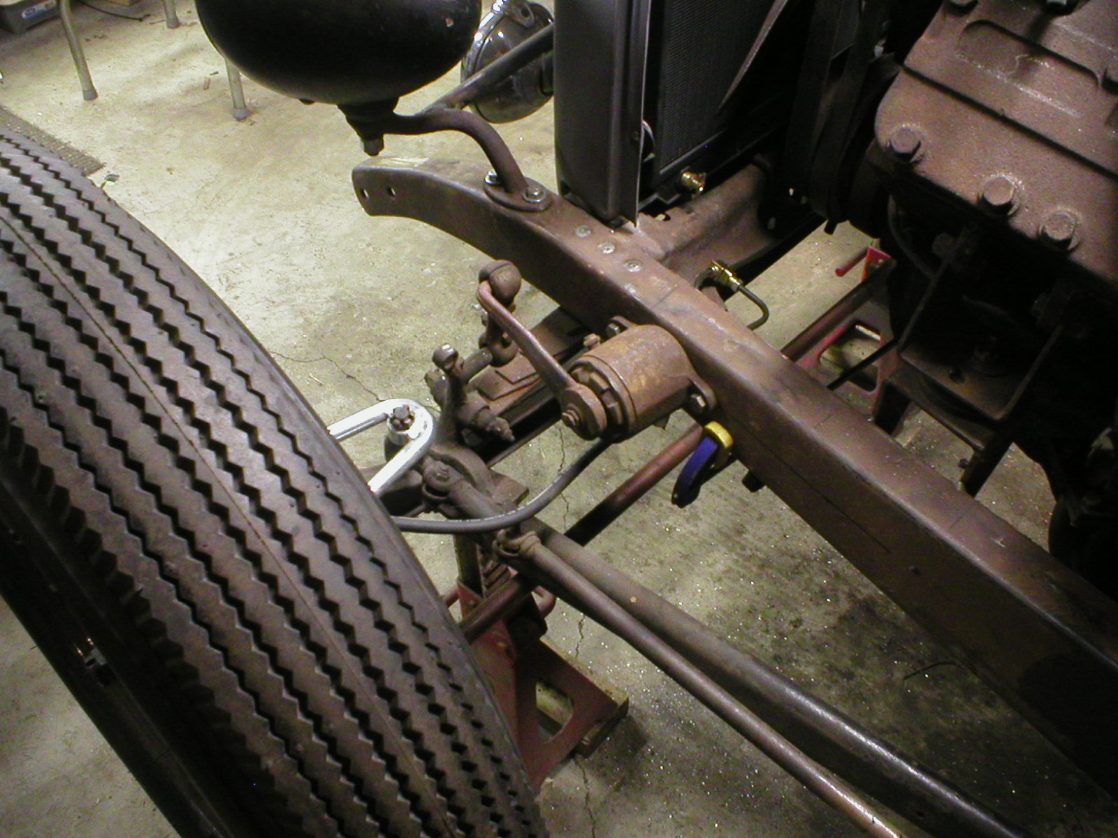

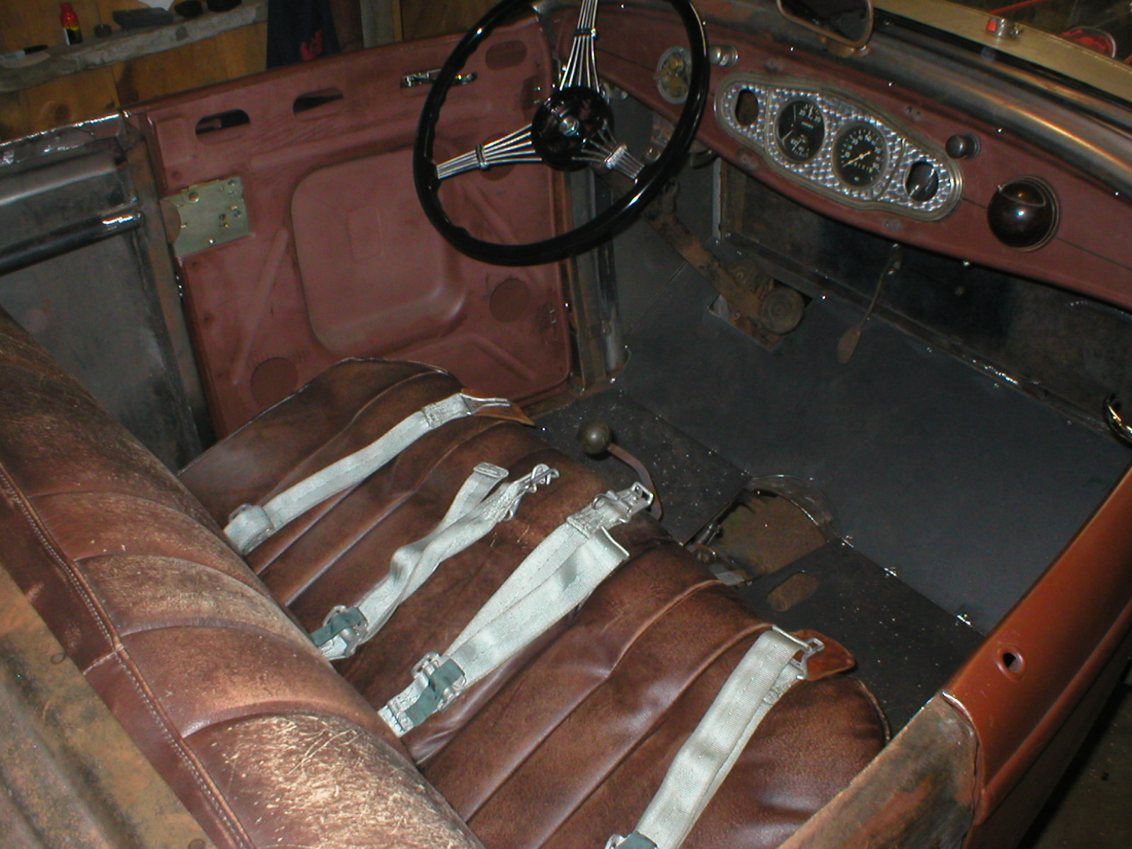

    I made a few small changes to the hose set up. I really didnt like the way the tubes looked so I cut them shorter and added more rubber radiator hose on both sides, looks a lot better. I made some copper fuel lines with isolation rubber, I bent them to avoid running the lines directly over the headers, the headers will be wrapped to keep the heat down.
    I added a few shots of progress, with the recent storm and the lack of power for 2 + days and the cleanup its been a little difficult to make time for the roadster...but I did manage to get a few things done.
    Got the seat and seat belts mounted, got the dash somewhat populated and finally got the tank and battery mounted.
    Front shocks mounted.
    Pete-

    Getting all fancy and shit with your interior. Next thing you know you'll have a latching deck lid. This seat is killer!

    Where did you get the seatbelts? Are they old or something you found new?
    Malcolm
  26. Pete
    Joined: Mar 8, 2001
    Posts: 4,807
    Pete
    Malcolm,
    I bought those from a dude here on the HAMB, they are original WW2 pieces. The seat was stitched by a friend who collects old leather couches and reuses the material.

  29. Looks great Pete. Now i have to start looking for old couches!

    Cool. ...and funny (great idea) that your seat is old couch leather. I also looked around for old couches to use the leather on my Roadster seat. Ended up finding some decent looking distressed leather on Ebay.
