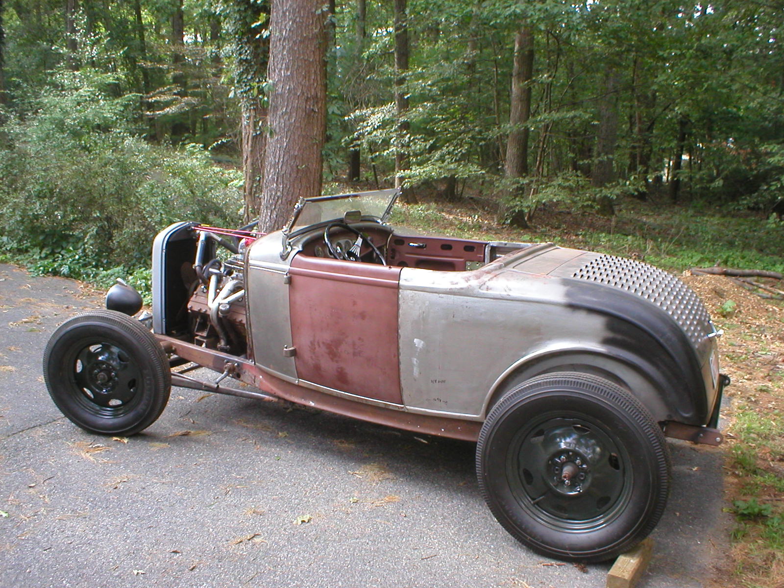

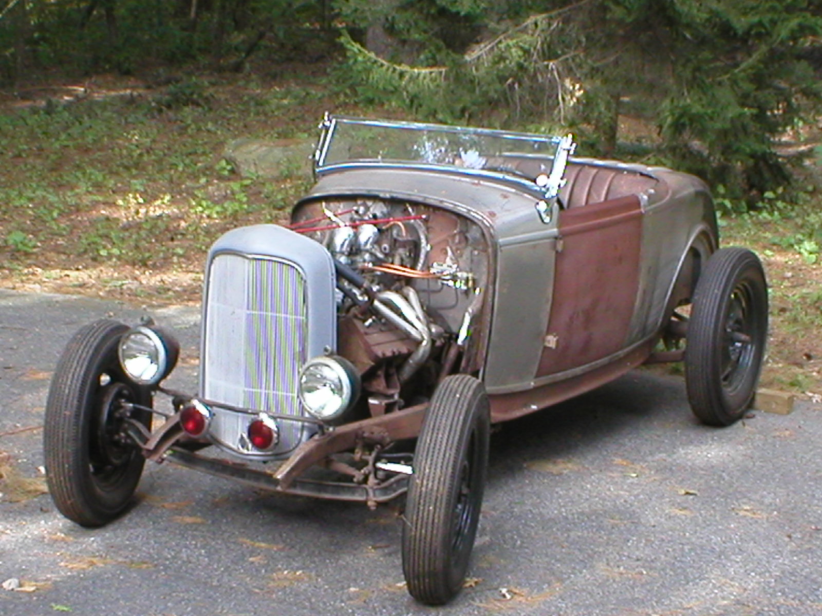

    I got way distracted over the weekend....I started working on the '32 five window!!! I bought a frame in North Carolina about 4 years ago, it was an old hot rodded frame with a really bad Z in the rear. I spent a few days dissecting the welds and removing the plate, finally managed to get it back to stock measurements. I dropped a model A front cross member and a '32 rear that I modified with a '40 center. Got the frame rolling and plopped the body on it.....This is the body I had listed in the cl***ifieds for trade, I think I'm going to build it now, coupedevilles chopped and channeled coupe really inspired me to keep the car. I have all the pieces for the roof and a 4 extra doors.
    Like I said I got way distracted.....
    Pete-

    Pete great sheet metal work , did you make the drip rails for the rear 1/4 trs ?? Lines look great and the openings had to involve some time consuming manipulation to get them so close .

    I bought the drip rail kit from Howells but had the fab the actual lips on the quarters in order to hang the drip rails....yes it was a pain to get both quarters the same, that took some time indeed.

    Mark and Becky stopped by the house today after Ty-Rods to check out the roadster, we pushed it than watched it roll down a small hill and just miss a giant pine tree....
    This is pretty much the first time I have actually seen the car outside in its final stance / posture, Im pretty stocked!!! Looks like the front may have to come down a bit.
