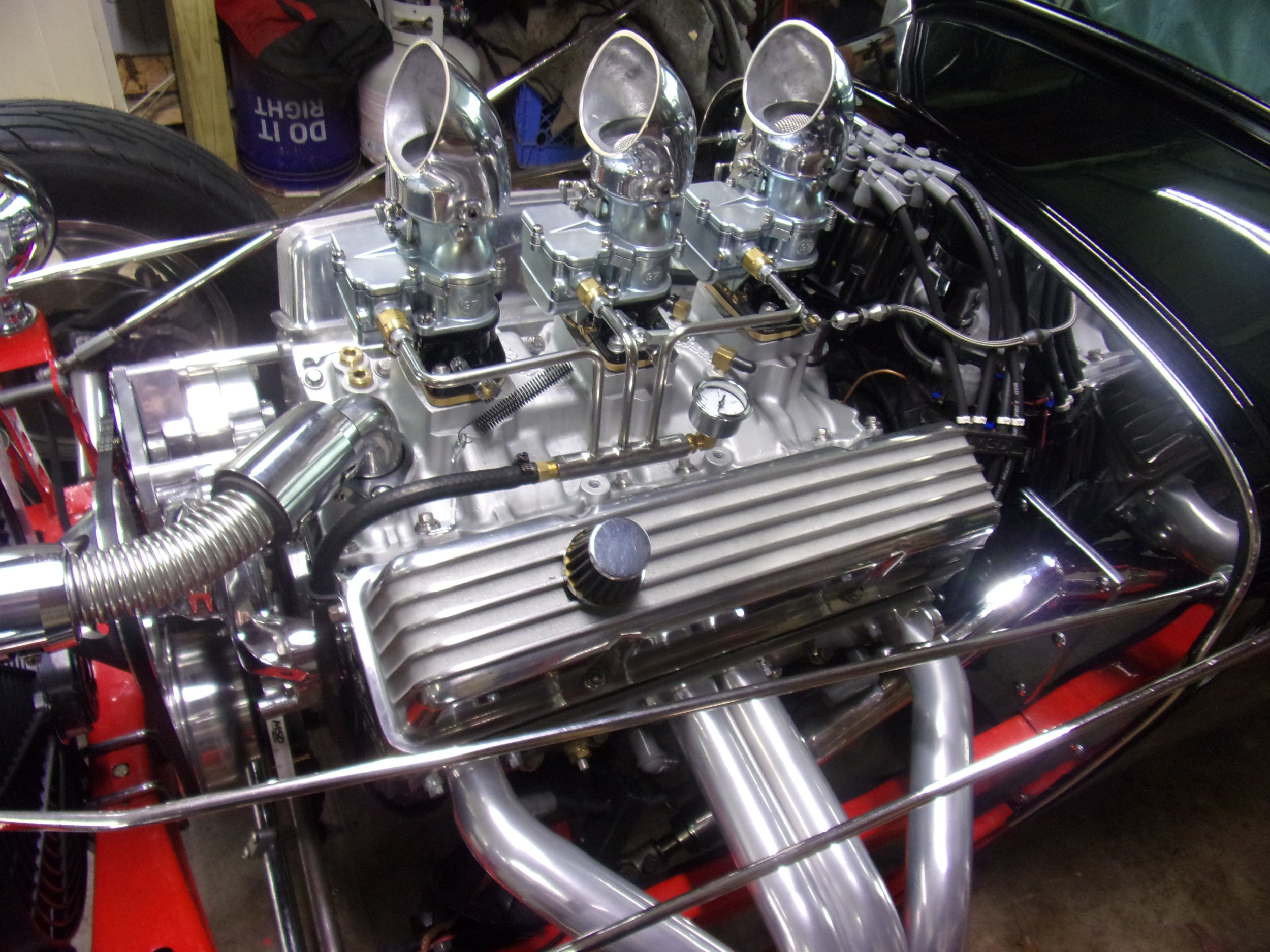

    has anyone found a good material that's not to restrictive on air flow and holds up, I've searched for recommendation's and found no good answer's, Thanks 100_0761.JPG

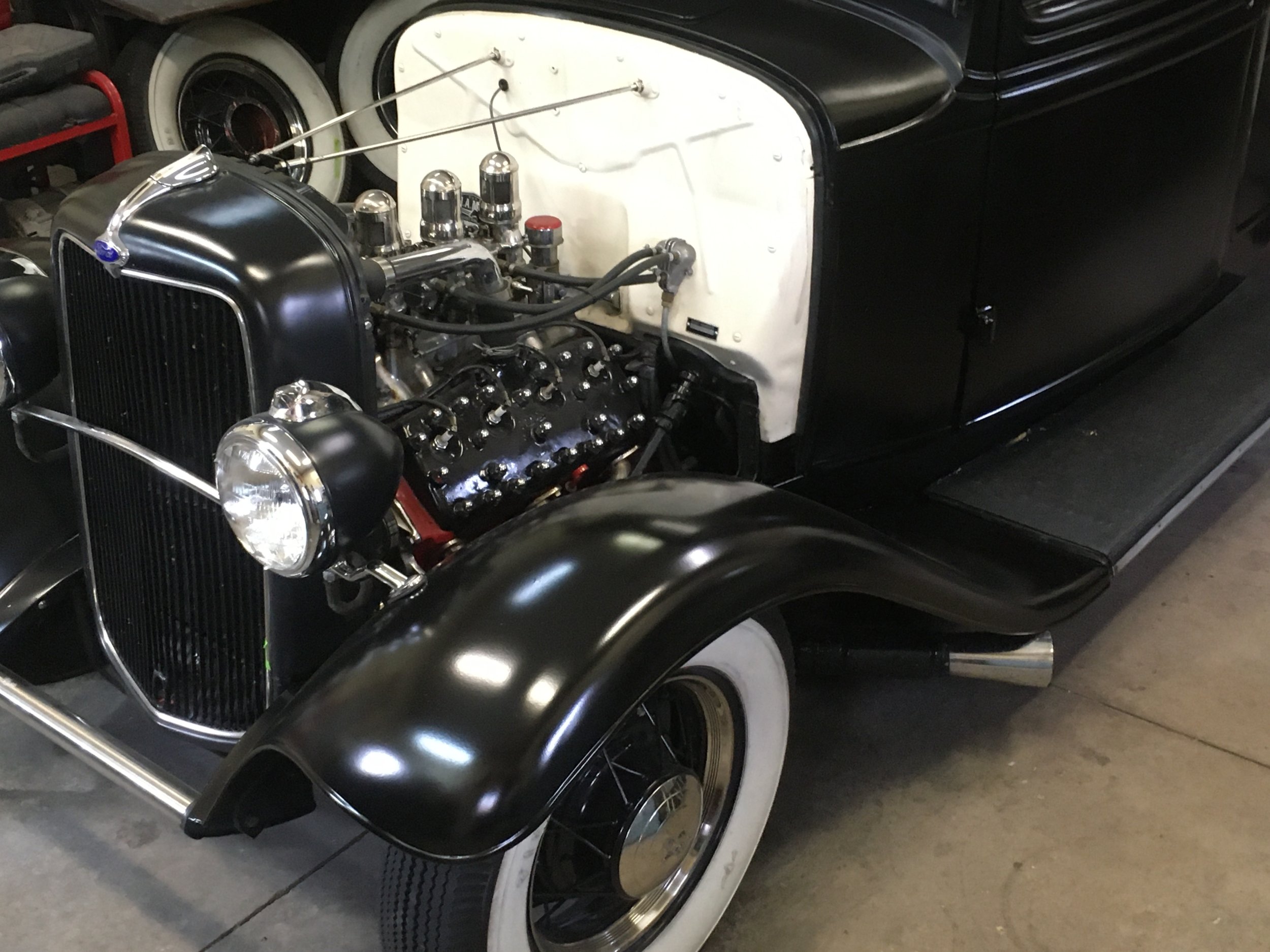

    Copper mesh and mommy’s *****hose.
