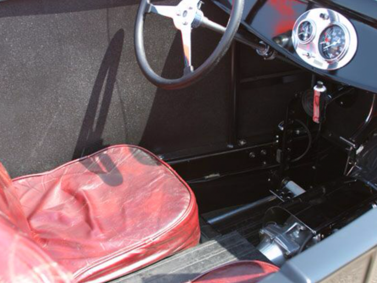

  13. A Boner
    Joined: Dec 25, 2004
    Posts: 8,162
    A Boner
    image.png My seat riser is just below the top of the frame rails at the front, and naturally slopes down to the rear. Oh, and don't be afraid to put the floor below the transmission.....in the ****pit. Might not work real good in south Texas, but works great in Wisconsin.....and it's a TH 350! It only starts to get hot in there at high noon on a sunny 90 degree plus day. In the evening when it's 60 degrees out it is a welcomed addition to a roadster. My floor is 5" below the bottom of the frame rails.

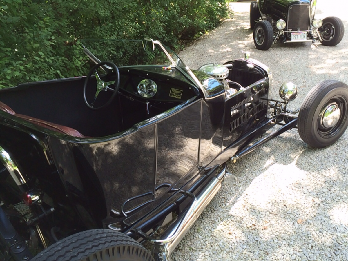

  17. A Boner
    Posts: 8,162
    A Boner
    Here is a pic showing the black belly pan and the stainless steel gas tank hiding behind the side pipe.
