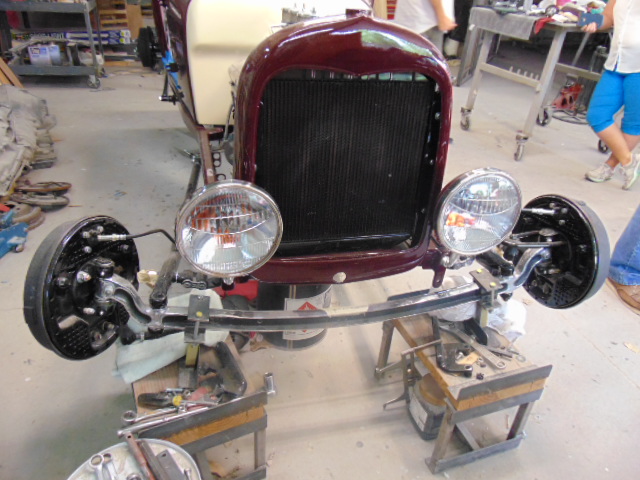

  2. This T Roadster has a flat channel cross member with axle out front. It belongs to Daddio211. JW

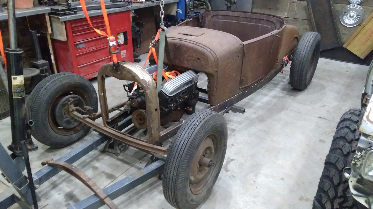

    Last night I managed to drag the engine in from where it's been for over a year now, sitting in the bed of a project truck, under a tarp. Don't judge...at least my lawn mower is H.A.M.B. friendly.
    I hung it in the engine bay just to see what I was working with. I'm hoping I can slip it in just under the upper hump in the firewall, with a recess for the distributor.
    I am hoping to get a chance to start on a flat crossmember tonight, and get a better idea of if the pulley will go behind or above the crossmember. I was told it is very easy to mount the engine too low. Does anybody have recommendations for crank centerline height? The top of my frame rails are 12" from the floor and the pinion should be around 16" (total guess based on 7.50-16 tires on a 8" Ford axle).

  10. Hanging that sucker in there like that tells you something, but a very little something. You need to get its (and the transmission too, ideally) weight on the frame to see where your rails ACTUALLY sit under weight.
    Put it where it needs to go, firewall cuts be damned.
  11. I set my motor so the pan rail was level with the top of the frame (At the front). From that pic of your motor it is clear that things are too short in the engine bay and with no spare room in the body you don't want to eat into that unless you are less than 5'' tall. If you use a flat cross member and have the crank pulley above it the motor will sit very high.JW

    Perfect! That was just the picture / description I needed. Looks like your engine tucks right about where I want mine to be. From that picture it looks like your body is off the frame a little? Or am I just seeing things?
    loudbang and 26 T Ford RPU like this.
  13. You are right, its about an inch up. Its how it was built in the late 40's so that's how its staying but I have now built a small filler strip. I have lots of ground clearance but that will change with different motors. JW

    I still did not get time to work on the crossmember, at this point it will have to wait till after Speed Week. I did get to play with the engine position though. I tucked the engine down and back till it looked about right. I am just under the bump in the firewall, and the back of the engine is dead flush to the lower part of the firewall. The pan rail is about 1" above the top of the frame rail, putting my crank level at around 13". The oil pan is around 6" off of the ground. This seems a little low to me. Any thoughts?
    Since I have one on hand, I am playing with setups using a 1928/29 grille shell. My wheelbase is still set at 103.5" Once I got the engine in with no crossmember or spring to worry about it was very clear that should my concern was misplaced this whole time. What I should have been worried about was water pump + fan to radiator clearance. With all the different options I have of spring / crossmember / axle combinations I can make something work suspension wise. Just for the record my existing crossmember actually did fit. You would probably have to pull the harmonic balancer off to pull the engine, but it could work.
    Anyways, here is setup #1.
    I slipped the grille shell right behind the axle. This setup would have a flat crossmember ahead of the pulley, and the radiator would sit right on top of it. I could run a 23" tall radiator. This would also be an easy swap to a track nose with a different radiator. The problem shows up when I measure for the radiator thickness. I only get 4.5" from the front of the water pump to the front of the grille shell. Keep in mind this is with the shell touching the axle...that would obviously have to change. I could stretch the wheelbase to 104" MAX, and maybe slide the engine back another half inch, but anything more than this is going to really start to chew up interior room I don't have.
    I love the look, but my question is how much (or little) room do I need between the water pump and radiator? I am figuring a 3" thick core, and a 2" ish deep fan (1" out front of the pump), so I am left with 1/2" of clearance. From the research I have done that is enough, but just barely. I could spec out a thinner radiator, or maybe make a trick fan that is set back towards the belt? Why does no one make one of these? It seems like it would solve a lot of problems for a lot of people. On a single pulley setup I could easily push the fan 1"+ towards the engine. What am I missing here? Has anyone considered this before?
    The other option is the same flat crossmember, but hanging the radiator and grille shell out over the axle.
    This gives me 7" between the front of the water pump and the front of the grille shell. Heck, I could even shorten up the wheelbase with this option. I do have to shorten up the height of the radiator to give me suspension travel though. Or run a dropped axle, but keep the ride height the same. Every inch of drop (axle) that I put in, is another inch that I can add back to the radiator. As it is I could run a 20" tall radiator and have roughly 3" for suspension travel. How much travel room do I need to leave myself?
    This would definitely need to have good bump stops to keep the axle from destroying the radiator. Is a 20" tall (including the tanks) aluminum radiator adequate to cool a mild 327? I am pretty sure it is, I just want to be sure. There is a local radiator shop that can make me a custom USA built radiator for a very reasonable price, so I can really have a lot of options here.
    kidcampbell71, Stogy and loudbang like this.

    Personally id stick with the basics. Drop axle. Reverse eyes. Aftermarket cross with 1" drop. Proven awesome by many . It is your first build. Dont be shy to add to your frame. Done properly and boxed it is fine . Plenty of 32 rails out there welded together.

  17. Stop wasting your time and thought energy on putting the radiator over the axle. It's a bad idea unless you're running spring-over.
    You've got the look and the function right here. DO THIS:
    28/29 shells look awesome with 26/27 bodies IMO.
    Grab that radiator you've got and mock up with it.
    Put some mounts on that block and some temporary mounts on the frame and put the weight on it.
